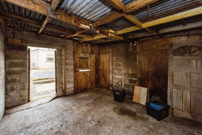

Thanks, this is exactly what I'm hoping to achieve. Would you suggest leaving a gap between the celotex and the roofing sheet OR between the celotex and the ceiling (plasterboard or plywood) to aid ventilation? -

It's a 6m x 4m garage with block walls and a correlated azzy roof. Not a pre-fabbed garage if that's what you mean? Not particularly looking to make it "habitable" just usable for a bit of office space. Do you think replacing the roof is a MUST? Trying to limit how much I neccesarily need to do. I'm happy to replace the azzy corrugated for some bitumin corrugated to freshen it up but I want to avoid putting a completely new roof on it, if possible. My main concern is whether I can realistically create an insulated false roof internally (framed ceiling as in the above photo with some celotex in between the sections and boarded over), without introducing condensation and ventilation problems? -

For a bit of context, this is an example of what I'm hoping to achieve. Corrugated roof, timber framed false ceiling, celotex insulation, then boarded over with ply/plasterboard. -

Aside the obvious aesthetics, what are the benefits to replacing the roof for a different style? -

Not sure exactly. The house is 1970s-ish. It looks quite fibreous. -

Ha. Somewhere in between would be ideal? I'm proposing the office and gym to be a self-contained pod-style design. A box within a box, if you will. I just wanted to put some thought into insulating the gap between the ceiling of the room, and the roof of the garage for extra comfort. I'm not looking to make the garage into a second house. A bit of office space for the day, a space for a gym and the remaining space as a small workshop with storage. If it's a bit chilly, it's not going to be a big problem. -

Hi guys, I'm converting my empty garage into a home office/gym/garage and I'm currently in the preparational stage of working out the ins and out of what I'm going to do. There's a lot that needs doing but the main issue I have, is that the roof is a standard corrugated roof and I believe it to be asbestos (haven't had any samples yet). I am proposing to create a false ceiling so I can insulate the office/gym space and trap some of those azzy fibres dropping into those spaces if the roof ever becomes damaged - I'm just wondering whether creating a simple framed suspended ceiling just below the corrugated roof and sliding some celotex in-between the two would poise any condensational problems or what other people might suggest? Replacing the asbestos roof for a bitumen corrugated roof instead is an option, but I don't think it's going to help much with creating a false ceiling for insulation. Secondary to that, I am shying away from the traditional plasterboard as a ceiling option as I feel like the dampness of the garage might make it weak and liable to fall so would blue-aqua plasterboard or even ply be a better option to use? Thanks, Darren
