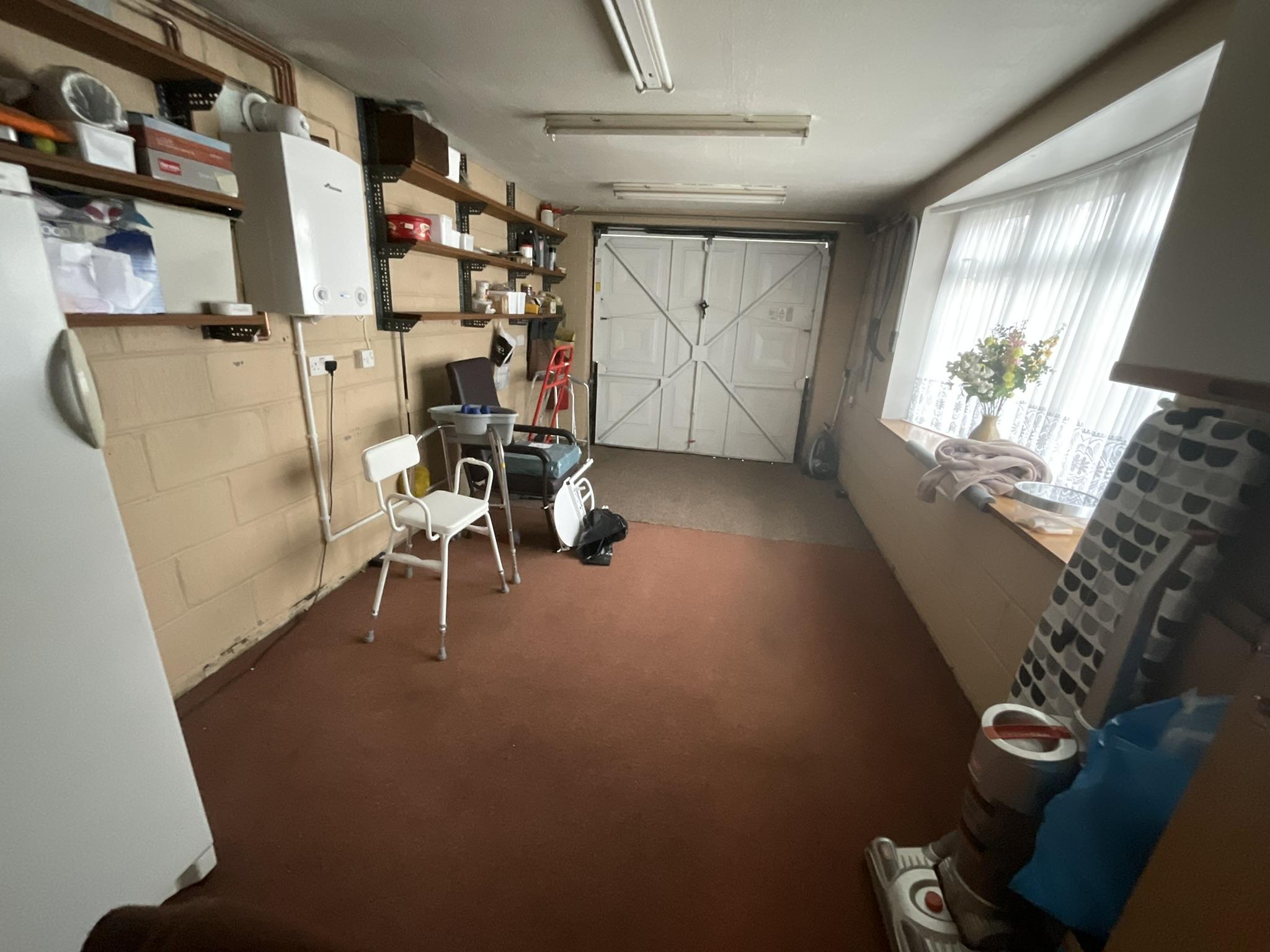

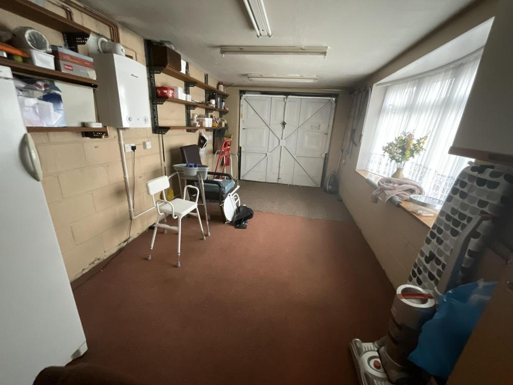

Member (3/5)

  1. LPA is Medway. Tried to call them multiple times but nobody answers or you get VM. Thinking I may as well just get the floor and elevation drawings done and just give PP a shot. If they say no, they say no. Thanks
  2. I have filled out the VOC form on the Planning Portal and it doesn't require any diagrams, it says: "You do not need to provide a site boundary or location plan for this application type" VOC It just asks for details of the original PP for the Extension and a box to explain what condition you want amended/removed and why. No option to add any documentation.
  3. I am trying to avoid needing drawings and going through full PP so £357 seems worth it if I can remove the condition no?

  5. Thanks all, sounds like the Removal of PD condition + appeal might be the first port of call as this will not require drawings anyway. These are the conditions listed against the original extension:

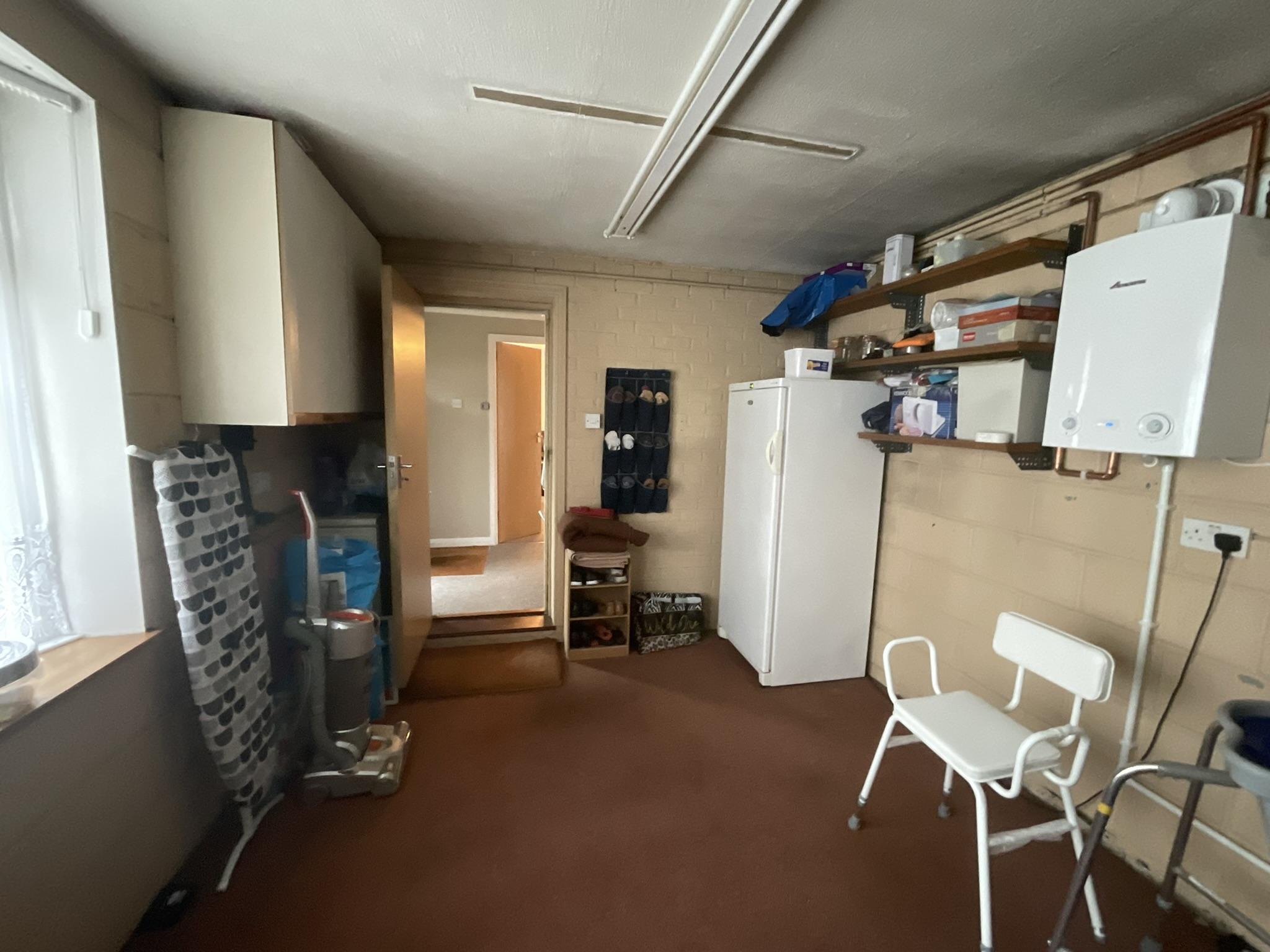

  10. HI We have an internal garage which was part of an extension done by a previous owner in the 80s. Bedroom above it so walls are cavity with ‘some’ insulation. Garage has a door from the hallway of the house, a large window and both lighting and electric circuits. We will never use it as a garage and would be handy to have extra room. I realise building regs will be needed so I am thinking I will need to brick up the garage door, foundations likely needed. Then raise the floor up to the house level. DPM, insulation and board etc. Then insulated plasterboard on the walls to meet building regs spec, although I have no idea how much in the the cavity walls already. Boiler is in there so will get that boxed into a little cupboard. Im gonna get a firm in to quote but I think it should not be overly expensive considering a lot of the work has already been done? Thanks
