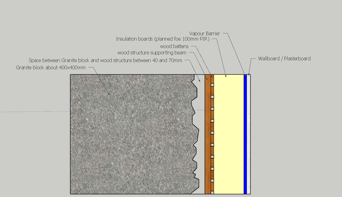

So yeah, as I suggested, the walls are built the way like that, I do not know what that technique called. This is how I think I could insulate it: Questions: Do you think this is generally viable? On the photo below the nails are rusty, not sure if they require any treatment/replacement? 100mm PIR for wall, sounds good enough? Thickness suggestion for wallboard/plasterboard Thickness suggestions for wall vapour barrier? Update, These are the thickness for the regulation (0.3 Watts / m2K): EPS – 88.6mm thick Mineral Wool – 108.6mm thick PIR board – 65.7mm thick

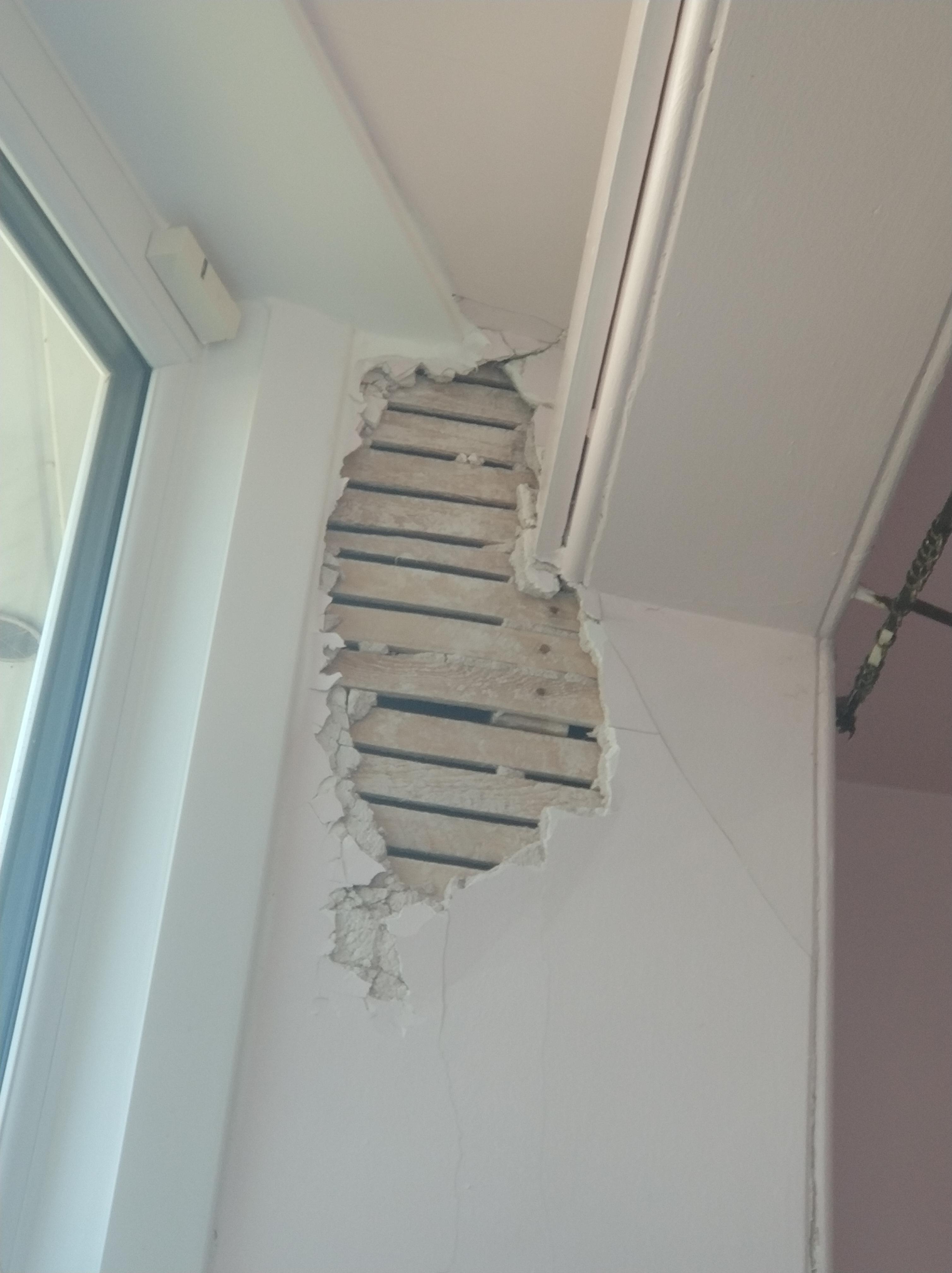

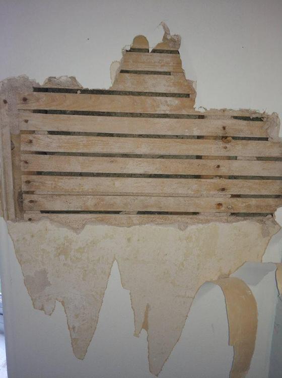

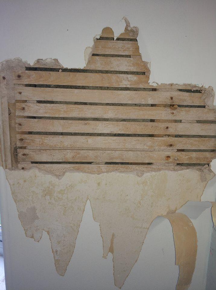

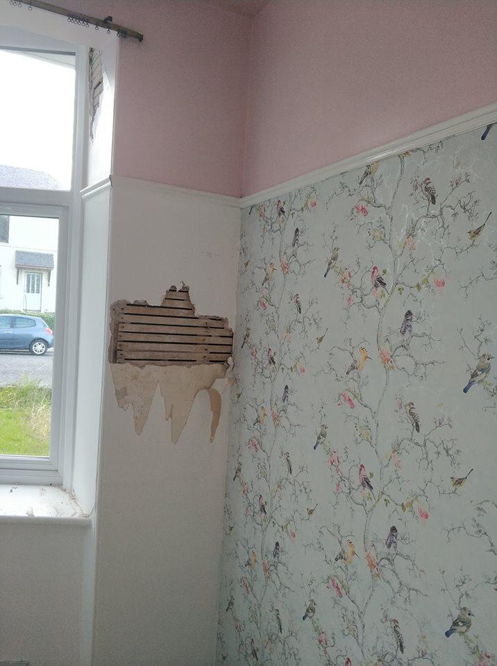

Realised some (probably) leak damage in one of the rooms, removed some of the horse hair plaster thingy and this is how the wall looks like behind it: There is no insulation at all, I hope there is a wood structure where I can put in some insulation, if there are not any I might need to build one, or go with alternative insulation methods like Lime plaster mixed with hemp directly to the granite wall. What do you guys think about this method, I got this suggested: Build a stud wall leaving an air gap between the external wall & any insulation. Use rigid rockwool batts, and finish off with a wood wool board

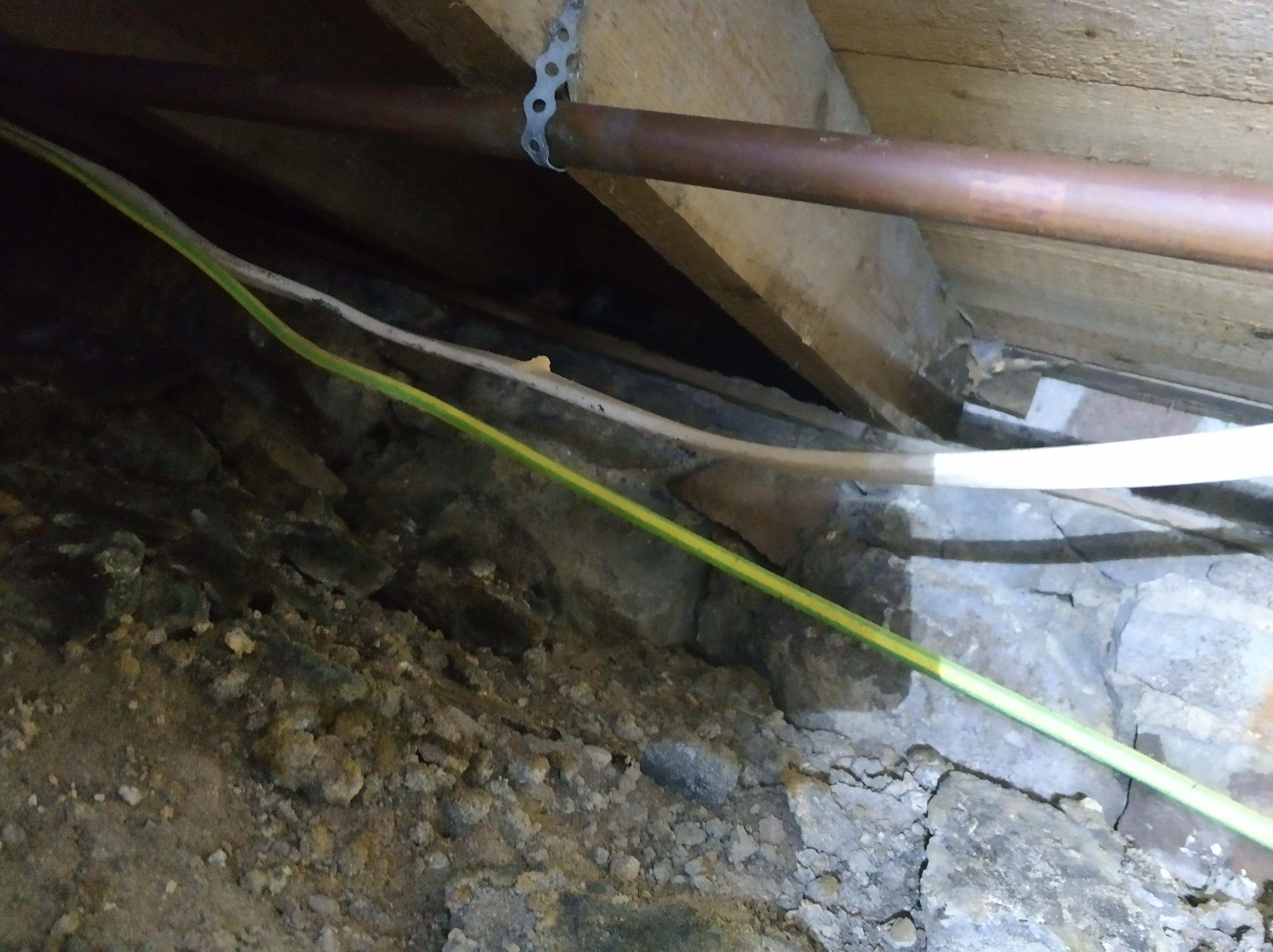

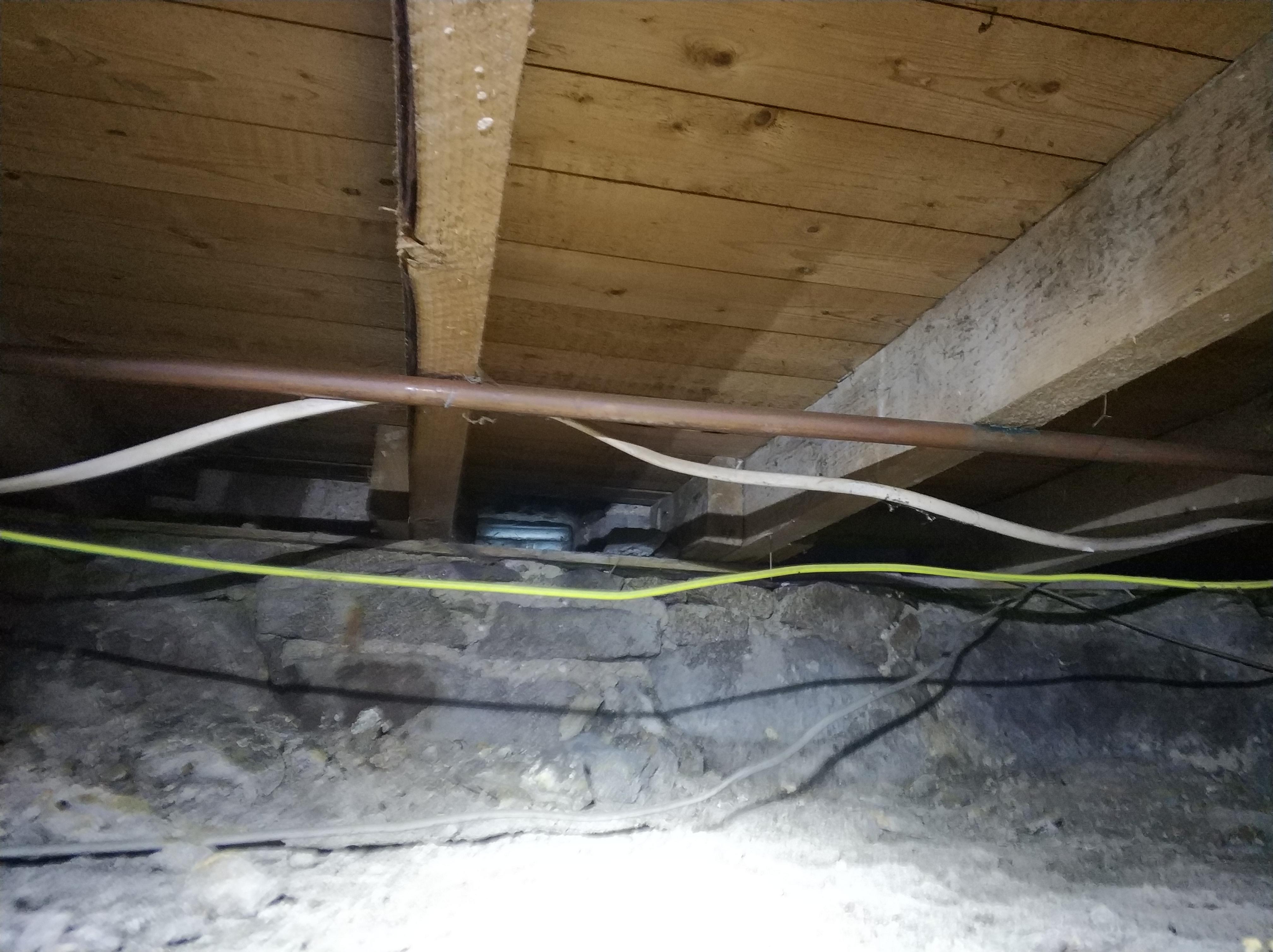

So I should use 225mm if I want to go for 150mm, that might be an issue... I was even just looking at how poisonous/harmful the materials are and they said EPS is better. At the end it will come down on space and price I guess This is how the crawlspace looks like, sorry for the bad photos not really sure which angle would be the best for the crawls space, but it might give a bit of an insight:

I'm currently thinking to use EPS instead of PIR for floor insulation, is this a good or a bad idea?

It is about 30 cm, so not really, but I will remove all the floor joists, and put down new floor as ply wood, so I will be able to do what ever I want.

I should be able to post some photos of the crawls space next week, I am not sure if it would help in the decision or not. So right now, everyone agrees that I should install the vapour barrier on the bottom of the crawls space as well as below the UFH and screed? (sorry for keep repeating your answers, just want to make sure I understand it right)

@ProDave From the discussions from above, I pretty much draw the conclusion that there is essentially no point to put down vapour barrier if I insulate the floor and install UFH. What do you think? Correction: I am going to install the vapour barrier between the Ply wood and UFH.
