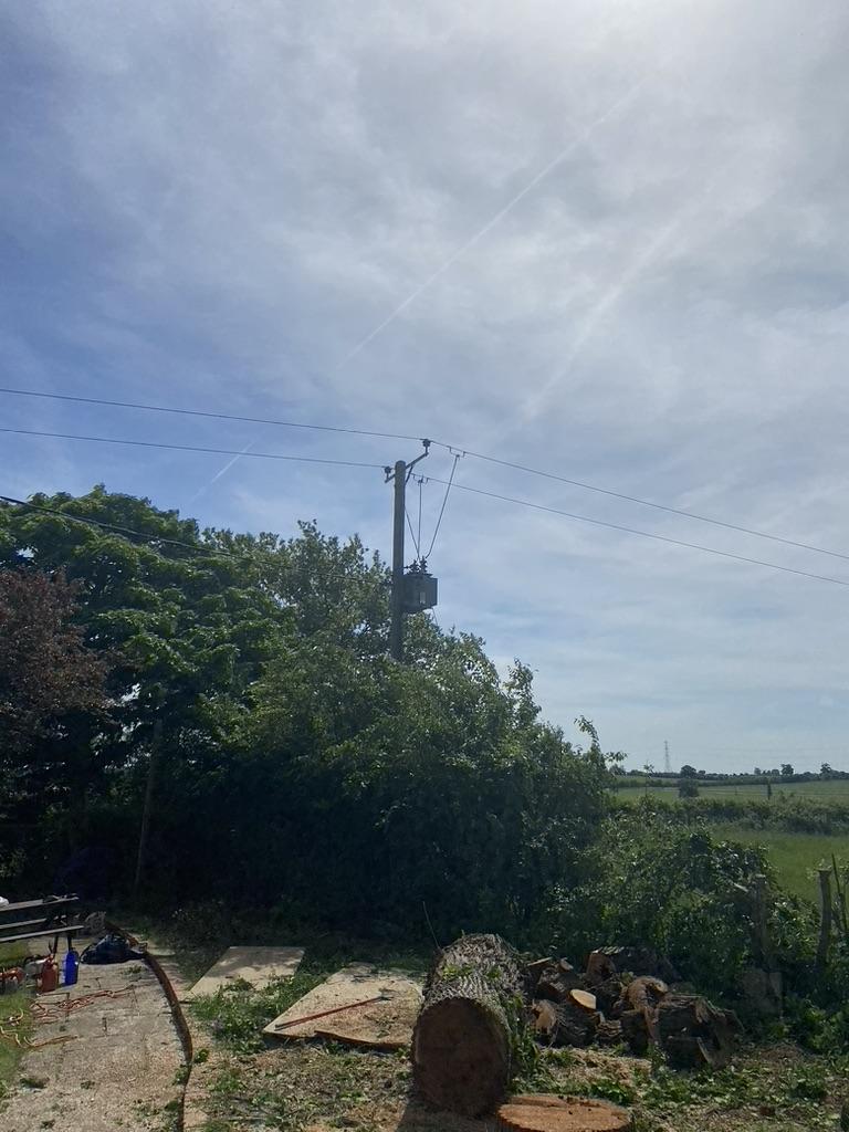

  4. Thanks but possible to have 2 phase (2 x single phase )??
  5. Hi all We are about to demolish a small bungalow and build a new 2 storey home for my disabled wife with PV/Storage and ASHP etc Currently we have single phase 100A supply and would expect to be limited to the normal PV export limit of 3.6kW from our DNO UKPN Looking at the substation/transformer and UKPN Mapping I can see its a HV Transformer High Voltage 1kV -> 22kV Control Zone = 11kV Chelmsford South Voltage = 11kV The power supply will be repositioned and terminated in a new GRP during the demolition/groundworks phase and our neighbours power line will be moved from going over our land to under it . How can I check if the transformer is capable of 2 phase supply as that would give us a better PV export limit and what. kind of cost would I expect. We had a UKPN survey to talk about relocating our neighbours powerline and I asked about 2 phase supply and he just mentioned the transformer would have to be upgraded/replaced ? When I see 2 powerlines coming to the transformer does that indicate possible 2 phase supply ??
