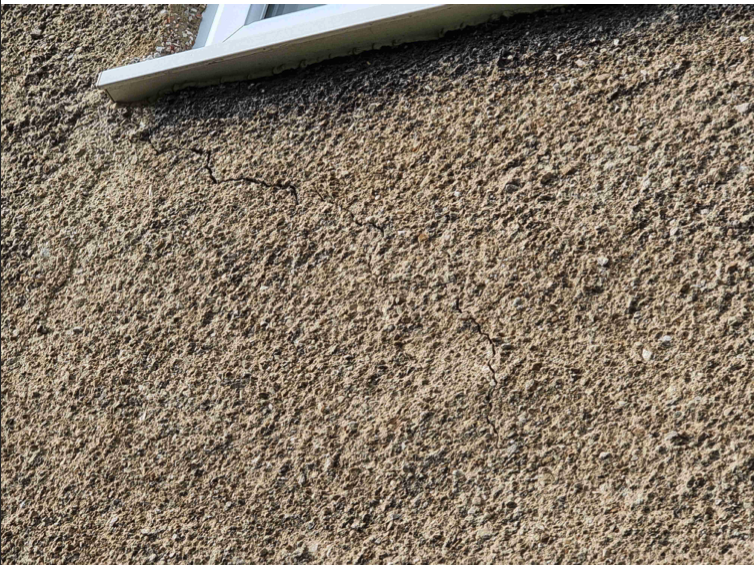

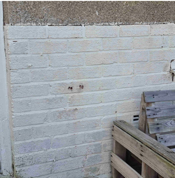

  3. Hi all, We just got our survey back for the 1930s fixer-upper that we're in the process of buying. The house is partially rendered in what I'm guessing was originally pebbledash and exposed brickwork on the bottom, and sometime in the past, someone has put paint or another render layer on top (possibly to hide any cracks/defects). The rendering is now damaged/cracked in various places. At the rear, the exposed brickwork has some masonry paint on it which apparently is the source of damp. The surveyor generally recommends using lime-base renders/mortars to allow the masonry to breathe. However, if we're planning to retrofit the entire house with a centralised MVHR, do we still need to use lime-based coatings/mortar? Could we strip off the existing render and replace with a 'simple' cement render from top to bottom?
