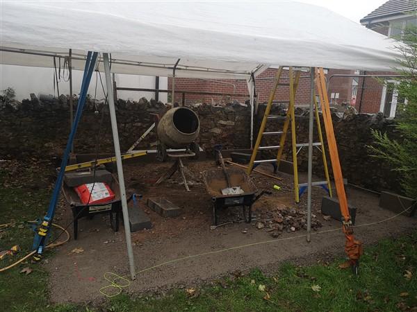

Getting there! Compacted the base, put in a few inches of sand and levelled it, DPC down, 75mm Insulation down and taped the joints and the concrete lorry is arriving in the morning! 😅 -

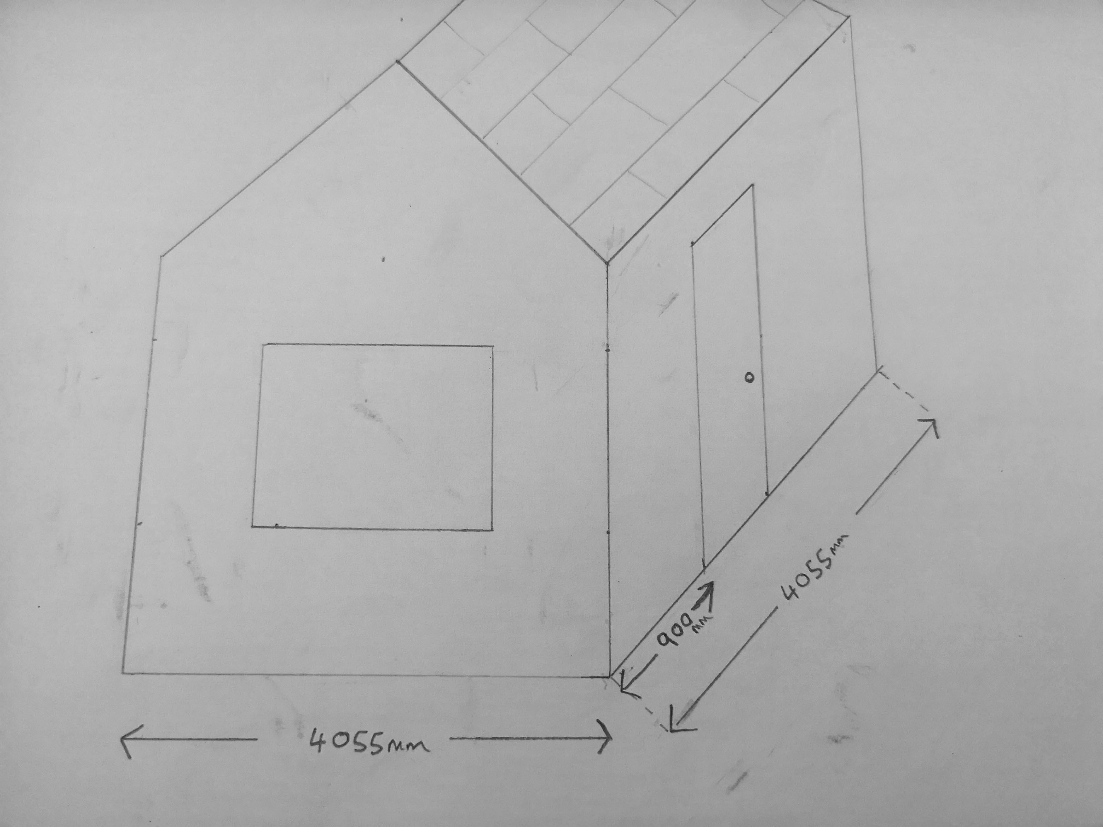

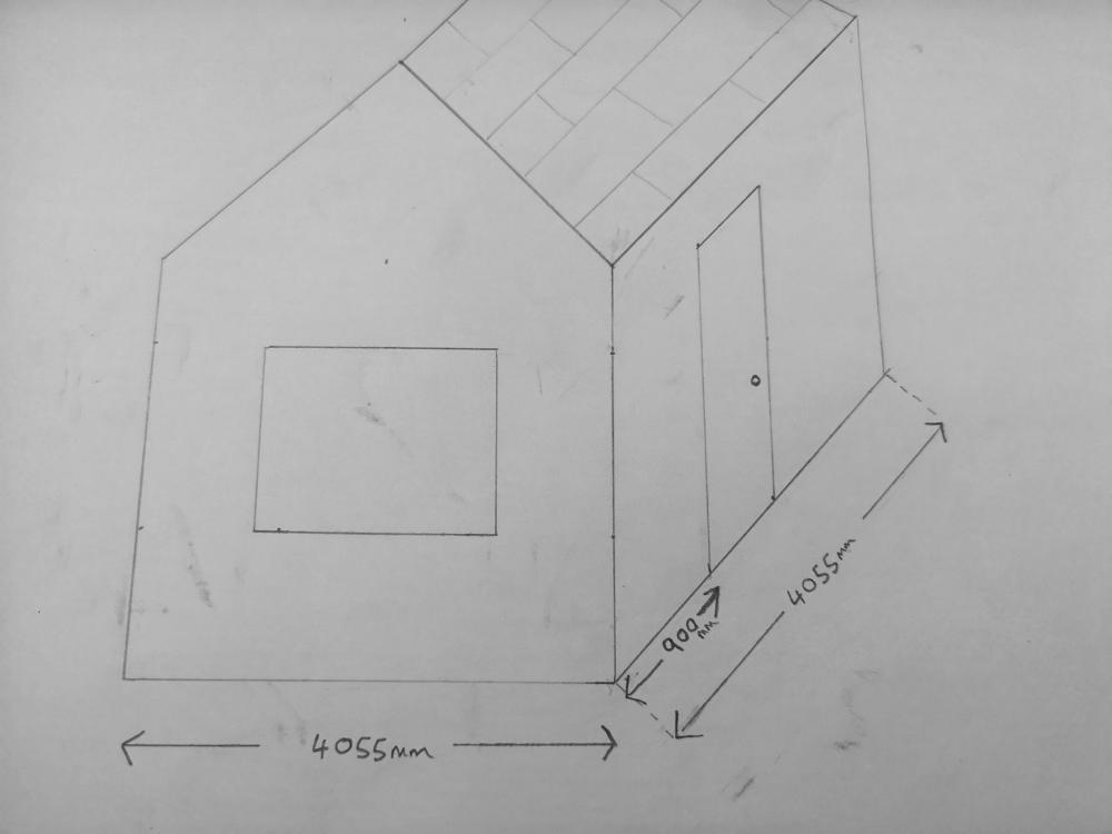

I have a rough sketch, and have worked out where I want the door and a window. Art is not my strong point! -

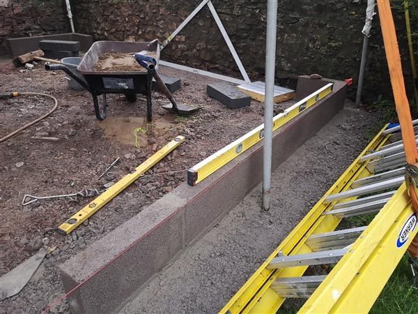

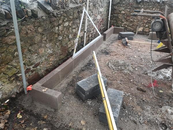

Decided to put up my marquee over the workshop since the weather is rubbish! Started my first course. decided to go with the blocks upright, and i'm going to add a little extra insulation as suggested and the floor concrete should only be around 75mm thick. Seems to be going ok considering this is the first time i've ever laid blocks! The corners are spot on square, have measured the diagonals to check and they are perfect. Turns out, the Taylor Wimpey concrete foots weren't quite as level as first thought, but only 10/12mm difference from one side to the other, so I've taken that out with the mortar bed. Question! As it is 4M square, I presume I need to put a block pier on each wall? Should this just be in the centre? Or should I maybe put it on the door opening on the one wall? On another wall there will be a large window, and my workbench will be running along that wall, I would prefer not to have a pier on that wall, any suggestions!? The piers themselves, do I just lay blocks right next to the wall blocks and use wall ties? Or should the blocks be laid flat for the pier? Any tips as always are welcome! Thanks. -

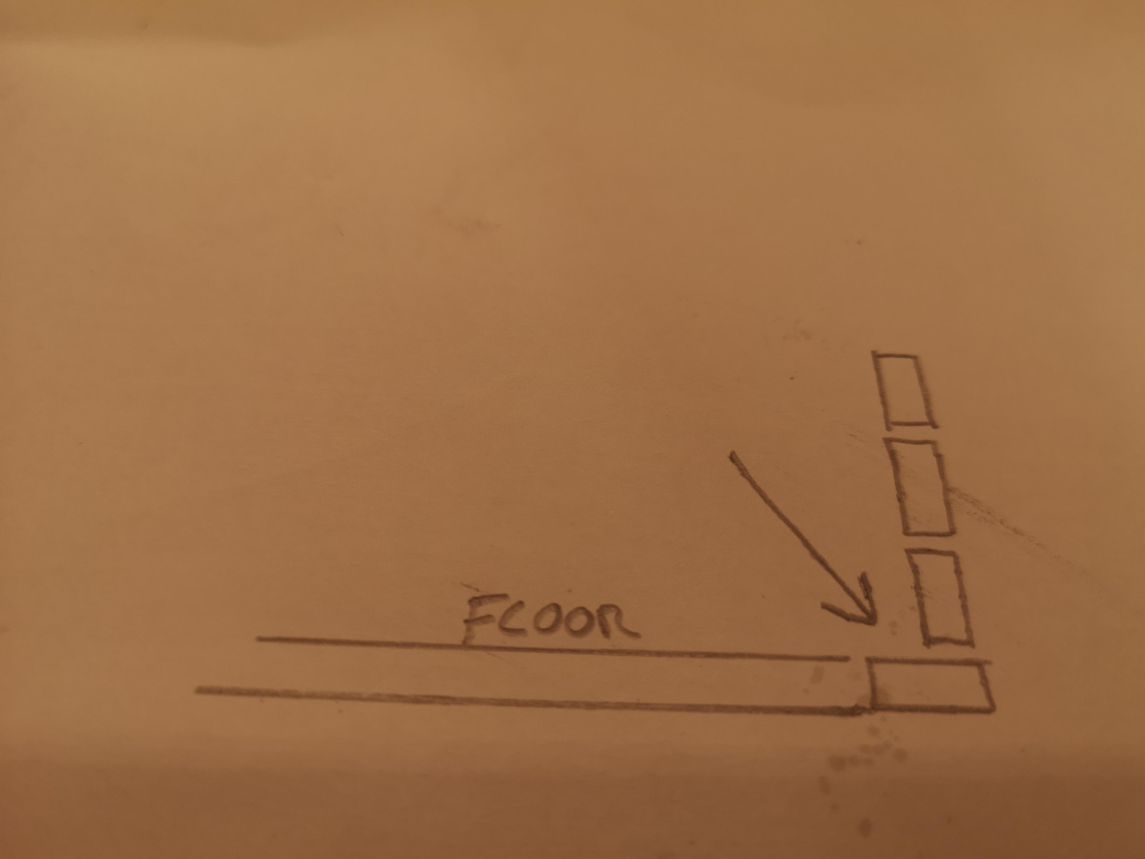

Sorry, I meant if the bottom block was on its side, and then the upright blocks were on the edge of the bottom blocks. You would see half the bottom block where the arrow is pointing... -
