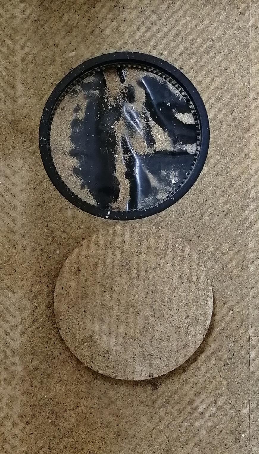

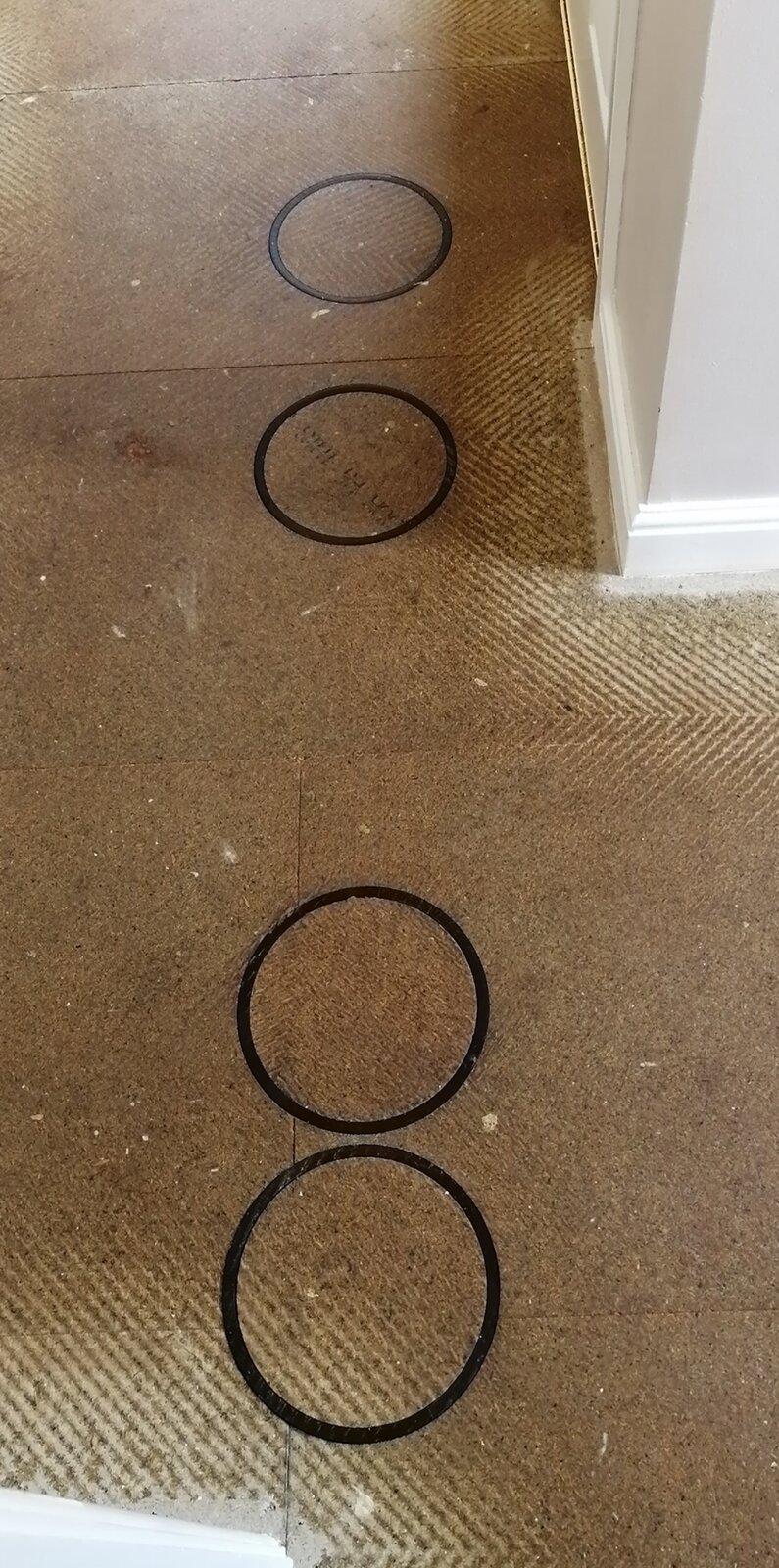

  3. There are no air bricks around the property, so I'm assuming there is a concrete floor below the wood. The floor is suspended as I can feel slight movement, plus it has dropped by a few mm where one of the inspection covers was routed out across the T&G leaving a weak spot that gives slightly. I will do as you suggest and cut the membrane to see what lurks below. Was this a usual method of construction 20 years ago?
  4. Hi, I have a bungalow that was built in 2001. When I recently pulled the carpets up I noticed a series of routed inspection covers under which appears a damp membrane covering... 'heating pipe junctions'?. I don't want to cut the membrane if I can help it; however, would there be a concrete base and some form of insulation underneath the wooden subfloor? I'm trying to understand the construction method.
