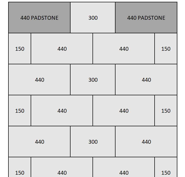

Thanks Radian and Temp, both look a better layout than my diagram. The only observation I have on Temp's layout would be that a 440 padstone would then sit directly on top of a 440 block (ie not staggered) - is it ok to do that? Cheers -

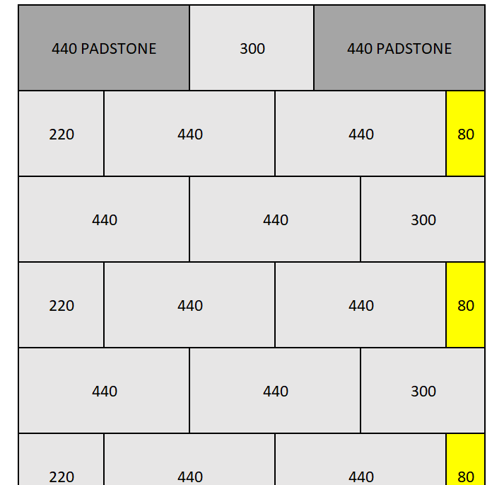

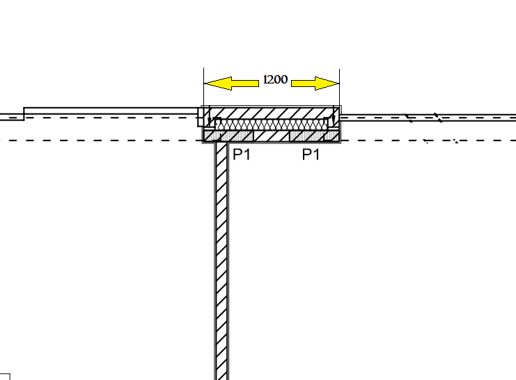

Hopefully attached images will help describe it - as part of a rear extension there are two adjacent rooms each with sliding patio doors and between the doors is 1200mm wide wall (with padstones at the top to support steels above the patio doors). Construction is 440mm blocks. So, 440+440+300 (plus mortar joints) would be the 1200mm, but the next course would then leave a 70mm piece at the end (220+440+440+70 plus mortar joints = 1200mm). My question is, is it ok to have a 70mm piece at the end, or is there a better layout? Many thanks for any input!
