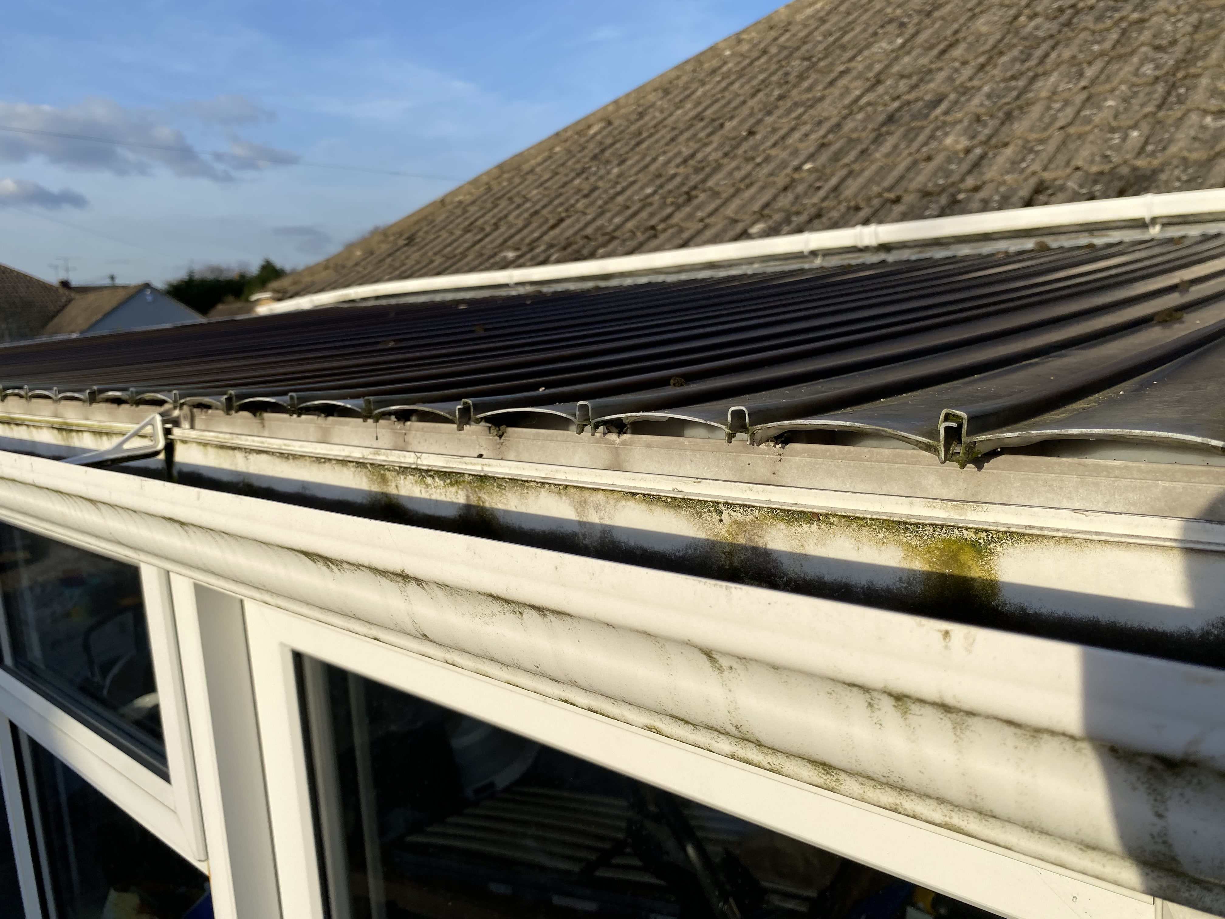

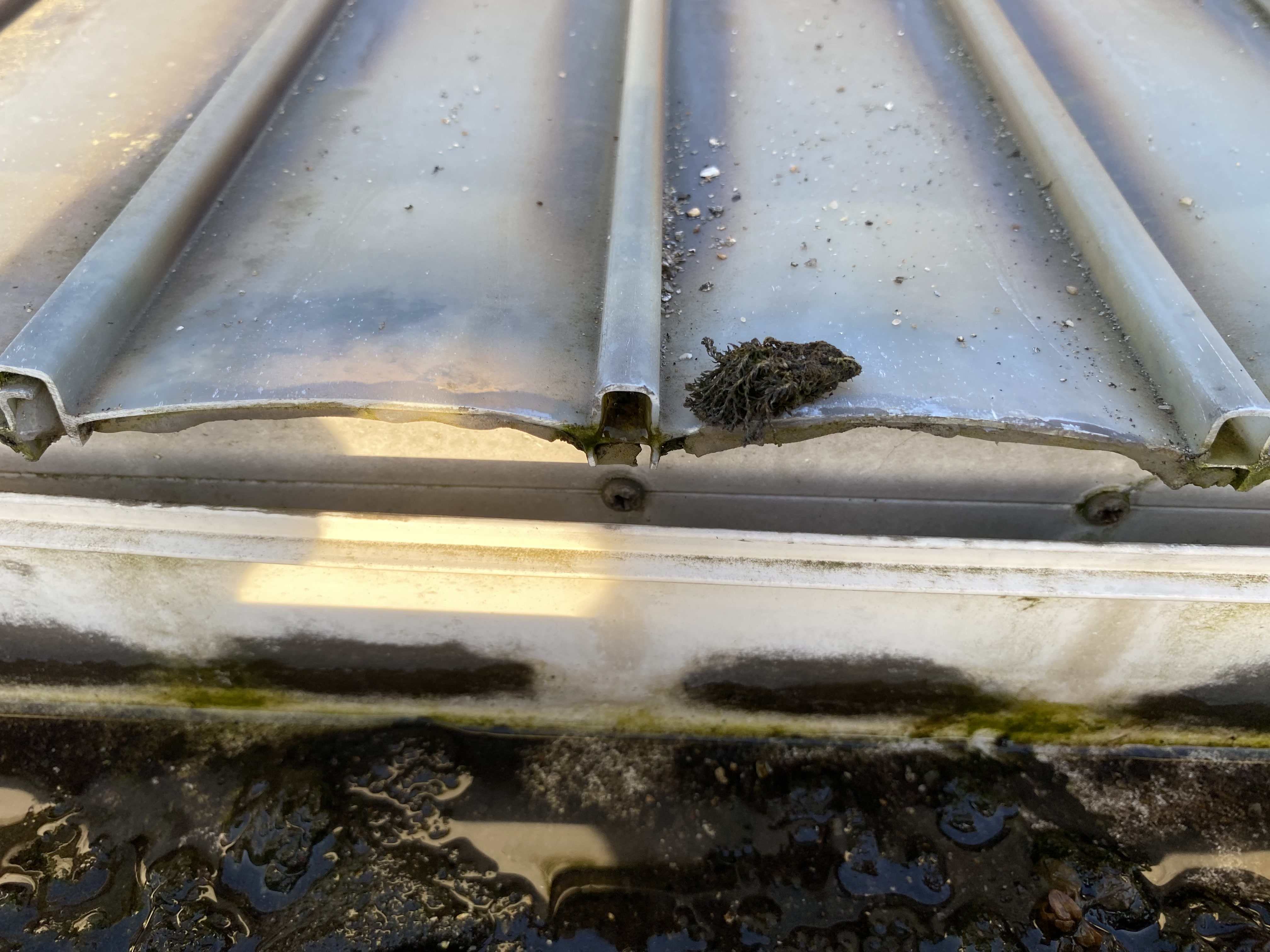

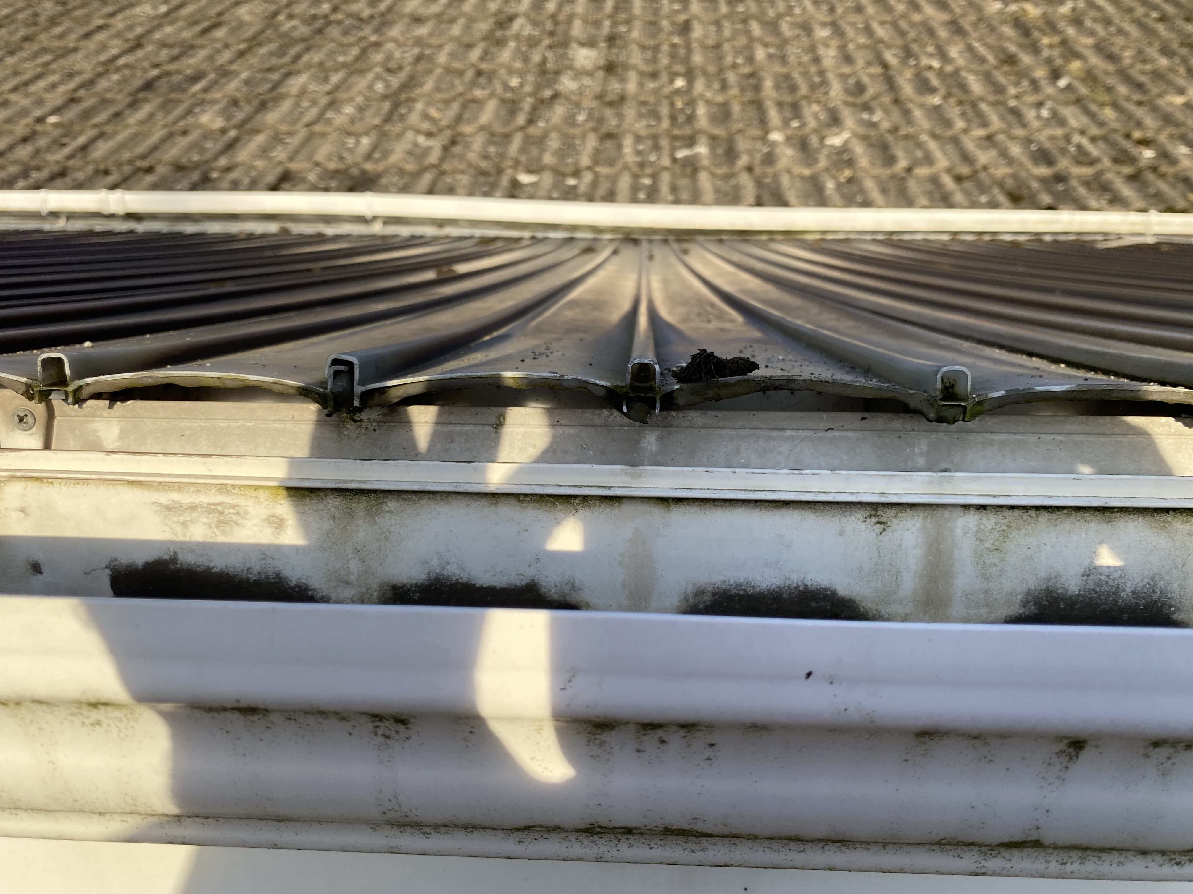

Hi there, I am having issues with water bypassing the gutter and running down the windows on my conservatory rather than flowing into the gutter, the water will flow under back towards the conservatory wall, I imagine someone tried to use mastic before. I do not know how to approach bridging the gap so the water flows into the gutter taking the shape of the panels into account. A roofer came and suggest lead flashing with mastic, but not sure if that could all be bent easily and how that would work, on the underside of the roof? thanks A

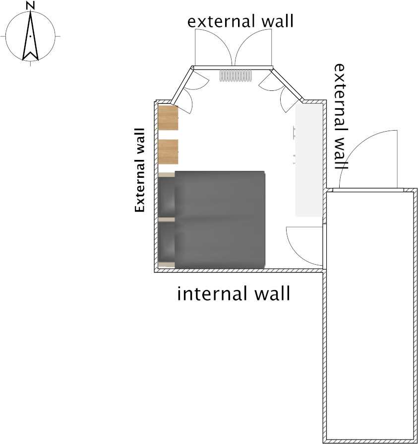

Hi there, haven't been on here in a while, essentially I found out that two of my bedside tables were against an external facing wall and have mould behind them on the mdc board. I am worried that there is also mould behind my wardrobe now, as there is some dark patches behind the boxes above the ward robe. This is the current master bedroom, with two and a half external facing walls (one wall is half external and half internal). I think there are few issues causing the mould one is the lack of proper ventilation, however, I didn't expect mould behind the two small bedside cabinets. Hence I am wondering if there is something else going on. Bed had to be moved to current location as had a baby recently. I previously had in another room a issue where the dpm not doing its role as render was bridging the floor to the wall bypassing the dpm, I chased all walls but for whatever reason wife stopped me doing these walls, when we were doing the renovations. I have to inspect and remove the skirting boards and do a chase, however, the main question post chase is, how can I improve the ventilation to reduce risk of future moulds. currently the walls can be wiped, its just small very minor patches.

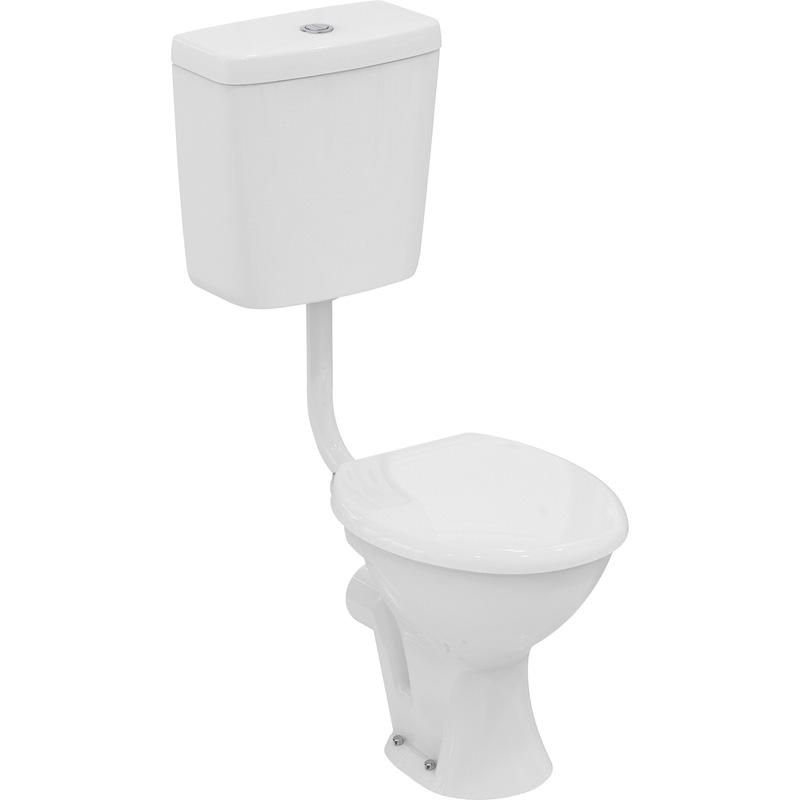

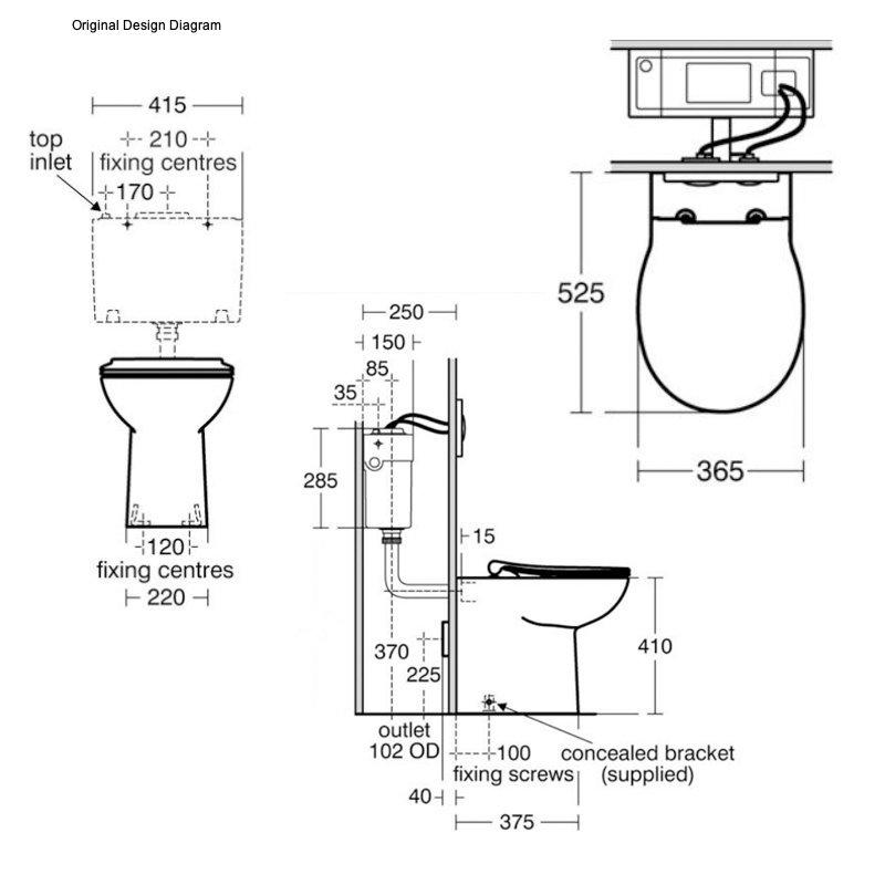

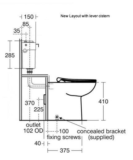

I currently have a twyford low level cistern, which is lever flush,I want a rimless back to wall toilet pan instead added to the low level twyford cistern, and I have been looking at the armitage shanks contour 21. I wanted to ask, if an alternative option would be to box in just behind the toilet pan and and have the twyford cistern exposed rather than the whole thing boxed in. see original installation diagram and the new diagram.
I am thinking of asking a plumber to do a hybrid of these two - https://www.travisperkins.co.uk/toilets/twyford-cc1132wh-classic-low-level-toilet-pan-p-trap/p/793388 https://www.screwfix.com/p/thomas-dudley-ltd-acclaim-side-inlet-dual-flush-lever-cistern-9ltr/4047f it May look cr*p, but better than having residual cr*p…
do you have a button flush or lever system?
@ToughButterCup 😅😂😂. Not sure he is familiar with modernisation of British plumbing though, case and point! Back to topic better to an armitage shanks sandringham 21 any good? They appear in every industrial site that I know? Or any other preferred brands?
Thanks @ProDave, Are there any non water saving toilets/flushing mechanisms out there? I have set the water in the cistern to the maximum. It can’t have anymore.
Hello, I have been having problems with my toilet in my cloakroom. It never empties waste completely, after having the house renovated, this room was the one left. The issue was also present in the previous toilet as well. My “Throne” pictures with a flushing video. firstly the toilet does flush only from the back in the pan, and poo is still present requiring a second flushing. There is no overflow of the bowl. the inlet and flush mechanism have been set to the maximum amount of water of 6 litres. when I redid the room, it was carpeted before, so I levelled the floor used a bal flexbone and then layed the tiles. There was a height difference between the waste outlet and the waste pipe, so I cut the cast iron waste pipe closest to the wall, used a 40mm offset pan connector with a pan connector extension. I bought this combi basin toiled with pan (from eBay) as I didn’t want a new hole for the basin’s dirty water. Basin works fine, toilet doesn’t. I have bought a Dudley duodlush instead as well but haven’t changed it yet. I asked a plumber for a quote for having the job done, he said that he would want to cut the metal pipe from the outside change the height/angle that will reduce weird angles with the pan connector. The waste pipe is outside and goes 7/8 feet high. He won’t remove the whole, but cut parts for the plastic waste pipes. I am happy with that bit. i want to box in the pipes in the bottom but want the pan to be changed to a better one, was thinking armitage shanks or twyford with a P trap. And have a my current cistern connect to them with a cistern pipe that goes into the pan from the back. Something like this but changing the cistern to mine. he is suggesting to get a complete new combi toilet basin. I don’t want to spend £300 additional on a new toilet on top of the work. suggestions?

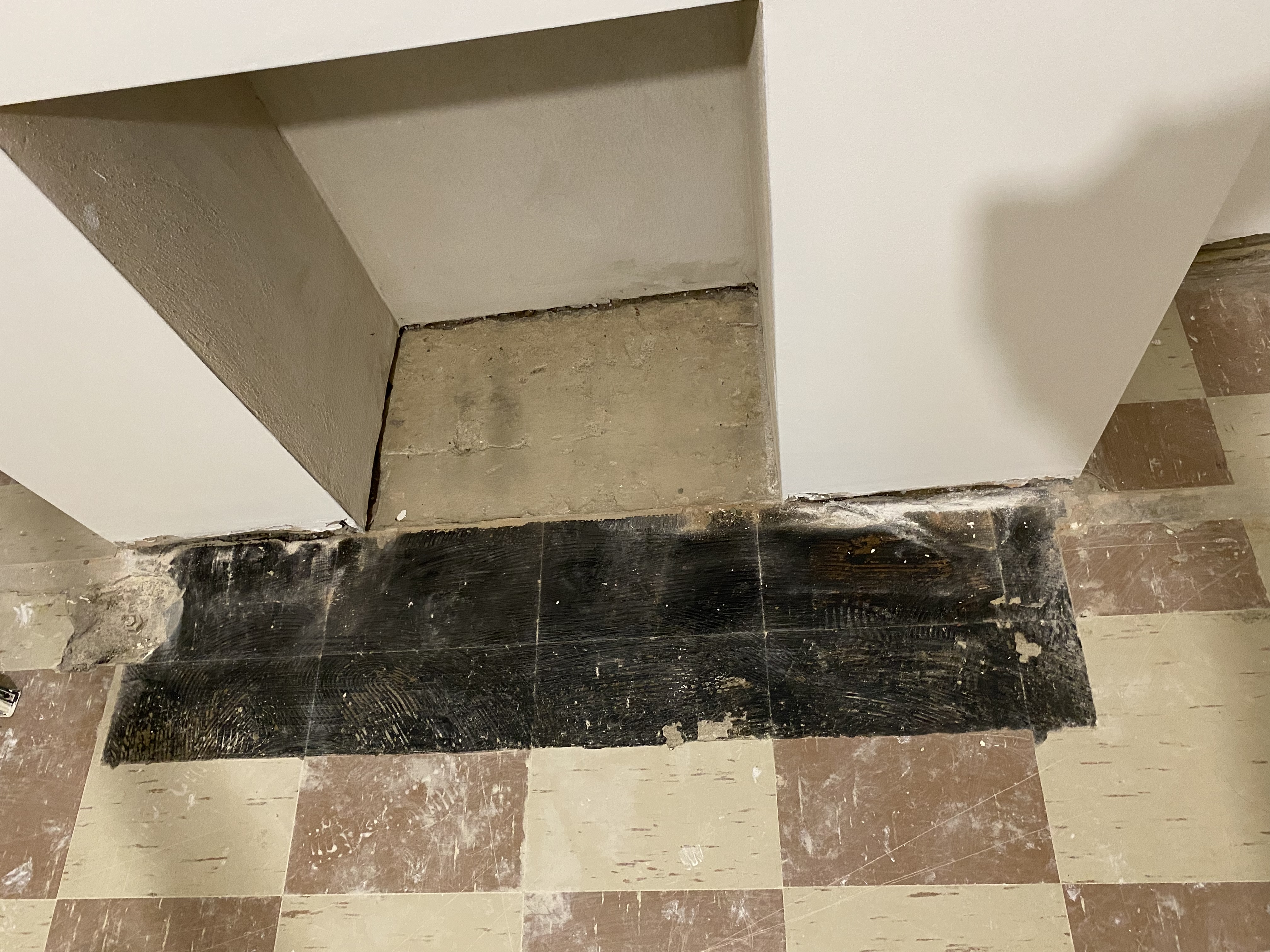

What to cover bitumen DPC so I can have a hearth on top?
agamemnon replied to agamemnon's topic in General Flooring
The hearth is quartzite. Just an inch off from chimney sides. Two separate pieces. One for the wood burner and the other in front of the fireplace. Covering the bitumen area. -
The problem overall was the render bridging the bricks above dpm with below dpm and the concrete floor. 1” wide chase along the walls solved the issue.
We are having a wood burner installed, the floor has Marley tiles as dpm, they were removed were the hearth will go, exposing bitumen. (Marley tiles did not contain asbeston, but bitumen wasn’t checked). What can I do to not having to screed over the whole living room, but make hearth stick to the floor? Everywhere else will have a plastic dpc, xps and then laminate flooring.

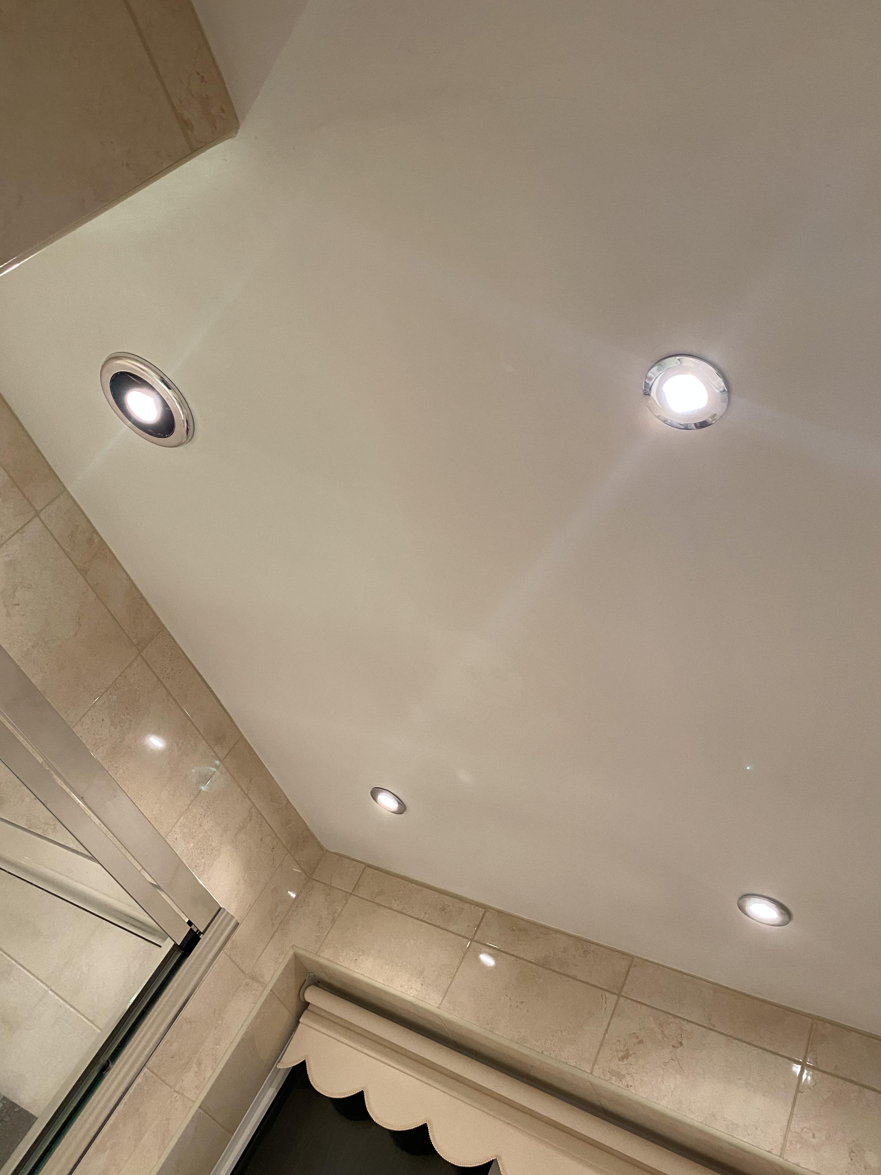

Hi there, I am becoming interested in making our house airtight. I am looking at dmev but we have a fan with a light in the bathroom and would like to replace with a dmev, I don’t want to impact the light loop while also not making the room darker. Suggestions in how to replace the fan with dmev and keep the room bright enough. The fan is above the shower cubicle.
