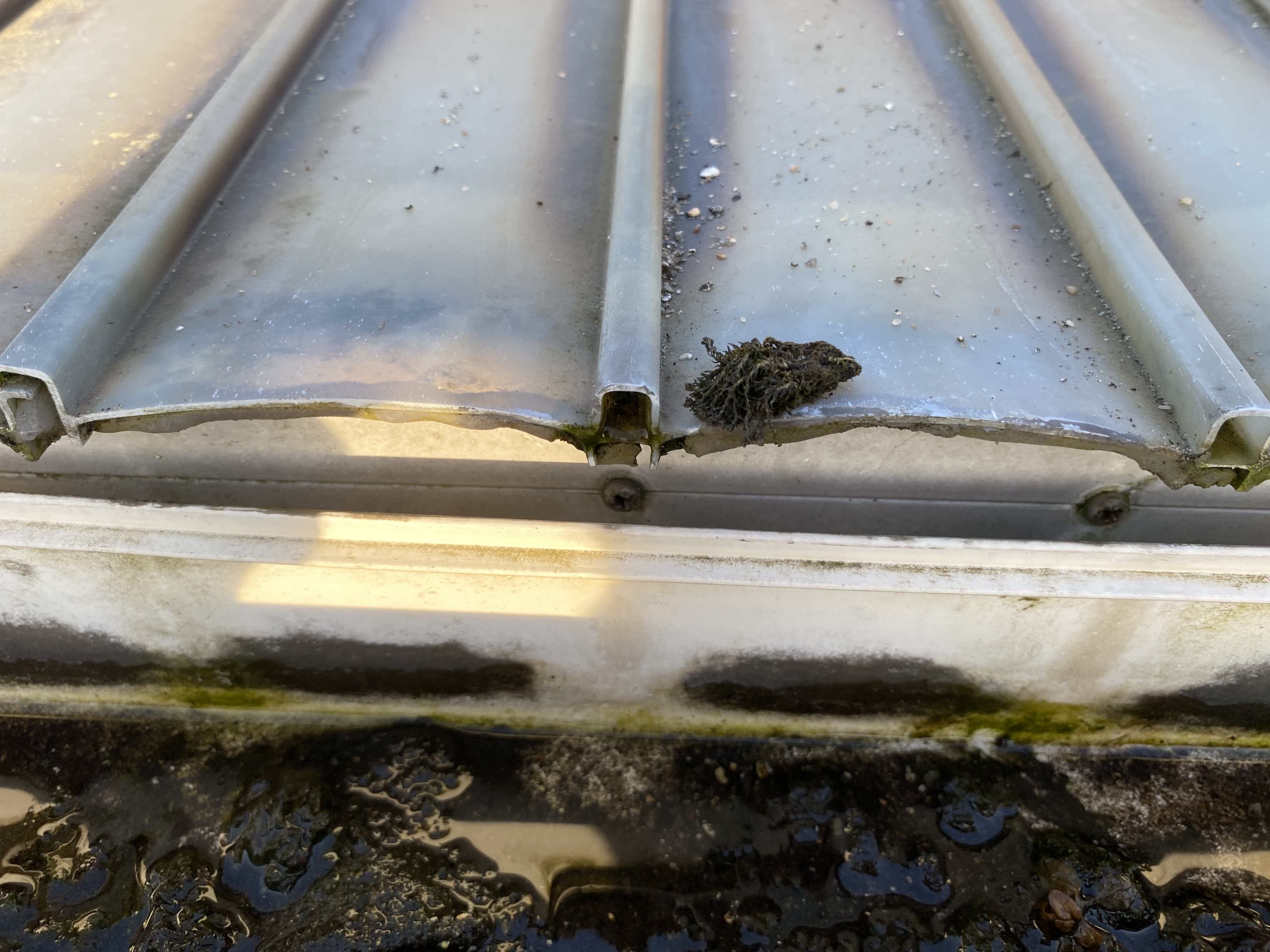

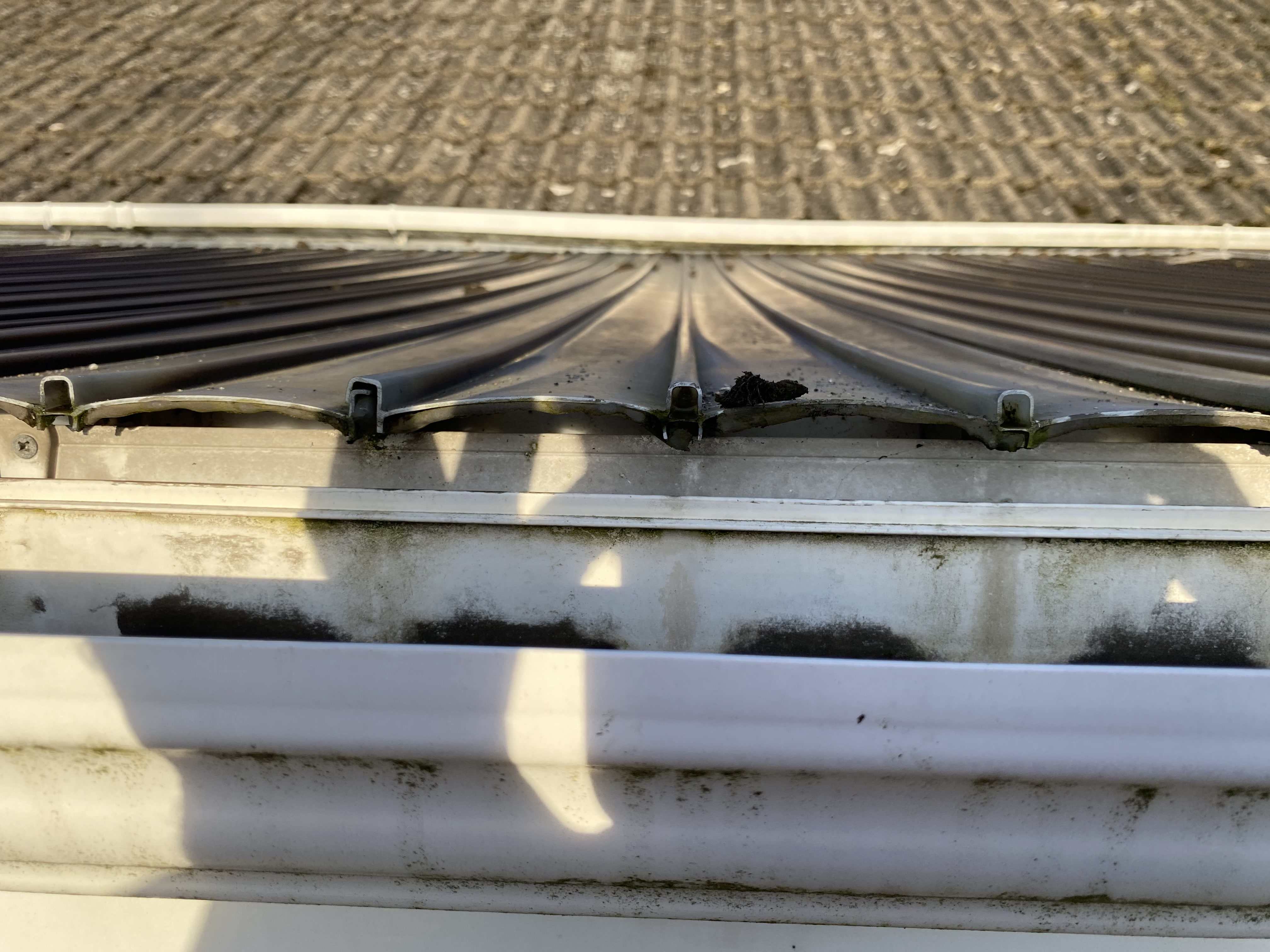

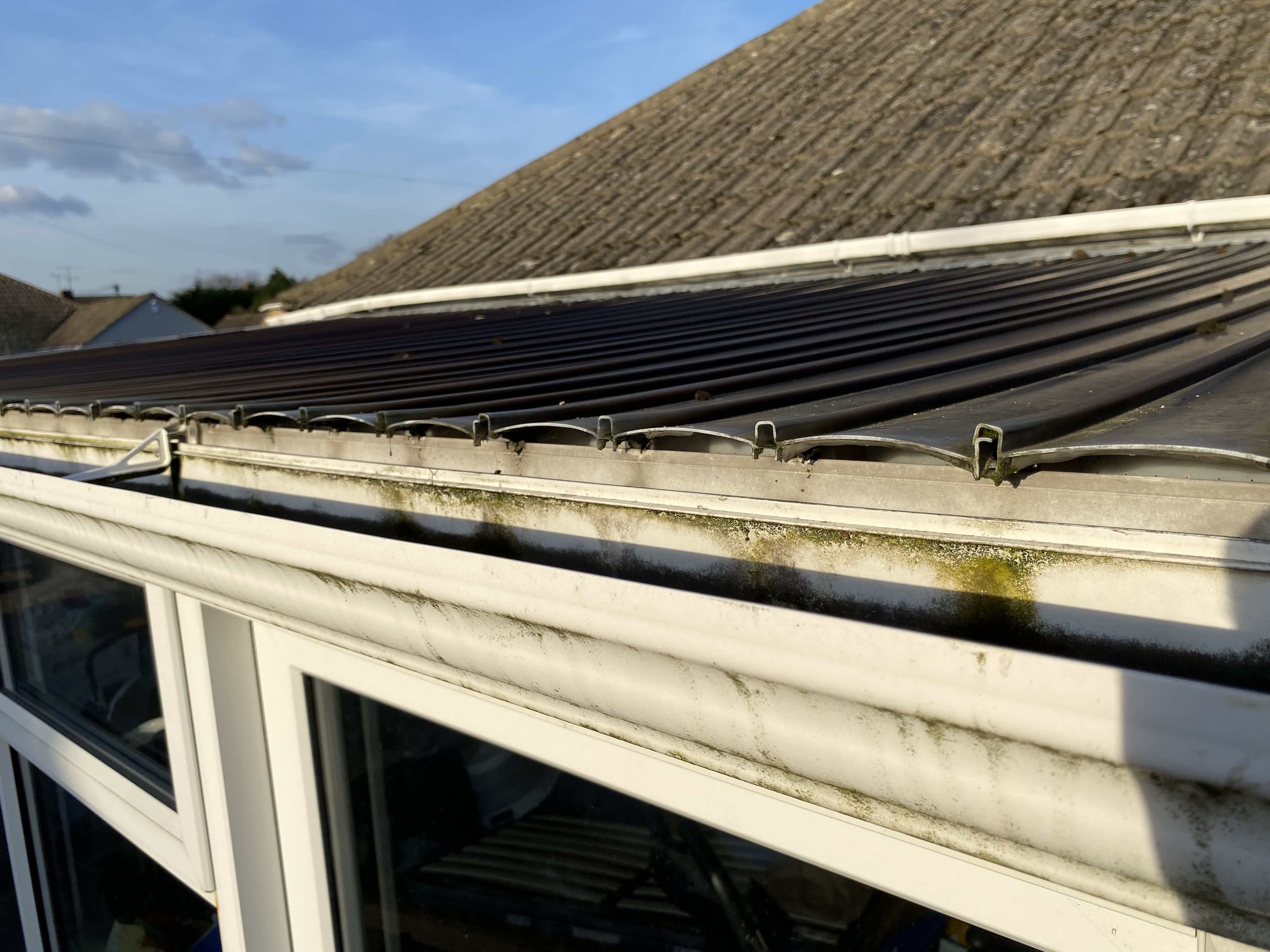

Hi there, I am having issues with water bypassing the gutter and running down the windows on my conservatory rather than flowing into the gutter, the water will flow under back towards the conservatory wall, I imagine someone tried to use mastic before. I do not know how to approach bridging the gap so the water flows into the gutter taking the shape of the panels into account. A roofer came and suggest lead flashing with mastic, but not sure if that could all be bent easily and how that would work, on the underside of the roof? thanks A
