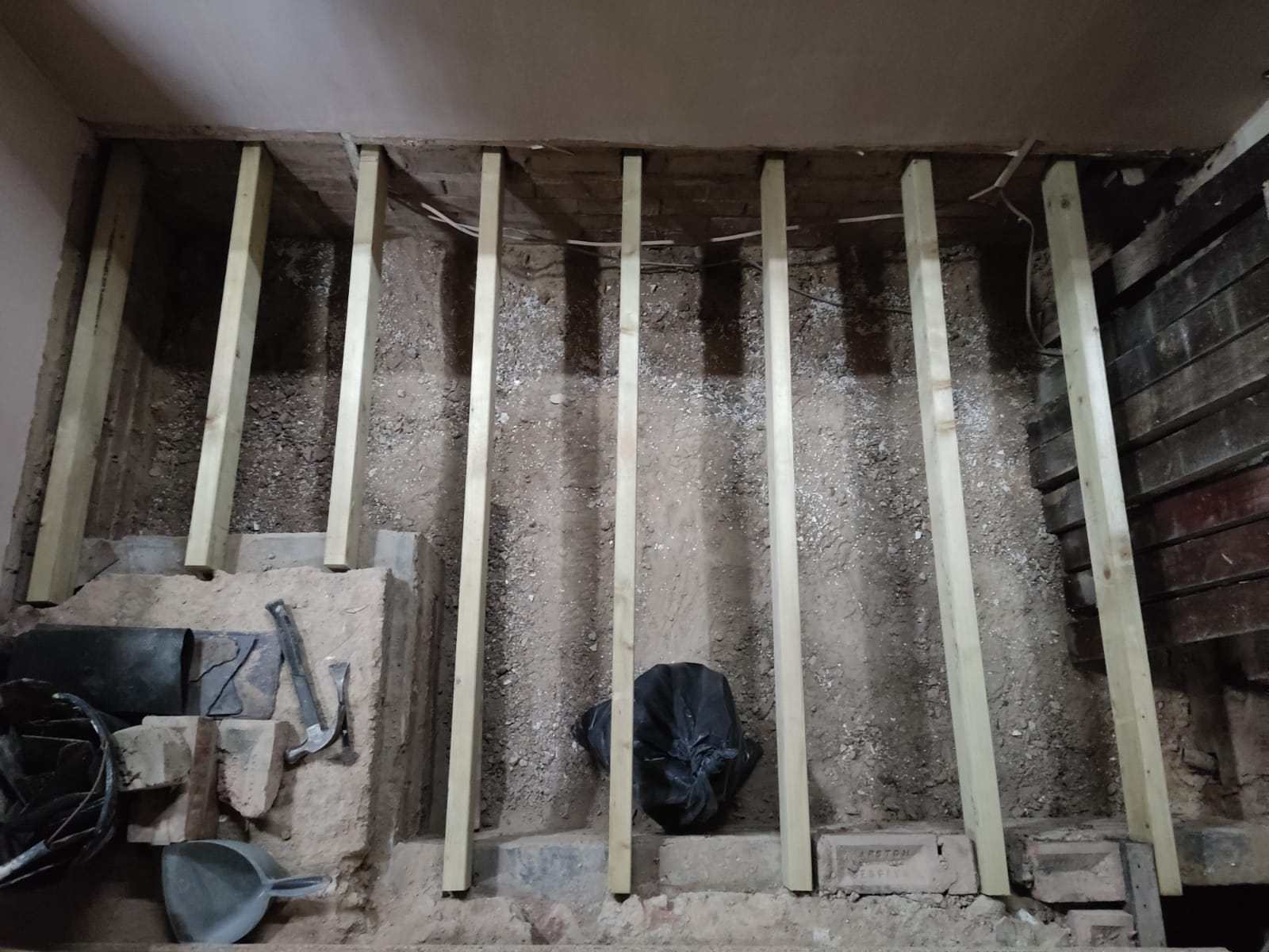

  3. Thanks, that makes sense. So the laser level is set to the highest point of the existing joists I assume. The only problem I'll have is the very right hand joist against the wall, which has plumbing pipes attached to it. I guess I could cut the new joist close to it and then restart it after the pipes again.
  4. Thanks Nick, So - level them all up to the current highest point, I have a laser I can use Sister them to the old joists (I guess the new ones could also rest on the low wall and concrete pad with shims) So I'd probably need to buy another 11 4x2's Not too sure about what you mean by "screw the very end of the new timbers alongside the original". Do you mean at the external wall end, put them hard up against the wall? I did look for hangers as well to support them on that wall next to the old ones, but can't really see an option for a sistered 4x2. I guess then the other smaller section of suspended floor would have to match. What if the wall pockets don't allow the joists to go any higher? Do I dig the pocket out more?

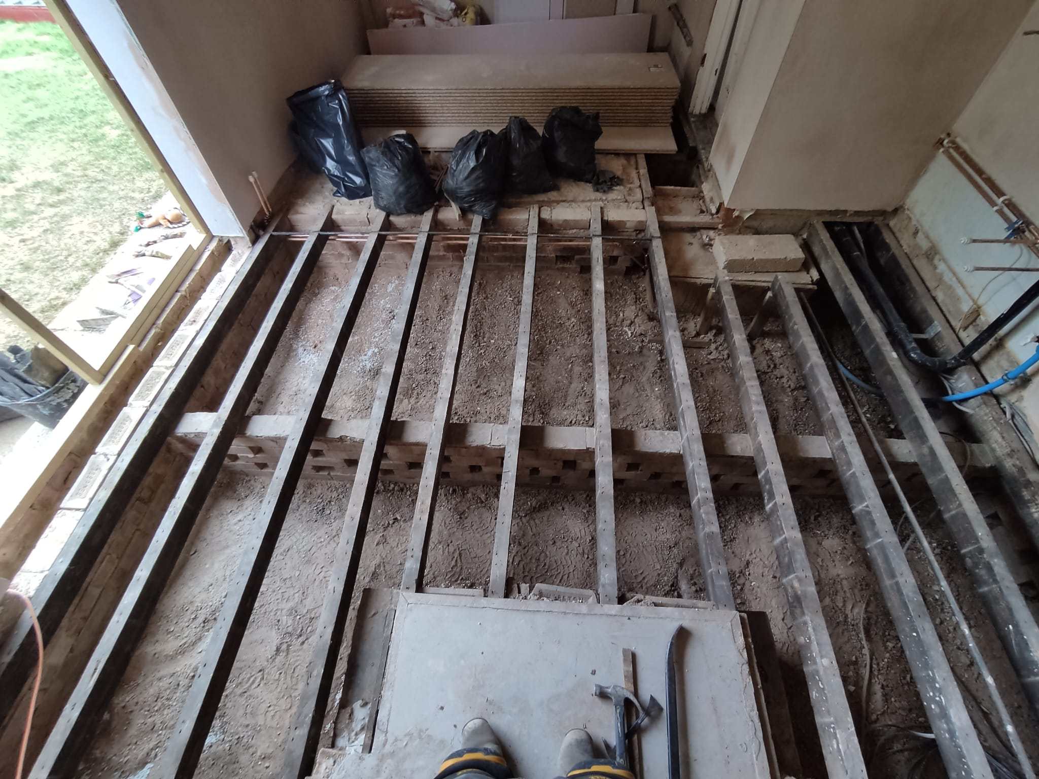

  5. Hi all, bit of background on my house/floor - 1930's detached. Suspended timber floor (100 x 50mm) on either side of a concrete pad which used to hold a wall up and old oven. I've removed and replaced (with 95x45mm C24) all the joists on the smaller section of the suspended floor as they had woodworm, and checked and treated the other side. I think the woods ok, but trying to work out how to level both sides has got me scratching my head a bit. I've bought some u shims I was going to use on the smaller side, but on the bigger side some joists are 10mm different in height to the next one, and they're wedged into the wall pockets pretty well, so hard to adjust. I was thinking to use the heavier grey blocks (trimmed down) in between the new joists, mortared in, instead of the old bricks. Was also going to paint the joist ends in black jack to seal them. Also going to whack some noggins in between all joists about 600mm apart for rigidity. But the first step will be levelling it all, or rather, making it flat. Do I first go and record the heights of all the joists? Do I not worry too much and use self levelling compound over the subfloor (22mm moisture resistant chipboard 2400x600 with NoMorePly 1200x600 6mm sheets on top)? Do I sister the lower joists? Not sure how flat it all needs to be for the eventual tiles to go on top. Any ideas or process you normally follow would be mighty helpful.
