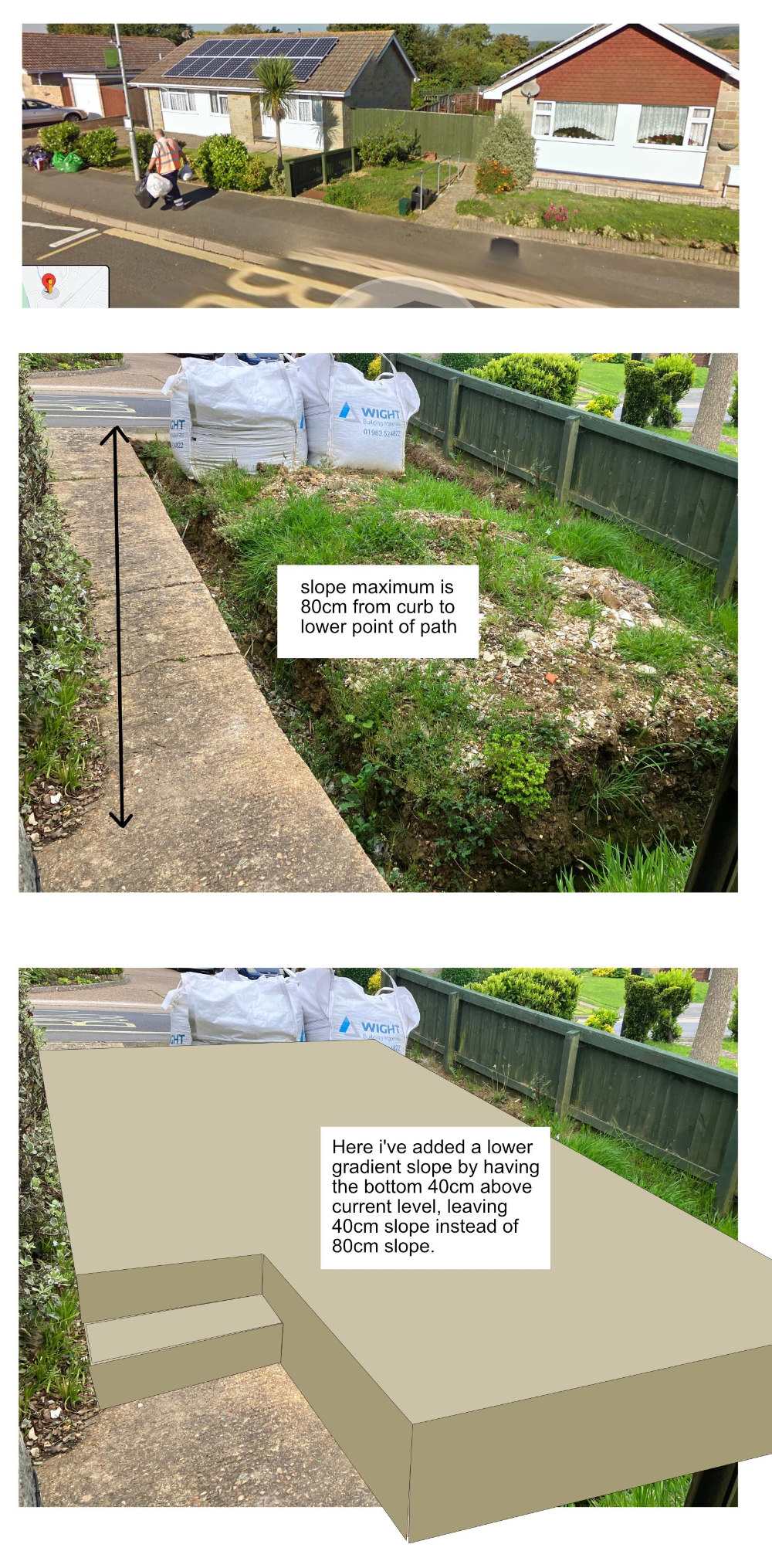

  1. Hi, I'm planning on converting the front garden to a driveway. It's too steep so I'd make a retaining wall (either doing it myself or paying). However, to make things easy, I was thinking of preparing the ground by excavating it to a much lower level, possibly flat so it's easier to work on. I can do this by micro digger, or ask a grabber truck to get most of the soil roadside. Then it will be easier to do footings for retaining wall. I've attached a photo with mockup. I'd really appreciate someone experienced in this to give me some steps for preperation. The driveway is 3.4m wide by 5.5m length, height gradient from curb to back is 0.8m, which I was going to reduce to about 0.4m Thanks.
  2. I won't have an issue with planning permission as it is going to be sloped toward my house. I also have grass behind it.

  6. there's an existing drop curb and that's beside the road. The mockup shows a small 20cm step.

  10. Hi, As shown, I have a driveway (including left path) is 5.5m length x 3.4m width and 80cm height from curb to bottom. I'm planning to level it a bit more so the incline is less, as shown, and using the full width, including current path. I'm not sure how they would achieve this. However, to save money, how should I prepare it? Thanks.

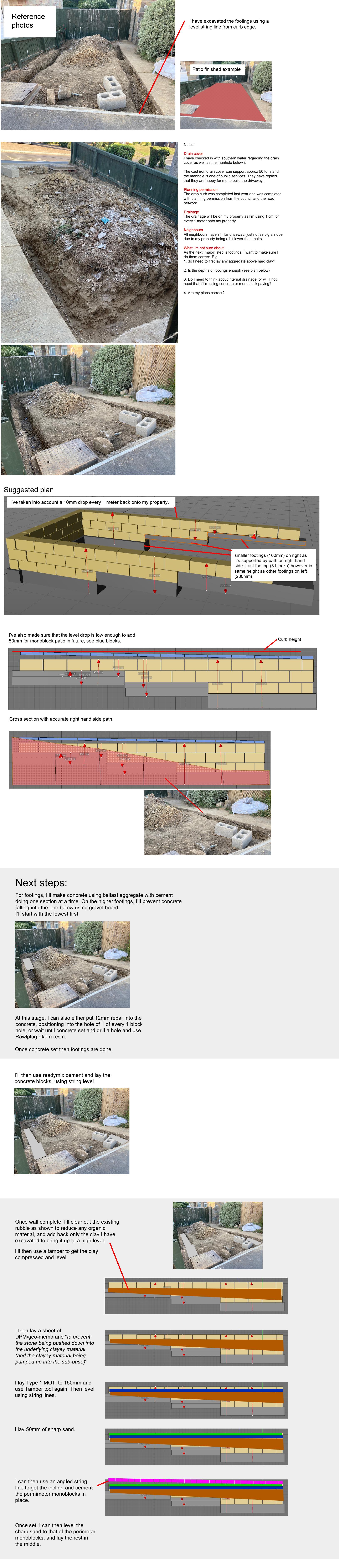

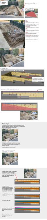

  13. Hi, I have a sloped front unused garden that I'm planning to convert to a driveway. The drop kerb has been approved. However I would like someone in this field of landscaping/construction to check my plans. I'm not going to hold anyone to their word, I am new to this and I want to know what someone would usually do. Link: https://ibb.co/P6LGLM4 My main concern currently is the footing requirements, as that's the first step. Basic stats from the link: - length 5.7m x width 2.7m - Using hollow concrete blocks 415mm x 215mm x 215mm - Footings 280mm depth x 330 width - Using 12mm rebar in the footings to line up with holes in hollow bricks, which I'll then fill with concrete I'm confident in making the wall itself, but not sure about footings (most important part I think). Thanks.
  14. Hi, I'm new to construction, so I've sought advice from a few people and resources online. I'd really appreciate someone to have a quick look to see if my plans are ok, or need adjusting. Sorry if a lot of this stuff is basic, but I didn't want to assume anything. As well as checking over plans, I'm not sure of: 1. Do I need to first lay any aggregate above (very hard, dry) clay? 2. Is the depths of footings enough (see plan) 3. Do I need to think about internal drainage, or will I not need that if I’m using concrete or monoblock paving? Thanks a lot.
