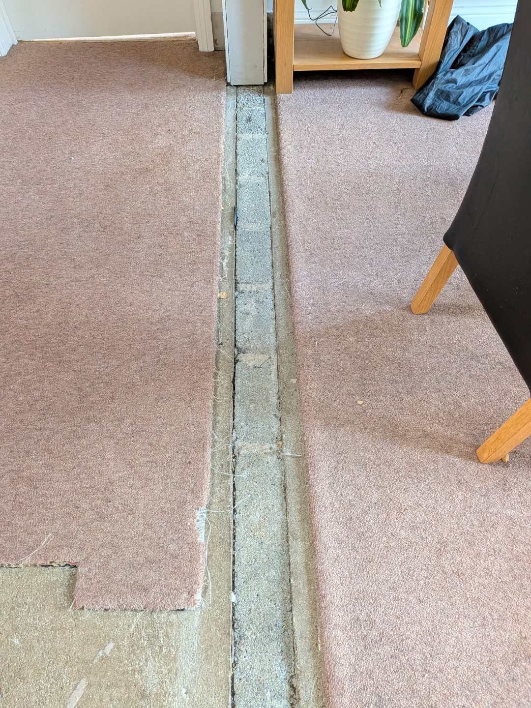

  1. I'm wondering if I might actually be wrong.... In trying to figure the situation out, I've been watching lots of videos about block and beam floors. In every case it seems that a DPC is placed underneath the beams themselves. So, I might be worrying about nothing. If that's the case though, I can't understand why there was an additional DPC at screed level for the internal walls. This is the same height as the DPC visible on my exterior walls. Maybe a DPC was applied to the internal walls out of an abundance of caution? Am I talking rubbish?

  3. After a bit of advice following a knock through... As you'd expect, there was a DPC atop those concrete blocks in my picture, now removed along with the wall. Next step is making good and I was planning to put a latex compound down to smooth/sort out slight level differences. BUT, without the DPC, I worry about the risk of moisture ingress via capillary action. It's a block and beam floor and those concrete blocks are ultimately in ground contact. What's the most practical way to resolve the risk?

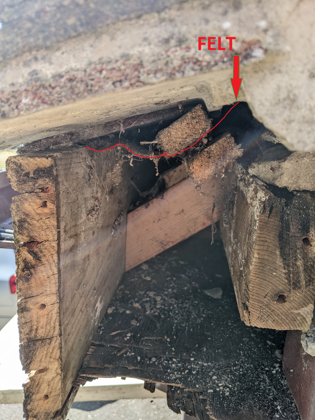

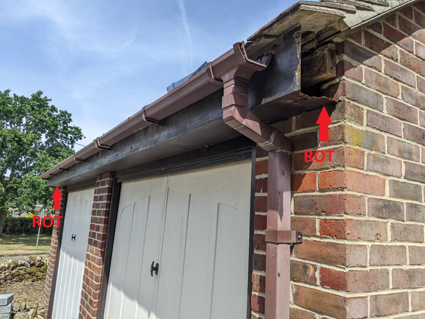

  4. Hi all, First post here as a DIYer, hoping I might get some feedback on an issue I’ve noticed with my garage roof and my proposal for putting it right… Recently moved to a new place with a detached double garage. Currently, soffits look to be 5mm ply and fascias 22mm x 210mm with a rebate channel at the bottom to catch the ply soffit. First indication something was wrong was noticing at each gable end, the soffits had rotted (fascia seems sound). It wasn’t immediately obvious where the water was getting in, additionally I wanted to satisfy myself about how the soffits/fascias were attached as I had been half thinking about replacing them with anthracite grey/upvc ones. Now for my laypersons assessment; I decided I’d remove the box end of the fascia and peer in along the eaves. It was here I noticed the roofing felt, instead of passing over the top of the fascia into the gutter, had weathered away and fallen inside. I also think the fascia has been installed too high relative to the last batten. This has created a U shape in the roofing felt, and I would imagine an opportunity for any water that has got in to pond behind the fascia. It would then have the opportunity to move sideways towards the gables until it falls out landing in the soffit; exactly where it’s rotting. My laypersons assessment of what to do about it; As mentioned, I had already been thinking about replacing with UPVC, not something I’ve done before, but given it’s low to the ground and I don’t have to take it up any gables I’m inclined to give it ago. 1. Remove existing Gutters, Fascia, and soffits. 2. Remove first 4 rows of tiles, slide new felt under existing. 3. Install UPVC soffit 4. Install UPVC fascia, attached to rafter ends, 5-10mm lower than existing to reduce kick on eaves course and create continuous slope for felt to gutter. 5. Install new gutter, replace tiles Planning to use something like Eurocell 200x18mm fascia board and 300x9mm soffit. https://www.eurocell.co.uk/fascia-boards/replacement-fascia-18mm/200mm-x-18mm-fascia-board-in-white-x-5m Alternatively, if not replacing with UPVC, do all of the above but just replace rotted out section of ply in soffit and give it a lick of paint. As mentioned, I don’t have any prior experience with roofs or soffits, so would appreciate anyone sanity checking the above or pointing out anything I’ve failed to consider/suggesting a better way. Attached some pics for better explanation. Thanks James
