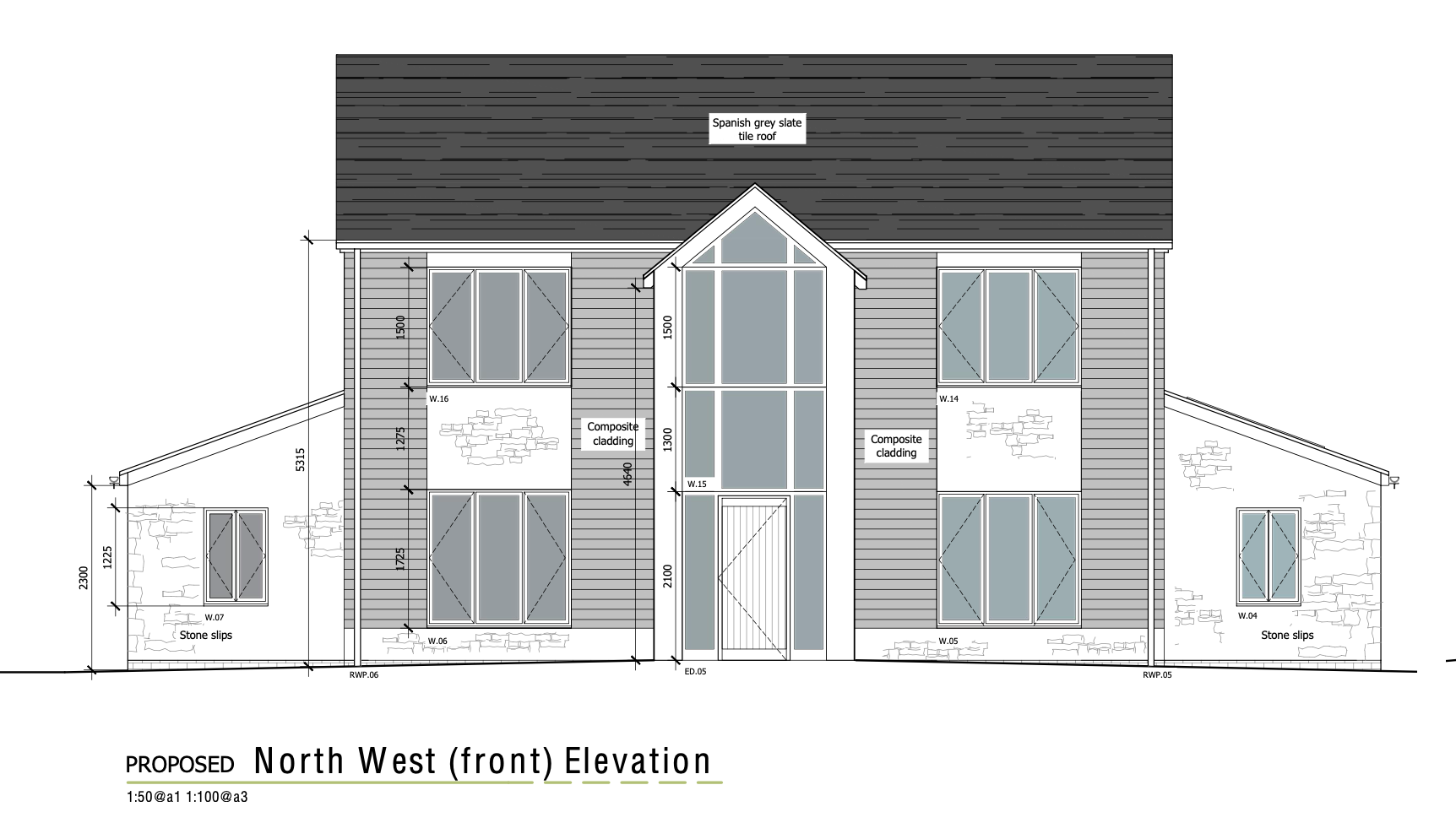

  1. Hi All, I'm about to start the external of my timber frame build which is a mix of Stone and render. Stone sections on 38mm battens, and render on 38mm cross battens. All then covered in 12mm cement board to apply the final finish. I've been racking my brain regarding the fire stops. I'm aware that the 38mm / 76mm timber around openings is sufficient. However, it's the horizontal fire stops that I'm questioning. I've seen some have used intumescent strips top and bottom of the cavity, others one strip between floors. Please could I ask what you have done on your builds? Also, do I need them on the single story side sections, or just the two story? I've attached my elevations for reference. Many thanks appreciate your help. David PL-003 Proposed Elevations.pdf

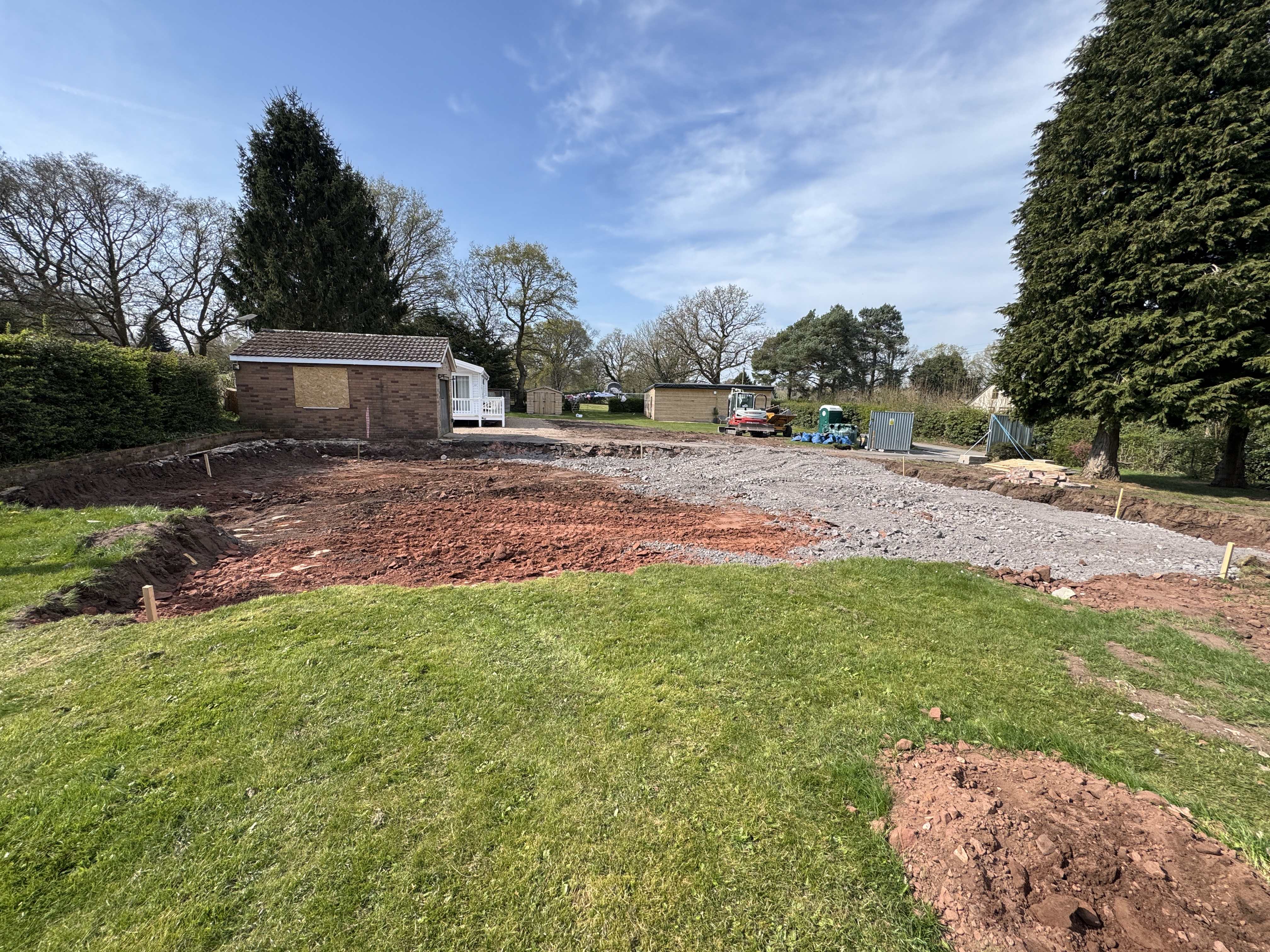

  2. The gravel will be scraped back after the scaffold down

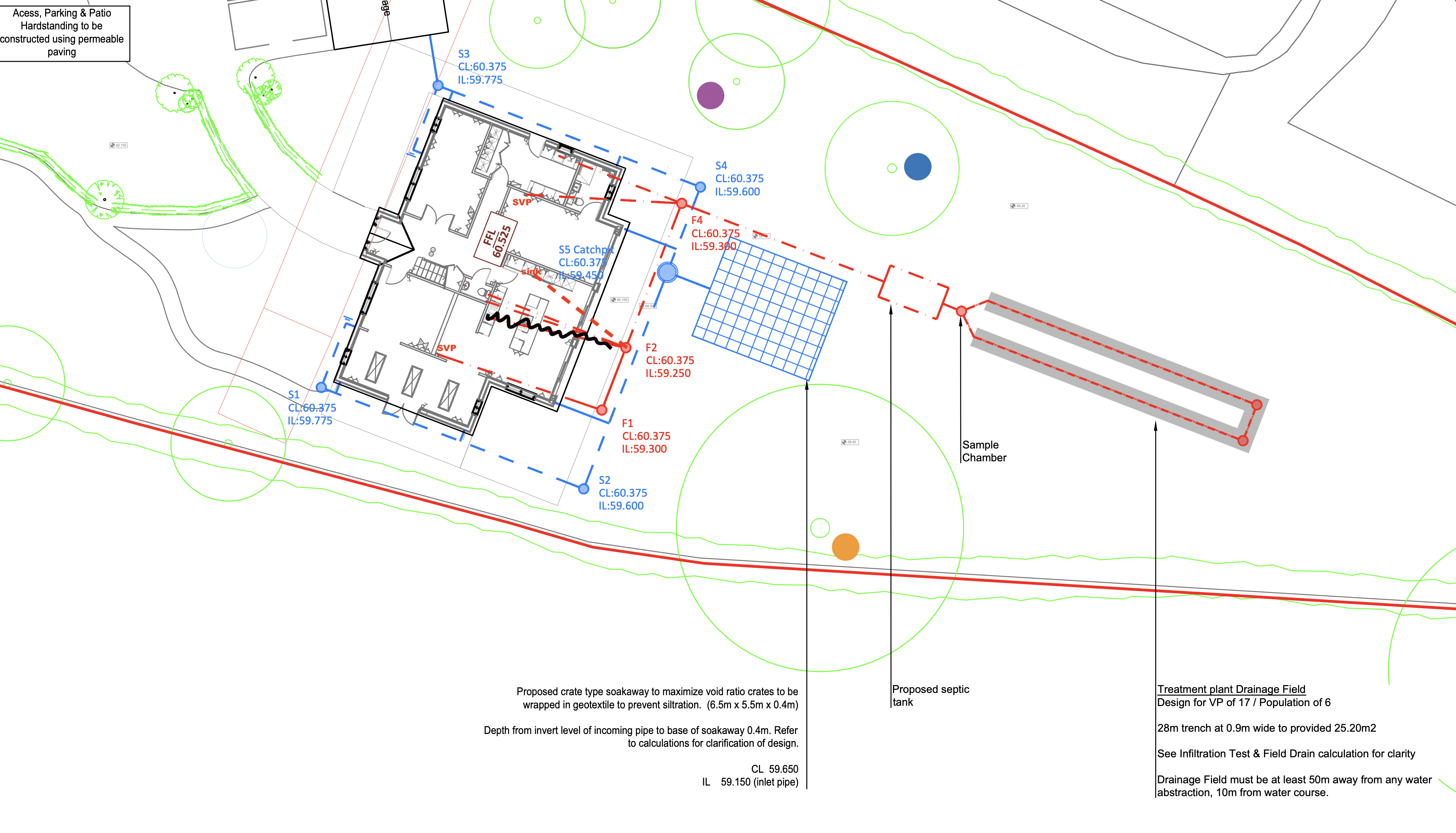

  4. Hi All, I drew myself a plan and laid the drainage. Ready to finish levelling and just need to add the water & electric ducts. When I get to the stage of laying the DPM over the EPS, what's the best practice for laying the DPM around the penetrations? Tape? Liquid DPM? Should I be using foam filler around any gaps too? Is there any recommended EPS friendly foam filler? Appreciate your help guys. Learning on the go! Cheers

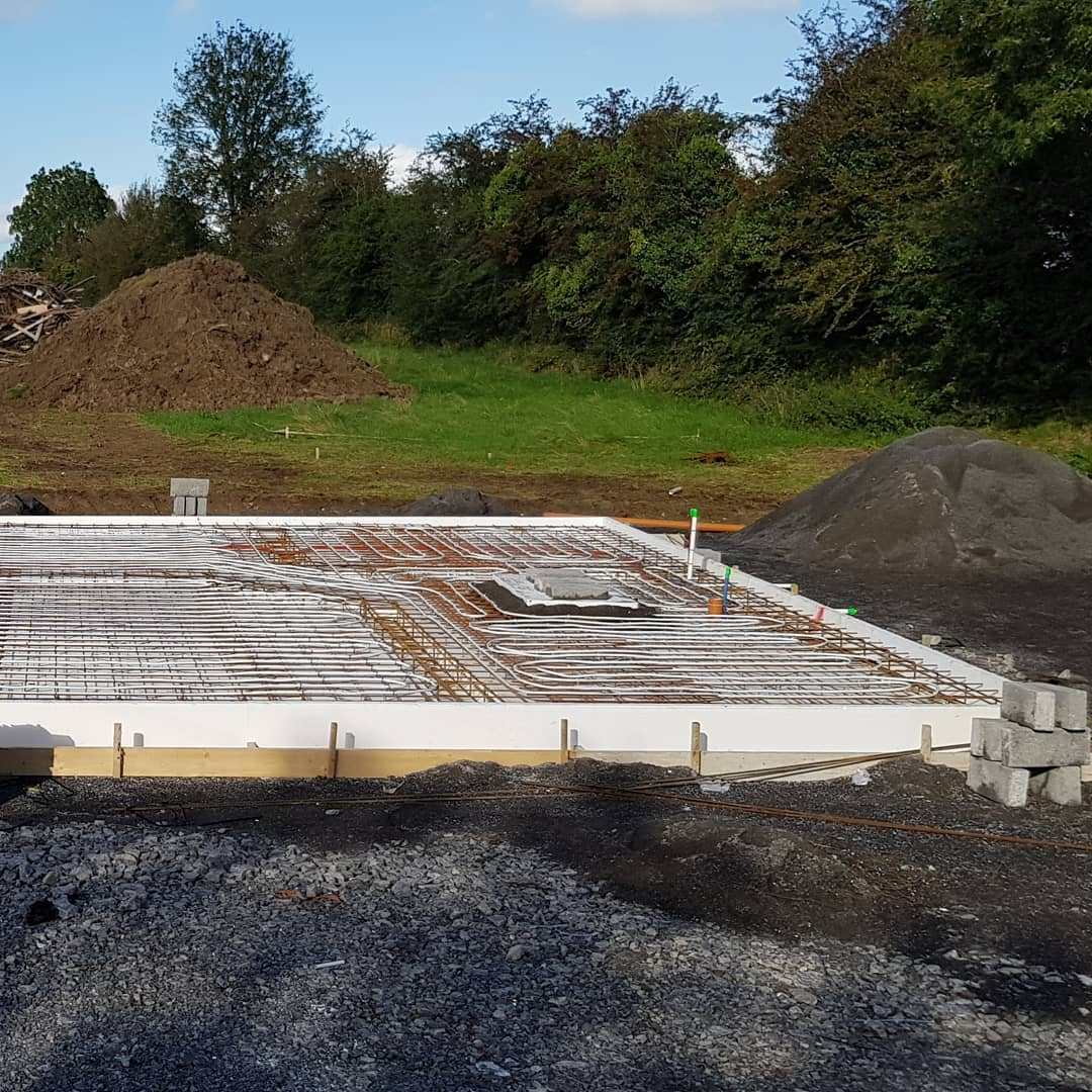

  6. Hi All, About to start our insulated raft foundation in the next 2 weeks. I have an urgent decision to make that I'd appreciate your input. We have 100mm of concrete above the EPS. The original plan was to use clip plates to attach the UFH pipe in, then use 50mm spacers and put the mesh. UFH company have advised that the pipes being 100mm below FFL is too low, and they would recommend putting the mesh in place (50mm spacers) then tie the UFH pipes above the mesh, meaning that there would be 25mm cover to the top of the pipe. What's your thoughts? Screed above isn't an option. Many Thanks

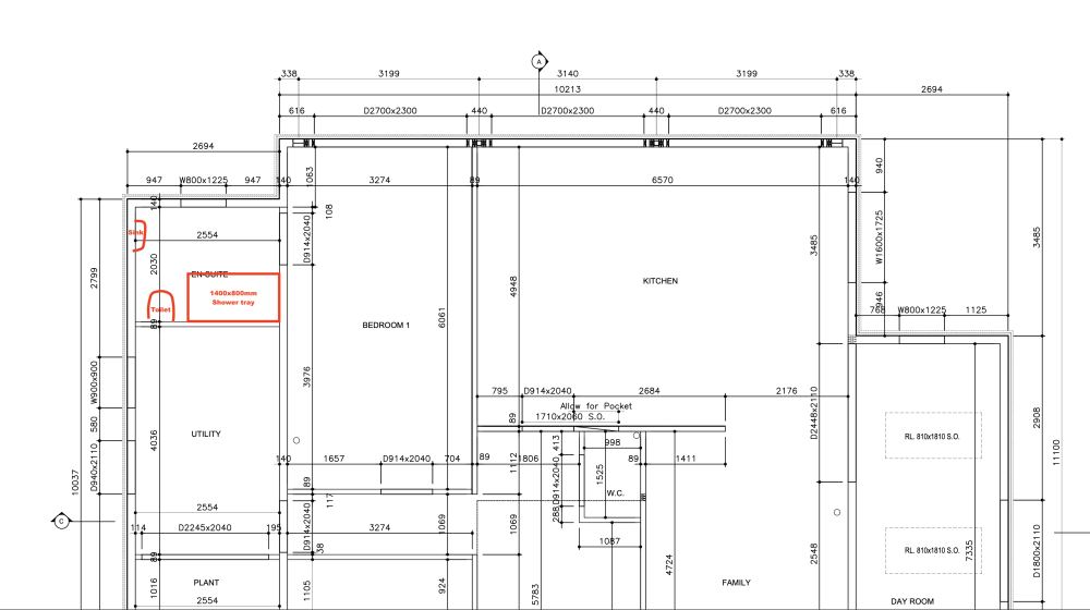

  7. Cheers @Nickfromwales I've just measured out the en-suite and we're looking at having a 1400x800mm shower tray. I'm looking at something like this - Not looking to go flush, but just low profile. https://www.plumbworld.co.uk/hydrolux-low-profile-rectangular-shower-tray-1400-x-800mm-with-waste-19421-1270350 Thanks again
  8. Thanks @Nickfromwales Does the rest of the plan seem to make sense? Would you make any changes?

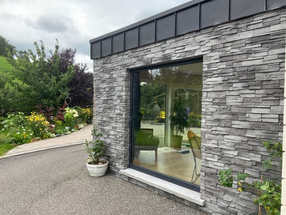

  9. Sorry, I missed this reply. I was planning on having a finish looking similar to this below. With a 225mm cill. The STS board has a 100kg/m2 rating. The stone is 45kg/m2. STS and timber frame co have confirmed with their SE.

  11. Hi all, I'm about to start work on drainage and insulated raft foundation in 2 weeks time. Please could you help with the drainage through the raft foundation? - Is all of the drainage that comes up through the raft 110mm? How far above FFL should they pop up? - Long radius bends with foot at each location? - There are 2 SVP's serving the FF. One serving a Master Bedroom Ensuite and the other Serving 2 en-suites. Do these need to extract through the roof or AAV in the loft? - Downstairs WC, does that need its own AAV? Does this need 2 outlets, one for sink and one for toilet? - Toilet in downstairs en-suite, can that connect to the same run as SVP? - How would you deal with the shower tray in the downstairs en-suite? Any other general advice would be much appreciated too. Cheers! -

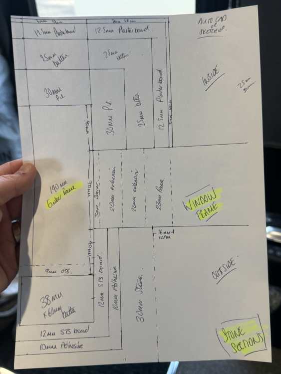

  12. HI All, I've just received planning permission for a replacement dwelling. Timber frame build - 140mm frame + 9mm OSB. Windows are triple glazed aluminium, window company has asked for details on position in frame and how the stone / render will return to the openings. We have 120mm PIR insulation in the frame and a further 30mm internally. Aluminium frames are 70mm. Please could you have a look at the attached sketch? Should I continue the 30mm PIR, 25mm service batten, 12.5mm plasterboard round into the window reveal, OR.. would it be better to say use 52.5mm insulated plasterboard internally straight to the timber frame? Appreciate your help. Also, anyone have any tips on software etc to draw these details? Thanks
