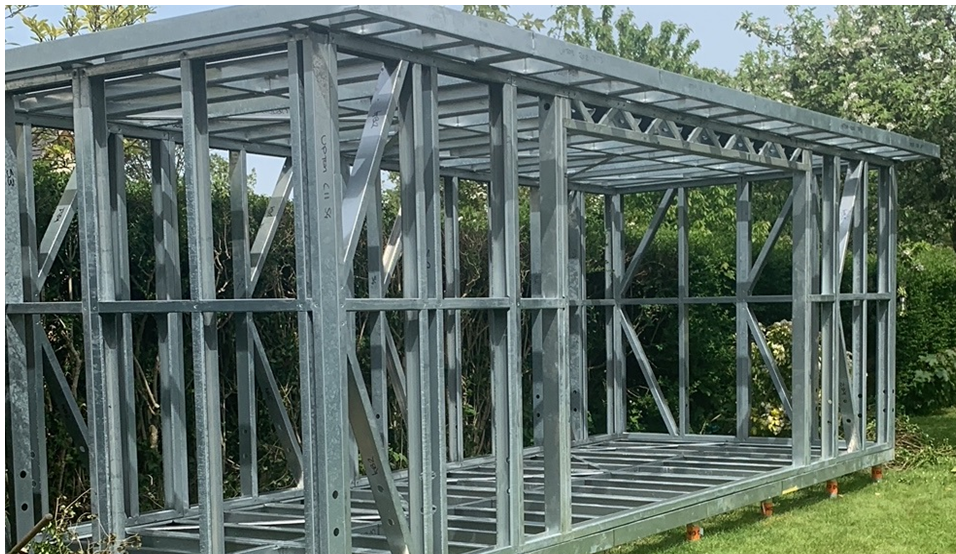

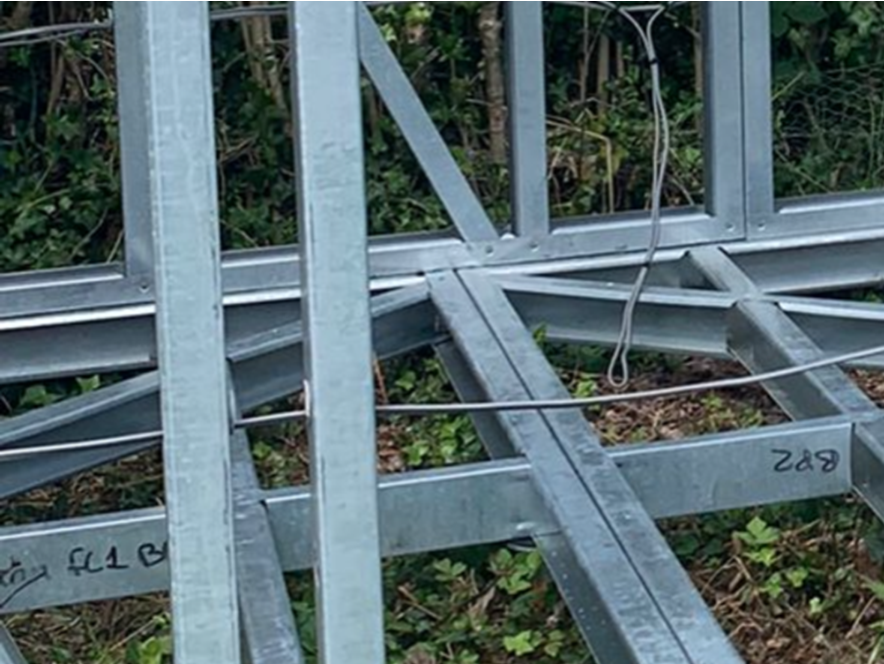

0

  4. thanks i cant get access to under the floor let me investigate the frametherm
  5. many thanks for the responses thus far this is something i am considering i coming up off the floor with battens and then jamming pir into them for the walls - i intend it to use a breather membrane on the external and just use mineralwool to try and contain costs. daft question ( prepares to be lambasted) could i not supefoil the floor and board over it ?
