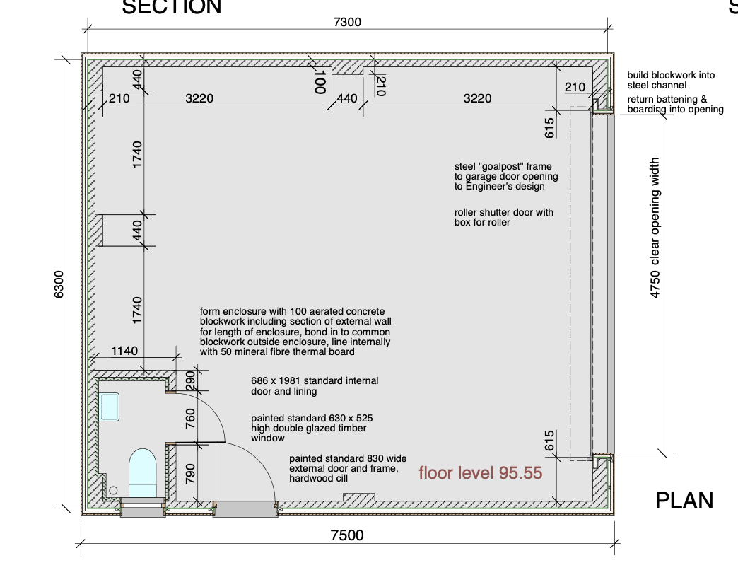

Alterations to detached double garage design
New to this replied to New to this's topic in General Structural Issues

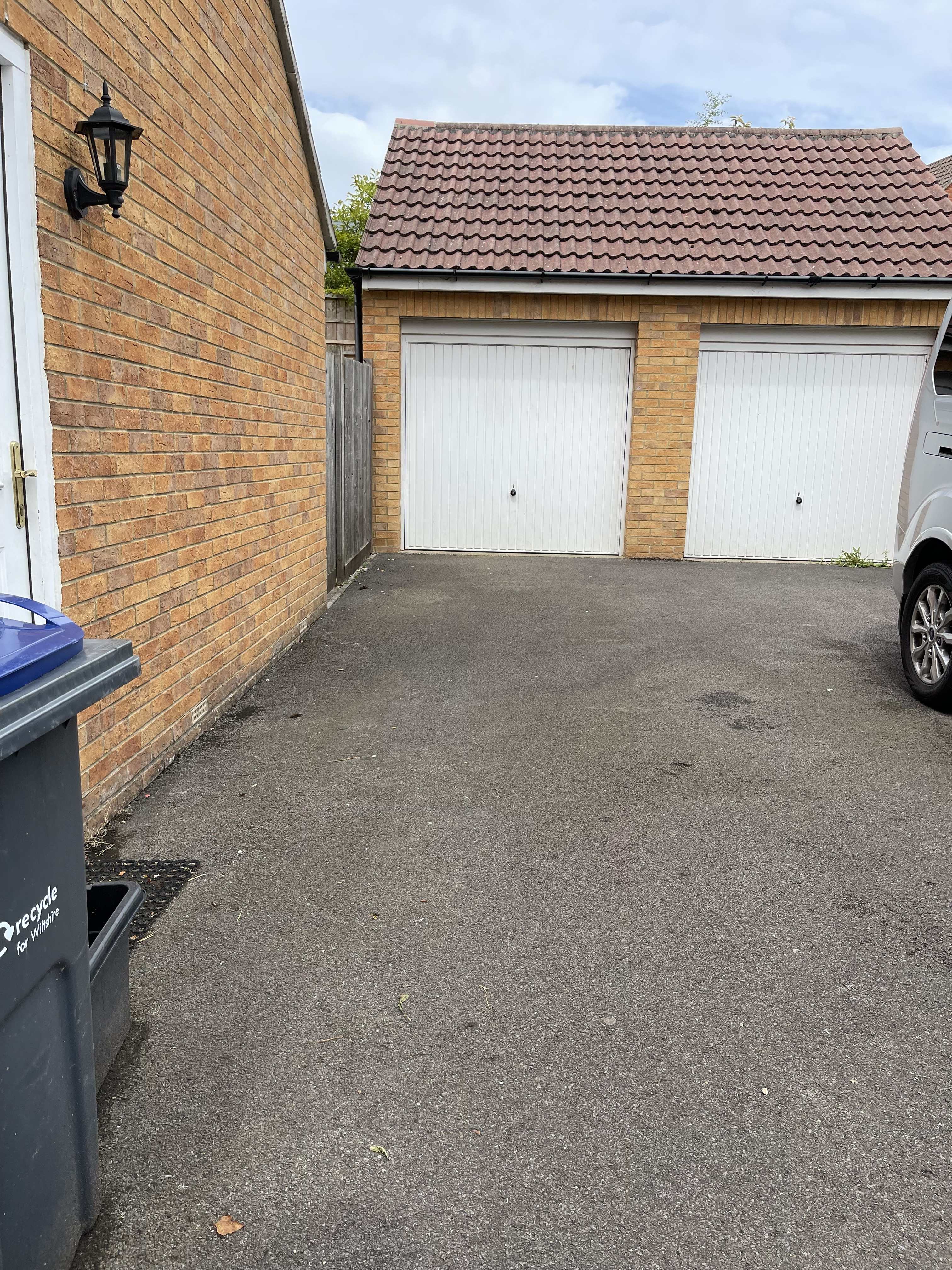

Really appreciate the input @Nickfromwales, @Russdl and @BotusBuild - we are sticking with ONE BIG DOOR 🎉 -
@Nickfromwales I think this may help - there's width to add the central pillar, by reducing the two side returns. All the supporting pillars around the permeter will be tied in as they are built. At our previous house, we had the garage in the photo - the pillar isn't massive. Apparently the concern now being expressed within the New To This household is that pretty much the entire width of the garage is exposed to the elements once that single door is opened, I personally don't see it as an issue, but it's Himself's baby, not mine!!!! His precious chariot will live in there, alongside the tractor mower and a few other bits. There's a separate pedestrian door in/out as well. @BotusBuild, I wouldn't put the goal post in if we are going for two single doors, simply the normal lintel over each opening. I should have added images at the start, would have made it a little more evident for all what I was getting at. -
Definitely where my head's at - but as a total novice, I don't know if a decision like that 'now' has consequences down the line! Thanks for sharing your view BotusBuild -
New to this posted a topic in General Structural Issues
Hoping you can point me in the right direction - our plans all drawn up by previous architect, approved by local authority planning department and foundations/steel work calcs completed by our SE. We now wish to switch out the planned 4750mm-wide large roller door in favour of two more typical (about 2.4m each) doors. What do I need to organise next for this to all work out ok? Will I need to go back to the SE, to get the steel goal post structure replaced with 'just' appropriate lintels, or can builder simply get on with that? Aside from the planning angle, what other impacts should I be considering here? It's a block single skin structure with double block pillars at appropriate points around the perimeter. I'd now look to block or double block the central supporting 'wall' between the two new openings, and sit the lintels on those. The already-designed structure has double blocks on left and right hand side of original large door anyway. We are likely to have LABC and self build warranty in place, we plan to build this structure first, to provide on site storage / welfare etc while house is built. -
