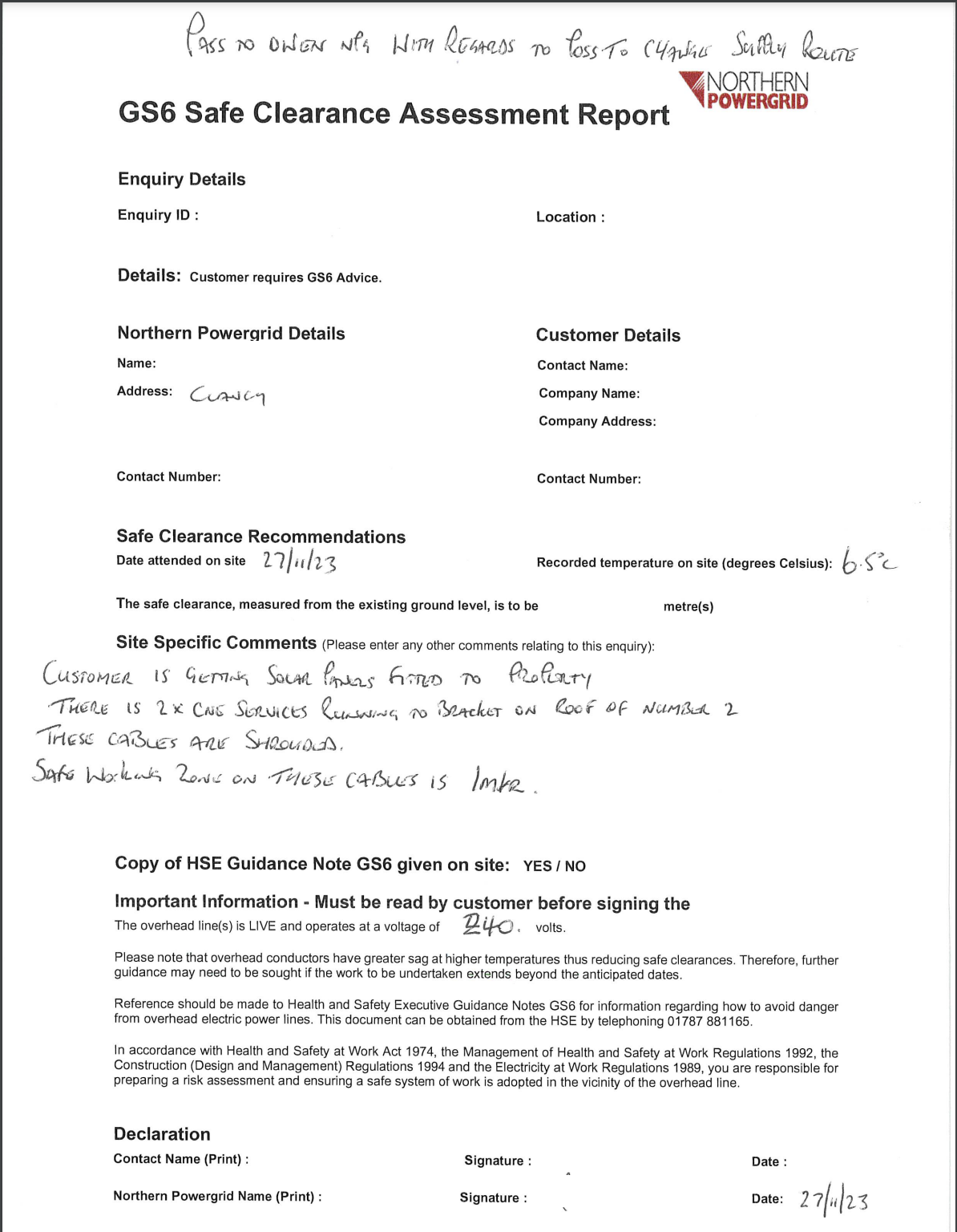

I've received a copy of the inspection report (attached), at first I thought they'd completely forgotten about moving the lines but then I noticed they had written across the top "pass to Owen NPG with regards to poss to change supply route" so I'm guessing that means someone called Owen at NPG may or may not be considering it now π€·ββοΈ. The report still seems to be based around safe working height rather than the safe distance for a fixed solar panel even though I have constantly laboured the point throughout the entire process that I am not asking about safe working distances. For good measure they also sent me a generic HSE PDF about safe working distances from power lines π. -

So I've just had the NPG inspector guy out & got some mixed info from him. He said ideally there should be 1 metre clearance for my type of cables but also said it doesn't really matter & if it was him he'd just put the panels up anyway π³ I should say that he also said that he was going to do a survey recommending my cables are moved & brought into the houses underground so I'm not sure if that had something to do with him saying I could just crack on with putting panels up on that roof. I really did try to push him on what exactly is or isn't allowed in my case but he just seemed to change the goal posts between saying ideally a 1 metre minimum & then saying it didn't really matter if I just put them up as is π€ Ah well it looks like it's still clear as mud. I may go ahead with them moving the cables though as he said there isn't a charge, which I was a bit surprised at. -

I've just had what was supposed to be a 35 panel 15kw system installed, however 10 panels were not installed due to a power line being close to one side of a roof. So I have everything already set up for a system with 10 panels more than what I actually have, the cables that were meant to go to the omitted 10 panel string are connected to the inverter & rolled up in the loft ready to go. Next year I will be completely re-doing the garden (which is currently a building site) so was wondering if I build a shed or pergoda etc to take maybe 6 to 8 panels (exact same models as existing obviously) would I be able to do most/all of the work myself or is there still a lot of red tape/certs etc involved in what seems like a fairly simple job? Or are there any other things I should be aware of as well? Cheers.
The national grid guy I've been speaking to on facebook reckons said "effectively insulated means a single layer of insulation I.e. ABC conductor (the main)" whereas mine is concentric double insulated so should not need any clearance. Obviously talking to someone on facebook doesn't really help my situation & I really needed to talk to someone qualified from NPG before my solar installers pack up & leave site tomorrow but there is absolutely zero chance of that. I'm fully expecting a very generic email from them within the next 28 working days that doesn't address my question as the confirmation email I got from them yesterday to tell me they'd eventually get back to me stated my question was regarding safe working distances π
Iβve had solar fitted to 3 sides small roofs & was supposed to be getting another 10 panels fitted to a 4th roof that has overhead cables above it, which enter my loft & connect to my meter. The job has taken much longer than anticipated by the installation company, everything was straight forward on the 2 tiled roof sides but the 1st slate roof side took several days for just 8 panels & I don't think they properly accounted for this in their quote from what they told me. Work then halted for 2 weeks while I went on holiday & on the way home I actually said to my wife that I had a feeling they might just tell us that they can't fit panels on the last slate roof due to the overhead cables (which theyβd mentioned before the holiday) in order to cut their losses & not have to pay the 2 sub contracted installers for another 4 or so days just to fit 10 panels (both installers being on Β£250 each per day I found out). Lo & behold when we spoke to the director later on he told us NPG had told him there needs to be 2.5 meters clearance so no point in trying to fit anything to that roof & he also said something else that didn't quite make sense to me. I have spoke to someone on a facebook Solar group claiming to be lead system design and power quality engineer at NGED who said there is no clearance needed for my cables which he assumed from my photos were: 95 2c ABC to 6 x 16mm Copper concentric with an open point to an underground circuit. To me this means either my installers are not being truthful, or they have been given the wrong info by NPG. I have just rang NPG connections department & basically I had to leave a message with a call handler who told me someone with authority would email me in 5 to 28 working days so I have absolutely no way of knowing as simply talking to someone who knows things seems to be to much to ask these days. Anyone familiar with clearance regs etc? Cheers.
