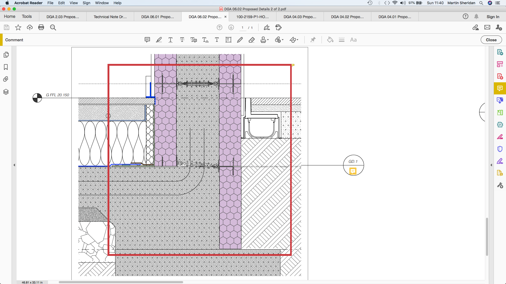

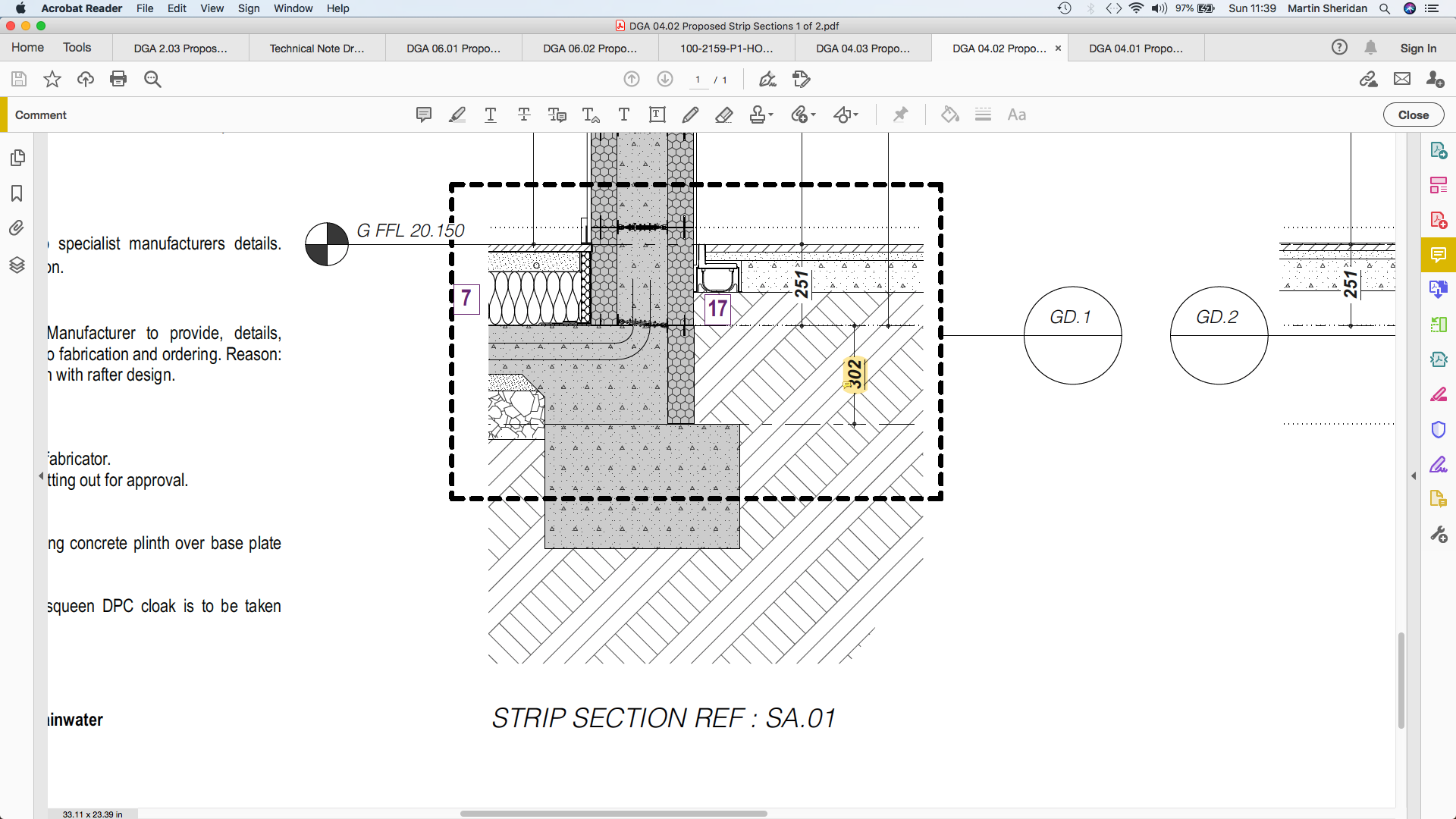

Understood but seeking level thresholds for wheelchair access. Unfortunately can’t raise house - had to dig down in the site to accommodate ridge height - and connecting into pre-existing combined sewer at a certain height. Be great if, as a minimum, I could lay drain across sand blinding to gain its 50mm thickness and 150mm thickness of hardcore. If I could go across higher even better.
Hi there I am self-building our family home and have minimal fall from ground floor level down to the combined sewer to make a connection without having to rely upon a domestic pumping station. We are building using ICF with strip footings and a ground bearing slab. Our floor build up is as follows per attached details: - nom. 25mm finish above screed level - nom 50mm self leveling screed (assuming 50mm rather than 60mm drawn) - Vapour control barrier/500 gauge polythene sheet over of nom thickness - 165mm thick rigid PIR insulation - Visqueen DPM of nominal thickness - 150mm reinforced concrete slab - 50mm sand blinding - min 150mm hardcore - min 225mm deep strip footings I understand that it is usual for the drainage to penetrate through the rising wall above the strip footings with flexible connections either side to allow movement and that there is no need for lintels given ICF walls. In terms of the floor build up what is the highest layer that I can penetrate the rising wall at, i.e. can the pipes penetrate down through the top of the floor, bend and penetrate through the rising wall within the hardcore, sand blinding, reinforced concrete slab or PIR insulation layer? Reference to relevant building regs would be greatly appreciated in case I'm challenged by Building Control. Thanks for your help. Martin
