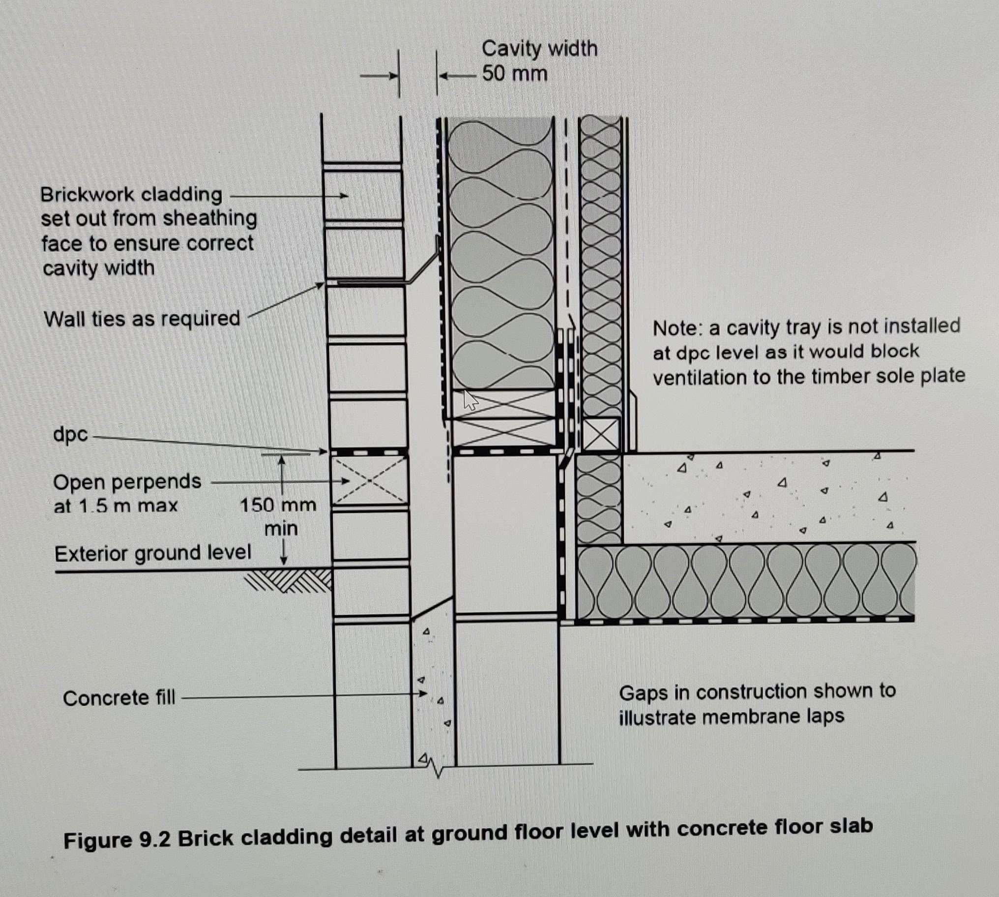

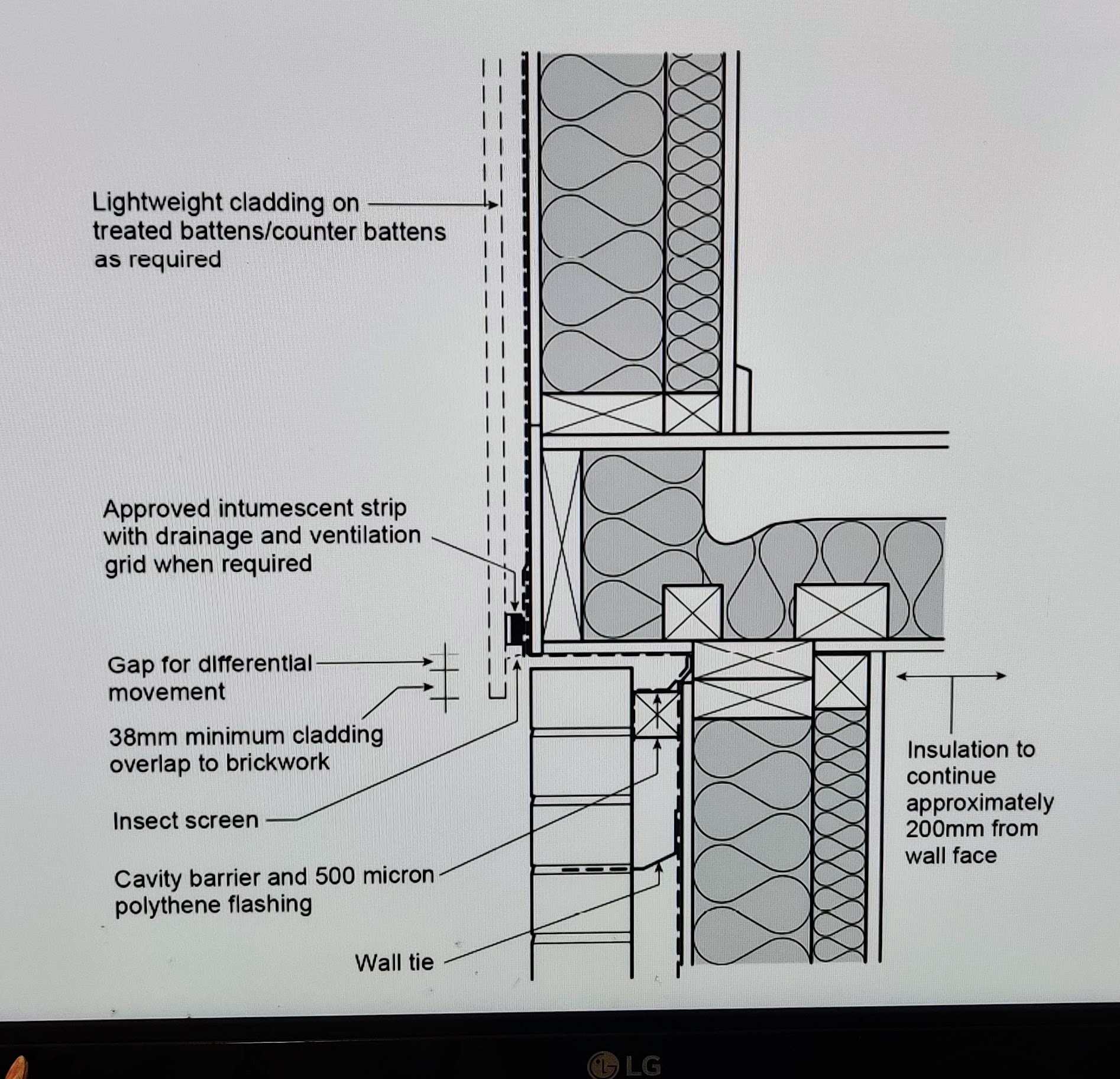

	Thanks @sgt_woulds, and apologies for the delay in replying. We've spoken to Klasse who say their board can be directly mounted to the timber frame, but as you mentioned preventing moisture build-up could be tricky. I'll look into woodfibre although with aluminium cladding it would need a ventilated cavity behind it, so I'm not sure if that would be possible.
	I'm currently in the middle of timber framing my DIY extension. One long flank is right on the boundary, so non-combustible cement board was specified by the architect as sheathing, but this is causing me a few headaches. Architect spec: Insulated PB Vapour Barrier Timber Frame (insulation between studs) Cement Board (direct to frame) - RCM Y Wall Battens Aluminium Cladding Problem is that Y Wall and all other cement boards that I've found also specify a ventilated cavity between the board and the timber frame. I've spent ages trying to find cement boards with racking resistance comparable or better than OSB, but now I'm worried that it will be compromised if not planked directly on the studwork. Not to mention that I'm having to add a second cavity which means I'd probably need another housewrap layer (and possibly 9mm osb) between the battens and the frame. Of all the boards, STS is coming out the cheapest, and Klasse C-Board seems to have the best spec for racking. Has anyone had any similar experiences? Thanks

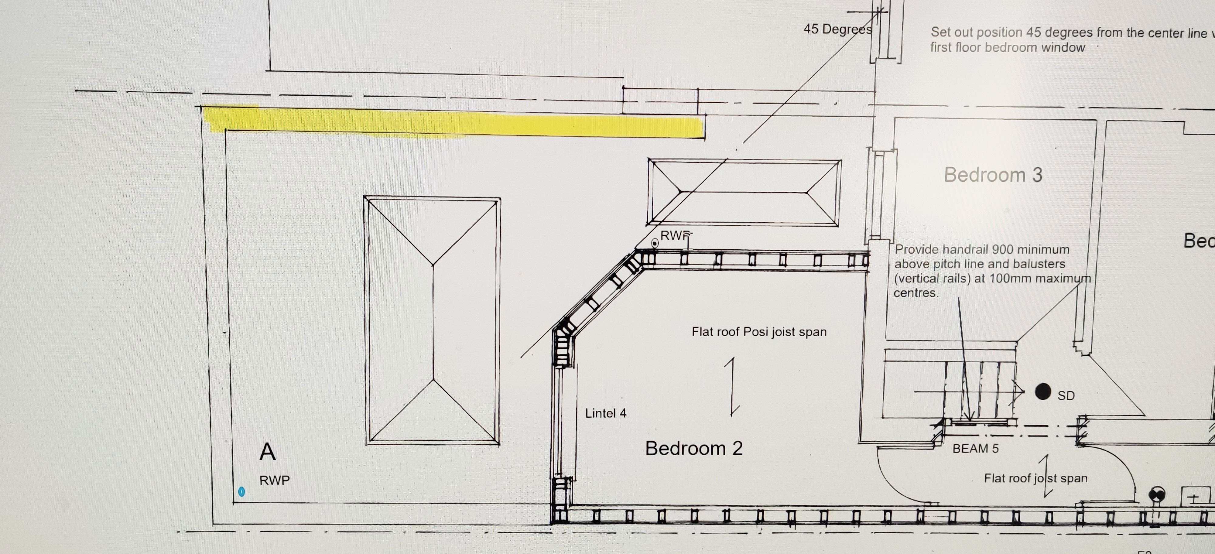

	Yep, will do. I'll get chance to fiddle with it tomorrow. Mass-concrete is the solution the SE came up with. He just left it to me to figure out the waterproofing. The BCO suggested bituthene, hence going with the Permaseal. For now, the green cross-hatching is concrete, the red vertical dashed line is the conservatory (not the boundary as labelled). The two red columns are blockwork, forming the base of a new wall - the cavity, up to the height of the conservatory is also to be filled with concrete. The steel encased in concrete is a ground beam foundation. The boundary line is approx half way between the conservatory and my new block wall. The pipe in the photos sits against the conservatory, pretty much along the boundary, and possibly a little over it. We've now started the blockwork, with the exterior skin up to 600mm. I'm hoping to get the waterproofing in this weekend.

	Hi all, Some of you may remember my posts from late last year where I had to pause my extension to get an SE to detail how to prevent my neighbour's conservatory from sliding into my extension... https://forum.buildhub.org.uk/topic/40498-i-am-soooooo-stuck/ It's been a tough 8 months with 2 sewage leaks and a water leak all beneath the neighbour's conservatory pouring 'fluids' all over my foundations (not helped by their lack of build-over agreement with the water co.).Since then, I've been researching how to waterproof the lower part of the wall (blockwork cavity wall with concrete infill), and think I'll definitely be using a bitumen self-adheseive layer over a primer. BCO suggested Bituthene, but Permaseal looks good too and is slightly cheaper. Question is, as it's only a 285mm gap between the two buildings, direct rainfall should be minimal, so do I need to worry about hydrostatic pressure, or even their vent pipe leaking sewage (as it's the head of a 5-cottage sewer run)? I've considered if there's any way to fit a dimpled drainage sheet between the waterproof layer and the concrete, but that would need something to drain into, and a perf pipe underneath all that concrete would be pointless (unless perhaps I put a layer of EPS between the permaseal and the Geodrain dimpled mat creating a cavity below for the perf pipe?). Would be great to hear your opinions on this one, please! Thanks

	Hi all, Following your help a couple of months back, I thought I'd update you on where I'm currently at with this! After myriad delays, the SE finally produced his solution last week: The wall in question will switch from timber frame to brick and block cavity, which will span the width of the ground beam. The gap between the new wall and the neighbour's conservatory (285mm in width) will be filled with concrete, blanketing the spill that is there (I'll remove the loose debris and cut it back where poss) up to the bottom of the conservatory (560mm height). The concrete will be laid with a fall away from my wall, and a channel of some kind will be formed to take water down towards the garden. The SE spec'd the wall cavity to also be filled with concrete up to the same height. He didn't make any suggestion for waterproofing, referring me to the BCO, who suggested using something like bituthene, and drew her idea (second pic) onto the engineer's drawing. Neither of them think that insulation will be necessary due to the mass of the wall, although personally I think I should go belt and braces and insulate somehow. I know it's far from ideal, but I think I have little alternative. I'd be really grateful for any ideas for waterproofing and insulation that you may have, please. If I can just get this wall design finalised and built in the next week or so, I'll be happy. I'm going to leave the timber framing until the spring when I can get a good run at it. Mahoosive thanks! 6154-SK02 Section 2-2.pdf
