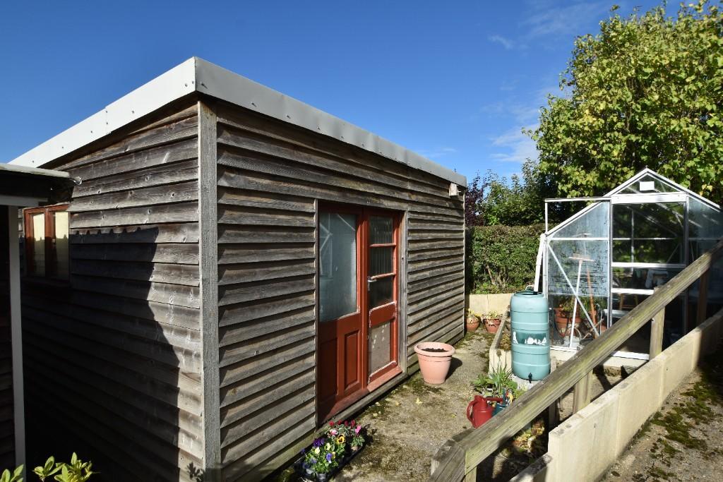

Thank you for the detailed reply! 1A) Windows - the two side windows will be removed in the next phase. The neighbouring wooden garage is in a very poor state, so I'll pull that down and rebuild it. Longer lead time as will need planning, as want to change the roof direction for solar panels, and absorb space taken by other wooden "things" that have been built around it. The plan is to join the two buildings by a wide link, that will be both a passage and storage etc. This will take in the two Windows (single glazed and not very useful). 1B) Doors - replacing them with a 3-door bifold. Obviously wider opening needed, and that will be closer to the left-hand wall. The front wall appears to have been made from three "modules", so I'll have to rebuild some of the framework, but less of a job thanks to how the front has been built. I still need to source a threshold for the bifold, as want to account for the increase in floor thickness (circa 70mm with the 50mm PIR and 2x 9mm OSB (for amtico or less if a floating laminate flooring). 2) French gutter at front - totally agree with that, and around the sides and rear it's soil and been overgrown, so will scrape back soil but soil membrane down and put gravel down. Planning to leave the gravel until after building work, but if I'm just doing the inside now, then could be a "quick" job to get done first (already spent a couple of days clearing the overgrown ivy and weeds etc). The front path however will have to wait for the electrics... 3) Electrics - quite my forte, was planning to surface mount, but if I have a void, may as well hide the cabling and create a nice crisp white box... Linked to the above, the current power supply is an armoured cable buried in concrete. Not to my liking, and makes changing the path near impossible. I've already laid ducting along a fresh route, so when I pull the new cable in, I'll be free to cut the concrete in front. 4A) Ply sandwich - fair point, it's been standing for 15 years or so. Internal ventilation is definitely the big issue, as when I cleared out the old workbenches, shelving etc, the majority of the musty smell went. Still not completely gone, but a good bleaching of surfaces and properly ventilating the place should get rid of that. 4B) Air tight tape - just any foil tape, or something specific? Also, if taping the plywood, does this in effect become a vapour barrier? Is the insulated stud wall on the cold side or the warm side? Are you for/against the addition of ventilation in the top of the cladding panels? 5) The stud wall does seem the best option, and something I can chip away at progressively... Because it's a metal roof (insulated panels), is there any special treatment of the top of the frame, like extending a tape or barrier between the frame/plasterboard and the plywood? I'll use skirting and trim at the roof to finish the plasterboard off. Or is the frame/plasterboard happy to just butt against the roof as-is? 6) I plan to lay a vapour barrier poly sheet under the PIR - I'm not sure if a barrier was laid in the concrete floor originally. I'll seal that to the plywood walls as well - would that be a sufficient DPC for the stud wall? Thanks Jon -

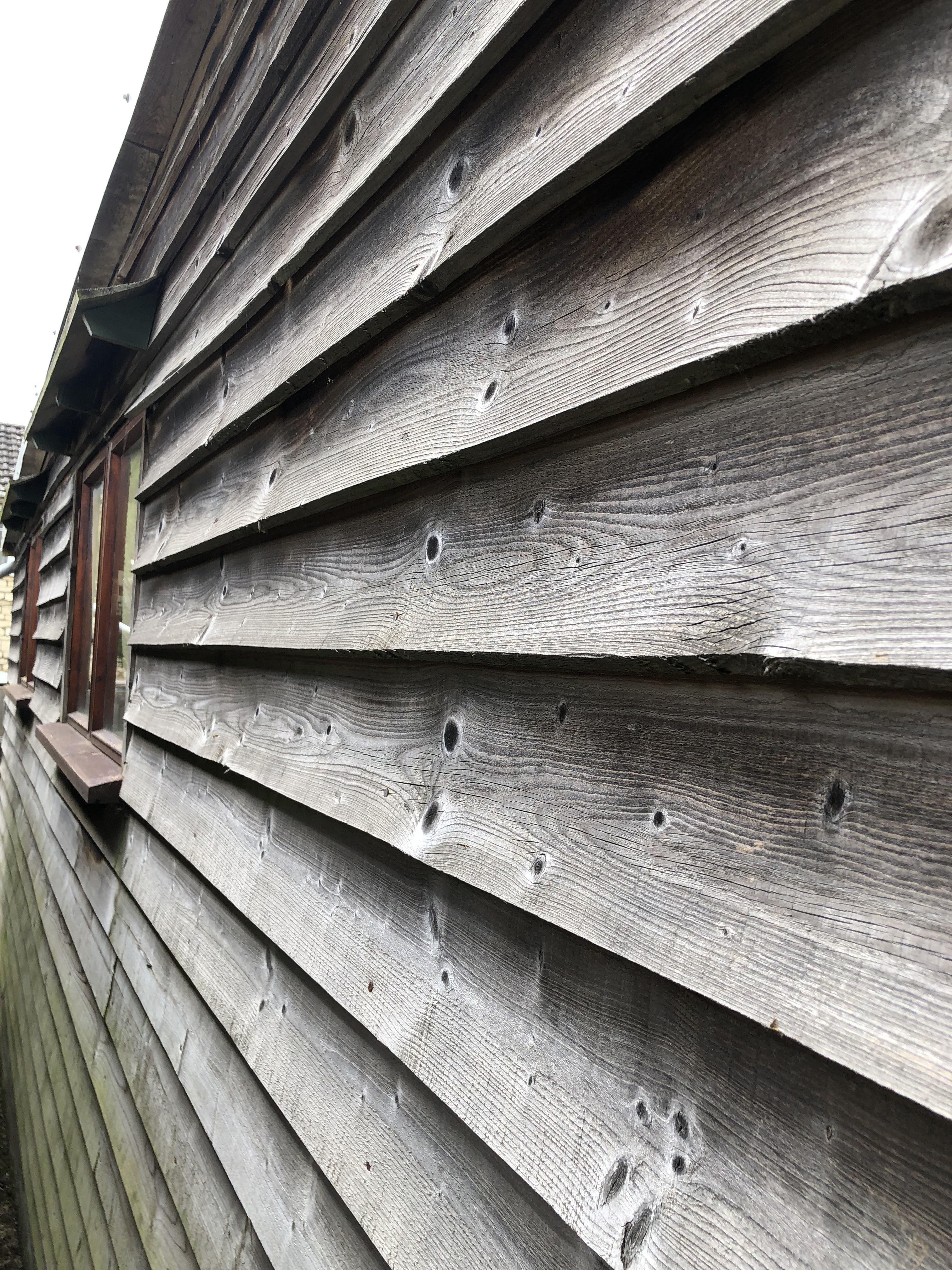

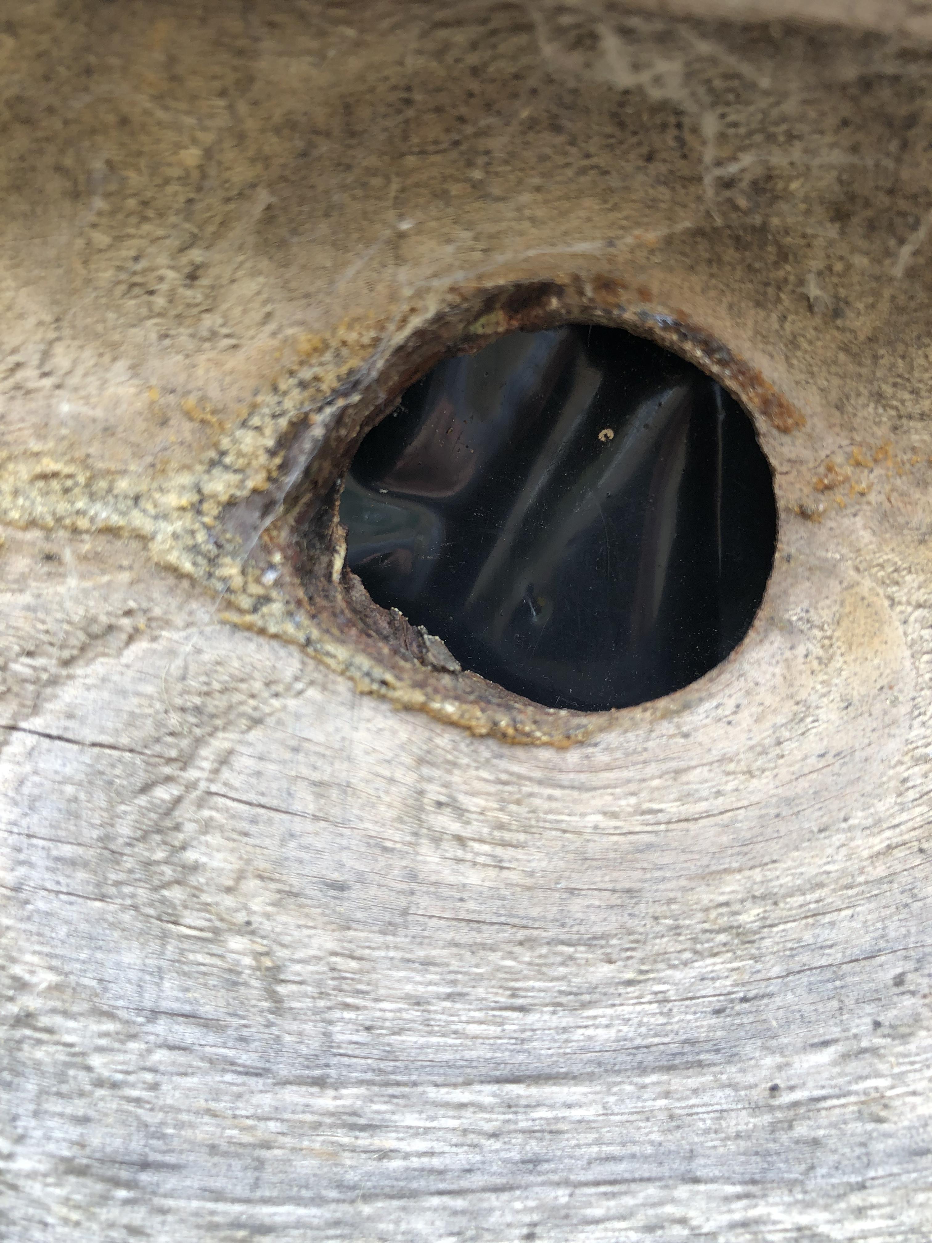

I'm not sure how it's been fitted, whether it wraps under the frame or not. I'm hoping it's "loose" at the base, but it'll still be held against the bottom of the frame by the cladding. The poly is very much not a breathable moisture sheet. There's no ventilation in the panels, so the poly seems to have been fitted as a water barrier without consideration of condensate/ventilation. It's fairly lightly filled with a fibre glass insulation of some kind. So, to add ventilation, it should be an easy job of cutting a 60-80mm hole in the top of each void and putting a vent. Do you mean the poly sheet under the cladding or when the plywood skin is taped up and that'll be an airtight barrier? -

Okay, so would require removal of the old poly sheeting (it’s under the cladding at the very outer)? or would high level vents that cut through the poly be sufficient? I wouldn’t have to remove all of the cladding - I could even maybe get away with removing internal plywood as well to remove the poly if needed. -

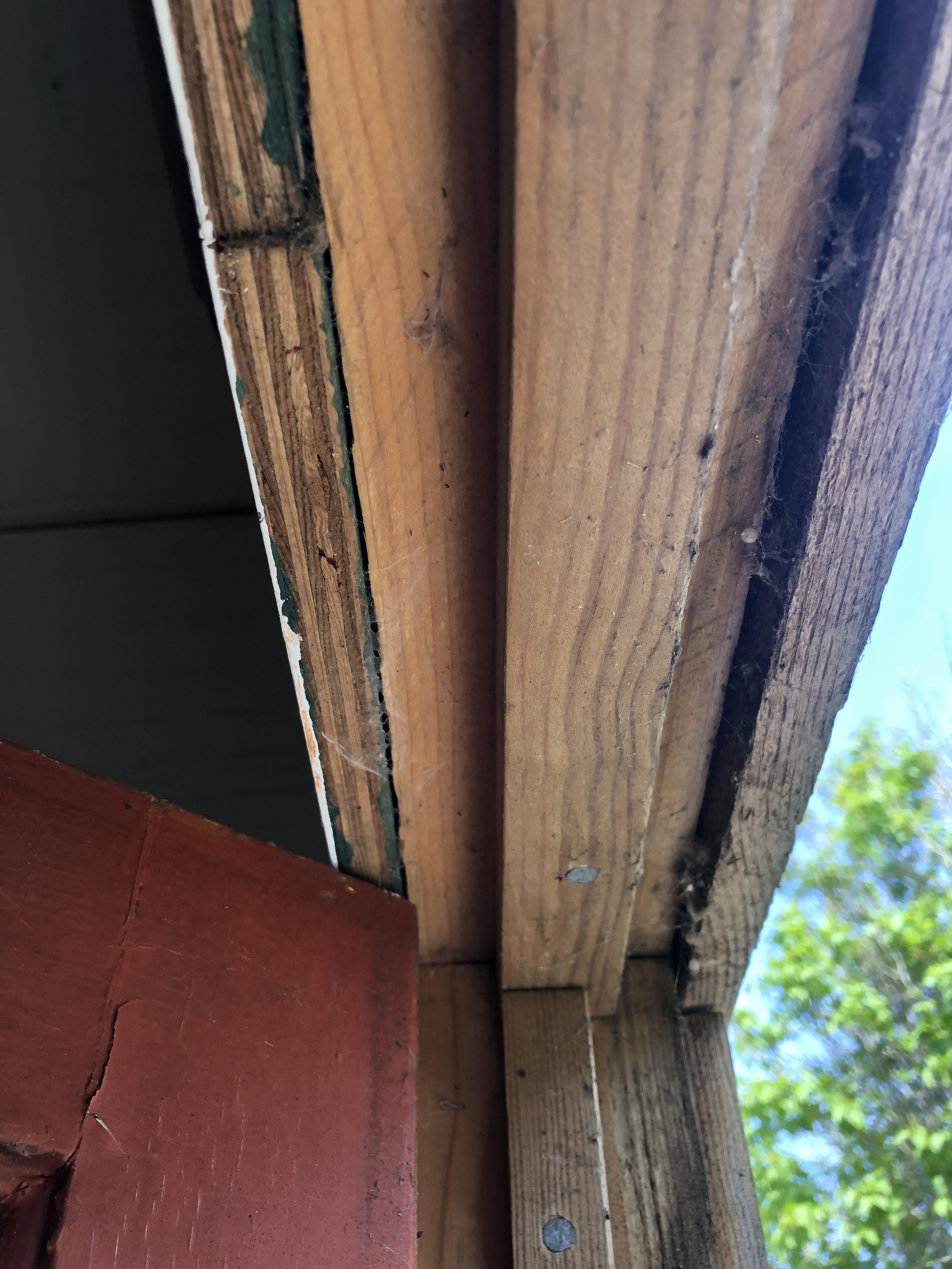

I’ll post some pics in a minute… The plywood is painted internally - if that’s taped at joints, will that not create a trapped void between the existing poly sheeting under the cladding and the ply? -

What software are you using for calcs as well? I’m trying to figure out the layers, and where the vapour barrier should go, and if it’s okay to sandwich the existing plywood, a barrier and then thermal plasterboard together - or if there needs to be an air gap for the plywood. My principle aim is to reduce/mitigate damp AND massively boost the thermal properties of the building. I could put a 63mm gap between the plywood and vapour barrier with studs. Also addressing your comments about the existing external barrier - I wanted to remove it (mostly as it seems to be a potential cause for any damp there is now), but also my thought was to fit ventilation for the exterior void. I might fit a breather membrane in to stop water ingress. The cladding is not perfect, so water ingress is possible. I’m very confused now, and back to square one having thought I’d figured this out! Materials on the way too 🥴 -

I’ll add, that the conversion for us is to turn it into a proper office/studio building - we’ll have print equipmen in there, and some needs to be kept around 20C. I’m trying to do what I can to retain as much heat as possible. Even now, during very hot days, it’s warm, but it’s not hot. That gives me hope that during winter the heat loss won’t be too bad. With the refurb we’re doing, it should perform better than our concrete block/steel frame office in a business park 😂 -

Hi, Is it worth putting a breathable membrane under the cladding? Or just cut the poly out, re-insulate the studs, and put a poly over the ply? So I’m guessing the objective is to leave the insulation and the studs open to the external air, and stop moisture from passing into the plasterboard/top layer (we might skin in plywood as the decor finish)? Your comment regarding the PIR - is this a bad thing that the damp will go through the studs? Or do you mean that it will need to be exposed in order to dry out? Thanks -
