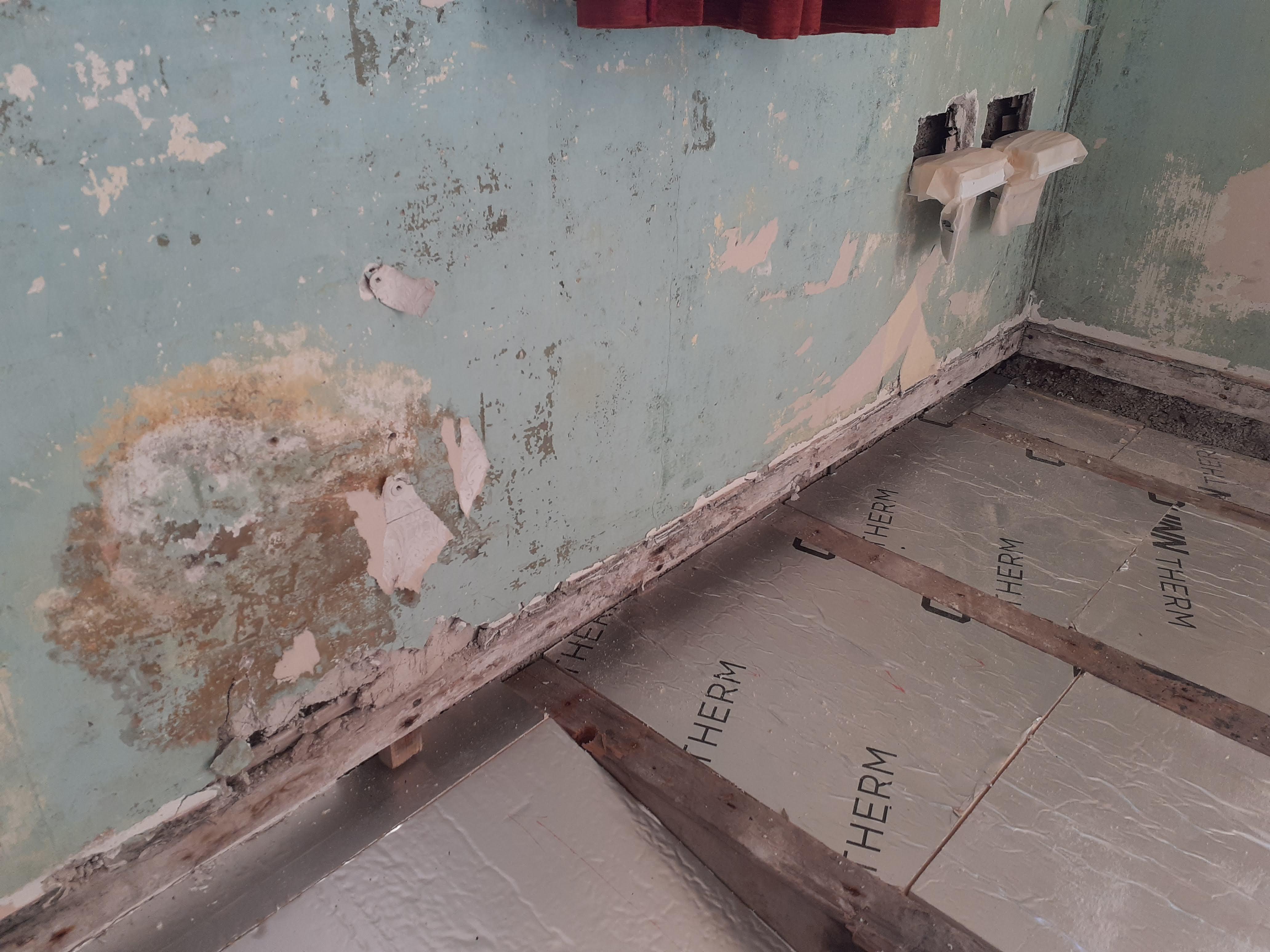

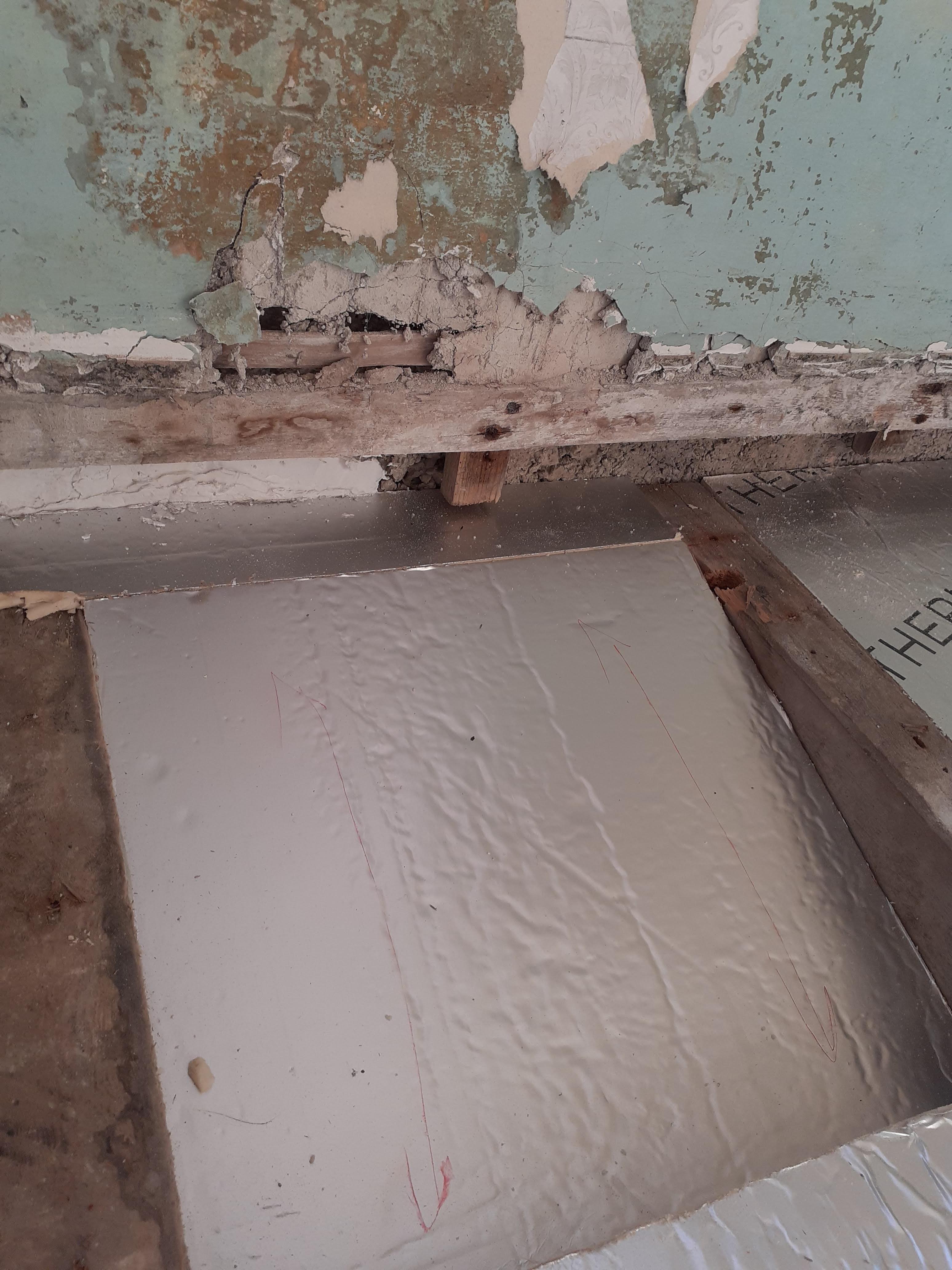

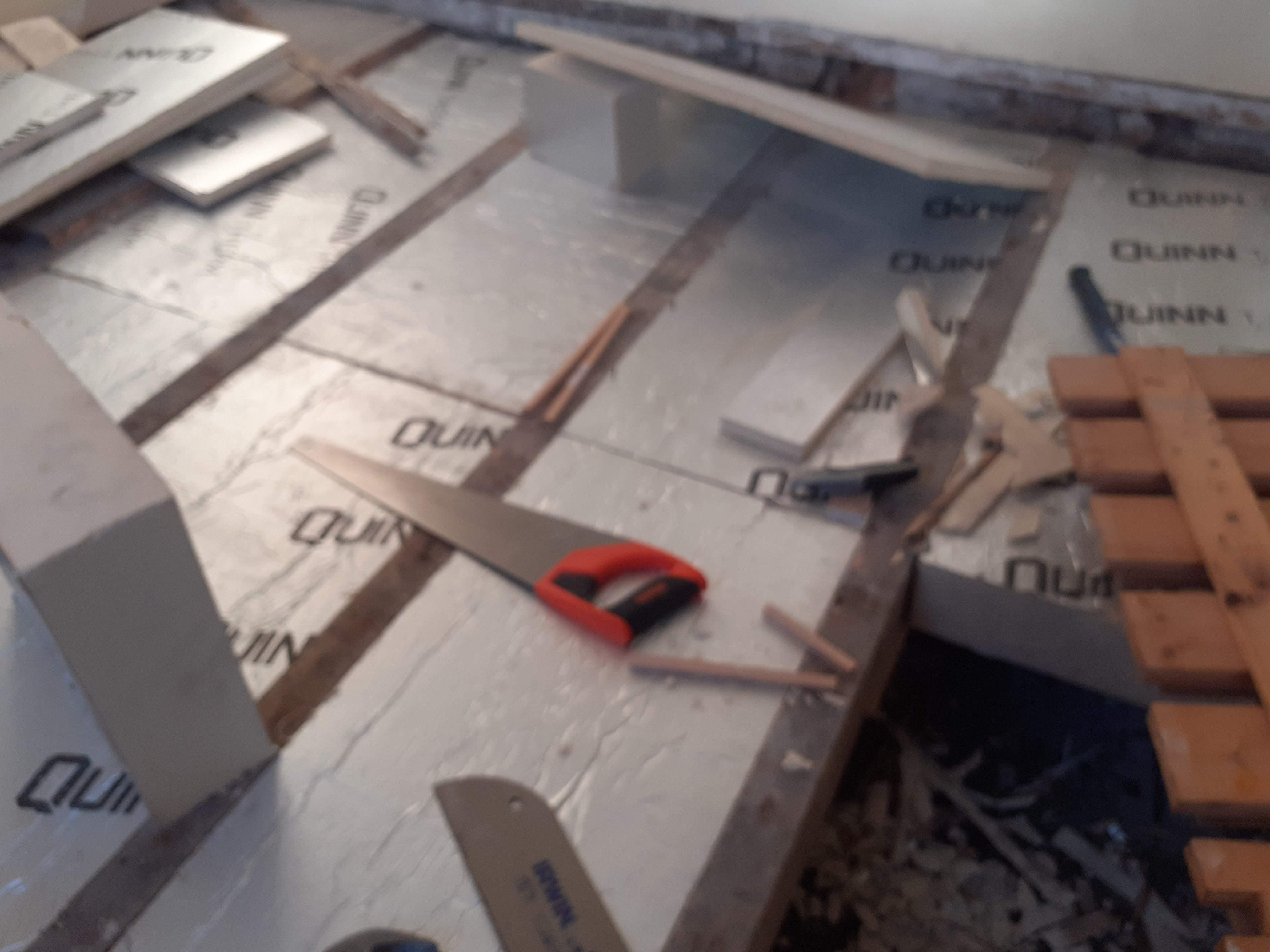

  2. Hi All Thanks for your kind words and great to hear from you all. It was -5 on Wednesday morning, felt sorry for the campers in tents at the foot of the pass! Simplysimon is spot on, Wanlockhead, Southern Uplands (also highest pub in Scotland, not as high as the wonderful Tan Hill Inn though in England). Anyway I digress. Advise sought and perhaps I will post on one of the more generic forums? Is that where I should be going really? So there I was with this horrible PIR board between the joists, and after so much prevarication I'm also thinking of putting it on the interior wall that that faces outside at the front of the house. But here is the crux, I have no idea whether I can just attch it do the present plaster (looks like lath and plaster? I have a horrible feeling that you experts will tell me to get rid of the plaster and use lime somehow, but really not sure what I'm doing here. The PIR is 12cm, quite happy losing that space to make this bally house warmer. Photos with work still in progress between joists (yes, I realise now that I should have done this bit last d'oh!). Oh going to move the sockets away from that wall as well.
