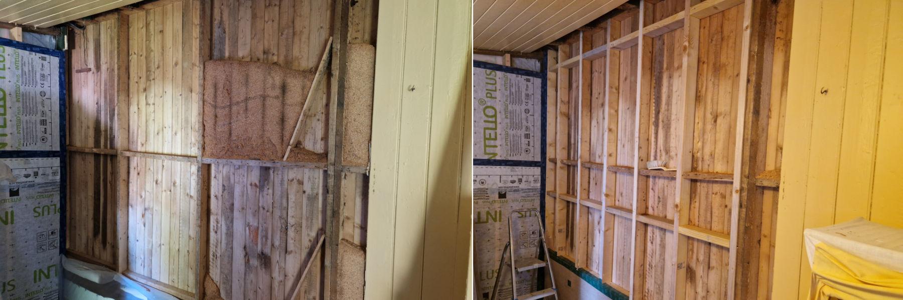

  2. @Iceverge — thanks, I’m going to have a second look at the foil. It’s starting to sound like a waste of money. I’ve attached a before and after image of an internal wall. Left: 3x2 frame, verticals ~80cm on center. Right: 4x2 treated CLS, 40cm on center, left the original frame in place where possible and added battens to the 3x2 to get it roughly level. This wall’s urgent because I need to run electrics along a utility channel in here. (The current wiring is very old and probably dangerous, so the sooner the better.) However, because it’s internal, I can get to the other side no bother, so as long as I don’t need to change things like the membrane, I can do most of the work from the other side. I may just put up some sheeting, add battens for the utility space and call it done. (Incidentally, you can see the end wall that’s an emergency repair to an external wall. That moved about 10cm in each direction when you leant on it. So that frame got hastily patched up this summer. However, it needs to be rebuilt again as it’s just a frame the outer T&G and some membrane to stop drafts.) The budget is more about time than money. I can afford to spend £1000–£2000 per month. I’m expecting it to take five years, and cost in the region of £100k. As I work full time I can only work on it evenings and weekends, so at the moment I run out of time before I run out of money. However, once I have to pay people (like electricians) I will eat through the budget pretty fast. The T&G on the outside is dirt. It was replaced in the 70s and they’ve used untreated softwood painted with some kind of gloss paint. Somewhere around 40% is rotten, so it all has to go before it gets into the frame. However, I can probably save ~60% of it and make do for now until the price of wood comes down. (Oddly, the side of the building that faces the sea isn’t so bad, it’s the sheltered side that seems to be worse. @George — thanks. Yeah, the foil is probably off the table by now. No one seems to rate it. @Temp — Nope, no DPC at all. Just a wooden frame fixed to a concrete slab at the back, and a wooden frame on stilts at the front. I’m planning to build a short 30cm concrete wall and rebuild the external frame on top of that. But I need to work out the width of the wall first. The damp course will get slotted in there somewhere once I’ve worked out the details.

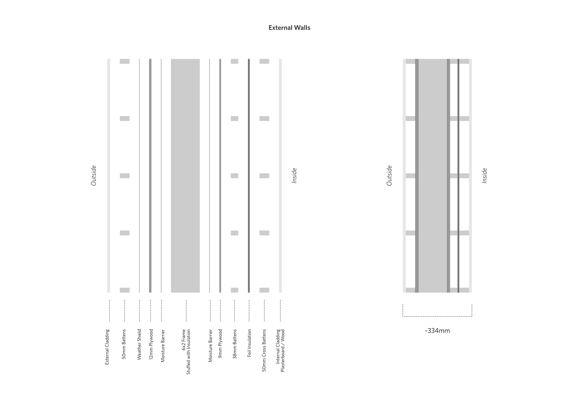

  3. Thanks for all the replies. I have the winter to make these decisions, because the weather’s just too unpredictable now. But I do want a plan soon, if only to get a budget in place. @saveasteading — I went for foil because the front part of the building is on stilts, so weight is an issue. I thought foil in the roof would save a bit there, and it seemed to make sense to continue the same insulation down the walls. The external cladding is likely to be larch, and possibly beaten brass or copper for the bottom 30cm to keep the wood off the ground. We’re still debating that, and the price of wood means it’s likely to be recycled from the current cladding for a year or so (the whole building is tongue and groove inside and out). @Iceverge — No, renovation. We’re living in it, and funding the build with what we save in rent/mortgage. So yes, it’s a bit of a jigsaw, and flattening it and starting from scratch would be easier and cheaper. But for a few reasons, that’s not happening. I have spent an unexpected amount of time reading about the difference between OSB and ply. It seems to be more polarising than brexit. I guess I opted for ply because I’ve used it in the past, so I was going for something I was familiar with. Literally everyone else says OSB though. The insulation we like is hemp (https://www.ecologicalbuildingsystems.com/product/thermo-hemp-combi-jute). Mainly because it doesn’t require any specialist equipment to install. The manufacturer recommended a moisture barrier on both sides of the frame to keep it in place, but I guess the racking would do the same job. Thanks for the Ubakus tip, I will play with that. @George — The foil insulation needs an air gap on both sides to be effective (minimum 38mm). I bumped it up to 50mm on the side closest to the plasterboard to give me a more generous service void (just in case). If I dropped the internal ply/OSB, I could probably fix the foil straight to the frame instead of one of the vapour barriers — but maybe I should rethink the foil anyway.

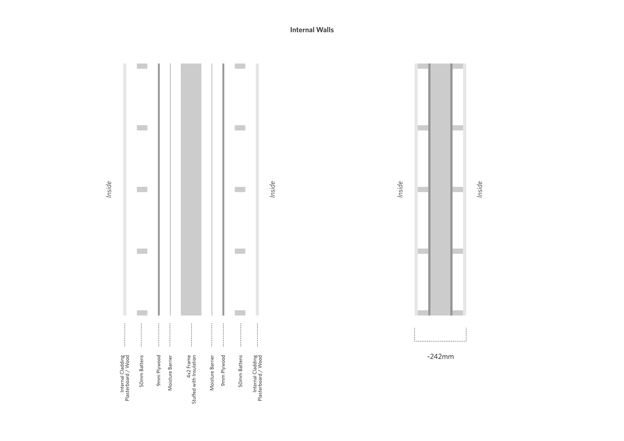

  4. (Apologies if this is in the wrong section.) For context, I’ve zero experience of house building, but I am pretty experienced with wood (furniture etc). I have a timber-frame wooden building on the shoreline in Northern Ireland. The weather can get a bit wild, and we’re quite exposed. However, it’s stood up for 100 years, and I’ve been told by locals this is in part due to the materials being pinched from the Belfast shipyards (and therefore treated for marine conditions). The walls (internal and external) currently consist of 3x2 frame, clad with 12mm tongue and groove, and stuffed with sawdust and wood chippings. Obviously that’s not adequate. I’m trying to arrive at a final plan for the walls before sending the plans off the building control. I’d really appreciate people’s opinions on the structure. Am I missing something, does something need to be chunkier, is there a newbie error in there, etc. (For example, I’m unsure if I need a moisture barrier between the frame and the plywood sheeting on the outside, given that there’s also a weather shield — I’m guessing it can’t actually hurt anything but my wallet.) My priorities are structural rigidity, wind/weather-proofing, insulation, a utility channel for electrics etc., and to be realistically achievable. Cross-section diagrams of external and internal walls attached. All opinions appreciated.
