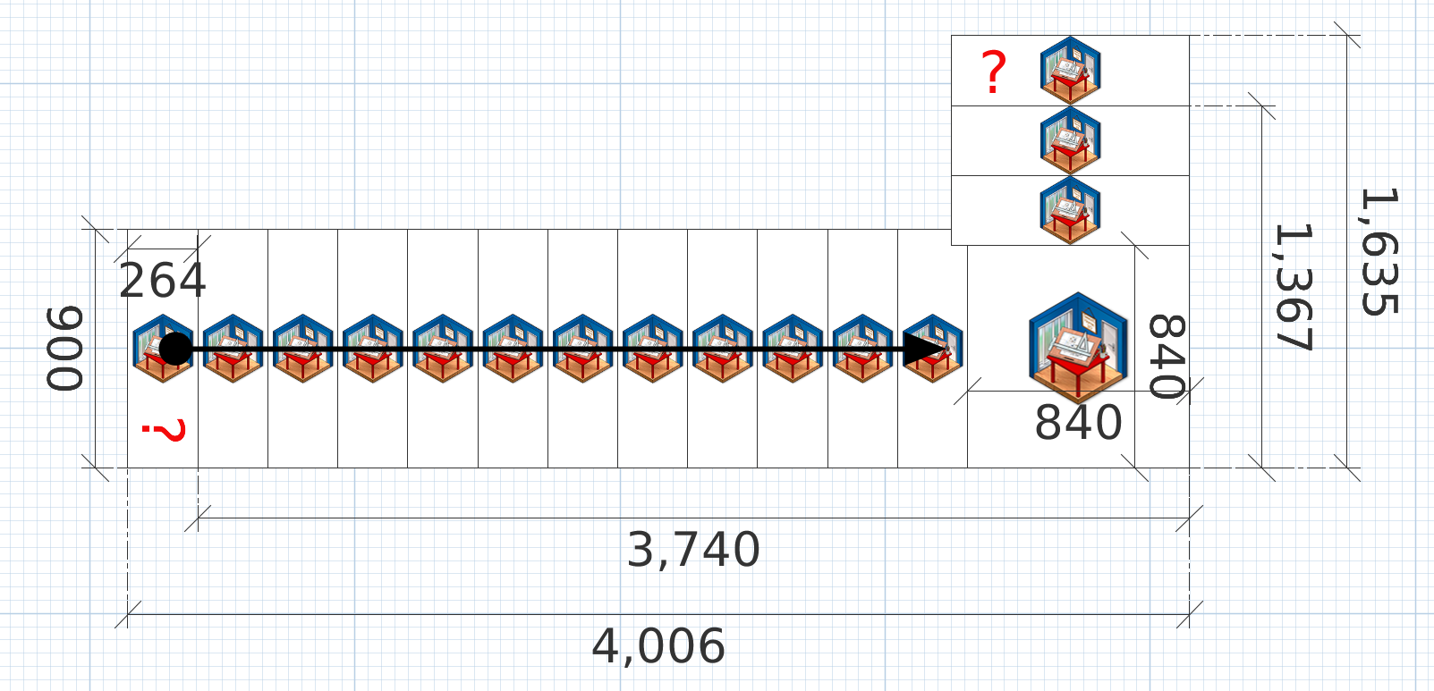

260mm is the going, the rise i am considering is around 178mm
many thanks, I get the point will do it 900x900
if 36 degrees is shallow what am i doing wrong here? according to what i found in the forums 264mm going is not much and 178mm rise is not very shallow, i am confused the calculator does give me a .6mm (178.6mm) for each rise but it then lists the height each step should be along the run and in that lists there are no partial mm and if calculated some are 178 and some 179. with regards to the tolerances you are right I might have some play there. the 900mm is the tread, i get the point. here are the 2 options from the calculator, i highlighted the relevant in red Many thanks for your help
I used https://www.blocklayer.com/stairs/steel-spine.aspx to calculate it advised to do some rises at 178mm and some at 179mm, this gives me 34.1 degrees, I am not sure but it feels a little horizontal to me am i right? the other option i get is 1 step less and rises varying between 190 & 191mm resulting in 35.8 degrees, i think the degree here is fine but i think 190mm is a little on the steep side, no? my current stairs are 184mm rise by 260mm going and are pretty comfortable, after works the total height will be 27mm higher then now, I don't mind adding another stair for comfort but going from 184mm to 190mm rise seems i will loose the comfort, please advise if you think I am wrong. I wont make the staircase wider then 900mm as my hallway is 2500mm wide and do not want to take away to much from the width. my current stairs are 840mm and I had no problem taking up furniture.

I know its an old post, this post has helped me alot but need a little further help. My total rise (including top tread) is 2857mm, I am planning to make my staircase staircase 900mm wide, going 264mm, rise 179mm with a half landing 3 or 4 steps from the top (have not yet decided how many steps i want after the half landing due to space constraints) I have 2 questions i am grappling with , a. with a rise of 179mm I am left with 7mm spare so 1 step will have a 172mm rise, question is where is the best place to put this lower step, bottom, half landing or top landing? b. to save space I designed the half landing 840x840mm with the higher stair overlapping is there any issue with this or does it seem good? (see attached image) (The pros and cons for if to put the step on the longer or shorter run is that if I put it on the longer run the staircase will start 1725mm from the front door and I prefer to get a bigger distance, putting it on the shorter run however makes for a smaller landing upstairs and it also lowers the height of the main hallway under the stairs, i still need to decide which is more important to me 🤔) Many thanks for your help
