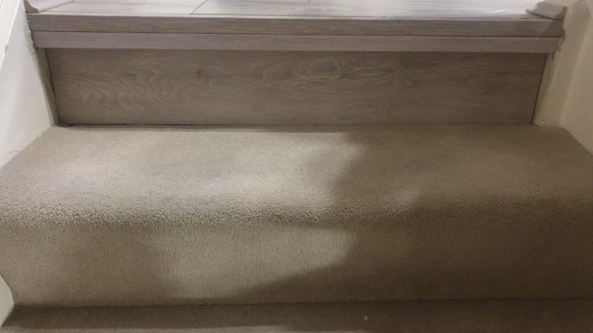

I measured my current one again, its old carpet and a toddle loose so its not possible to get accurate measurements, however the stairs vary between 260-264mm (inc nosing) going and 182-188mm rise, (bottom and 1st step from qt landing are 193mm) the big difference between this and the one i plan to build is the current one is carpeted therefore i think its a soft landing whereas the new one will be wood, I am not sure if this makes a difference and if i should therefore lower each a few mm? The top stair is 190mm, no 1 has ever tripped (since i replaced the carpet on the landing (increasing the height) ~9 months ago) maybe because there is a visual difference (see image) the other issue i found is when measuring at first I did not really pay attention to the nosing as the carpet on the rise looked like its only a few mm in from the top small enough to be ignored, however now that i measured nosing to nosing i found that my nosing is around 22mm giving me an actual going of 242mm vs what i thought before to be 264mm. according to the calculator if i were to use the nose to nose measurement at 242mm and rise at 189.5 it will result and a 38.1 degree, i cannot use the same for the new steps as total rise will be slightly more, to achieve 38.1 degrees I can use 244 going (no nosing) and 191.1 rise (R*2+G=626.2) th4 going will be very close to the current only the rise will be more, not sure if going with a rise of 191.1mm will be comfortable. Thank you all once again for your amazing help.
the rise i am certain is 184, what playing on my mind is that the going might be 240mm and for some reason i am working with 260mm. thanks

many thanks, seems the like my current shallow degree is based on the going part, will have to remeasure my existing staircase and see (the after works the height will increase by approx 27mm so cannot use the exact same measurements for the new one). Many thanks for the link, was a eye opener
