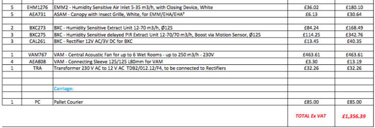

My quote from BPC was £1200 for the unit (Vent Axia) and £1k for the ducting. I would also need to get it installed as sadly I don't have the skills. I've had quotes from the usual guys - CVC Airflow, Total home ranging from £3-5k which I was expecting. Then the DCV was brought up which I'm exploring on the basis of capital cost, running cost, maintenance, IAQ, control and commissioning as it seems to have something in it, but I don't yet have enough information to confirm any claims or merits. -

I do have a quote for the DCV. Design and supply only. To cover 4 wet rooms and 5 rooms with air inlets. Doesn't include ducting which is bog standard 204x60mm or 125Ømm ducting. The claim is that the installed cost of DCV is usually approx. 60% the installed cost of an MVHR system -

Afternoon all I'm a new member and I'm planning to build a timber frame home with a target fabric air tightness of 1 ACH and the u-values of the home will be 0.14 w/m2. On the good advice of others, I had only ever considered MVHR as an option for our ventilation solution. Though the cost makes me shudder a little. However, I recently spoke to a consultant who spoke about ventilation strategies and suggested many options I hadn't even heard of. Some not appropriate for my build e.g passive stack, but one that caught my attention - Demand Controlled Ventilation. . It's an occupancy and humidity controlled system that uses CO2 sensors and humidity sensitive extract grilles and air inlets that react to occupation in rooms whereas MVHR runs at the the same rate whether the house is occupied or empty. There were points that made it sound like a credible alternative to MVHR. However, it is not a heat recovery system and doesn't temper the air that goes back into the room. The eyebrow raiser for me is that I don't know of ANY private residential project in the UK that has heard of it let alone installed it! Commercial yes, student accommodation, apartments yes. Ireland and mainland Europe yes. I have scoured this site high and low and not a mention of DCV within the most clued-up, switched-on self build community. Anyone know anything about it - good, bad, ugly?
