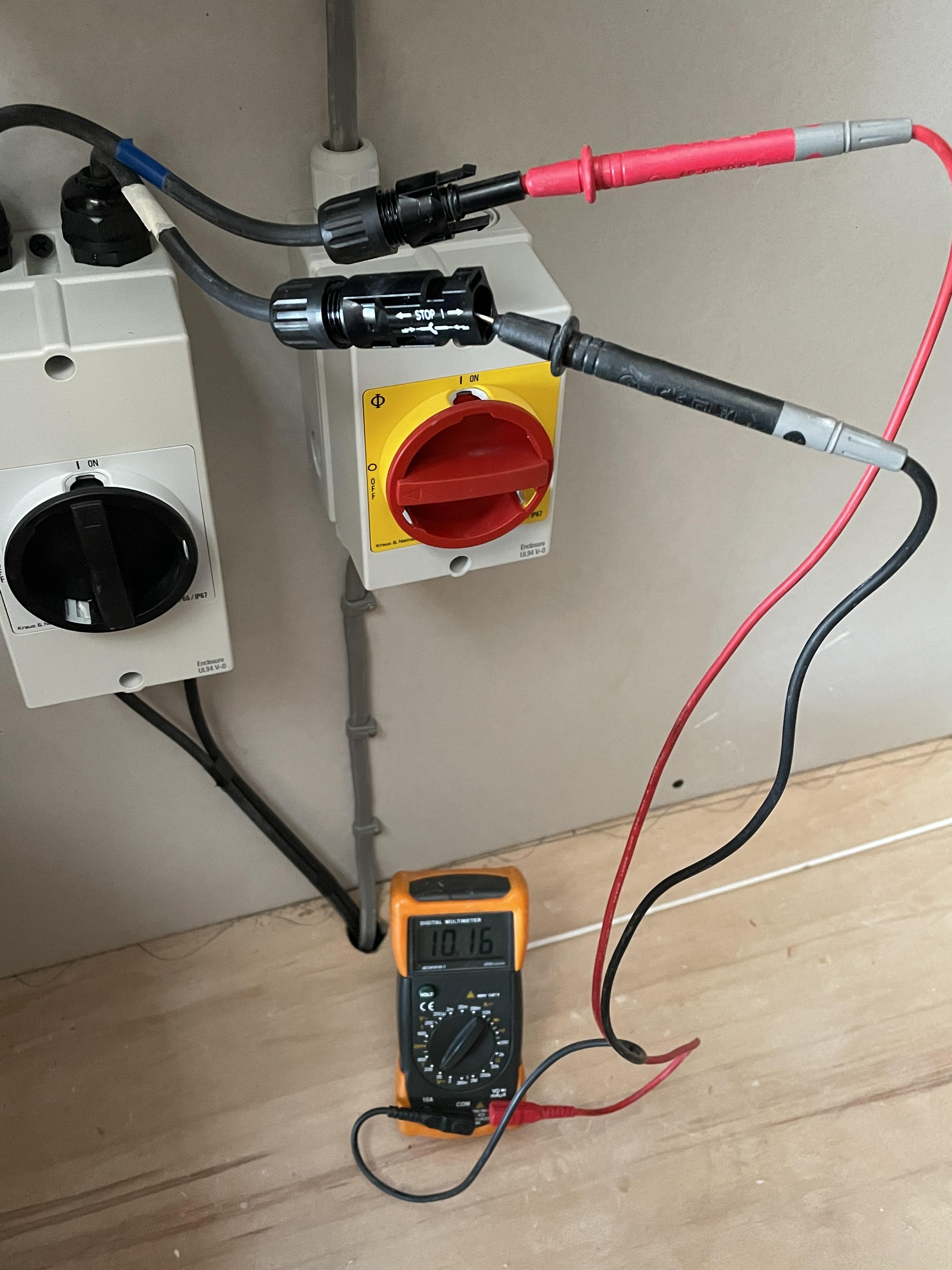

That female MC4 with the red multimeter tip inserted inserts into the +ve labelled connector on the inverter. And seems from the multimeter reading that the polarity is therefore correct. thanks for all your consistent help with this by the way - really very much appreciated! -

I believe so yes. I’ve checked it a bunch of times with a multimeter and pretty sure I’ve got it right. difficult to explain in words so hopefully this photo makes sense! -
