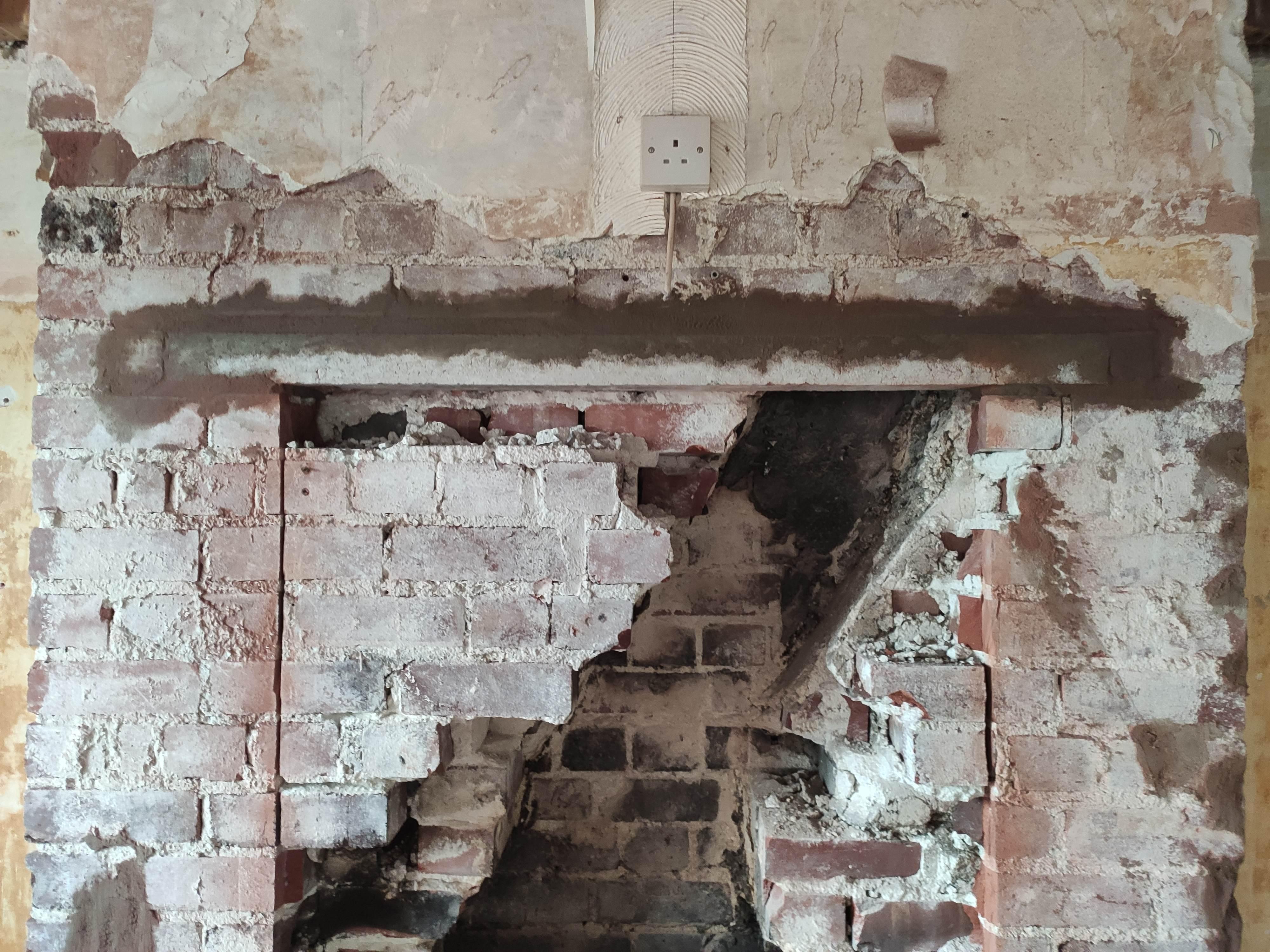

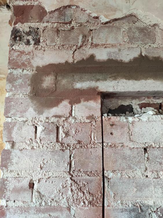

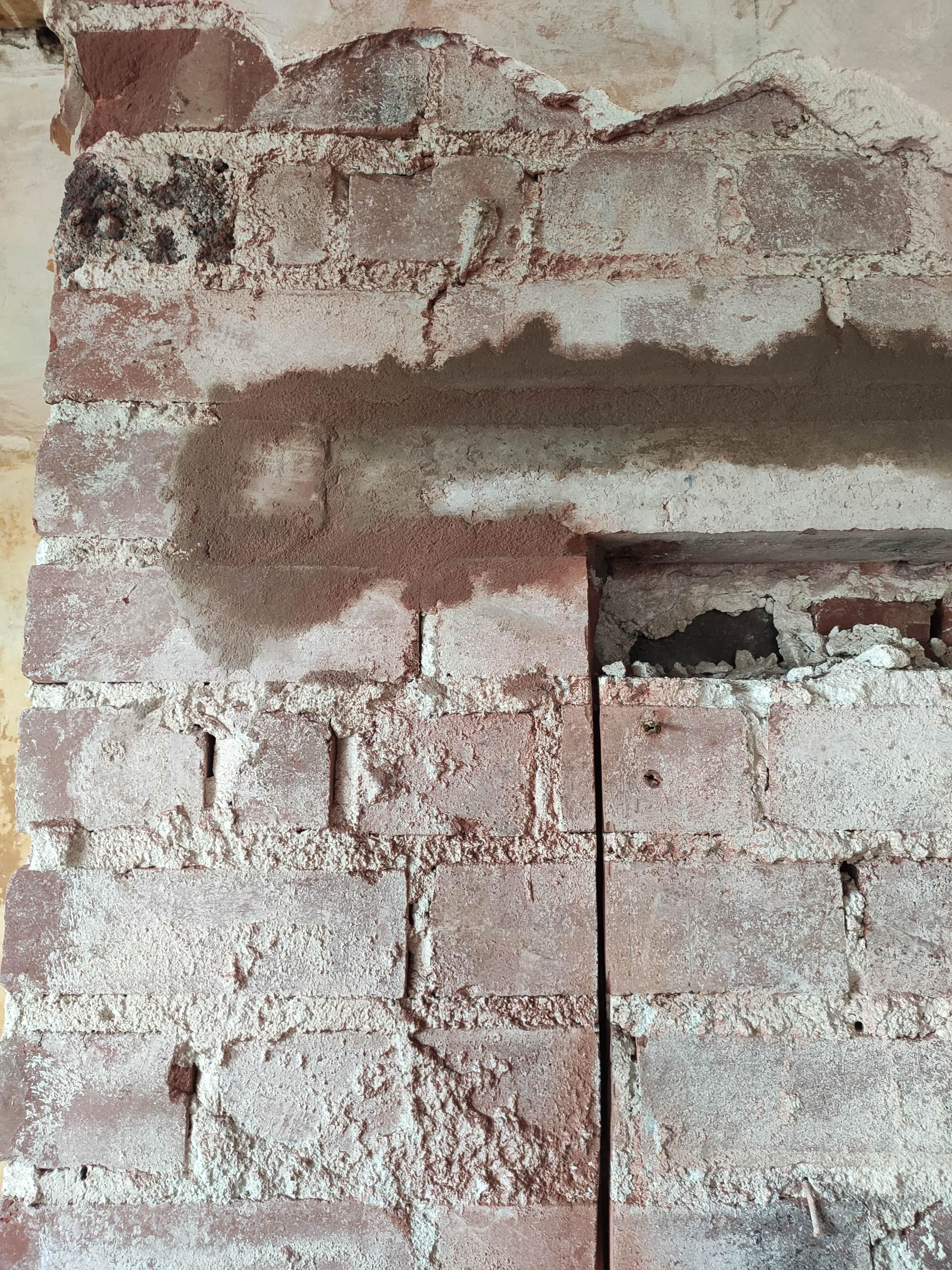

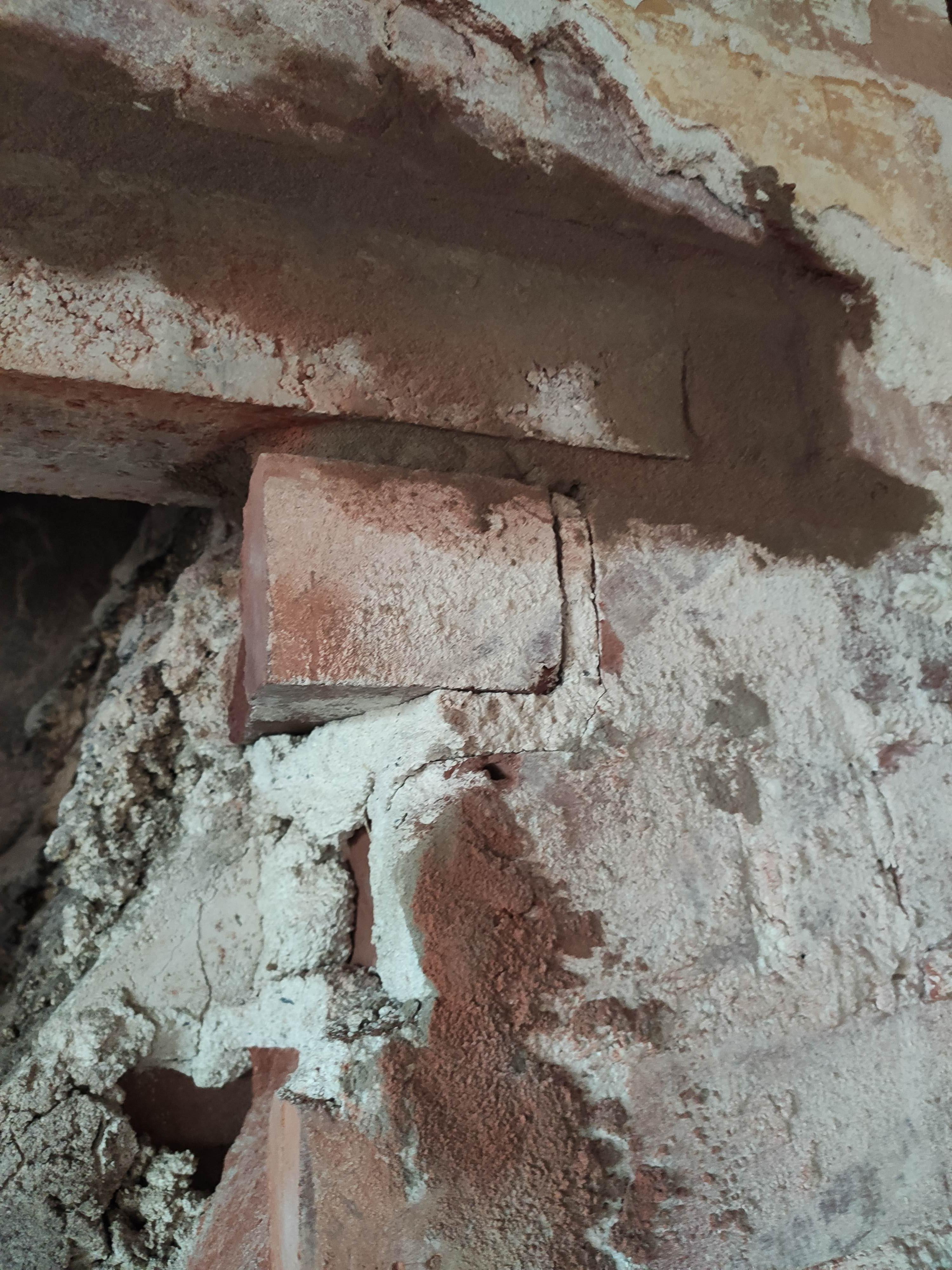

  4. Hello all, started to remove/open up the chimney breast in this 1930s house for a hob top. Breast is 1545mm wide Lintel is 1200mm wide The ends of the lintel sit on 150mm of brick This is the first time so unsure on a few things; 1. The brick work inside the chimney is only sporadically tied into the front wall with bricks going side ways. Do I need to support the inside section with anything or is it another being tied into the front facing wall? 2. Most annoyingly the brick pictured on the right hand side has come loose and the brick below hasn't broken off cleanly so I'm concerned the overall support for the lintel is no longer enough? How could I rectify this? Any other points you notice please let me know. Many thanks

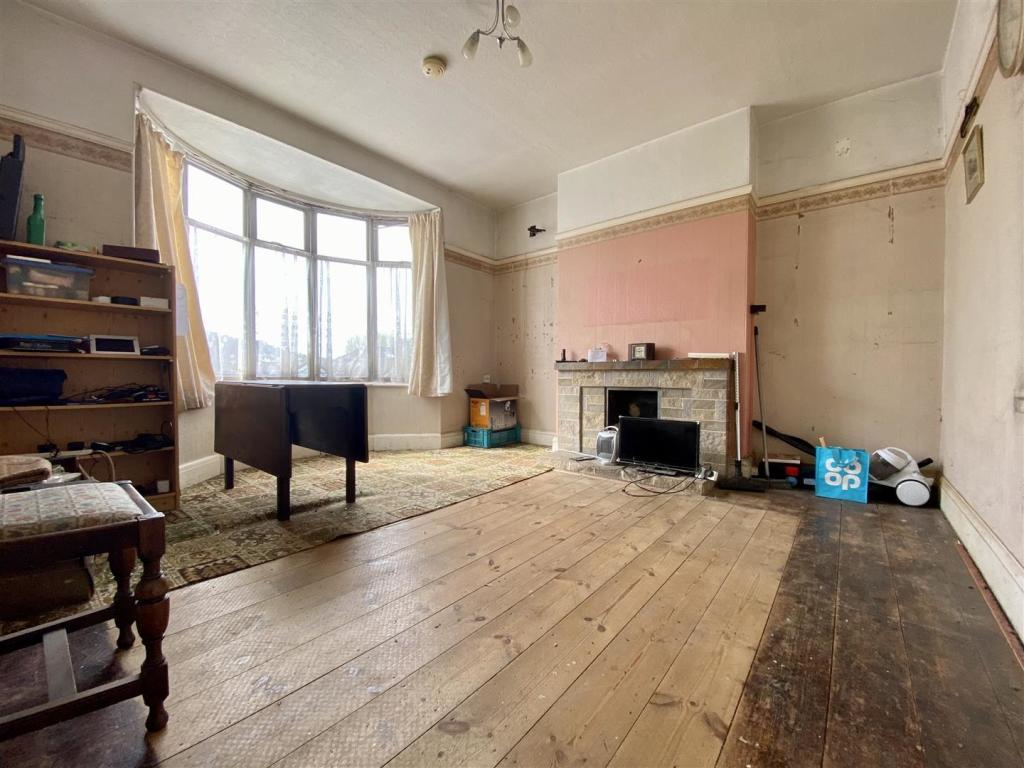

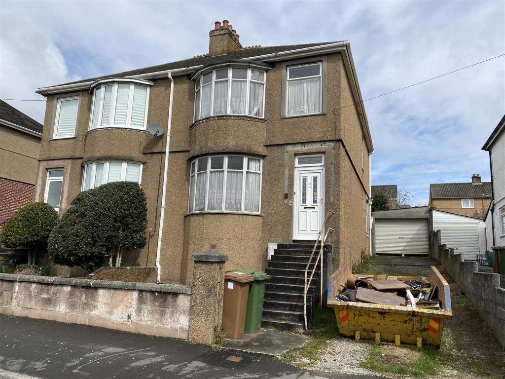

  22. Hello, Just had an offer accepted on a 1930's Semi typical house, need a full renovation and wanting to future proof it as much as possible as it will hopefully be a home we keep and pass on. The house has no insulation, no boiler/radiators (does have a gas supply) It has suspended timber joists 400mm centres thoughout. I originally planned on a GSHP with UFH but due to cost, budget and not really having the space we are going for a combi boiler (Probably Bosch Greenstar 4000) My questions is whats the best method? From what i can gather in my reserch screed is best and can be done with suspended joists but i need to check that it can take the weight? (assuming i need to get a structual engineer in?) If they cant whats next best? I've seen the ali spreader plates but not the best reviews as they seem to be noisy and not produce much heat? Also whats the best floor construction after the UFH, do i need a subfloor and if so wont this limit the amount of heat i get through? Any pointers or help is much appriceated, this is the first project ill be taking on and hoping to do it all myself, im an mechanical and electrical engineer so this is new for me but im keen to learn and i have no real time limit to complete.
