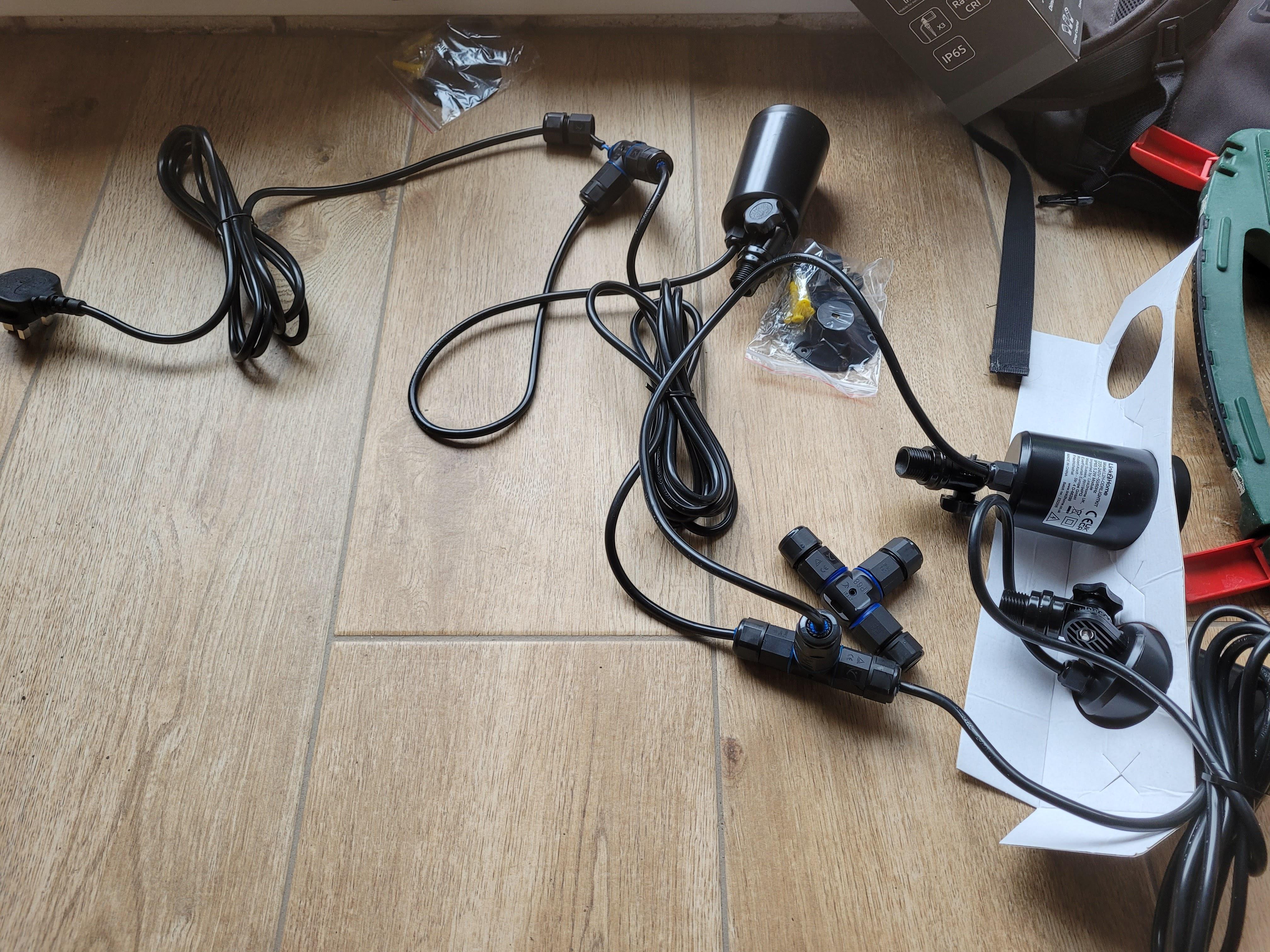

Yes they're connected to an external socket with a spur. In terms of my above proposal of daisy chaining them - is that feasible
I've had a set of 3 lights up for a few days and so far so good. The app is great and no problems yet. I did get them for £30 rather than £120 RRP so no major loss if it stops working.
Oh really? How so?
Hi I have two sets of 3 garden lights as shown in the attached image and 1 singular garden light. Each set of lights has a mains plug at the end of it. I would like to connect all 7 lights to one circuit by daisy chaining them. They are all connected via these T connectors: https://www.amazon.co.uk/Waterproof-Junction-Outdoor-Connector-External/dp/B091CJWCLL My plan is to connect them together via a 2.5mm twin and earth armored cable. I would remove the mains plug as it would be redundant. My question is the current cable is only twin (live and neutral) but I only have twin and earth armored cable. What would I do with the earth? Does this sound like a feasible DIY job? Thanks

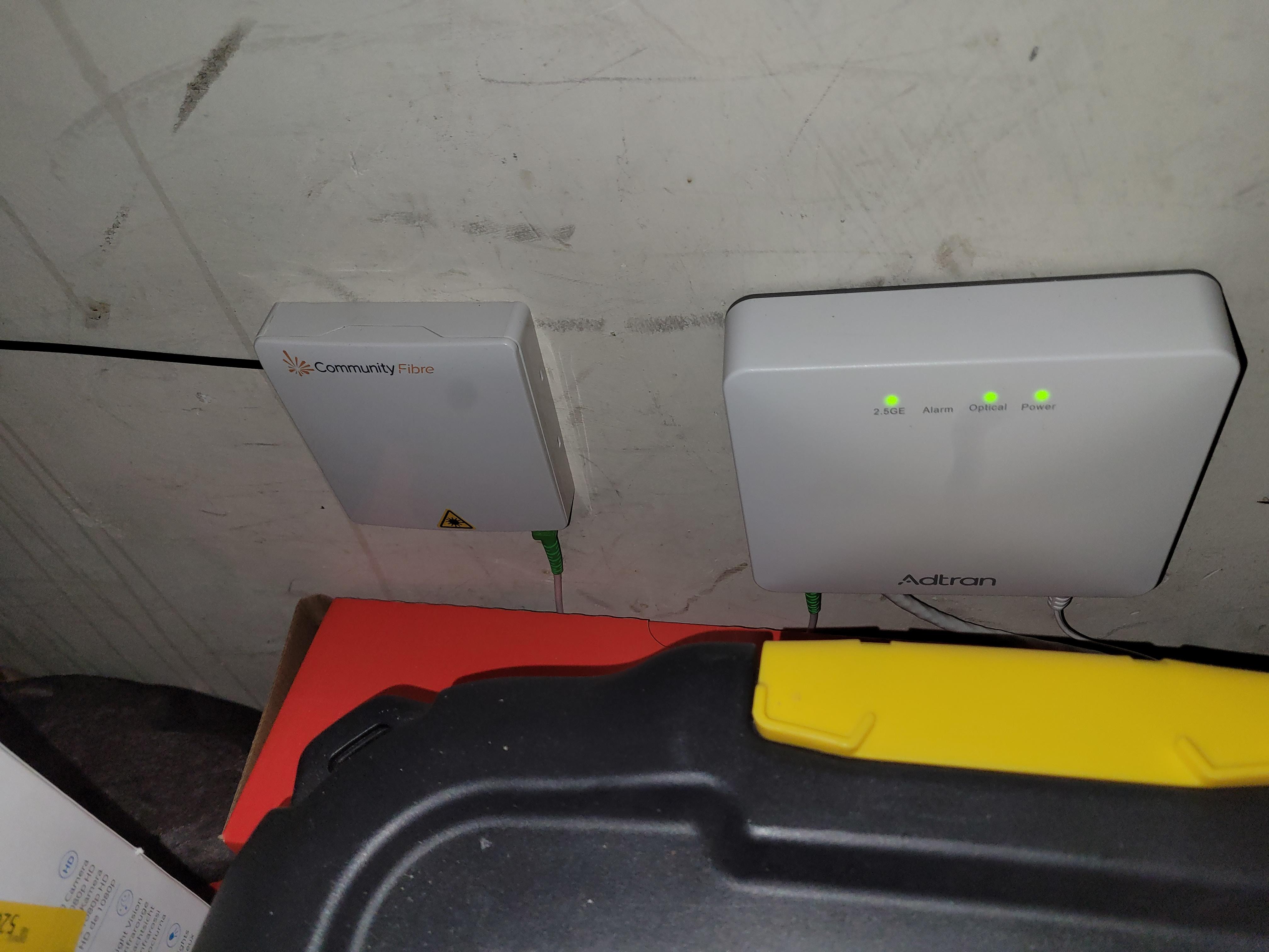

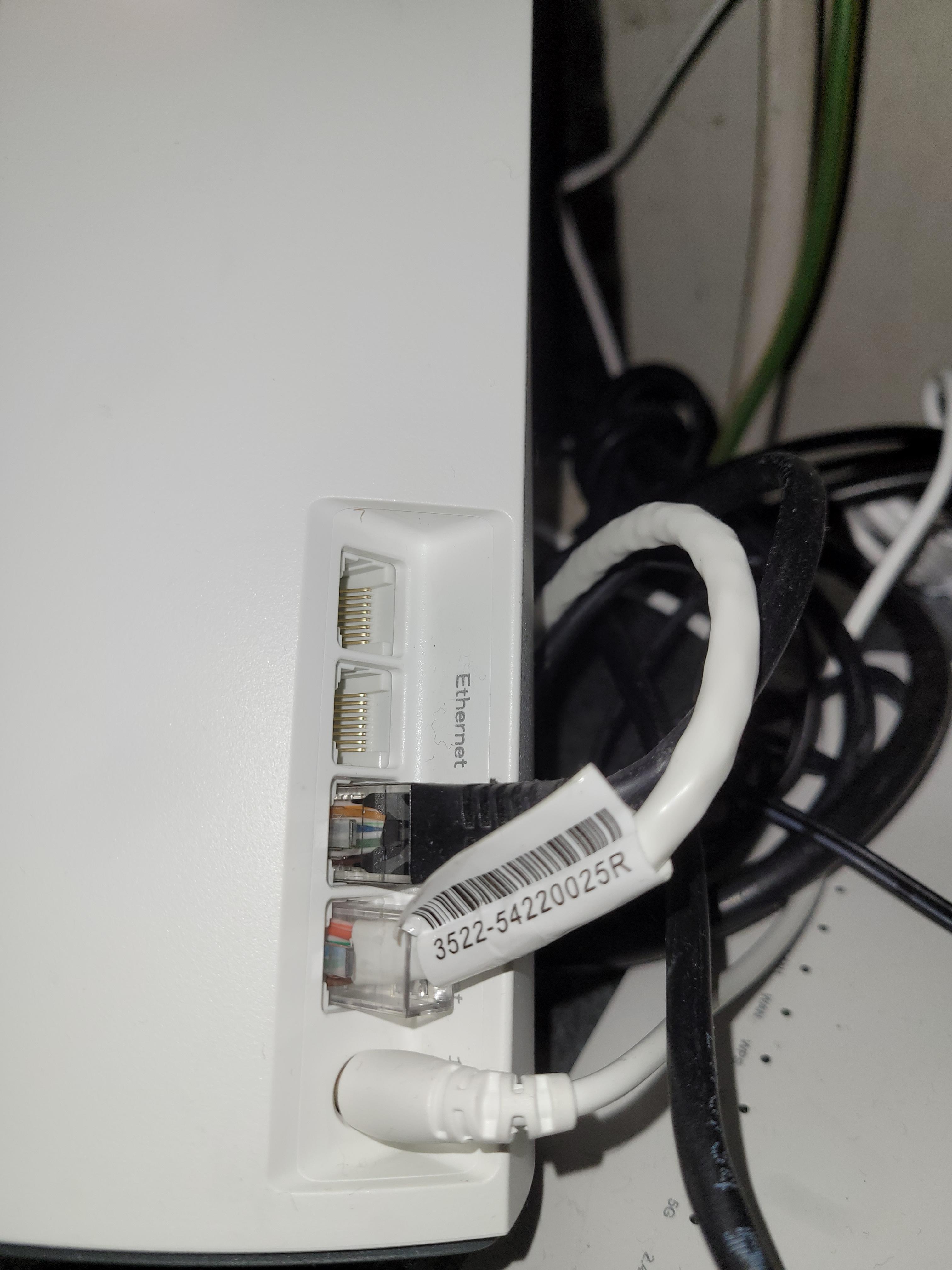

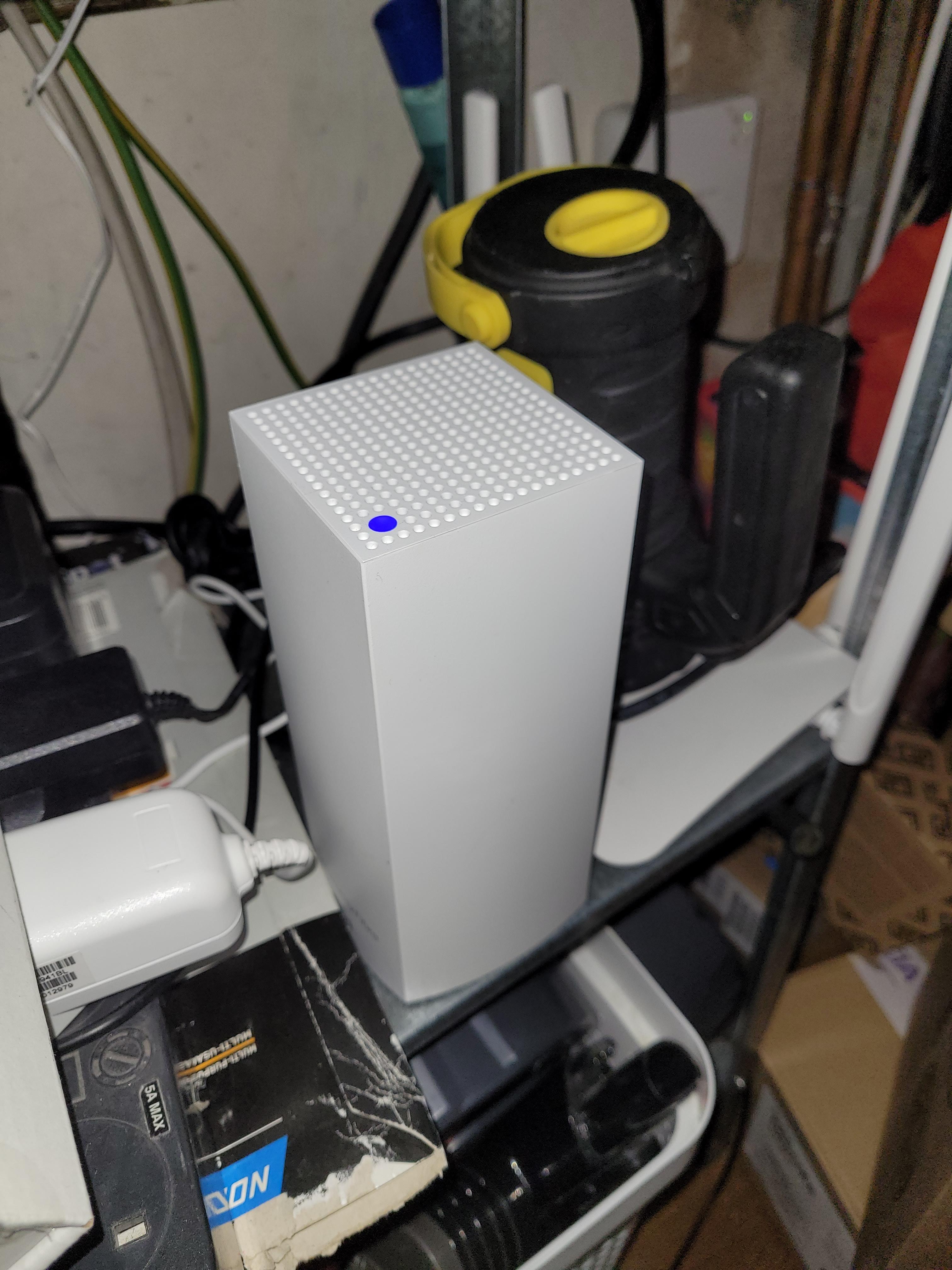

I have the two boxes that are attached to the wall. The WiFi router is plugged into the modem My WiFi does have spare ethernet ports but I thought for better performance it would be better to bypass the router and connect to the modem directly. However I only have one ethernet port on the modem hence I thought to buy a switch. The Wifi can be plugged into the switch and I can purchase another ethernet cable to run from the switch to the back room. That's my idea anyway...

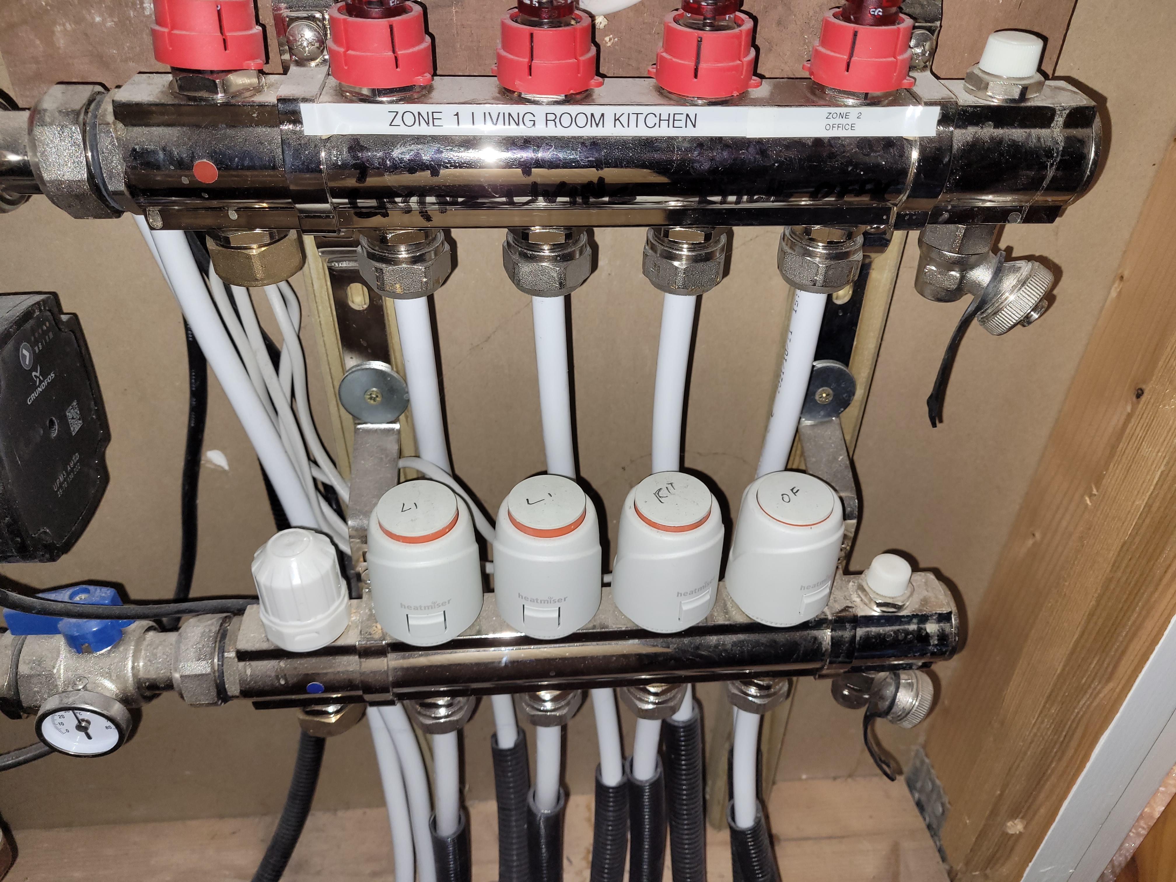

I have attached the bottom rail of the manifold. 2 x L1 is what I imagine the two zones to be and is controlled by one Nest OF is the office which is controlled by the Salus KIT is the kitchen where the installer ran some pipework via a back wall in case I want to put UFH there in the future. This is not in use.
I've just signed up to Community Fibre and the modem was installed under the stairs along with the WiFi router. I'm now getting a severe dead spot at the back of my house. I'd like to run a cable under the stairs alongside the external wall (semi detached) and into the back room Eventually I would want a wired connection to my laptop and then a Wifi access point My research so far has found I need a network switch that I would connect to my CF modem - https://amzn.eu/d/fBnhlB2 I can then plug in the mesh CF WiFi router into the network switch (??) I would then run an ethernet cable from the network switch to the back room I would need to fit an ethernet wall socket into the back room and connect the other end of the ethernet cable to the socket Are those steps correct? I'm unsure on the type of ethernet cable to get i.e. how would I connect it to the wall socket? Below is a picture of my CF setup Thanks
Hi I had UFH installed a couple of years ago and the installer laid the pipes in a way that the living room and dining room could operate as two zones. At the time however I decided that I would like one Nest controlling both zones just to see how it gets on. A couple of years on I now would like to have the dining room controlled by it's own Nest. I've spoken to a couple of plumbers and I'm not sure if they are understanding my requirement. From the pipework picture below I can see the dining room has it's pipes laid separately to the living room. However I'm unsure if what I'm seeing is in fact two separate zones. Am I making sense? If so is there an easier way for me to word the requirement to the plumber Thanks
