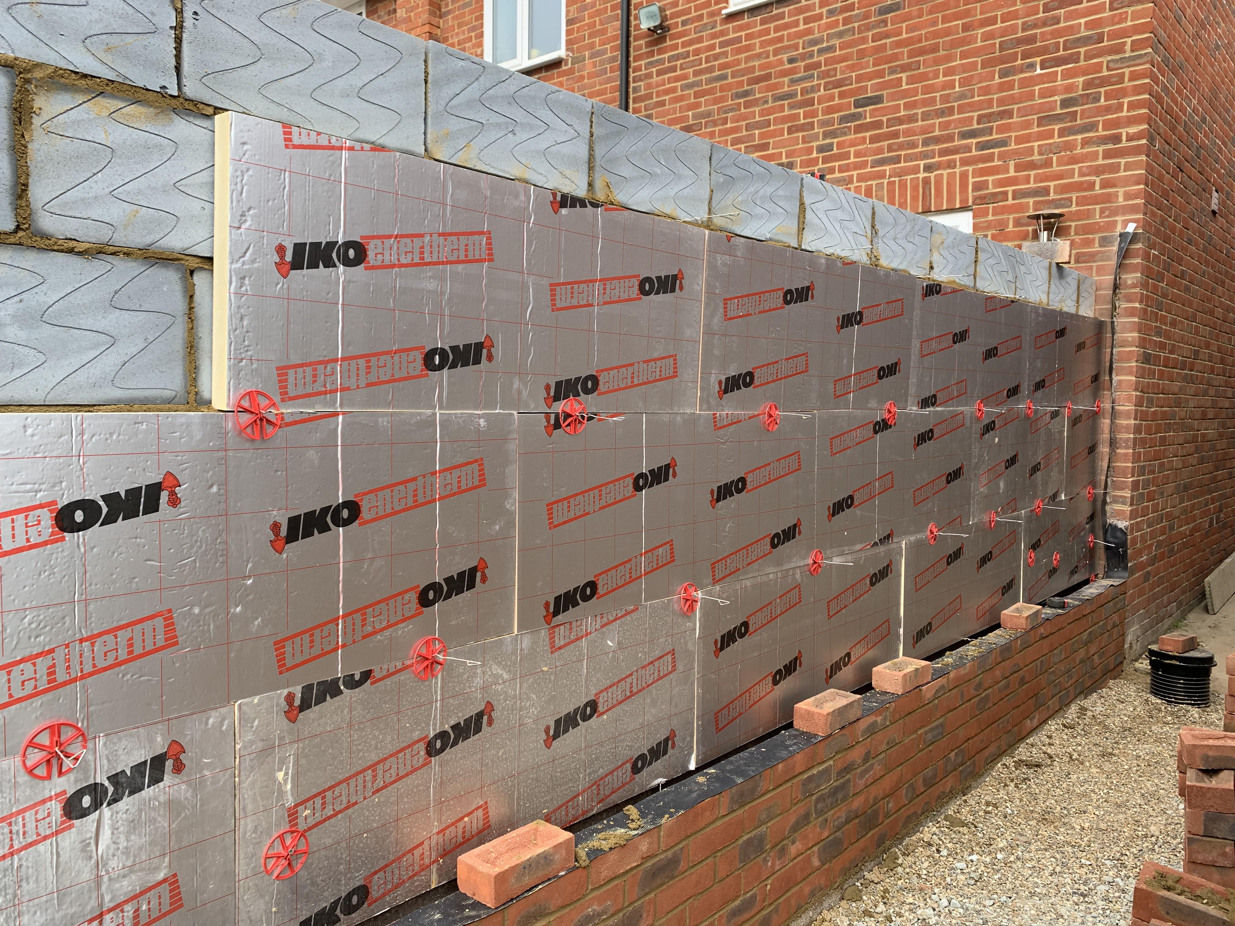

  9. Hi Gus. We had to grind a vertical Dpc into the existing wall because bc insisted it. It’s only 15-20mm in so not going to compromise the brickwork in any way and in my mind it does seem like good practice. You are right in it being a sheltered spot however. We will be going with 100mm celotex with screed on the top but I don’t understand what you mean but perimeter vertical insulation? The walls will be bonded and plastered. At the moment I think my best option is to grind a 25mm groove into the blockwork a fraction above the Dpc and gripfill the Dpm in and then cement it in completely. It would give me peace of mind. I’m open to other suggestions however 😃

  14. Yes we’ve got wall started ties in, you can’t see them because they don’t go on a rail they drill in every few course see… https://www.selcobw.com/staifix-stainless-steel-wall-starter-tie-pack-10 there is also a vertical Dpm in the adjoining. That’s there because BC told us to put it there. Look if I’m honest it’s partly my fault, I knew it needed to tuck in but was distracted and before I knew it the time went by. I’m paying the bricklayer on a day rate and don’t want to demolish and start again. But do you have any better ideas other than grinding it in? Appreciate the reply
  15. Along one of my walls the Dpm hasn’t been over lapped into the inner skin, it’s also in places not long enough to get in there anyway. is the best option to grind out a channel in the Dpc course and mortar it in and also tape more to it where it’s short ?
