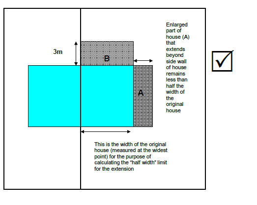

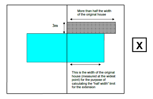

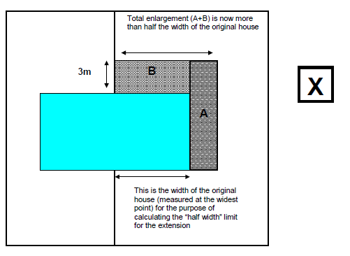

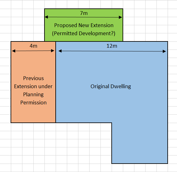

philnic's Achievements

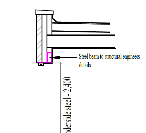

  1. The detail is now slightly different as i'm hanging the joist with hangers rather than sitting on a wall plate. The bottom joist is a 47 x 200 joist, with furring's, then 150mm insulation, not another joist. Any suggestions on the cold bridge, if there is one??

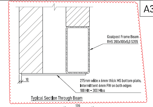

  2. I have the below detail for the 6m wide lintel above some new bifolds in my extension. The RHS goal post sits in line with the internal blockwork and has a continuous 6mm plate welded to the bottom to support the outer brickwork skin above the doors. I'm worried that this plate will permit cold bridging. I intend to dot and dab plasterboard down the wall and return in to the door head, but is this enough to prevent cold bridging through the plate? Do you have any suggestions or products to help avoid this, or am i worrying about nothing?
