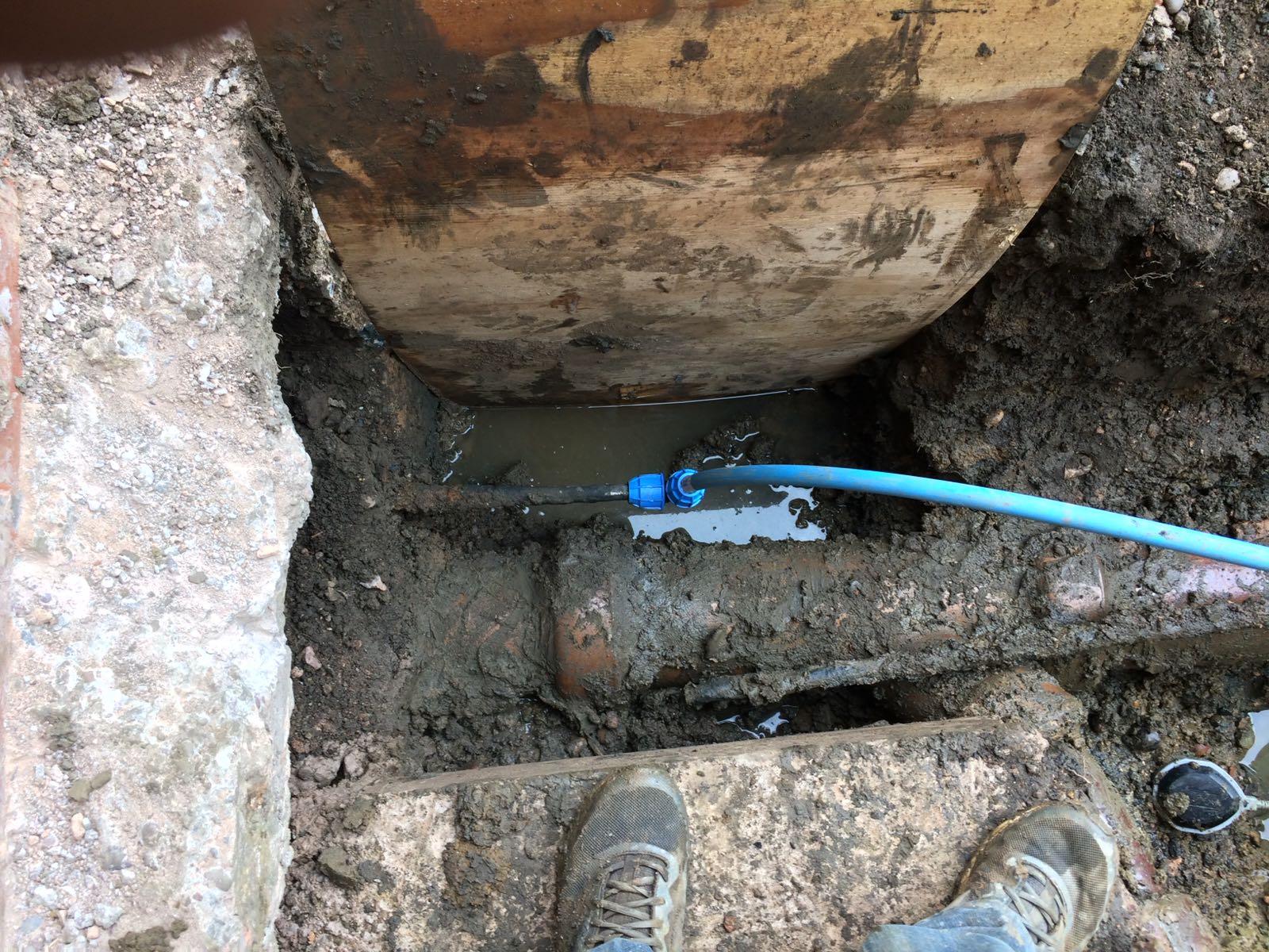

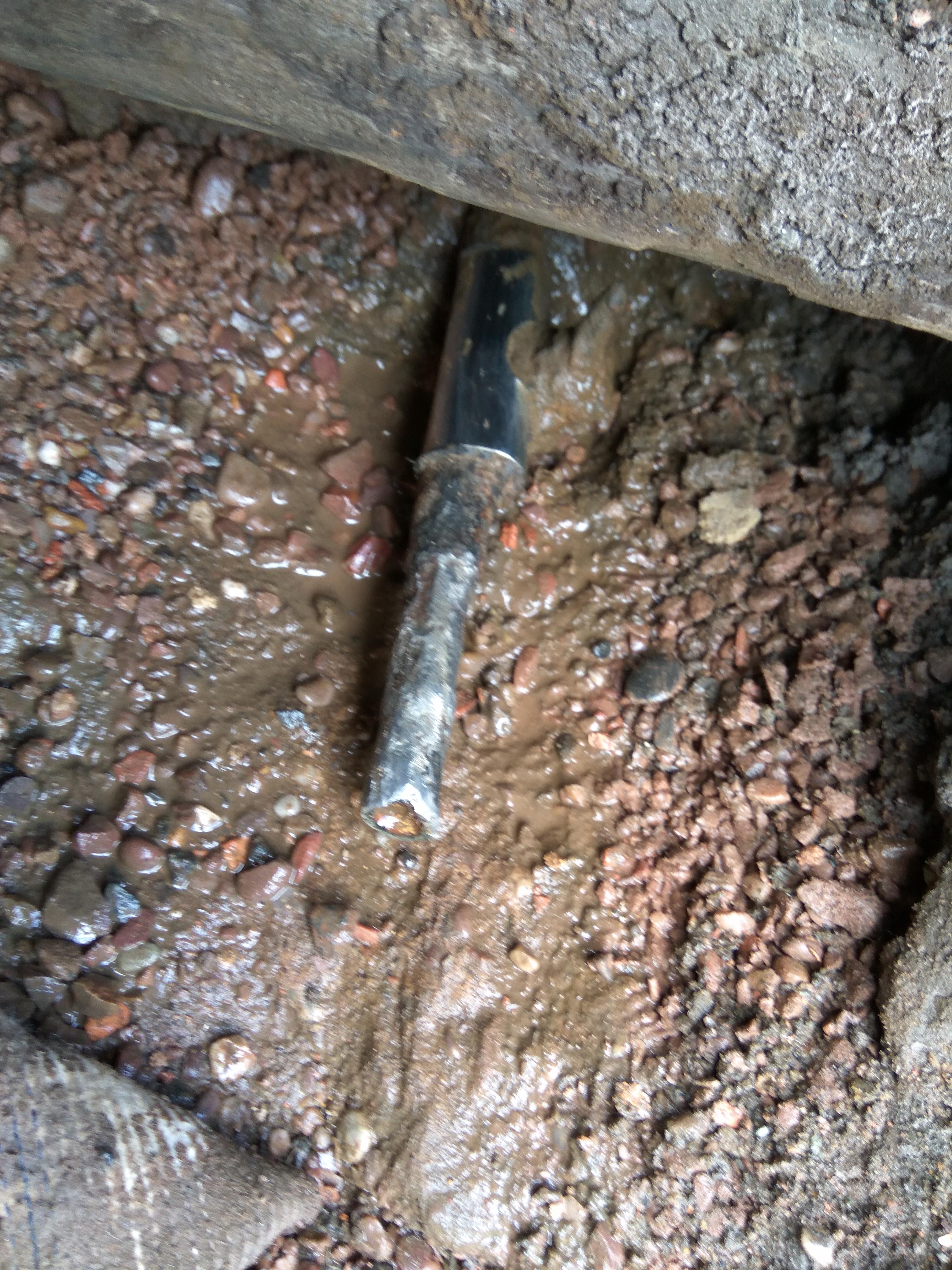

  4. Thanks for all the replies. I managed to get next doors landlord in today who has agreed to foot the bill his side and use the guys i've got in I attached the pipe to a Philmac 15-21 adapter and that seems to have stopped the leak as well temporarily Strangely enough though the pipe looks to be attached to some kind of stainless steel piece. It was only after polishing it up that i noticed. Not too sure what it is but I think its some kind of clamp?!

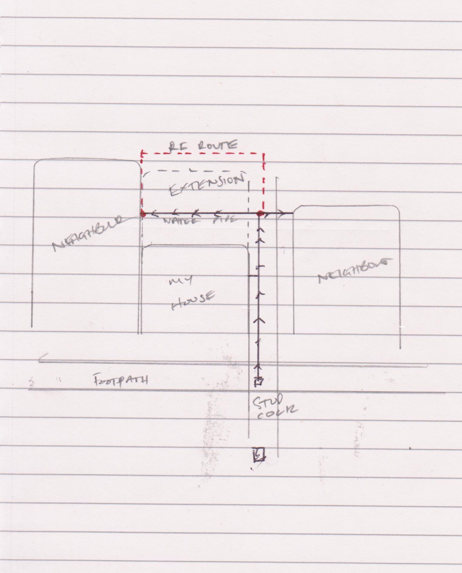

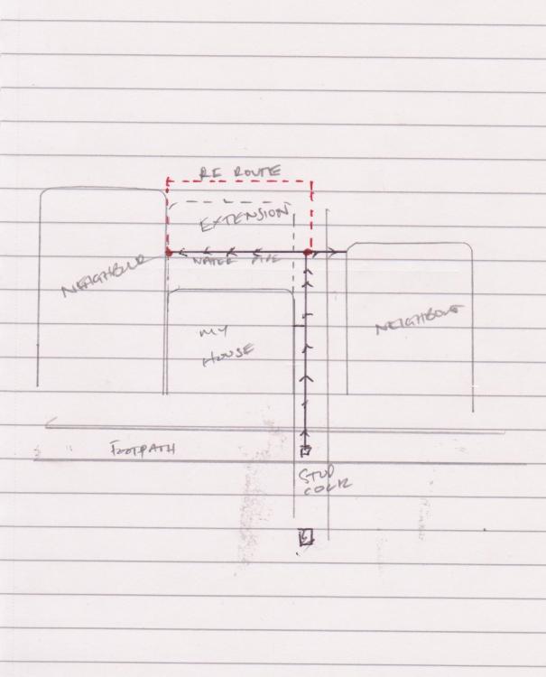

  6. I'm going to re-route it around my extension , so it wouldn't actually be going under mine. The stop cock comes up from the pavement, down the side of the house, feeds into mine then goes a bit further up and the tee's off left and right. It feeds the property on the left (where the pipe is and two properties to the right. So where it tee's off i'm having all that replaced to outside the front print of the extension, with the intention replacing all the way up to stop cock . But I cant do anything about the pipe feeding onto and under the neighbours extension. Yes, my thoughts as well.
  7. I have discovered a corroded water pipe which come out from underneath the neighbour’s extension while I’ve been digging my footings. The entire pipe was gone, I’ve started to replace everything from my side with mdpe up to the stop cock and reconnect the neighbour’s water however none of the fittings I’ve bought seem to catching onto the old pipe from the neighbour side and its constantly drip leaking There’s only a short bit of pipe to work with before it disappears into concrete. So i need to be careful on how to best put a permanent fitting onto the pipe as it will be between the party wall. Had a plumber out today and he said he hadn’t seen a badly corroded pipe like that for a while, he couldn’t guarantee the work so wouldn’t touch it. It’s been suggested to re-route the pipe around the neighbours back but really don’t fancy going down that route. Their house is rented and I’ve never met the owner. It’ll take weeks to sort something out I don’t want to but I’m seriously considering getting someone to come in after the BC inspection and solder on a fresh piece of pipe that we can work with! Before I do, is there anything else I could possibly try or do?
  8. Metal of some sort. Its not the ST Main - its a 20-25mm clear water pipe My service is in black, on the plan. In between my house and the vertical pipe from the footpath
  9. I’ve been getting my footings done for a rear extension and while exposing the Severn Trent main pipe we found a 20-25mm lateral water pipe to the side of it as well, which is rotten through and has sprung a leak in the middle of my footings (I’ve currently cut out a section and put in a 20mm MDPE pipe with stop cock) The main stop cock is at the front of my property and a pipe looks to run down the right side of the property under a path which leads to the garden. There’s a T junction about 3m away from the property which then goes both left and right to feed both the neighbouring properties. The neighbour to the left already has an extension and both the ST main and this water pipe both run under his extension. The problem is I’m building my wall right up against his and I’ll need to cut the pipe and re-route it around my new extension as per South Staff instructions. I’m concerned that in the future if there’s ever any kind of leak then there will be no way to access and repair the new joint. Not too sure how to tackle this. Even leaving a small gap between the extension and the neighbour’s extension wouldn’t really be enough space unless realistically I leave a 500mm or so gap? I’ve attached crappy pic to explain but would appreciate any suggestions on how best to go about it without reducing the extension size.
