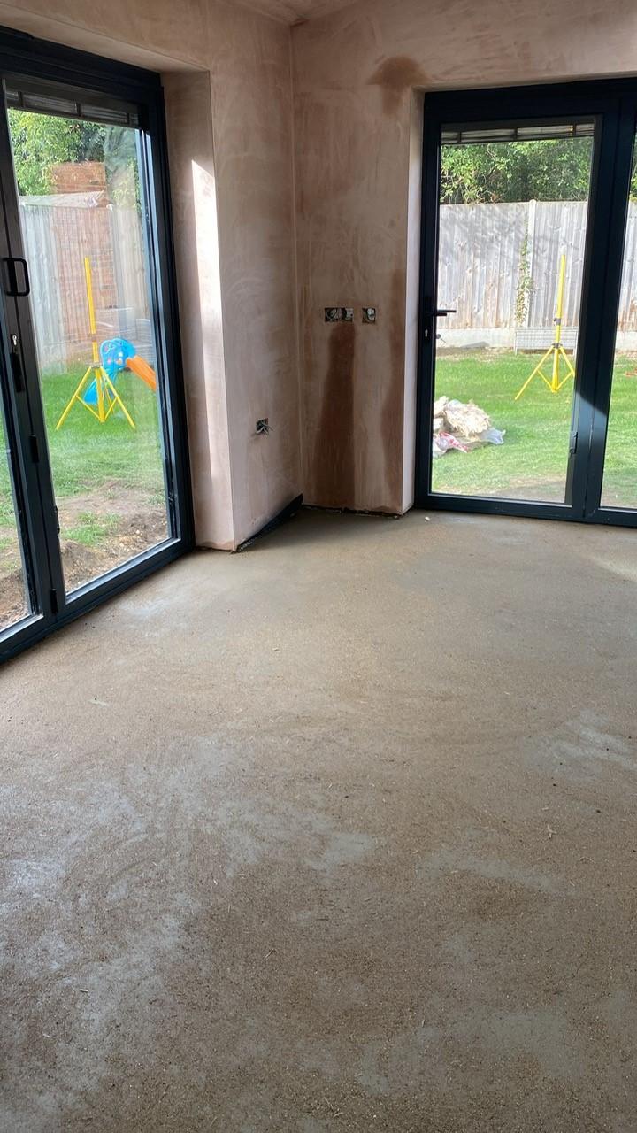

Hi, I have a query that I was hoping someone could lend some advice on. We had our bifold doors installed a few weeks ago. They left an oversized DPM flapping on the internal side of the doors, and the fitter specifically said we needed to 'turn up the DPM under their product prior to the floor installation'. I have returned home to find out that our floor insulation and screed has been laid and the above has NOT been done. The oversized DPM was instead lapped with the DPM that was placed under the screed. This essentially means that the screed has been laid in direct contact against the bottom of the aluminium door frame. Is this okay? Or does this present a real risk of corrosion of the frame in the future? Pic attached for reference. Any comments would be appreciated.

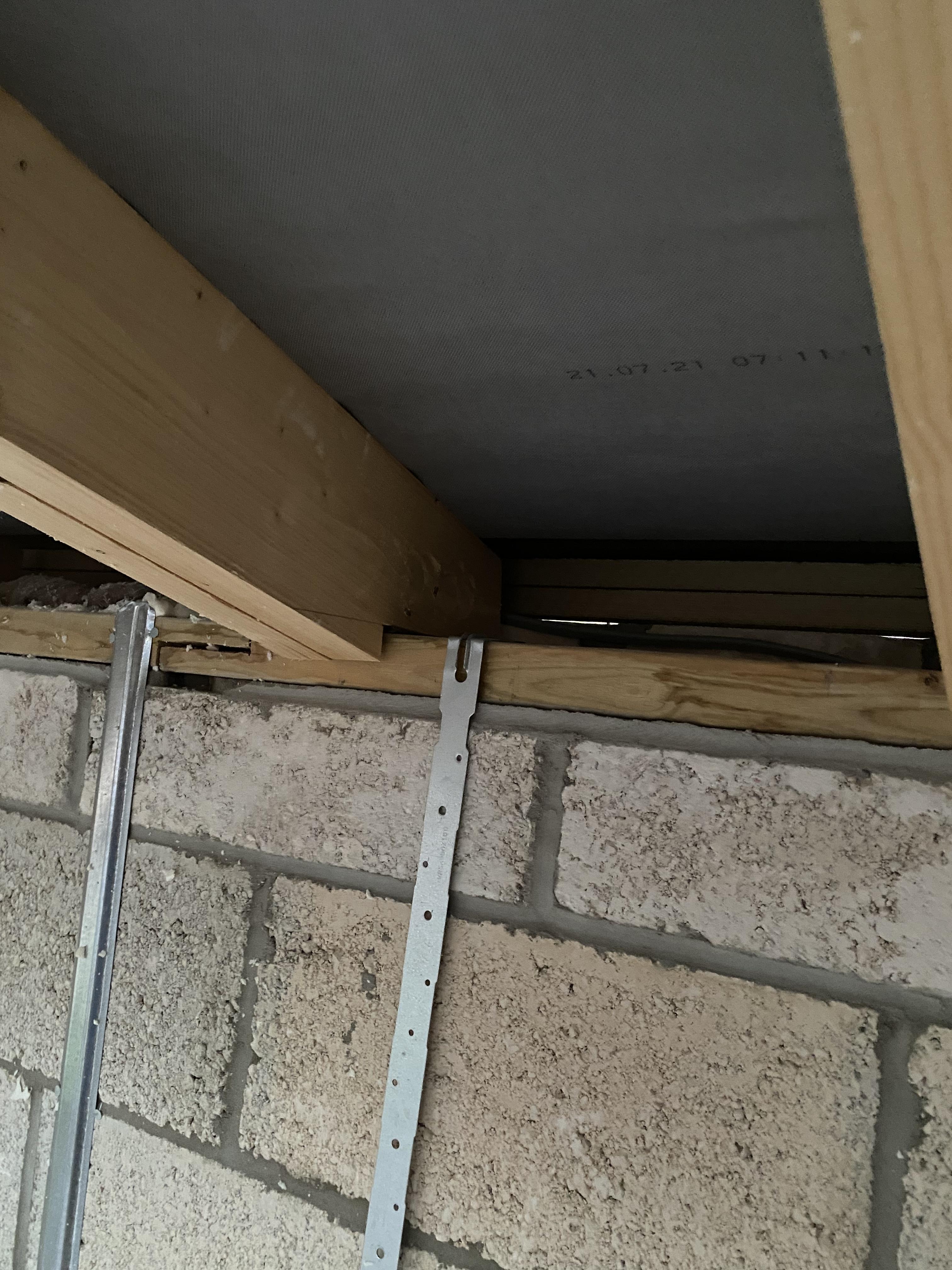

Thanks for the reply. I can drill the holes from the inside to ensure that I do not hit rafters. Therefore might the drilled holes idea work? Pic attached.
Hi, We’re well into our extension project and I fear we’ve encountered a problem. Hoping for some advice on a suitable remedy. The roofer has progressed the roof but has NOT installed a proprietary eaves ventilator. He is a friend of mine so I am hoping there may be an easier solution opposed to having an awkward conversation with him about stripping off the roof tiles to put one in. Would this work… at the top of the external wall we have two strips of timber (see pics). Would drilling a series of holes into these timber pieces allow air get into the underside of the roof for ventilation? Any help would be appreciated.

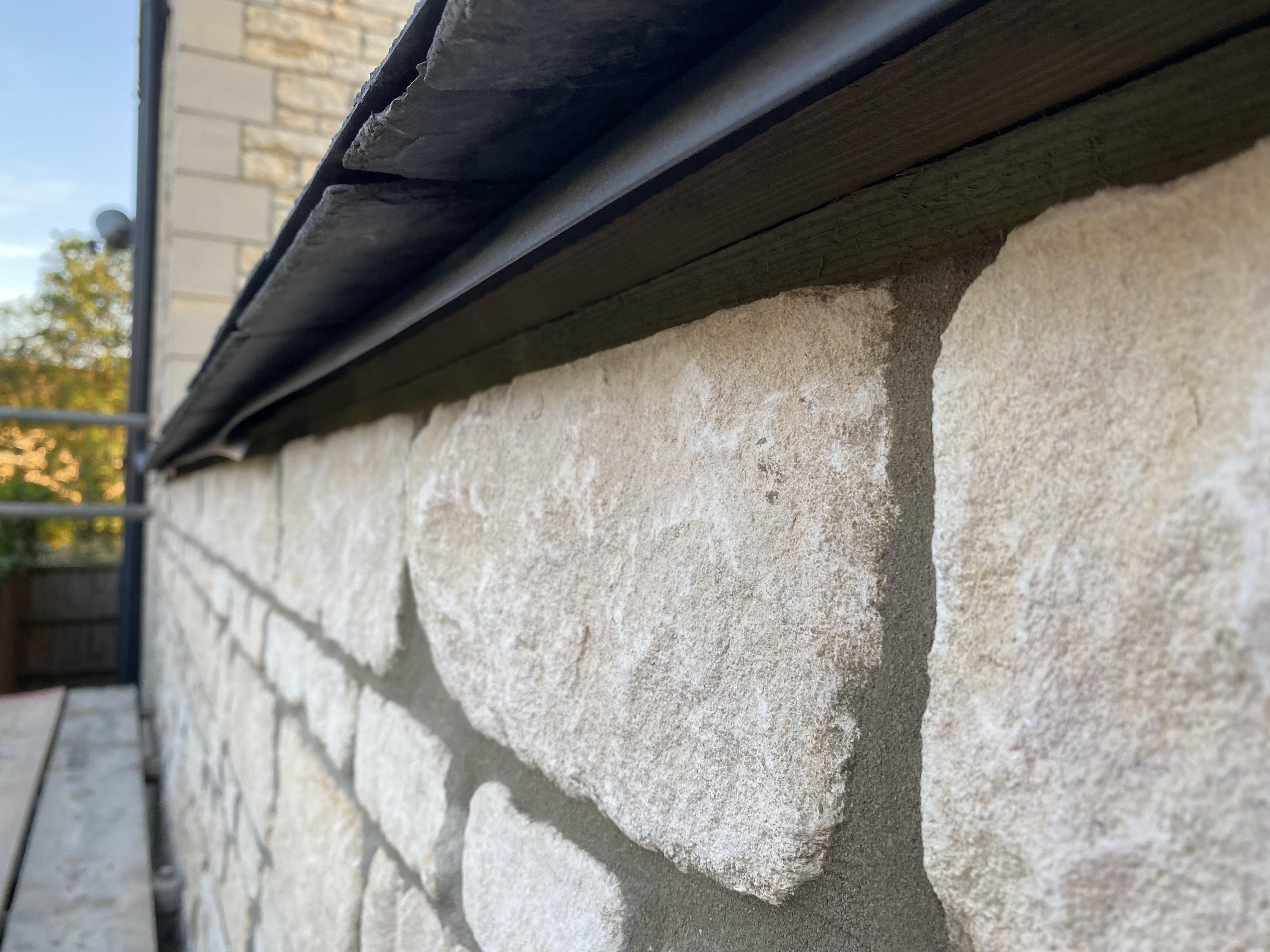

Thanks all for your comments. I'm starting to think that a last minute switch to a flat roof is probably a good call? Obviously this would completely eradicate the issue with the ridge height, and retro fitting a cavity tray would be much simpler to do along a horizontal line (note that the stonework is in varying heights and widths, which will make retro fitting a cavity tray diagonally a very complex and expensive task). A friend of mine who is a good with 3D stuff did actually draw this option for us when we first started planning this project. Obviously it's a change to the approved planning drawings, so I'd need to agree it with planners, but as it's to the rear of my property I'm not too worried about that. Brickies are due for their final visit Friday, so this is all very late in the day! But better late than never I guess.... I'd certainly rather be having this discussion now instead of when my rafters are in place! Any further thoughts would be really appreciated. -

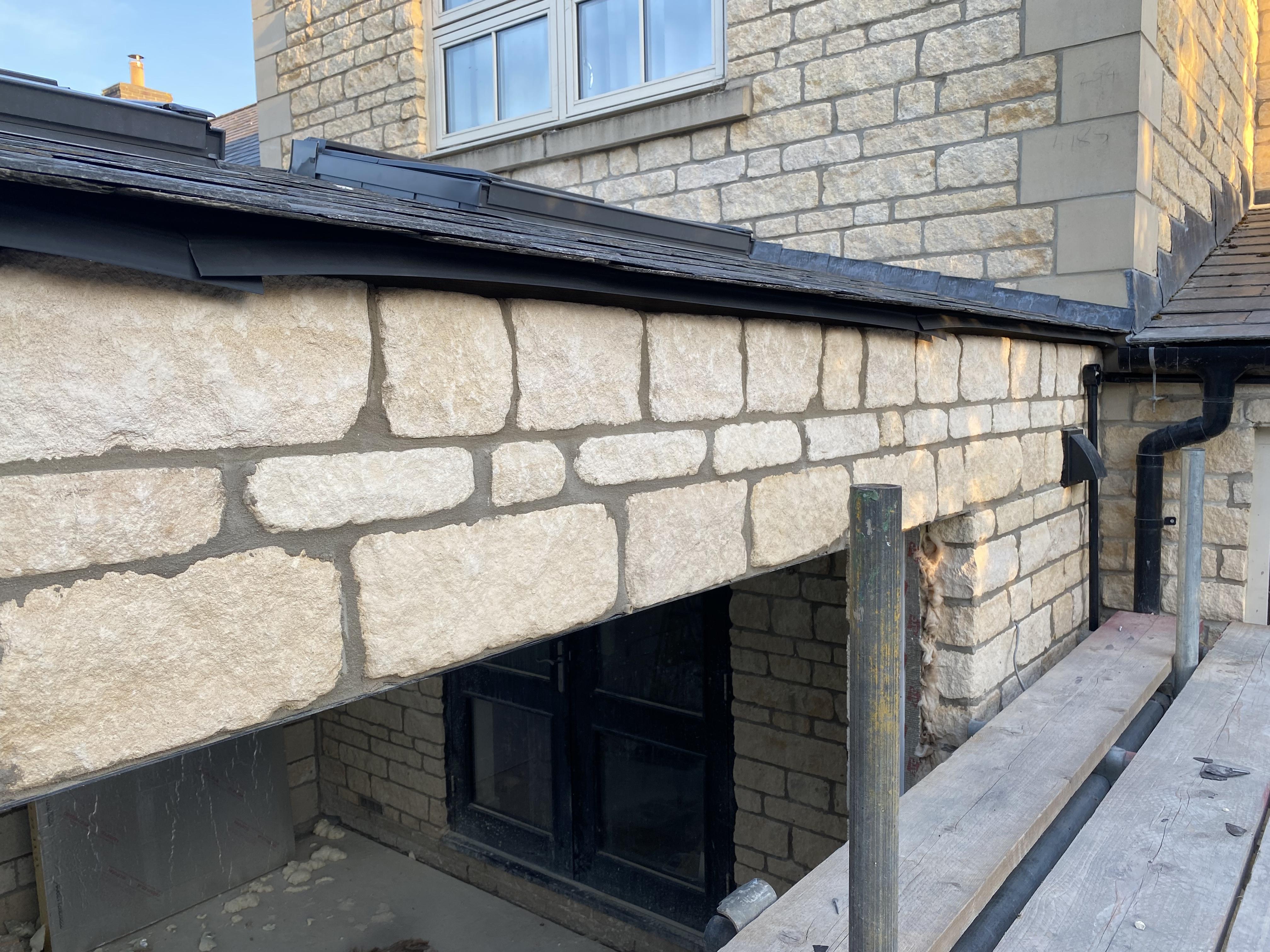

Hi, Our extension is progressing well and I'm looking for an answer I have to a query re the new roof. We're proposing a pitched roof (as crudely drawn below, red). In order to achieve a suitable fall, I was planning to tie the lead flashing to the ridge tile directly under the stone cill. Is this likely to be acceptable? With this, the pitch will be around 16 degrees, which is based on the pitch meeting the adjacent mono-pitch and gutter (which you can just see to the right of the photo). Any help or advice would be appreciated.

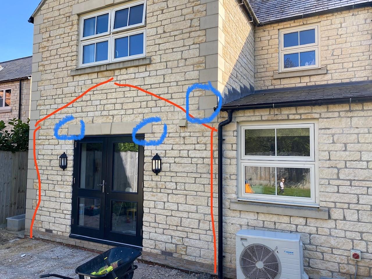

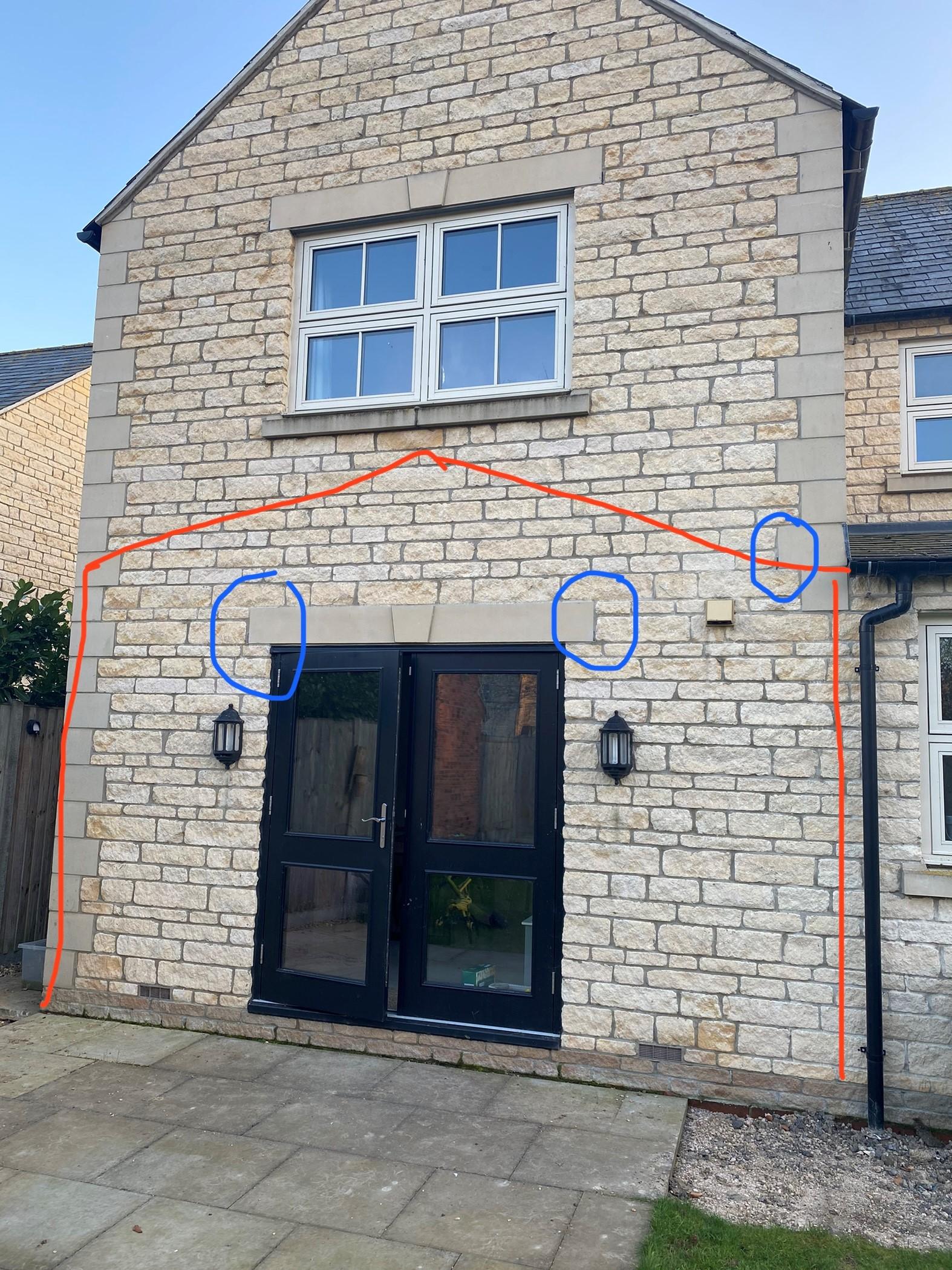

Thanks everyone for your input on this. The one to the right is the one that makes me most nervous, because it clashes with the proposed roof build up for the extension. I assume that this particular weep hole is serving as the outlet for the cavity tray that runs adjacent to the existing pitched roof? Any thoughts on how to tackle this would be appreciated. See attached pic from a better angle. -

Good evening all, Hoping someone might be able to help offer some advice regarding our proposed extension. I have crudely marked out the outline of the extension in the below image. It is going to have a concrete tiled pitched roof to match the existing. The question I have is that the extension will cover 3 weep holes (circled in blue). What should I do to avoid any internal leaks? I have read online about fitting cavity trays which I assume would need to involve chasing out the stone above the roof line to fit the trays (which sounds expensive and complex). Is there another simpler way around this?
