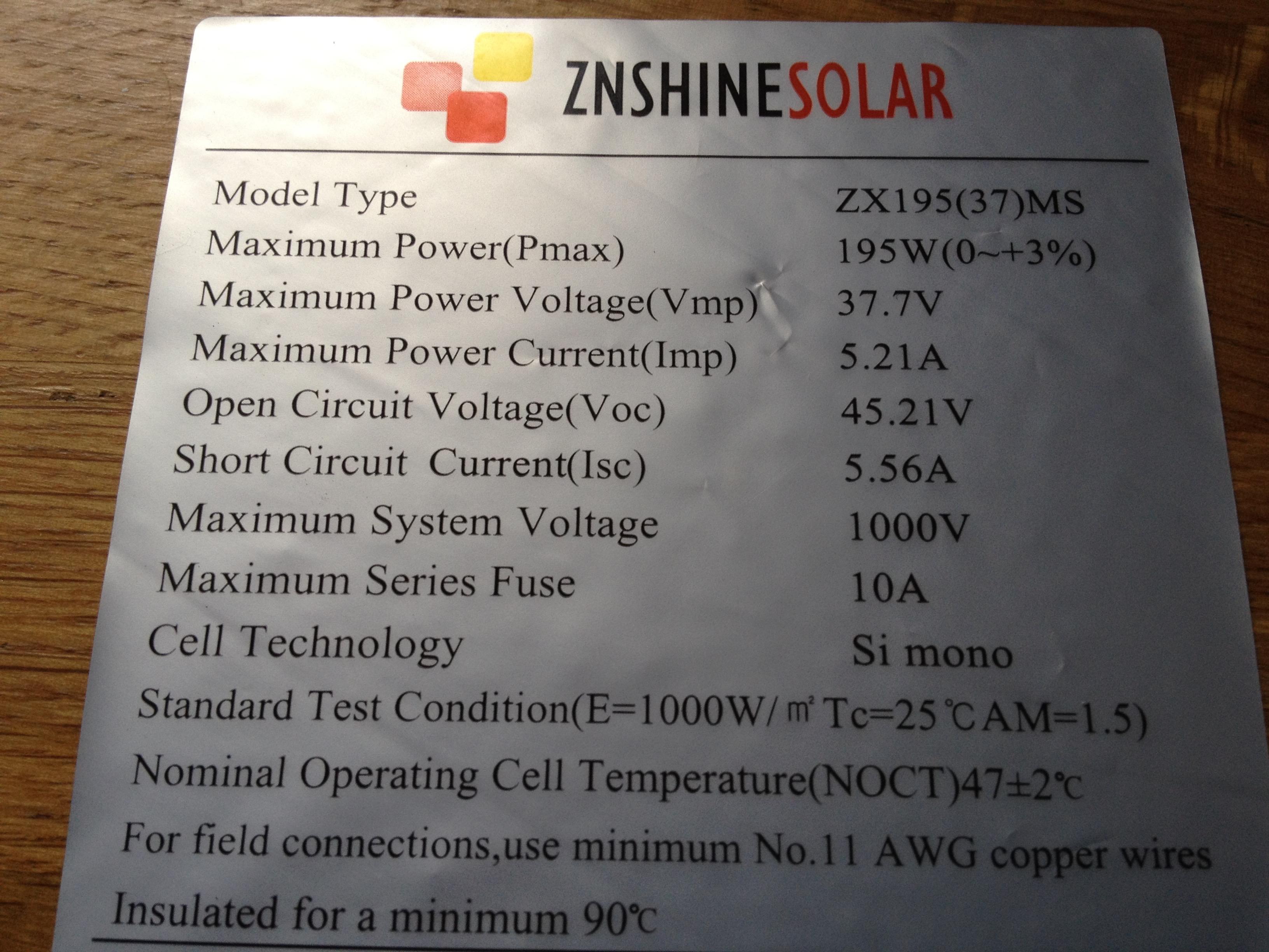

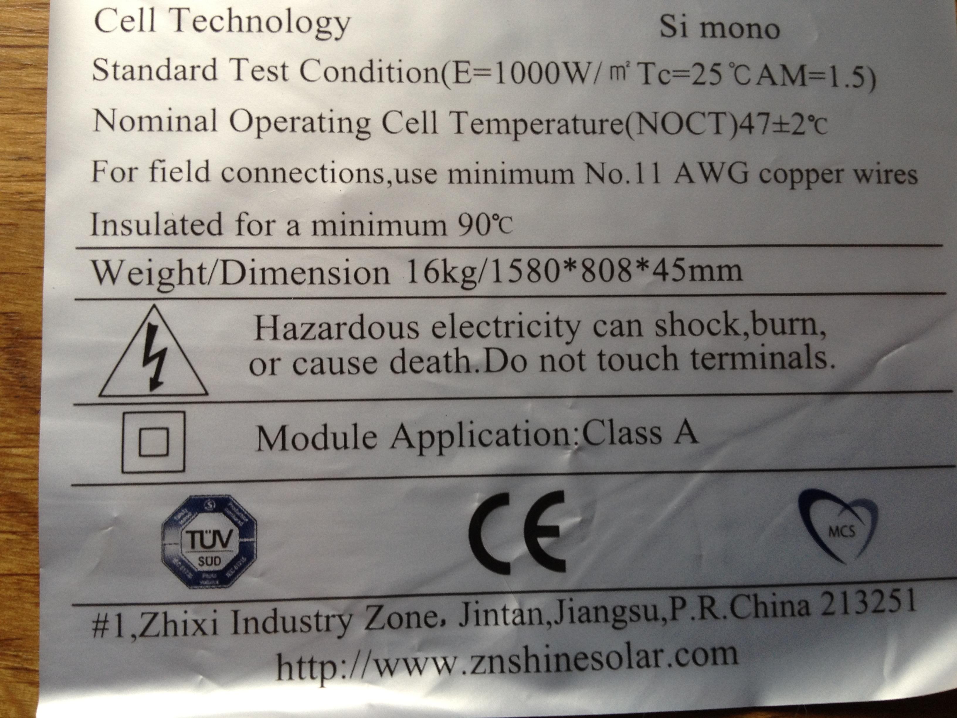

  7. This is the specification of the panels…
  8. The panels are 195w (20x195w = 3.9kw). The inverter is a Diehl AKO Patinum 4300S http://www.raine-or-shine.com/dloads/PV/Inverters/Diehl-AKO-Platinum-Inverter-Manual.pdf

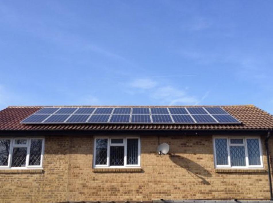

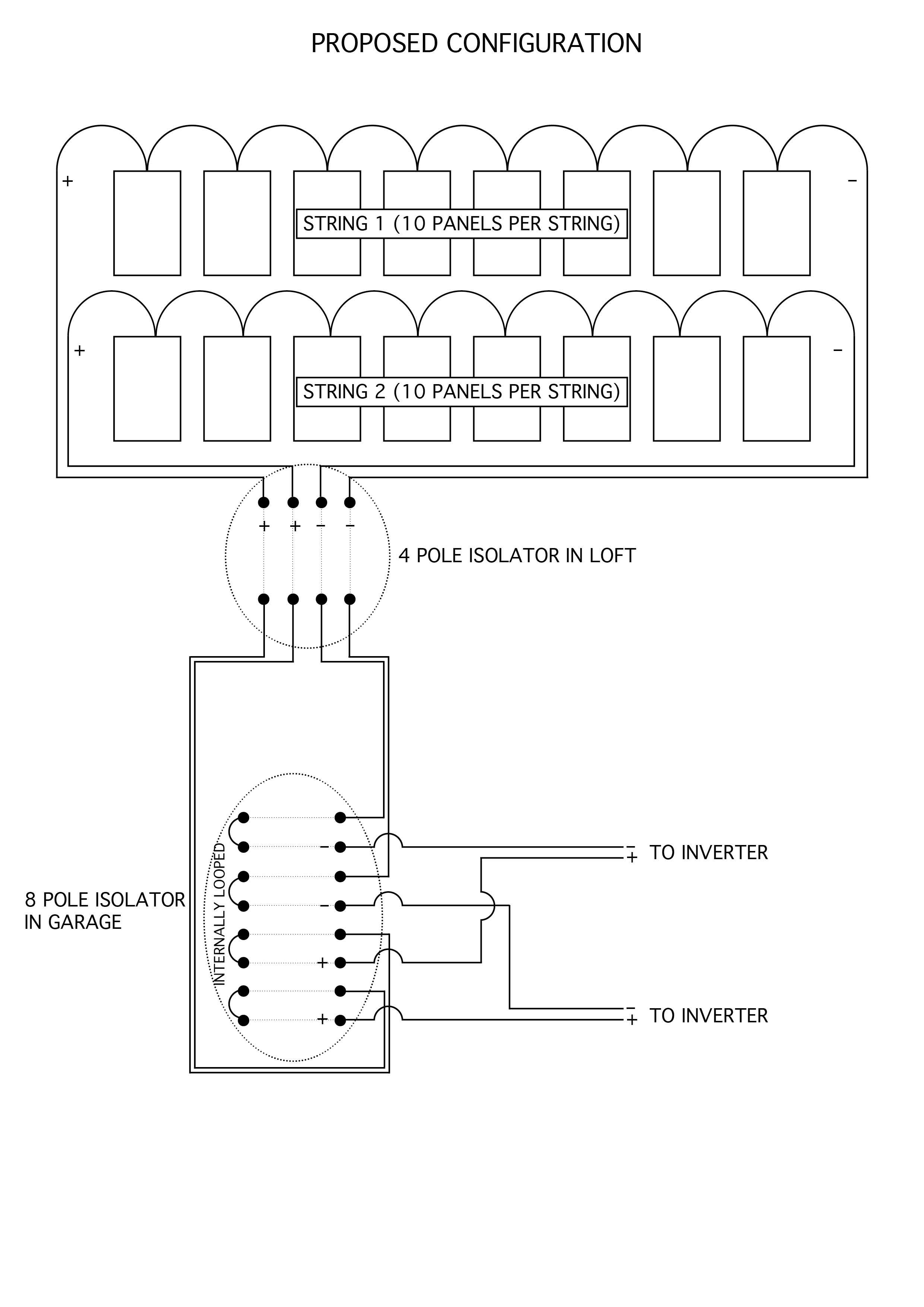

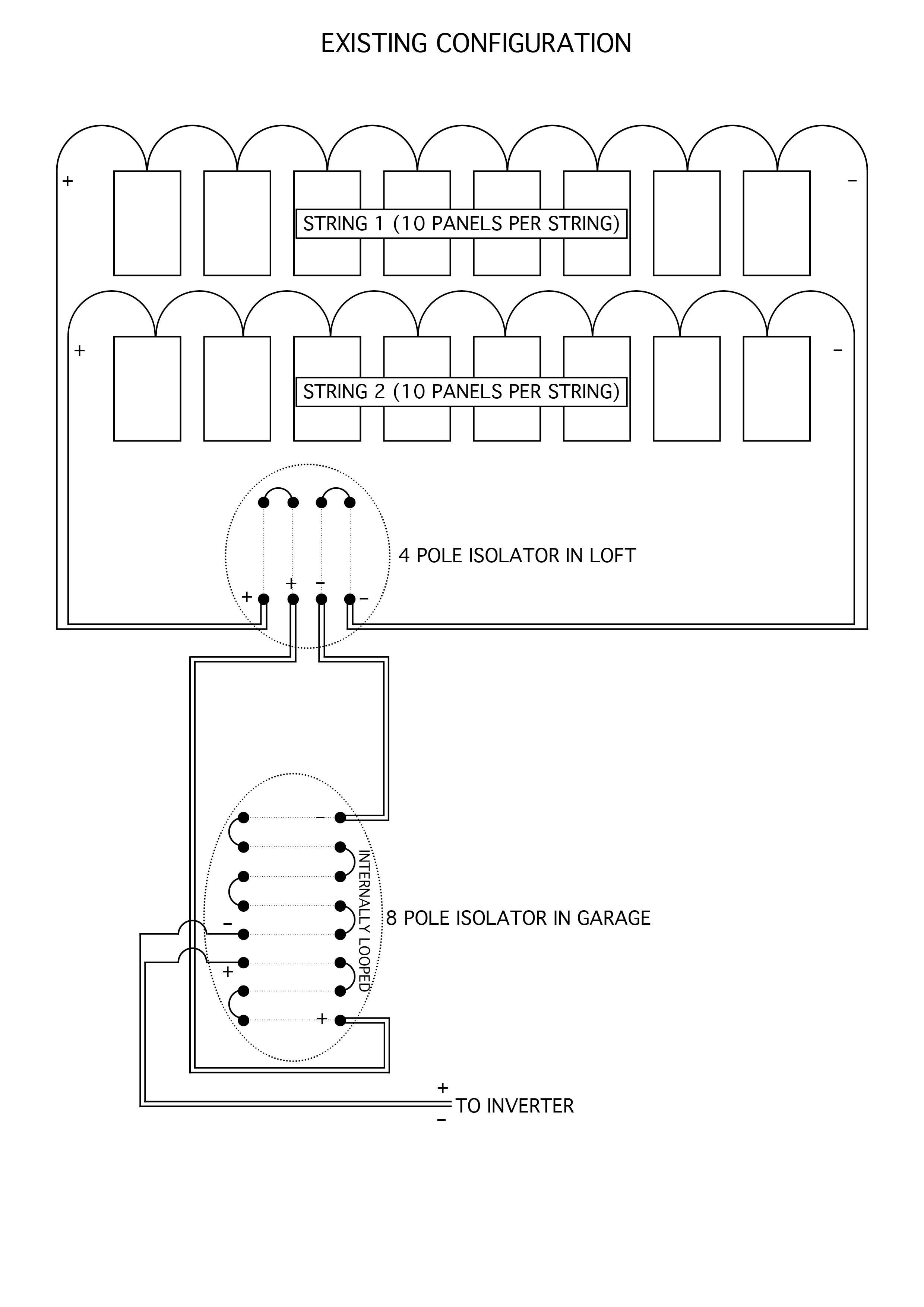

  9. Some time ago, we had a PV system installed, and ever since, I've been unhappy with the way it's been wired, so would appreciate any thoughts that you may have. All DC wiring is 4mm. As you will see from the image below, we have two strings of ten panels, and these are connected together via a DC isolator in the loft. When the cable exits the loft isolator, both positive and negative go down into the garage via four 4mm cables. When the cables reach the garage, they go through another DC isolator before exiting through a single cable and then into the inverter. Currently all works fine. However, our inverter has two sets of inputs to facilitate two strings, so what I'd really like to do is take each string down to the garage separately, so we're able to connect the two strings separately into the inverter, so we can see how the strings are performing individually. The following diagram shows how I think it could be done using the existing wiring and isolators. As stated previously, I'd appreciate any thoughts that you may have.
