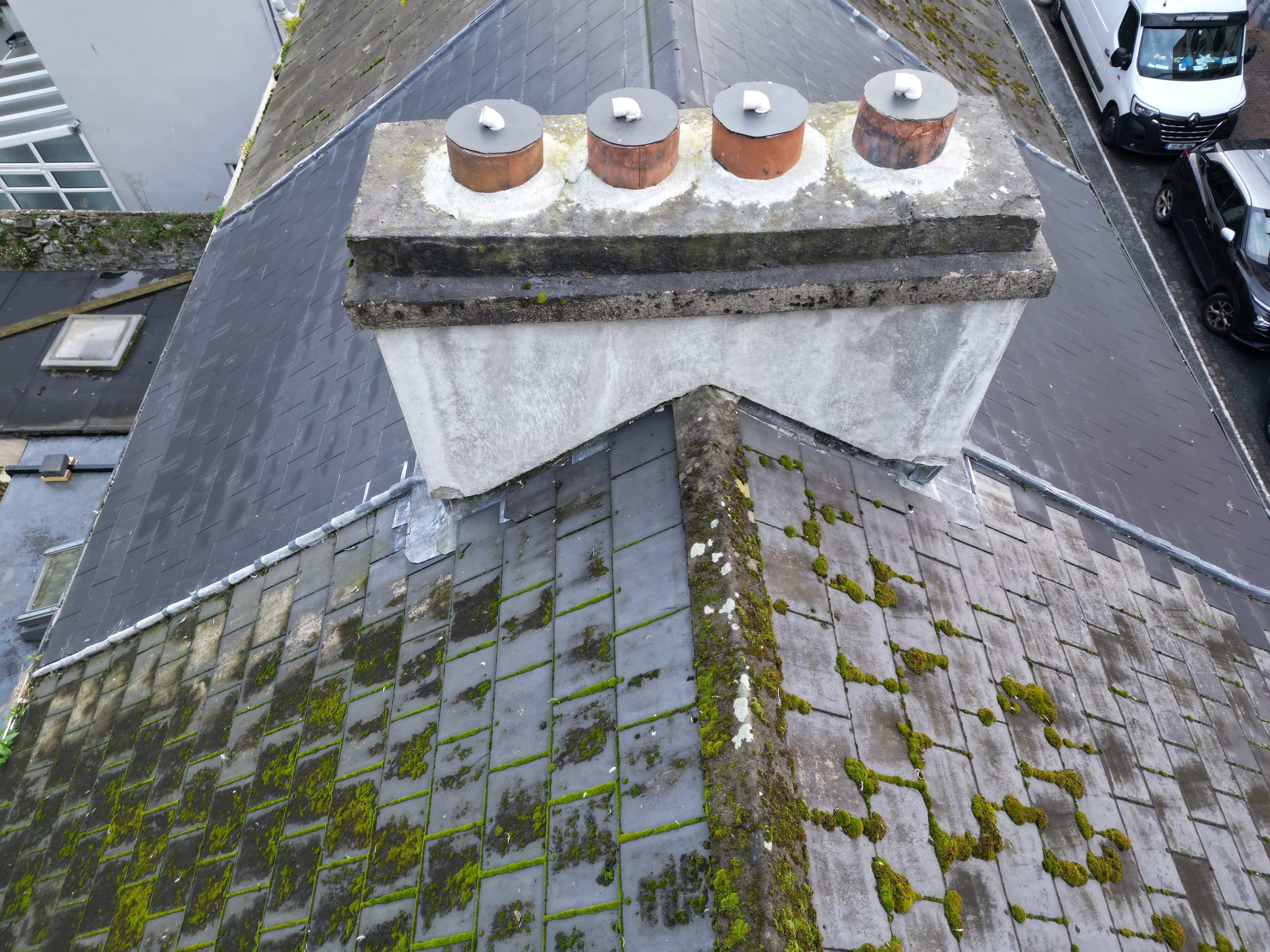

Hi there, I have a cracked chimney crown (crown/cap? I think thats what its called) and I was planning on spraying off the moss & green stuff and then applying Storm Dry I'm also going to spray 'patio magic' on the slates to kill off the moss etc Does anyone have advice on this? Am I doing the right thing? TIA 👍 -

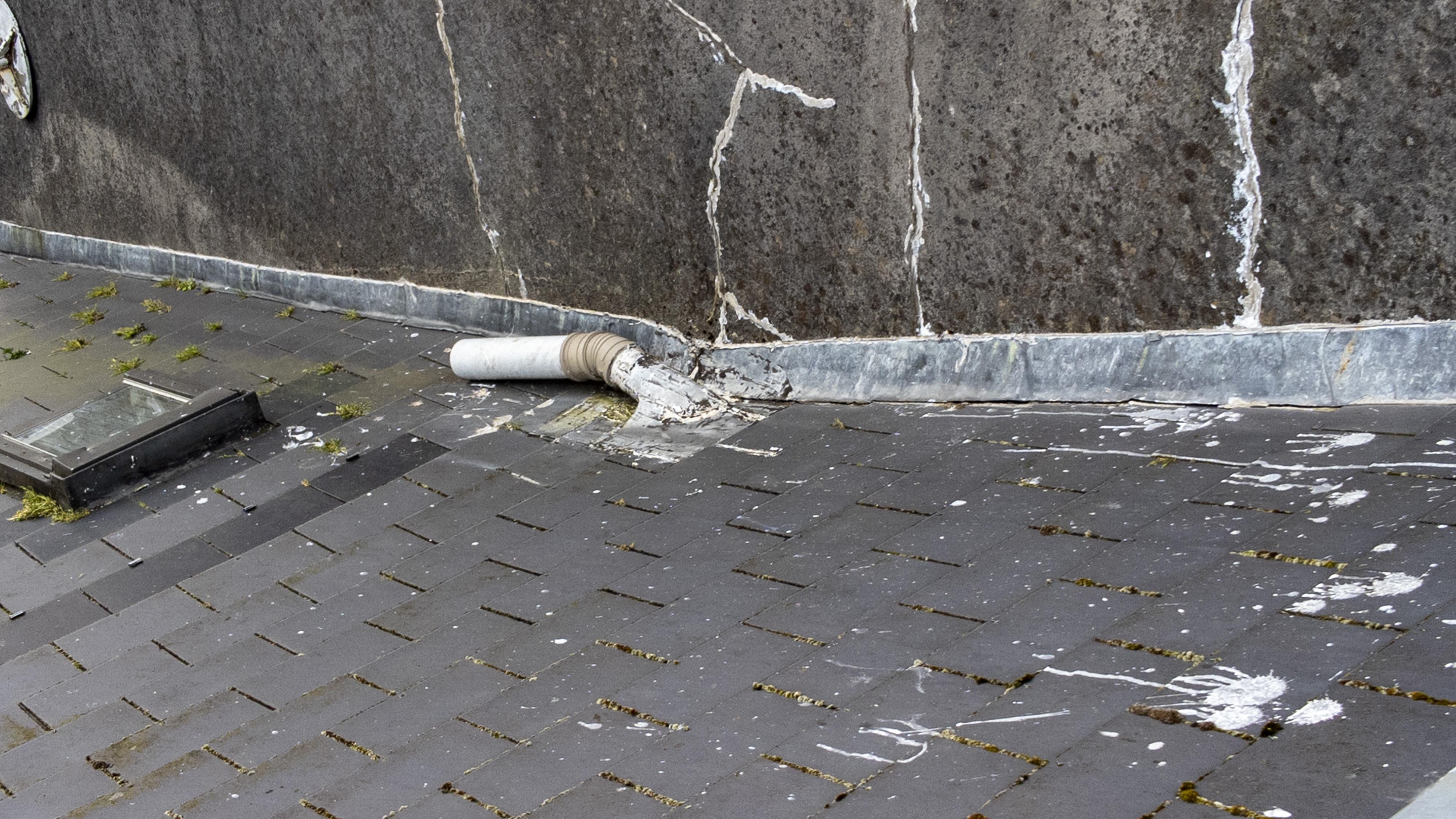

Dunno why the extra bit was put on - twas before my time. Here's something that might work if the angles were right https://www.leadworx.co.uk/shop/lead-slates-pipe-flashing/pitched-lead-slates/

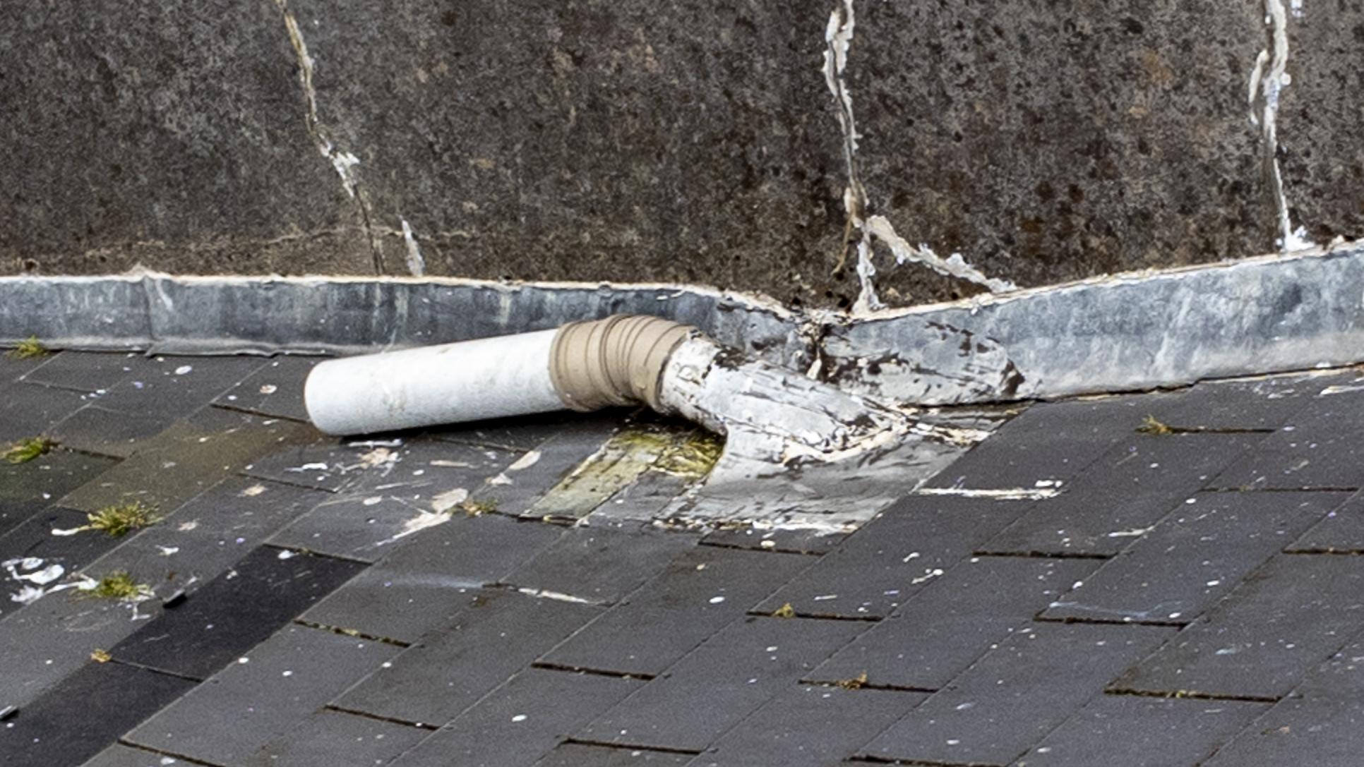

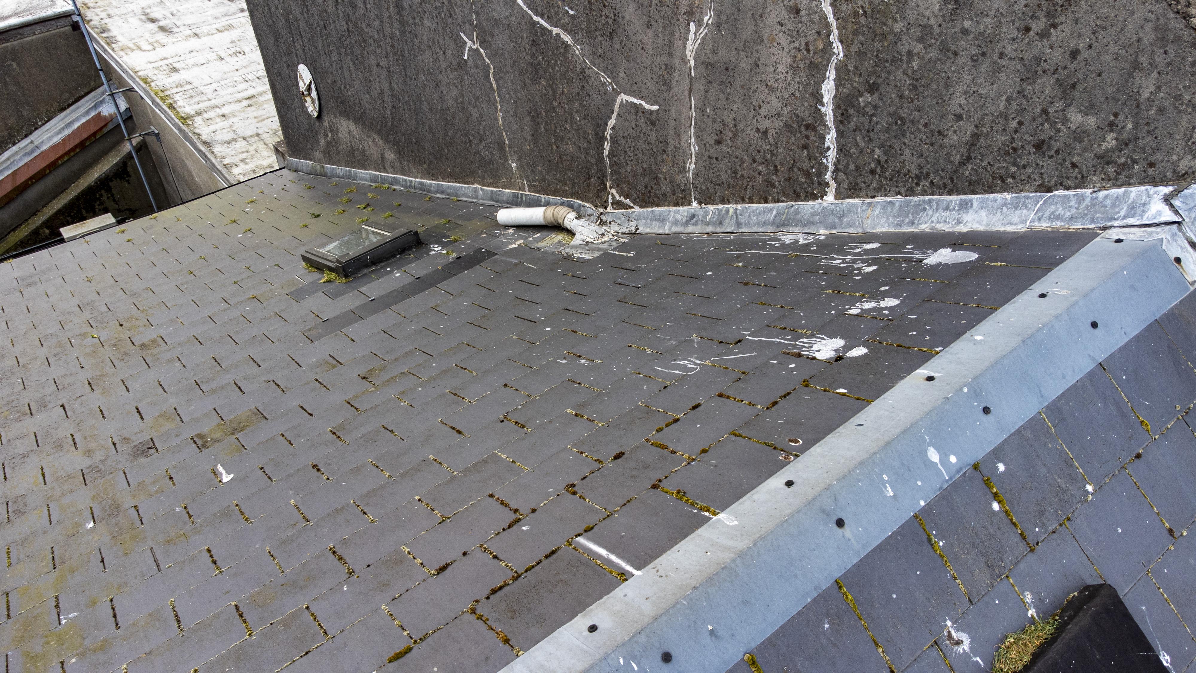

I have a rain water pipe that runs from the front to the back of my roof which drains rainwater from the front parapet to the rear. There is no way to add a downpipe on the front of the building so I have to stick with what's already in place. The 4" plastic pipe exits the roof as shown in the photos but it looks like a real patch job....is there a proper tile/pipe adapter that can be fitted instead? I'm having some work done so I'd like to have this redone properly. Thanks in advance.
