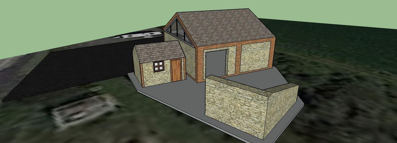

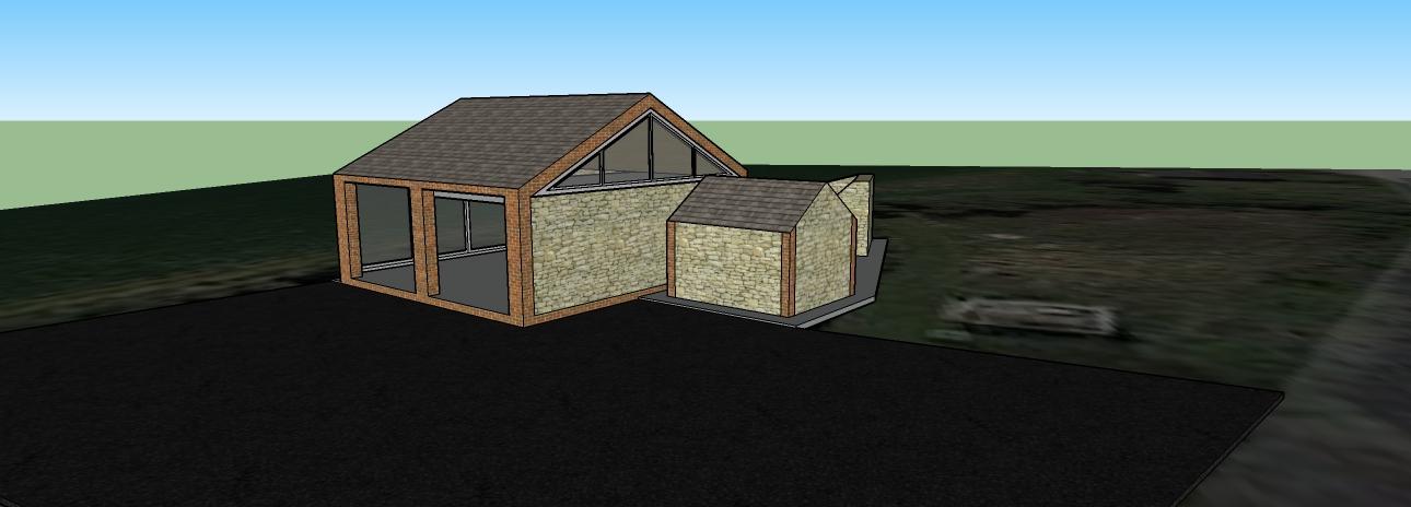

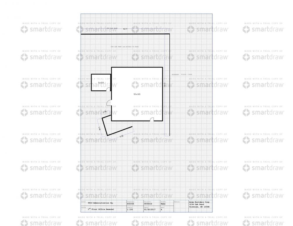

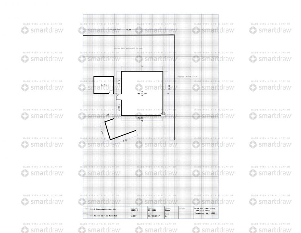

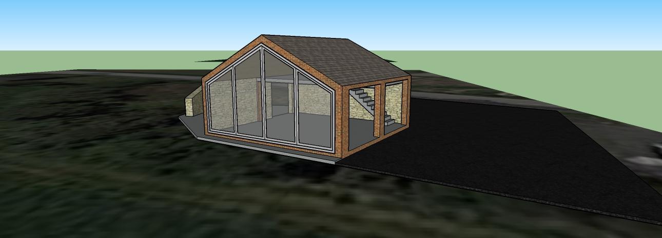

Thanks everyone for your responses and advice, it has been very helpful so far! The architect mate of mine came back with a few suggestions. He's based abroad though, so he doesn't have much insight to offer on getting a permit. I think it is wise to keep at 2m from the boundary to reduce my chances of being rejected, and argue only on the height of the building as required. We're also contemplating moving into my car park, so reducing driveway footprint and increasing garage footprint (at 12m long, 7.5m wide). Those are his drafts/sketches for now. He suggests I can use bricks/breezeblocks to take the loads for a smaller structure, but for such a large opening I would definitely need steel beams to support the roof, as timber would be problematic. He also said what others have said here already, a 150mm to 200mm slab with steel mesh is probably going to be more than enough. The amount of windows he's added really appeals to me, but I suspect it would cost a fortune, so I doubt the finished thing would ever look like this. I'm off to find a planning consultant in Mold, Northrop or surrounding areas who have knowledge of what usually gets approved. -

Thank you al, this is really encouraging and well motivating! Out of curiosity, what would the difference be if I was to build it using breeze blocks, cost wise as time-wise I know it takes longer. Yes the foundations would need to be able to take a considerable amount of weight, as a car with ramp is easy more than two tonnes, and a car stacker with cars is more than that. Was that with cladding and roof included or just the frame? I would consider concrete pads if there is a way to secure them together, as there will be some serious loads from multiple cars stacked or ramped up. I suspect concrete foundations alone would cost around £3.5K and that's not including groundworks. Yes I will definitely insulate it, I plan on working from there (sitting on a chair and all)! I was also thinking on underfloor electric heating, as the wife is hell bent on getting solar panels for the house, and because of the loads I'd feel better with wires than pipes. Also what's the deal with getting planning permission for a building that is closer than 2m from the boundary and taller than 4m? Is it doable, or should I just plan to leave 2m from the boundary? Many thanks for all the replies, this is very helpful and motivating! -

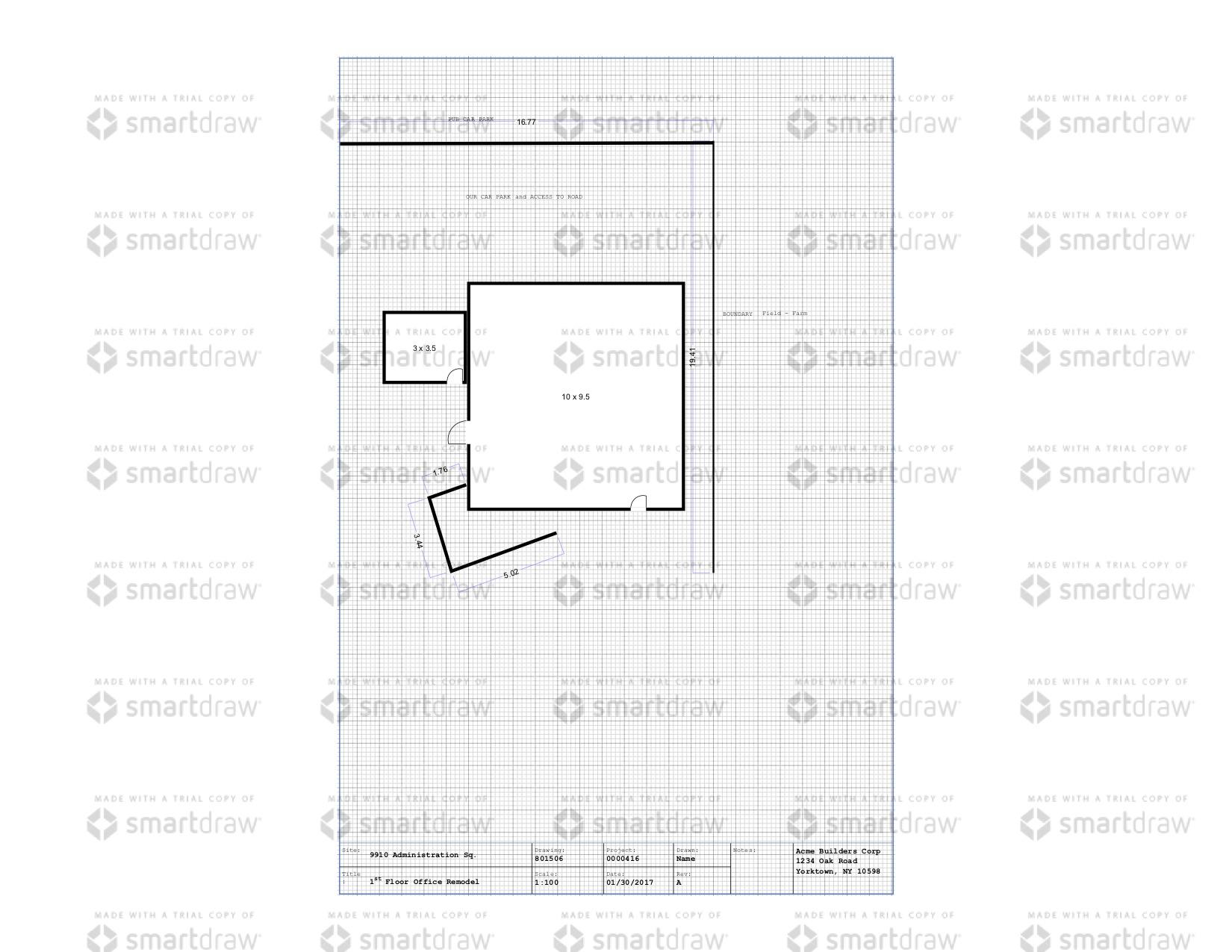

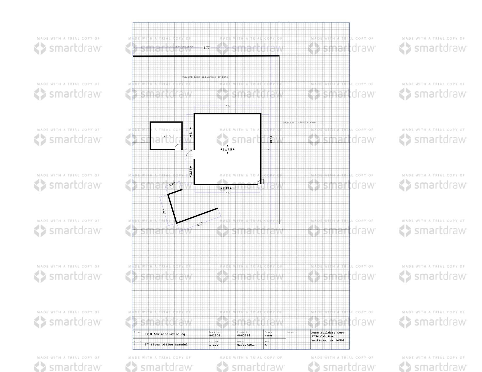

I made this using an online sketcher, the idea being to show the location and available space. Maybe it helps. -

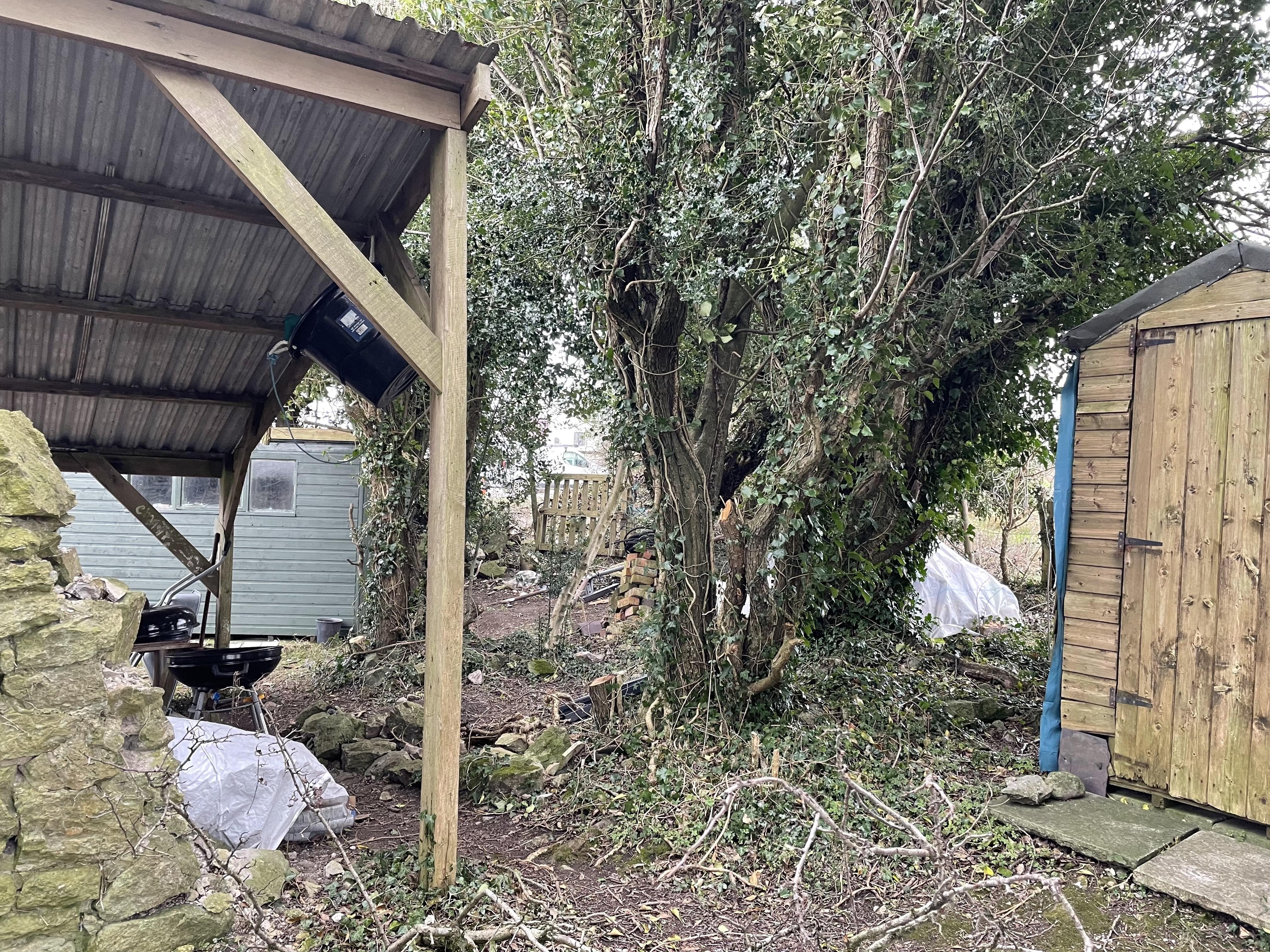

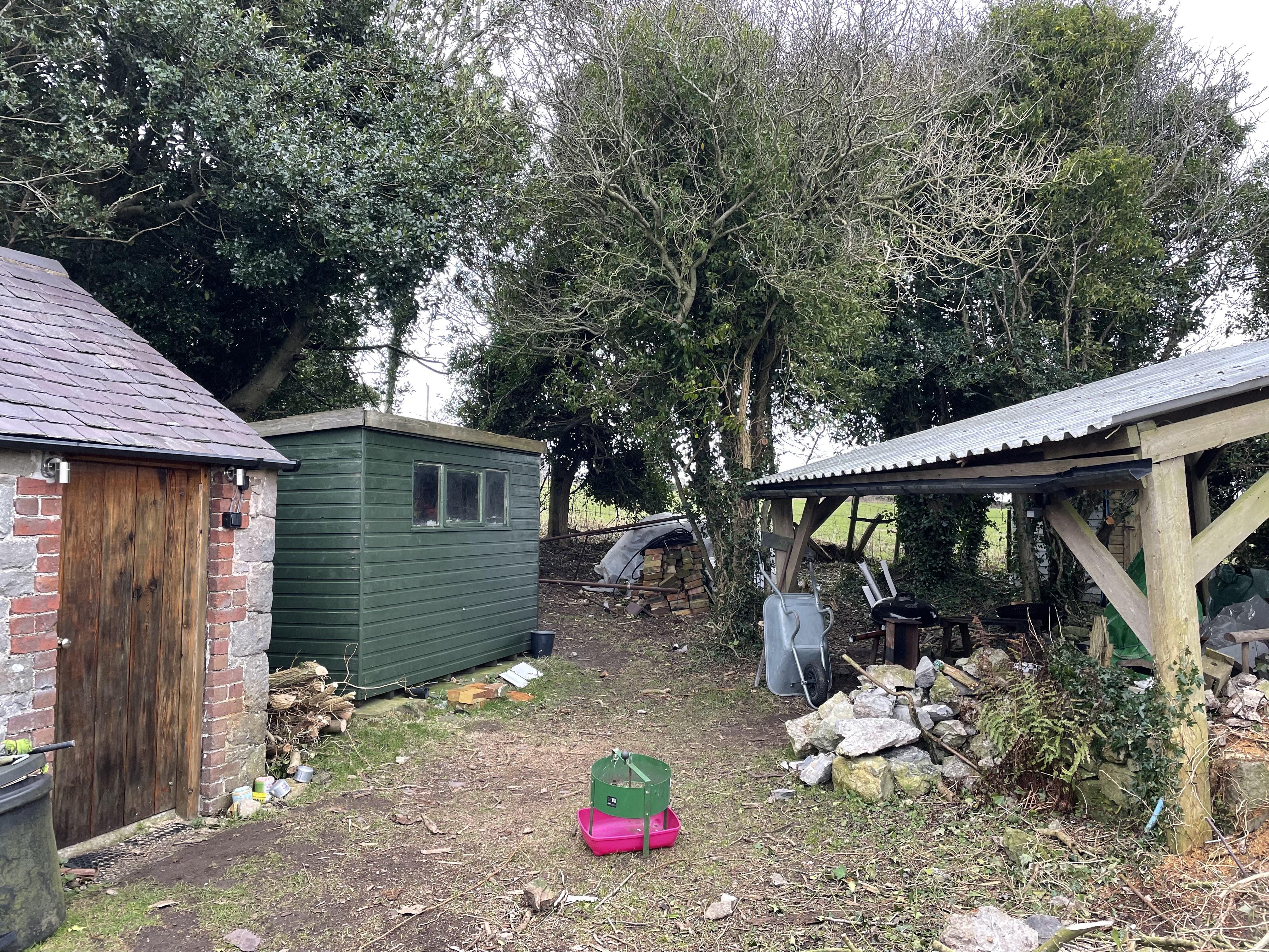

Right side (looking towards North, e.g., the pub car park). You can see the lean-to on the left, shed behind it, and just about the boundary fence to the right. There's a large field behind. Behind the front fence (where the pallet is) I've got another 7.5m to the boundary, but I'd also need some space to maneuver the cars in and out (unless the garage door faces the entrance which is an option). -

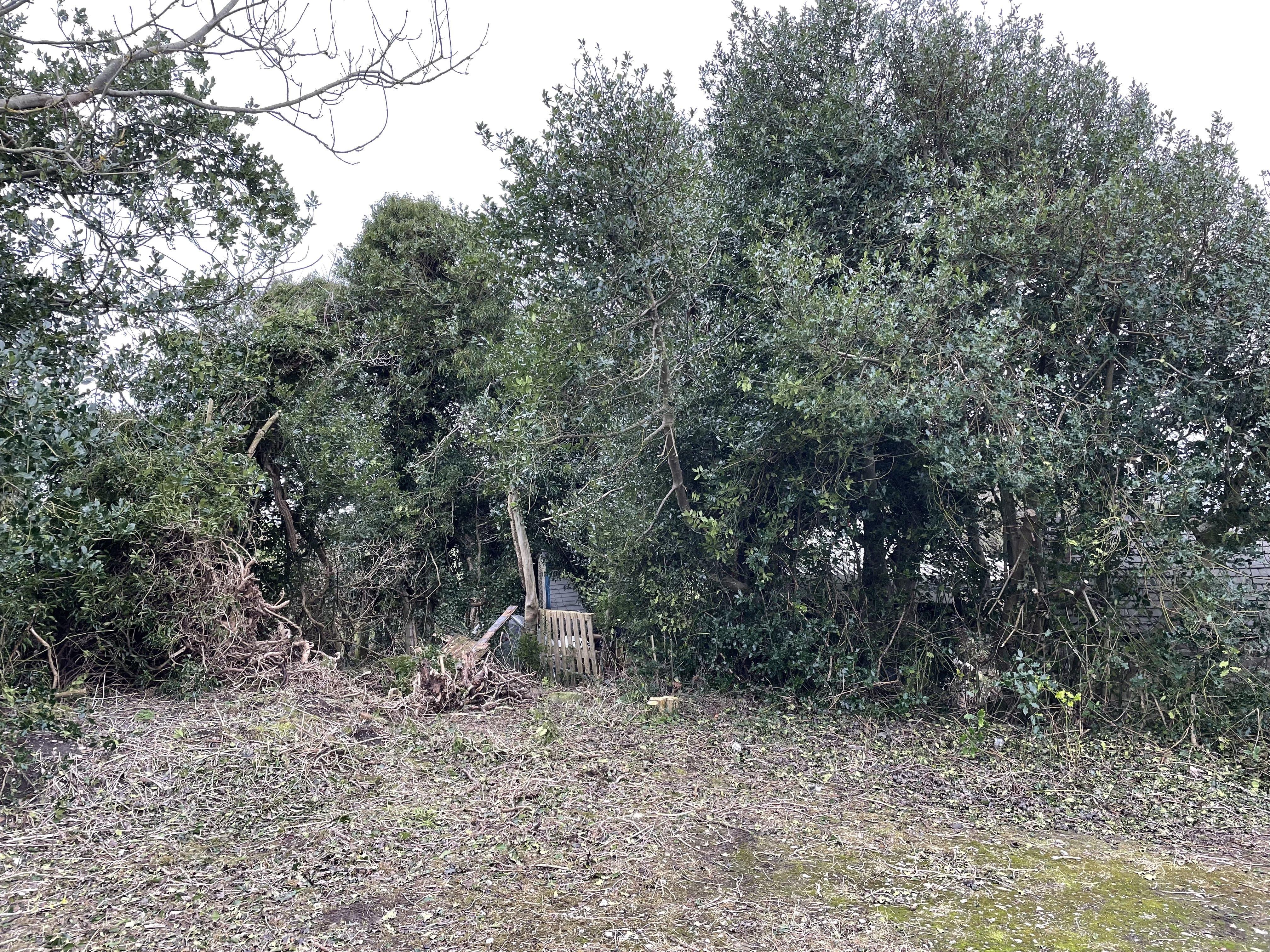

Left side far (I'm facing south); the property includes the area with the vegetation and trees and extends further than the pallet and fence you can see (another 7.5 meters). The stone building on the right should be left intact. It isn't listed but it is very old and I'd rather not demolish it. Vegetation and trees would be removed. You can just about see the shed behind the trees and the lean-to in the far end. -
