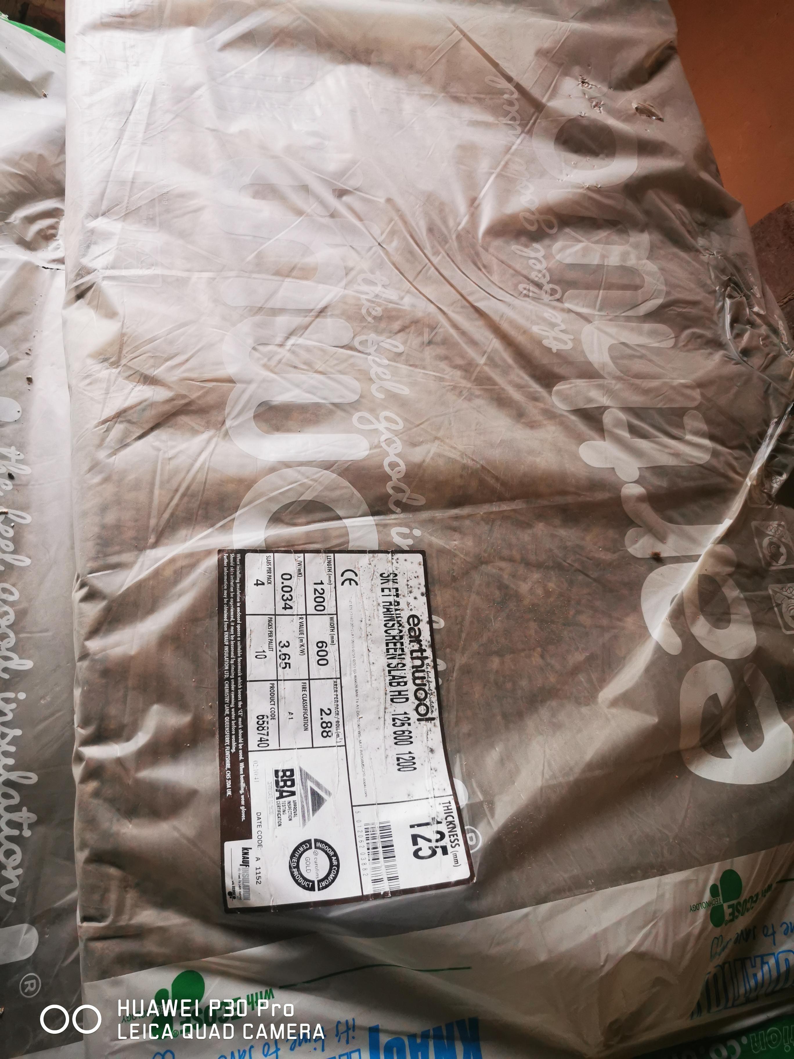

  3. Hi, been given away some knauf rainscreen slabs, i know they are for façade systems. but can it be used inside, like between floors for sound insulation ?

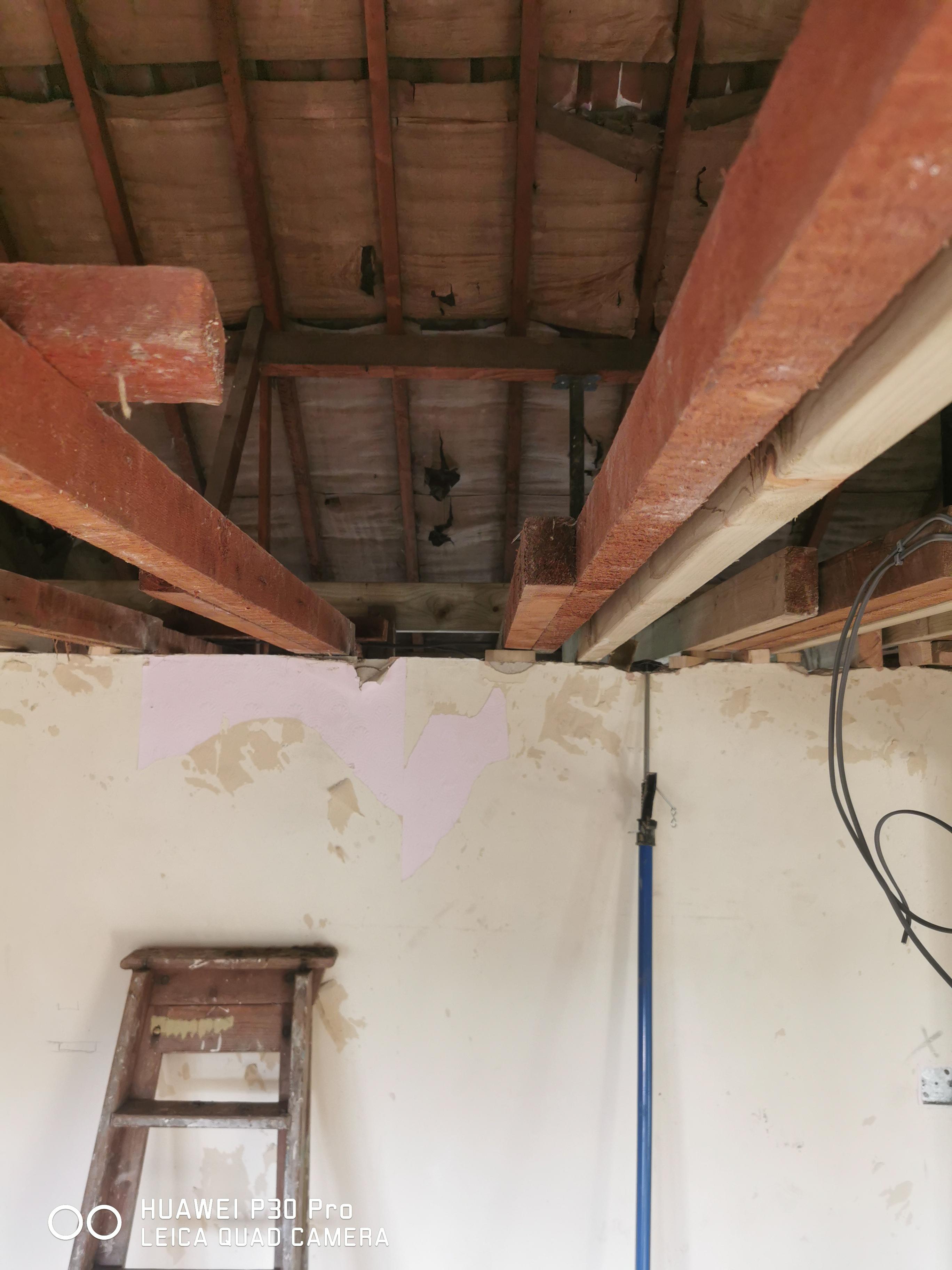

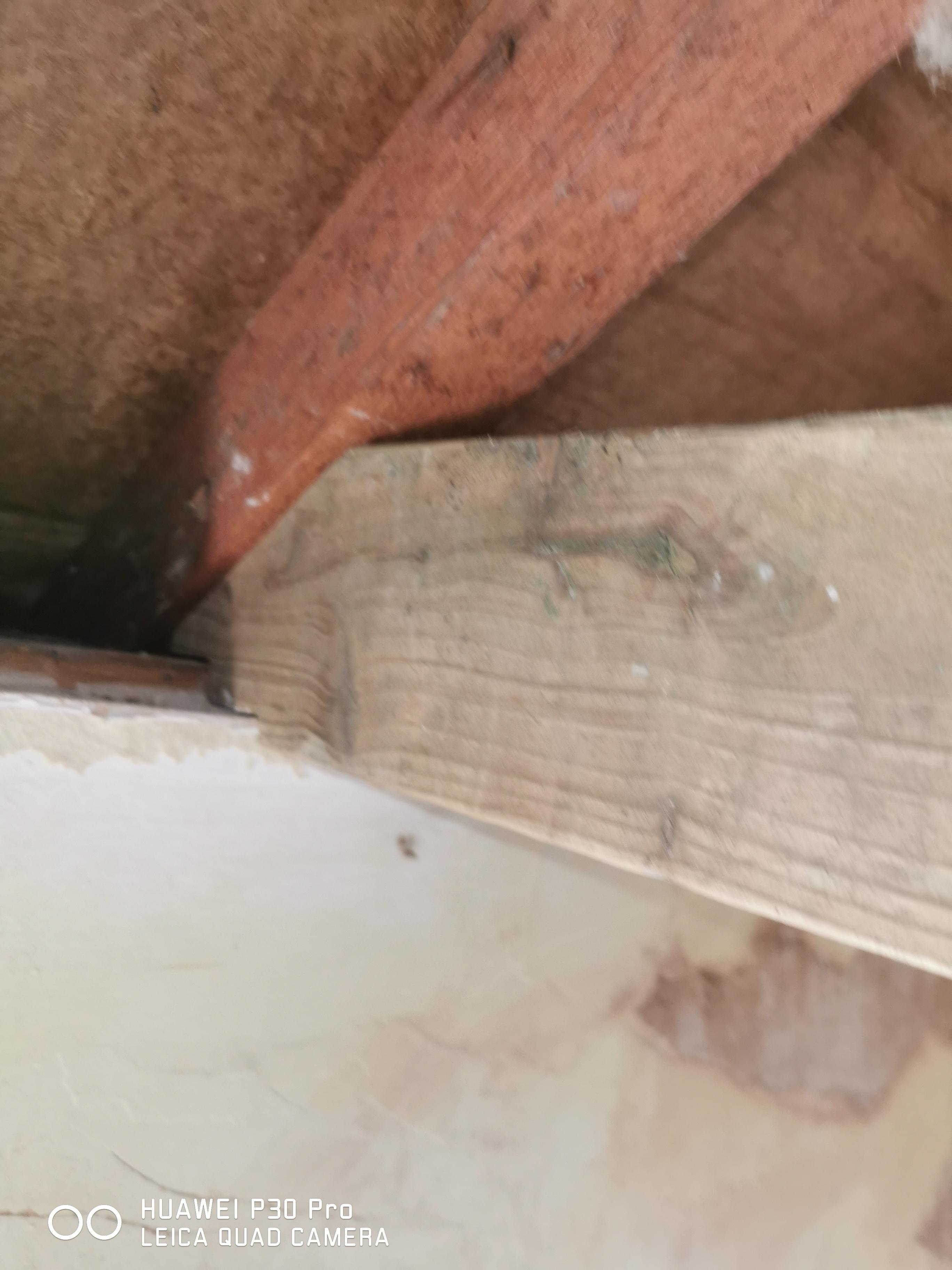

  6. can i put some new joists under the rafters like in picture, because the way some of the old joists overlap each other that I can't atach the new joists on normal side only the rafters side, the engineer said is not recommended, but don't really know how to do it differently. i could ask engineer a gain but it takes 2 days to get answer.
  7. so got email from engineer to double them with 2x6, and change binder to 2x6. Could you explain me how is " SPLICE THE CONNECTIONS WITH 1 METRE MIN SPLICED TIMBER SECTIONS" looks like.
  8. ? no, i got a lot 2x3, so was thinking to use 2x4 , where struts is pushing ceilings and in other places somehow use 2x3, if not will get more 2x4 not a problem
  9. ...and should i do all of them or every other?
  10. Thanks for opinions. Will add alongside old, new 4x2 , should shim new joist on wall or put timber wallplate ?
  11. It's a bit bowed but not a lot, a lot house's on the street same..
  12. ceiling is quite low in some places, and sagging is 4cm-5cm,
