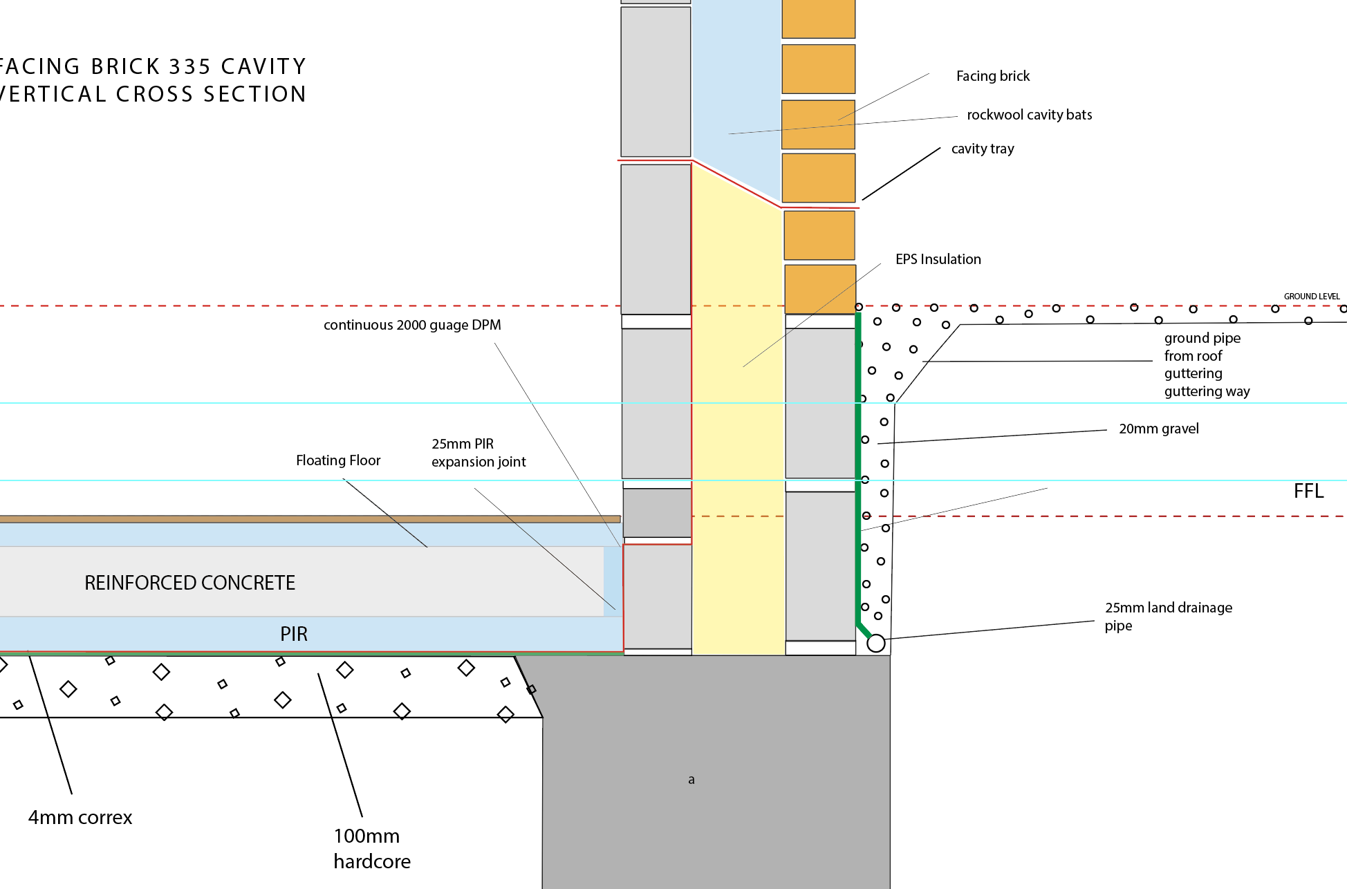

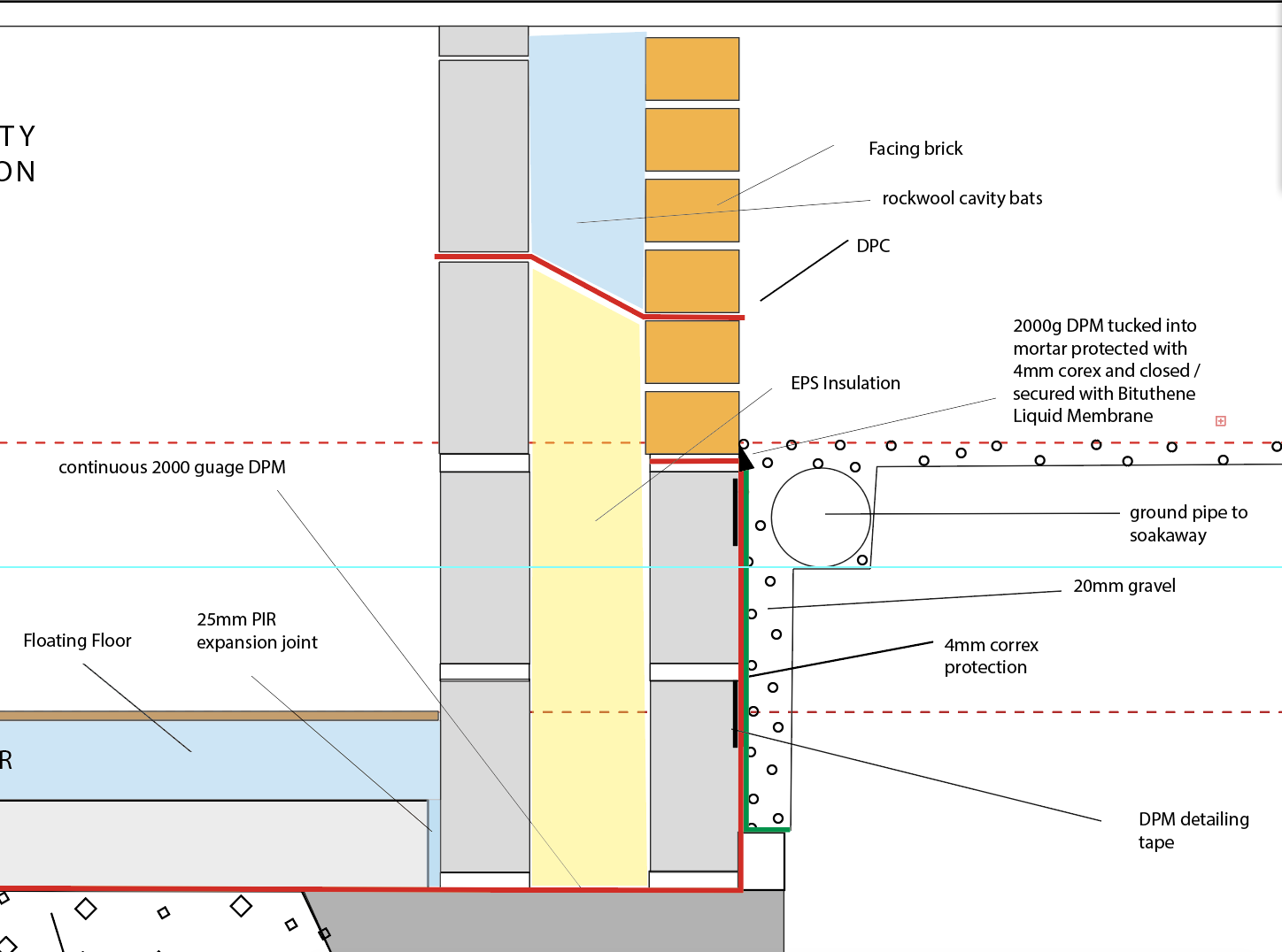

  2. Hi all, okay i have gone back to the drawing board and simplified. how does this look? I cant make the drain lower than the DPM unless i put insulation under the DPM rather than over as i have already poured foundations and hardcore

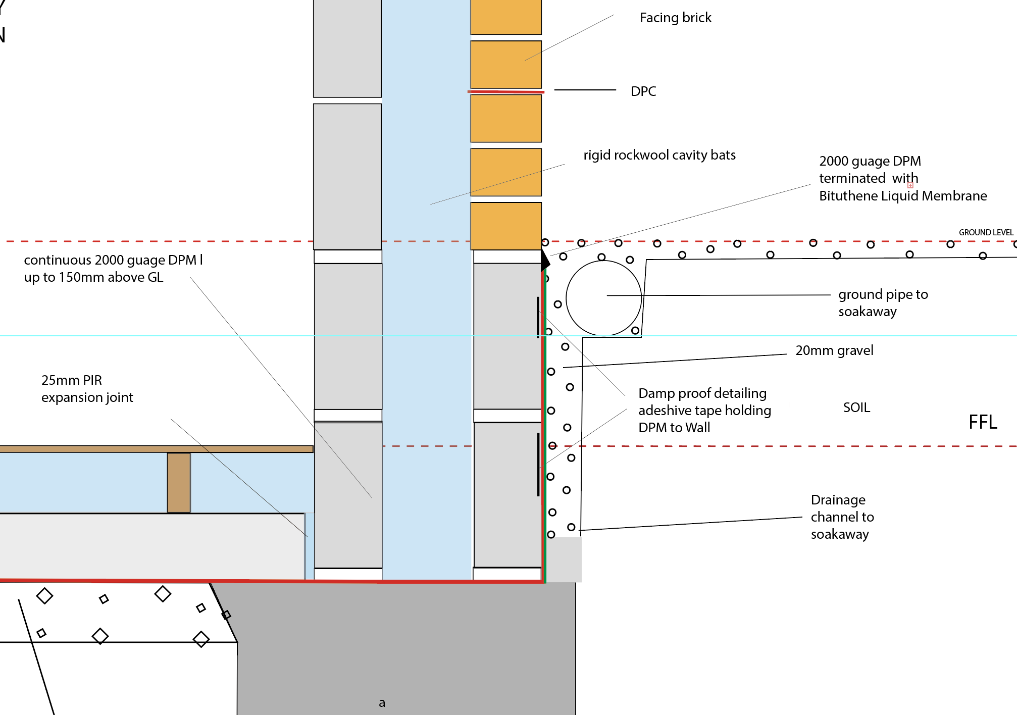

  3. I think i am losing a sense of why i was trying to do this in the first place.🤯 I thought it was to try and stop water getting into the building in the first place in the event of very wet ground or flood - but that's tanking right? So with a DPM detail thats more standard - i'm, in general, obstructing the transference of moisture from the outside to the inside. BUT if the building gets very wet or there is a flood a more standard detail will allow me to dry things fix things out more easily? I'm so confused
  4. thanks @saveasteading do you mean the water will more easily travel out of the soil and into the gravel channel around the outside of the building?

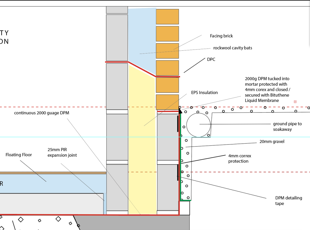

  6. @tonyshouse@Rob99 and anyone else - how about his detail below i've just drawn? Taking into account your feedback - my question is will this many bits of plastic (DPC/ DPM) in the outer leaf of bricks / blocks cause any structural issues? thanks for your help
  7. @tonyshouse thanks for your response can i please ask: Can i use EPS for below ground level and rockwool above/ - my bricklayer who i have been trying to keep sweet as he is very good and they are in short supply told me to use Rockwool i think it makes his life easier. Floating floor - as in lose the wooden joists bridging the slab?

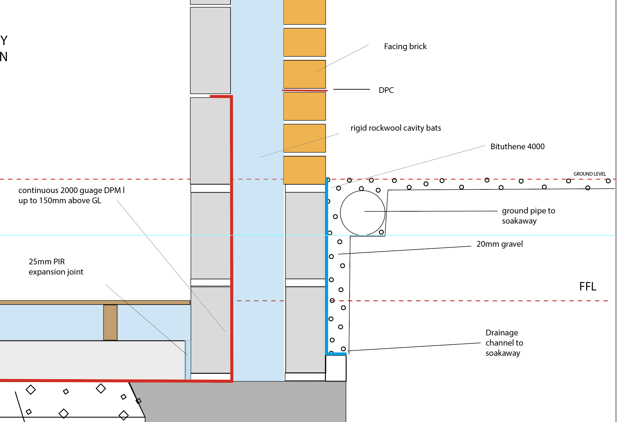

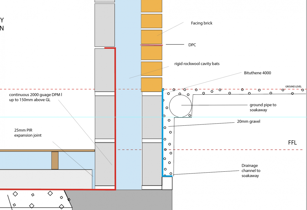

  8. Hi all, me again, Thanks for all your help so far. I have another question I want to protect against ground water / rain water / holy water the lower 500mm of my outbuilding, as it is below GL in a quite wet area. My first detail was this : But i have come up wit this detail instead which, to me, will do a better job and much cheaper: pretty please please could you tell me if this can work / share your wisdom apart from the 'change your design so its above ground level' wisdom thank you
