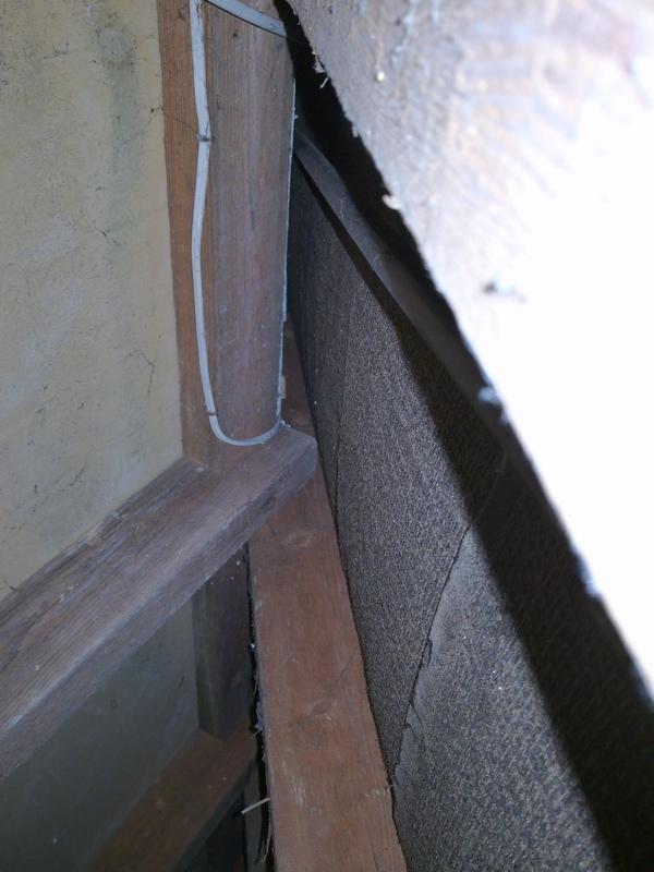

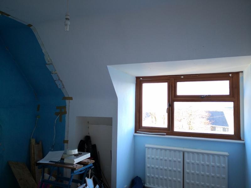

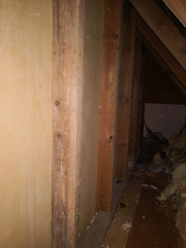

  6. Hi Iceverge, yes, I've definitely read so much stuff on here and elsewhere to get the message about points 1,2 & 3! Some photos attached (random foam/tape/plasterboard to temporarily block up holes where old cupboard was removed). My thought for conventional buildup was for: Sloping Ceilings - 50mm PIR between rafters/100mm PIR under/VCL/15mm Plasterboard Dwarf Walls - 50+mm PIR over studs in eaves/100mm between studs/VCL/PB My alternative was to use the same for the SC, but change the DW to: PB/VCL?/100mm Woodfibre Batts between studs/100mm WF Batts over/80mm Woodfibre board to hold the batts outside of the studs in place?? My rough calculations suggest a comparable U value (~0.15) and about 1/3 more expensive than the PIR option. Comments I've seen suggest WF doesn't need a VCL on the inside face, but wondering if I could continue PIR VCL along top of WF and then down outside to meet VCL under/over insulation laid in eaves. At present the eaves have glass wool, but mostly destroyed by previous plumbing work access and full of dead flies. Quite keen to replace it as well.

  8. Hello all, we recently moved into a very neglected 1950s chalet style house, in the far south of Cornwall. The in-roof upstairs bedrooms are eccentrically insulated with a random mix of old glass wool, loose polystyrene sheets and - mostly - nothing. Knowing nothing much about insulation or building regs a few months ago, I now know a little more but feel ever more confused... Our rafters are 100mm deep at 600mm centres (ventilated roof). I'm assuming there is no real option in the sloping ceilings apart from PIR to get to, let alone exceed, building regs (I think at least 150mm is going to be needed)? As we have more space behind the dwarf walls I was wondering if there was any mileage in fitting wood fibre insulation in this area? I've noted the various comments/topics on thermal mass/decrement delay as well as the claimed ability of wood fibre to store moisture. Or is it pointless to mix the two and we should stick to PIR for the whole thing? Many thanks for any light you can shed.
