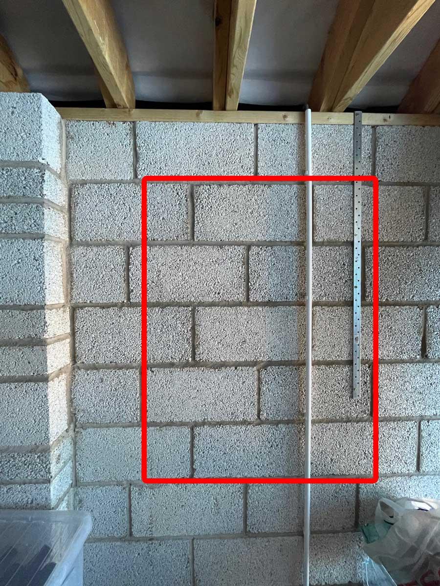

Hi, In the process of converting a car port into an annex. Have attached a pic, but if i'm looking to install a window based on the image attached, how do I determine which lintel to use, it's single storey, window width roughly 1100mm Do i need to get a proper calculation done etc, or just install a large enough concrete lintel above
