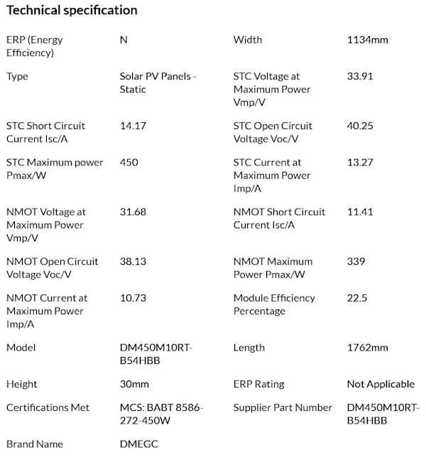

  1. Hi, i have an inverter that is a Growatt 6kw with a max 500v input & 150v start up & the panels are all as per spec below. I have 10 panels & would like to wire them in 2 series of 5 = 10 in total. Which i think is 5x40.25voc = 212.50v Is my figures correct for my inverter & should i take any other things into account. Thanks for your help.
