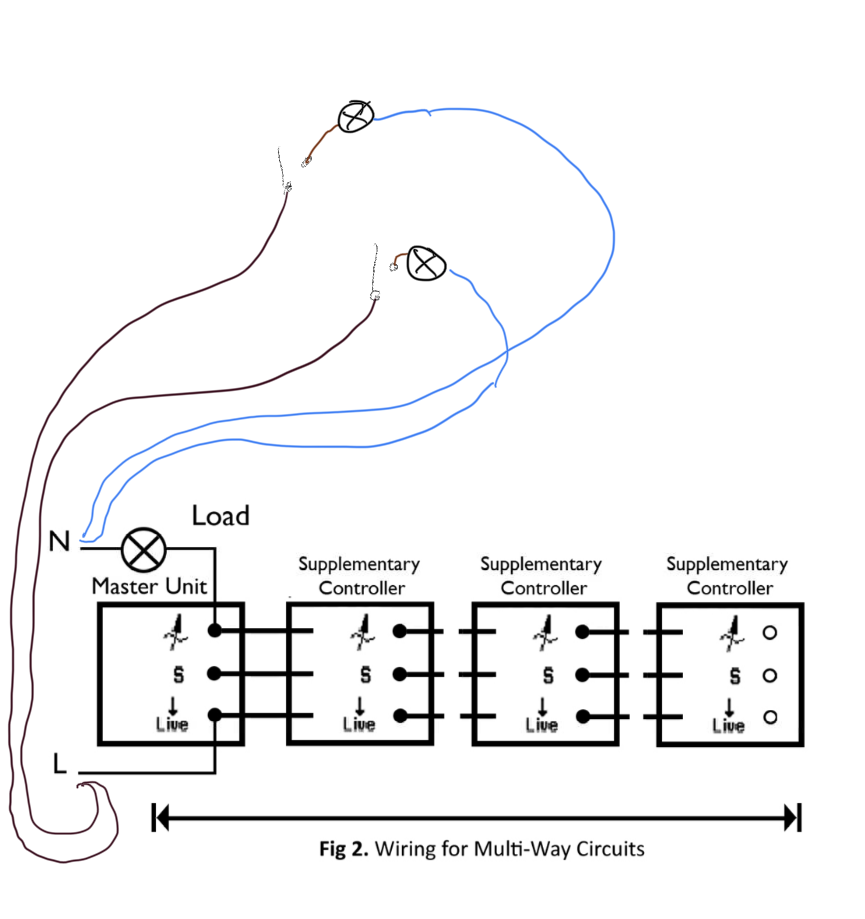

  4. After several hour of testing and checking everything I am coming to the conclusion that either the V-Pro Smart dimmer switch must be broken, or there is an issue with the switches or wiring of the hallway lights. I disconnected the slave and only left the master connected via live and neutral terminals (no slave needed). Switching the hallway lights, which are on the same circuit as the bedroom, via any of the hallway switches (end or intermediate) still causes the bedroom lights to switch on from time to time. I also seperated the wires as far as possible and ensured no contact, and as there is no slave link in this setup, capacitive coupling is unlikely. Since all the hallway lights and switches are working correctly and this happens using any of the hallway switches, it's probable that it is a faulty V-Pro Smart dimmer switch. The V-Pro Smart dimmer switch are always on. I guess, switching any of the other lights on the same circuit will always cause a small spike in voltage which the V-Pro Smart dimmer switch reads as a signal (even though it shouldn't). I will email Varilight support and see if they have any suggestions or explanations
  5. Thanks! You may be spot on - I have a supplementary controller linked via the S link. The live wire splits to the hallway and is in very close proximity to the S link, maybe I need to add some extra insulation and push them apart a bit further. Will give this a try tomorrow. Thanks! Will check but I don’t think so - if it was a switched live then surely they should turn on/off every single time rather than at random? As I understand it, these pro smart dimmers are always on and don’t have a mechanical on/off (the normal v-pro do, but not the smart).
  6. That’s my suspicion as well, as these smart dimmers are always on; ie they have a small current between the master and the slave. It doesn’t happen every time, only about 50% and both on and off. So that might suggest a spike being read as a switch. That said I’m really not sure why or how… the hallway lights which trigger the bedroom dimmers are the same LEDs as in the bedroom. 6x 5W for a total of 30W GU14 controlled via a a traditional three switch layout with 3 rocker switches (2x SPDT and 1x intermediate). Nothing smart, no transformers. The bedroom lights which don’t trigger are only 5W so maybe the spike there isn’t big enough.
  7. I just installed these Varilight V-Pro LED Smart Dimmers (https://www.tlc-direct.co.uk/Products/VLMJM100.html) in the bedrooms (one master and one slave each) and they work fine, except they also switch on and off when someone switches the hallway lights which are on the same lighting circuit with normal rocker switches (2 SPST + 1 intermediate). Weirdly this doesn’t happen when I switch the bathroom lights which are also on the same circuit (1 SPST). I’m fairly certain I’ve wired it correctly as per the diagram below and the instructions (https://www.tlc-direct.co.uk/Technical/DataSheets/Varilight_Instructions/V-PRO_Smart_Dimmer_Instructions.pdf). I’m under the load limit, 45W in the bedroom for a 120W dimmer. Could it be something to do with the wiring of the hallway switches? That said seem to work fine by themselves.
