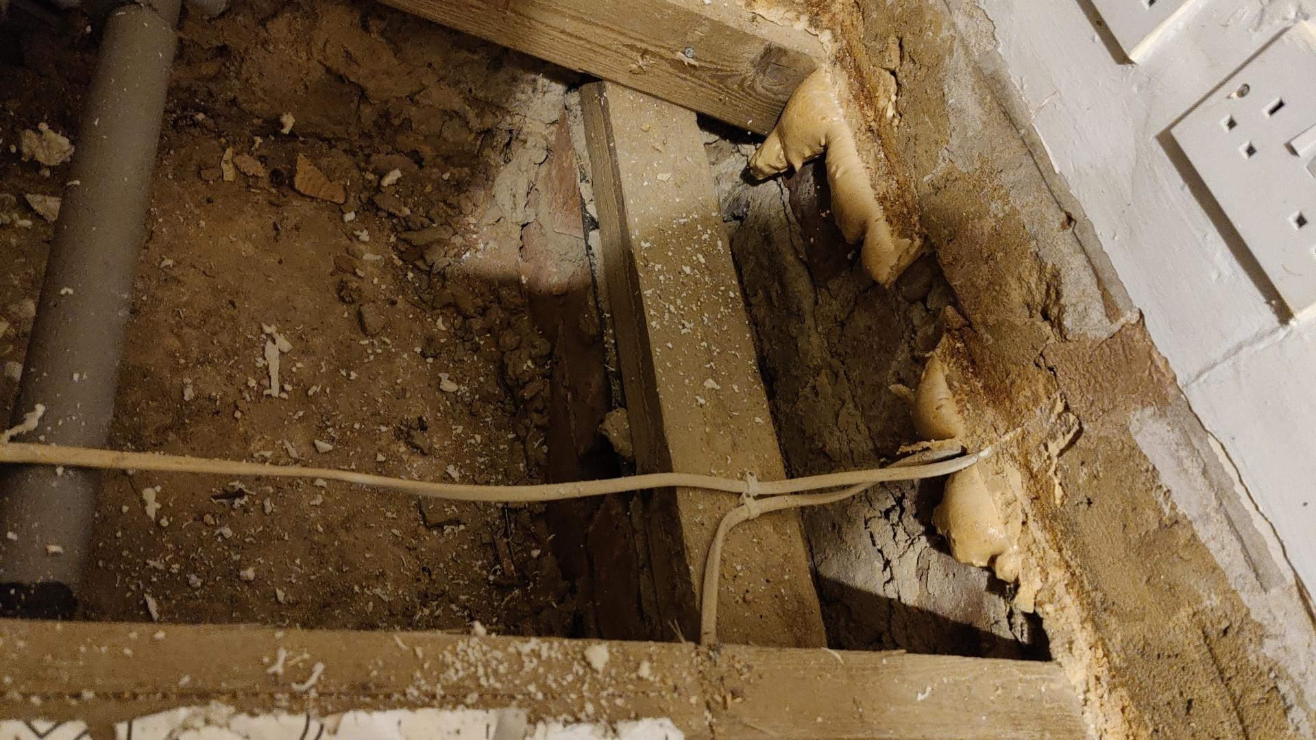

  1. No, nothng supports these boards other than friction and some foam on the edges, hence my worry. That offcut just happen to be there, I believe it was removed later. Last photo is to show depth of the panel relative to the joists.
  2. We are in the process for installing underfloor PIR insulation boards and I have a question regarding electric cables. On a photo cable rests on a beam and insulation board will be installed on top, squishing it. Is it acceptable? Shouldn't cable be moved under the beam? Do I need to ask builders to make a cut in a PIR board to leave air gap around cable at least?
  3. Added photos showing finished underfloor with PIR boards installed.
  4. When board depth matches joists, so that they can sit flush with the top and bottom this method would give me peace of mind. Unfortunately our boards go deeper than joists, so it is very hard to make support for them :( Nothing at the bottom? Is friction + foam + tape enough to keep them in place for years? Wont tape lose stickyness over time allowing boards to "migrate" down? What's wrong with properly installed PIR boards?
