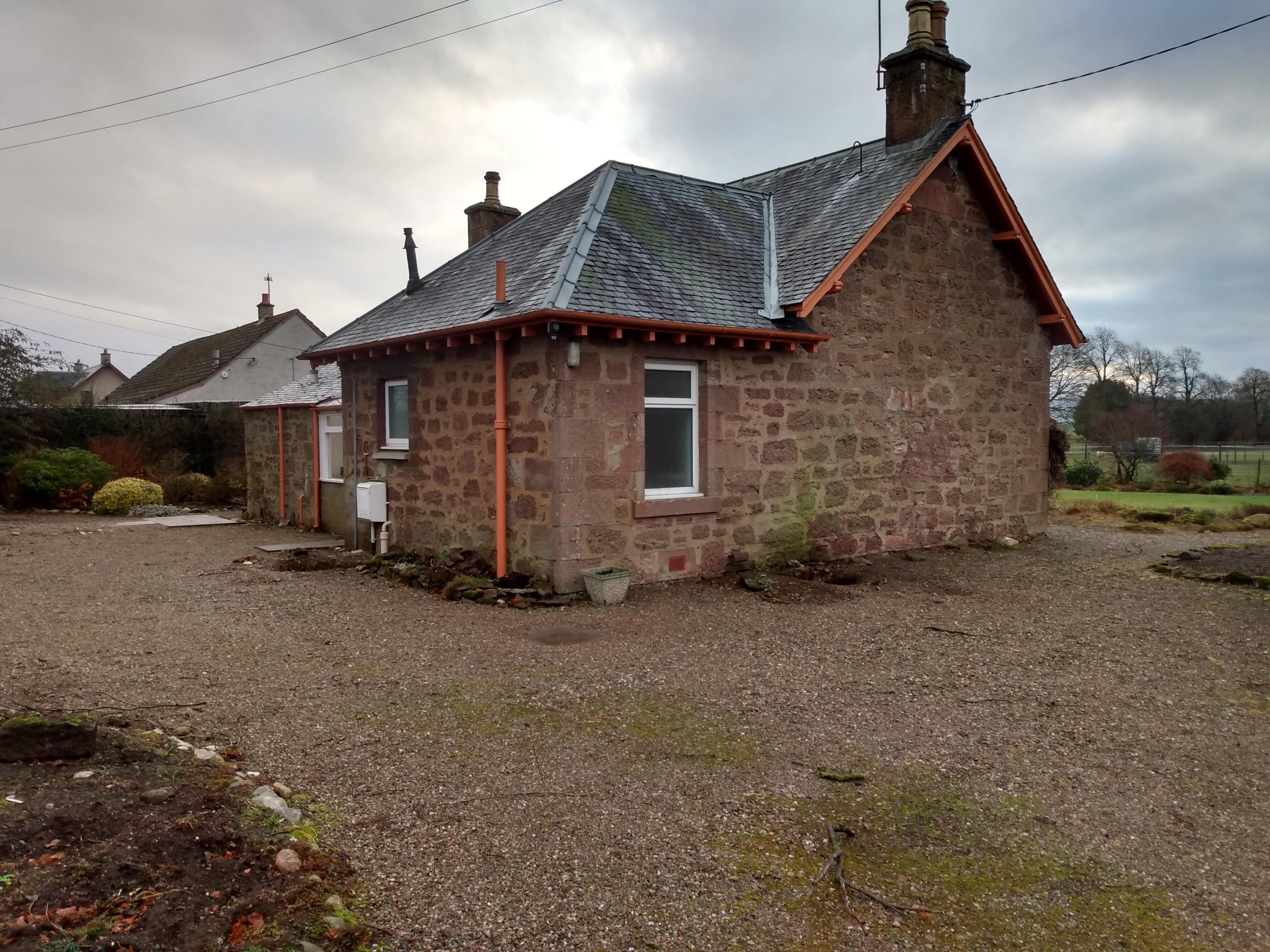

  8. Its looking like redoing the mortar then insulate top and bottom and leave the walls might be the most pragmatic approach, along with good draught proofing and glazing. The longest wall of the house actually faces south so we would get good thermal gain, including the two big windows that will face that way. The west end is that gable you can see and is where the majority of the weather will come from. The extension will be built off that wall so it will protect it to a large degree. The extension will have UFH and a stove so will be toasty, there is potentially a door between the extension and the original part but we are toying with leaving it open to allow air to move. The old part is essentially the bedroom and office wing.
  9. So is the fan just to get rid of moisture? Or are we doing a heat exchanger sort of deal? On the moisture front I assume an electric cooker would be better than gas as no products of combustion! Also have good extraction in kitchen but then you could lose a lot of heat there so even more need for heat recovery? Its almost as though we should just bulldoze the house and start again! As obviously retrofitting this is a PITA.
  10. The new part will have south facing glass for max solar gain in winter so maybe some way of moving that warm air around isn't a daft idea.
  11. In East Perthshire, definitely not covering the stone up but it needs repointed so will lime mortar help with breathability? Got a suspended floor in it and plenty of airflow underneath to reduce moisture problems coming up the way. We are still at the early stages yet but the walls are pretty thick and I assume they will be rubble infill. The extension is going onto that gable end so we need to keep that bit breathing and stop cold bridging etc. There doesn't seem to any damp at all, at least to my layman's eyes. The green patch on the wall was where there was a fruit tree growing. Its on very sandy soil with lots of gravel which naturally drains well but a French drain round the house might be a wise move. The walls are very thick so interior insulation would shrink the rooms a bit the current house is 68m2 and the extension will be about the same. The house had a 92 year old lady in it, and she lived all her days there I think, needless to say it needs throughly modernising so the original bit will be the bedroom and office wing and the new part is going to be open plan living and kitchen with a large utility room. New part will be part render and wood clad with a standing seam roof. There is mains gas on site and we will probably leave any renewables for now apart from a wood burner. The mains gas in our area comes from an AD plant. If there was no gas I would go for kero instead. We don't have enough room for GSHP so it would have to be ASHP and with the price of electricity currently it SEEMS like an expensive option. My wife is never impressed with the looks of solar panels but it could be something to look at. It went in for planning a month ago so here's hoping we might get started this year. I live in a tied house for my job so no rush to move. We used to own a couple of buy to lets and we have been looking for an opportunity to do something like this for maybe 10 years! Now its getting quite real and a bit worrying.
