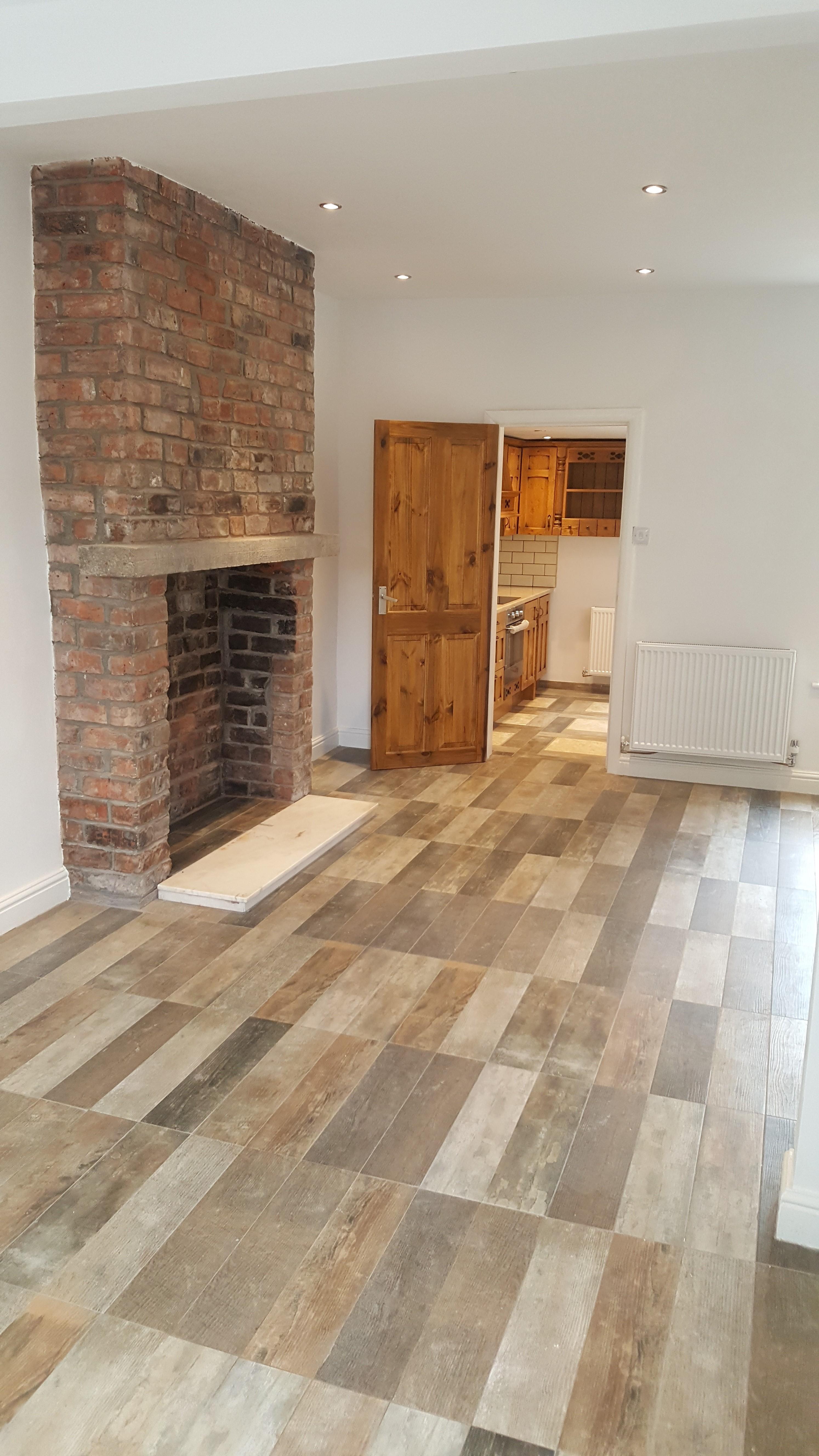

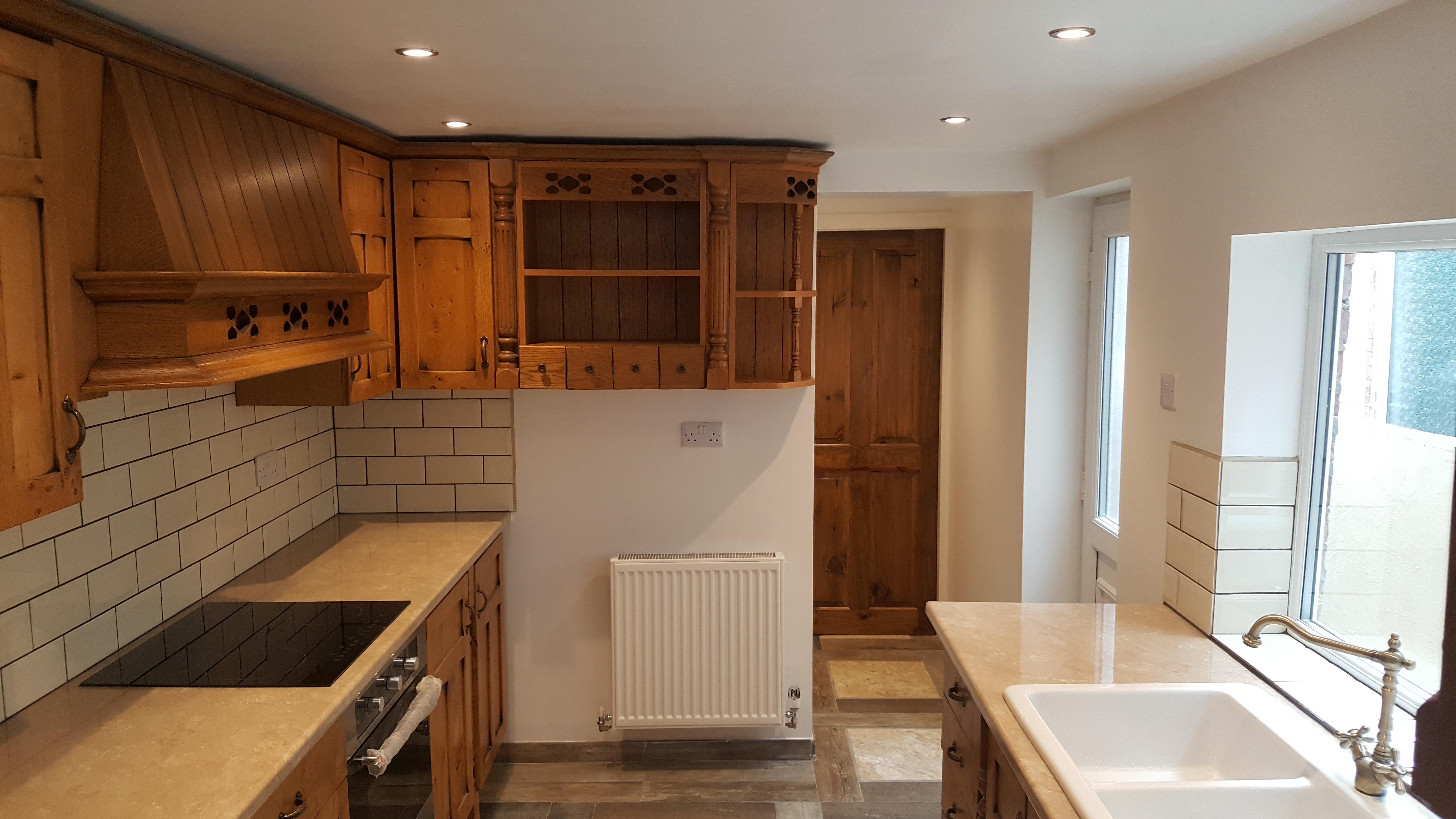

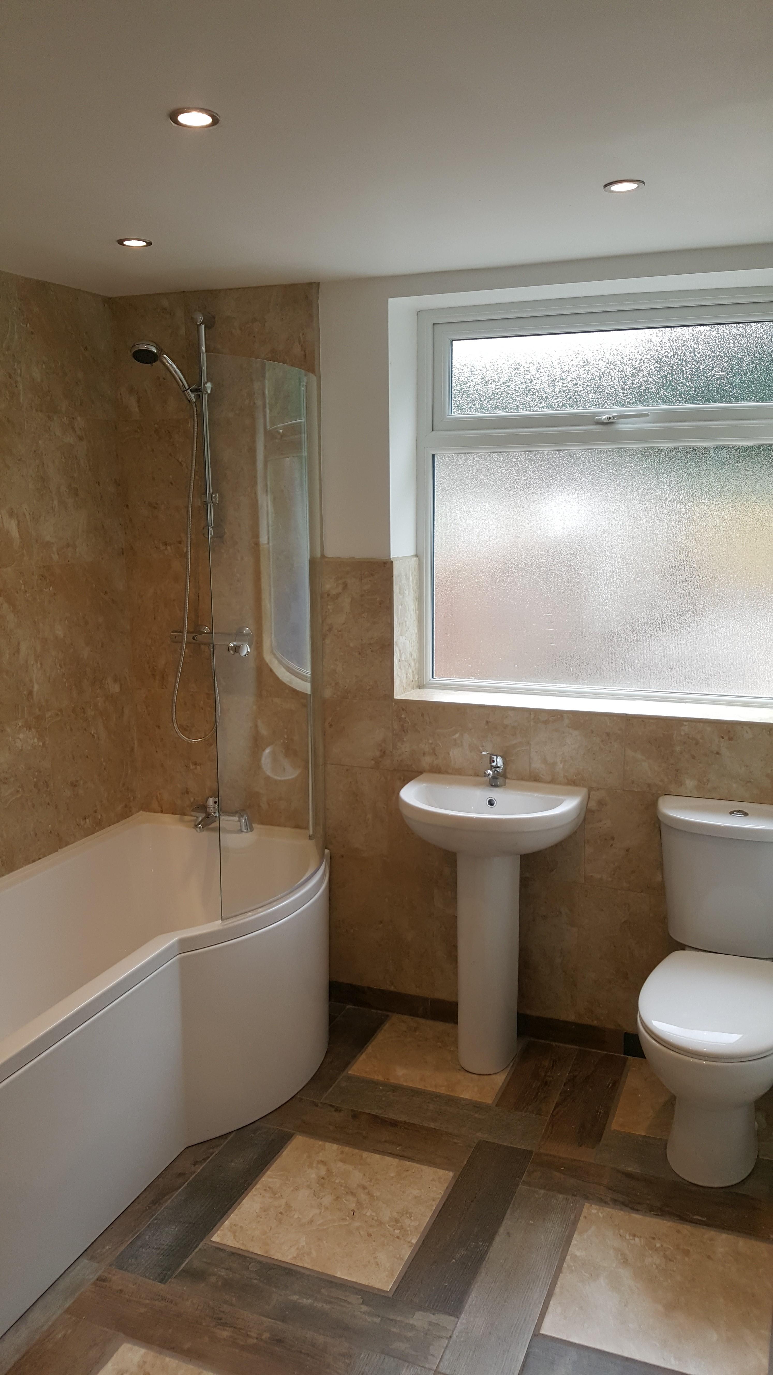

Hi all, Been a while.. Ive just come accross the pics i posted on here quite a while back.. I just wanted to thank everyone for all the input regarding sorting out this house.. Heres a couple of pics.. been finished now a while.. and its been lived in again. :) -
