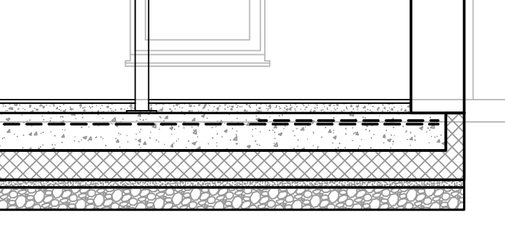

  1. R Wall have been good so far. We haven't started to build yet, we will hopefully in the new year but have just had our xps delivery. They've been helpful in the process so far and it was good being able to visit a local build in process. Matt was really good at talking us through the process and answered all our questions we had both there and over email.
  2. Thanks for all your comments. Very helpful for the waste in the slab. Still undecided for the floor finish. Everyone keeps telling me that I need to put a screed over the slab but this seems stupid. Does anyone have and door threshold details that they could share? In particular, we would like to have a fairly smooth transition from inside to out through our bi fold. If we want to use the slab as finished floor, or a small floor make up (an uncoupling membrane and tiles for example) how would the external doors sit with the slab? Do then sit on the concrete or on the insulation? Your responses are much appreciated

  5. Thanks for the info. Not so keen on exposing all the aggregates. From speaking with a company about the finish, it would need to be power floated and then polished rather than a full grind. Then 2/3 layers of penetrating sealer. They've suggested minimum 100mm concrete to be able to polish it. Seems like a lot of extra costs for a second floor. Is it highly likely that you will get cracks all over the floor even with expansion joints? What do you mean by kitchen spec? Just having a perfectly level finished slab?
