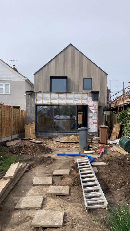

Insides are plastered out and oven ready for our mist coats, which hopefully start Monday.  I’m hoping we’ve no buried leaks or missing cables, time will tell.
Outside a small groundwork’s team are half way through connecting the house to the drains.  When I dug down to find the capped sewer pipe it looked closer to the surface than I remembered - which featured in the playlist of yet another sleepless night.  I’ve quite a wide repertoire of tumble dryer worries, yet another talent courtesy of the build.
Thankfully it turns out my water level did me proud and the poo pipes protruding from the house are at the predicted level with respect to the sewer so happy days.

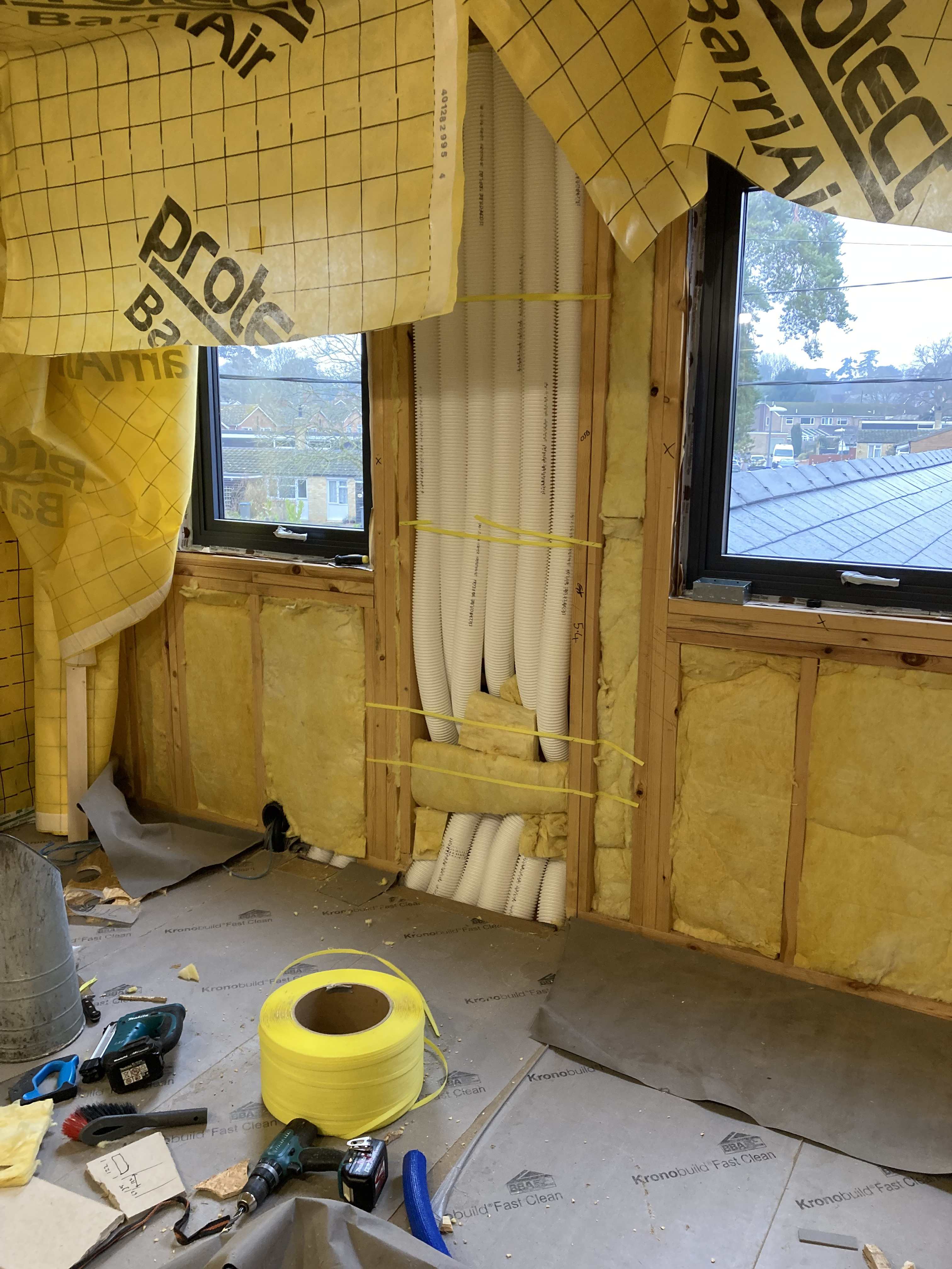

One thing that didn’t go so well was the vent ducts.  It wasn’t helped by the fact that I’d decided to go for 90mm rather than the smaller version and we’d ended up with 253mm metal web joists (pozis) rather than the 304mm I’d planned.  It also wasn’t helped by a glulam blocking the ideal route from the main house into the loft above the downstairs bedroom.
So it was a fiddle, (polite version) and the pressure was on as the duct itself only arrived on the 28th of January, mostly due to a supply issue.

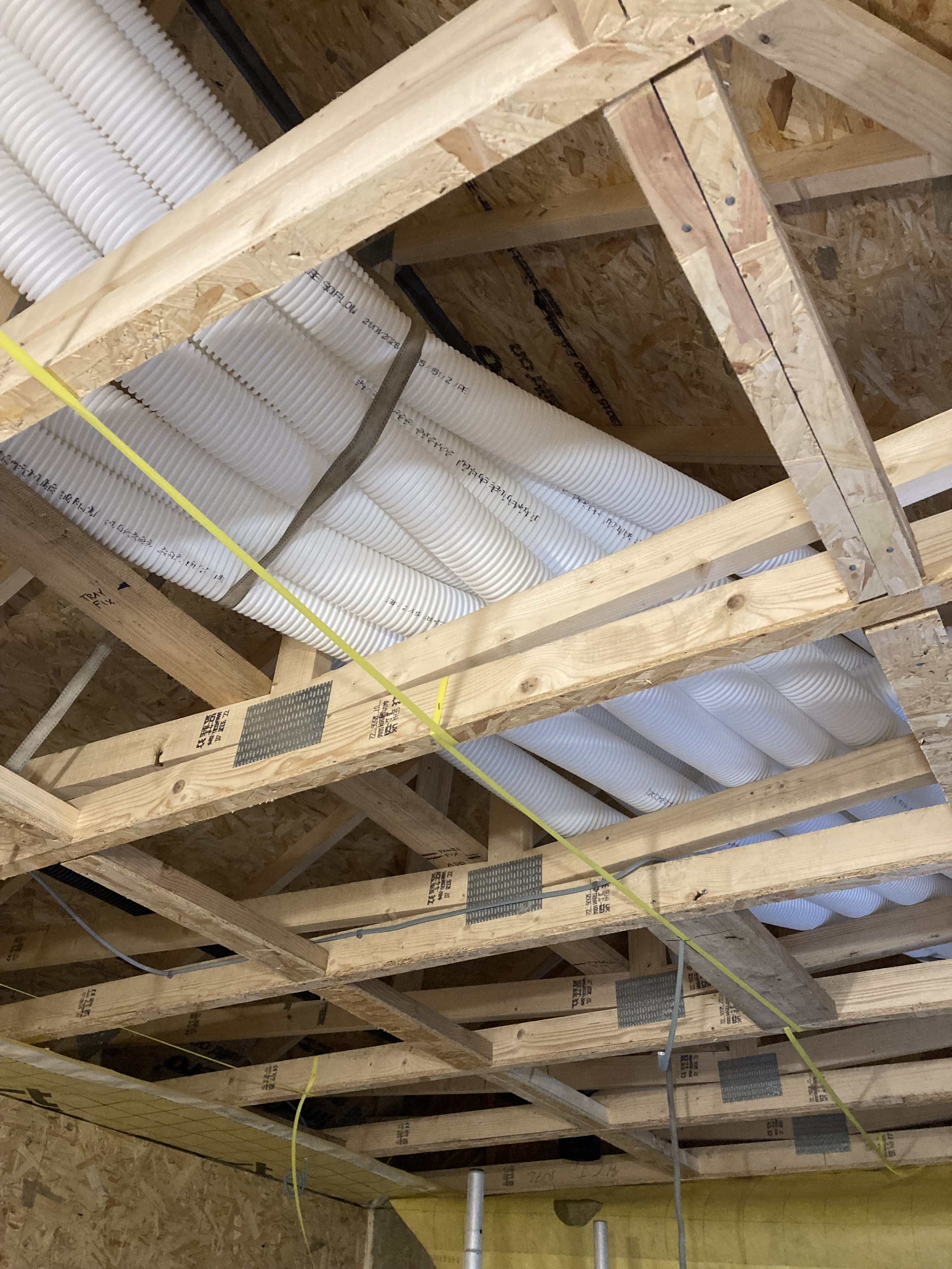

I’d thought long and hard about duct routing, but things are never as one imagines.  The MVHR unit will sit in the garage next to (but not touching for fear of noise) the wall of the downstairs bedroom.  All duct pass through the loft above said bedroom and then enter the house itself.
That loft is a disturbing piece of modern art.  I’m glad that I will never see it again (fingers crossed).  Fifteen 90mm corrugated white tubes bound together wrapped in fluffy brown insulation snaking through the trusses.   Where they pass into the house there is a Quatermass of airtight foam, as if the house was punctured by the hydra and it bleed green goo.  Getting the insulation up there was surreal.  It’s a v restricted space and the only way to do it was to poke my upper body through a gap in the ceiling VCL and distribute the insulation.  It pretty much fills the loft now.  When I start sleeping properly again I’ll have nightmares about all that.
IMG_9192.thumb.jpeg.7947c79f0dfad8dcb7e59d877bbf6bff.jpeg     IMG_9247.thumb.jpeg.1a187bf23e54bd9eafefa30391d396aa.jpeg
It wasn’t all bad news though.   One bit that worked really well was taking all the ducts for upstairs straight up the front gable wall, with the ducts insulated but never passing through the VCL.

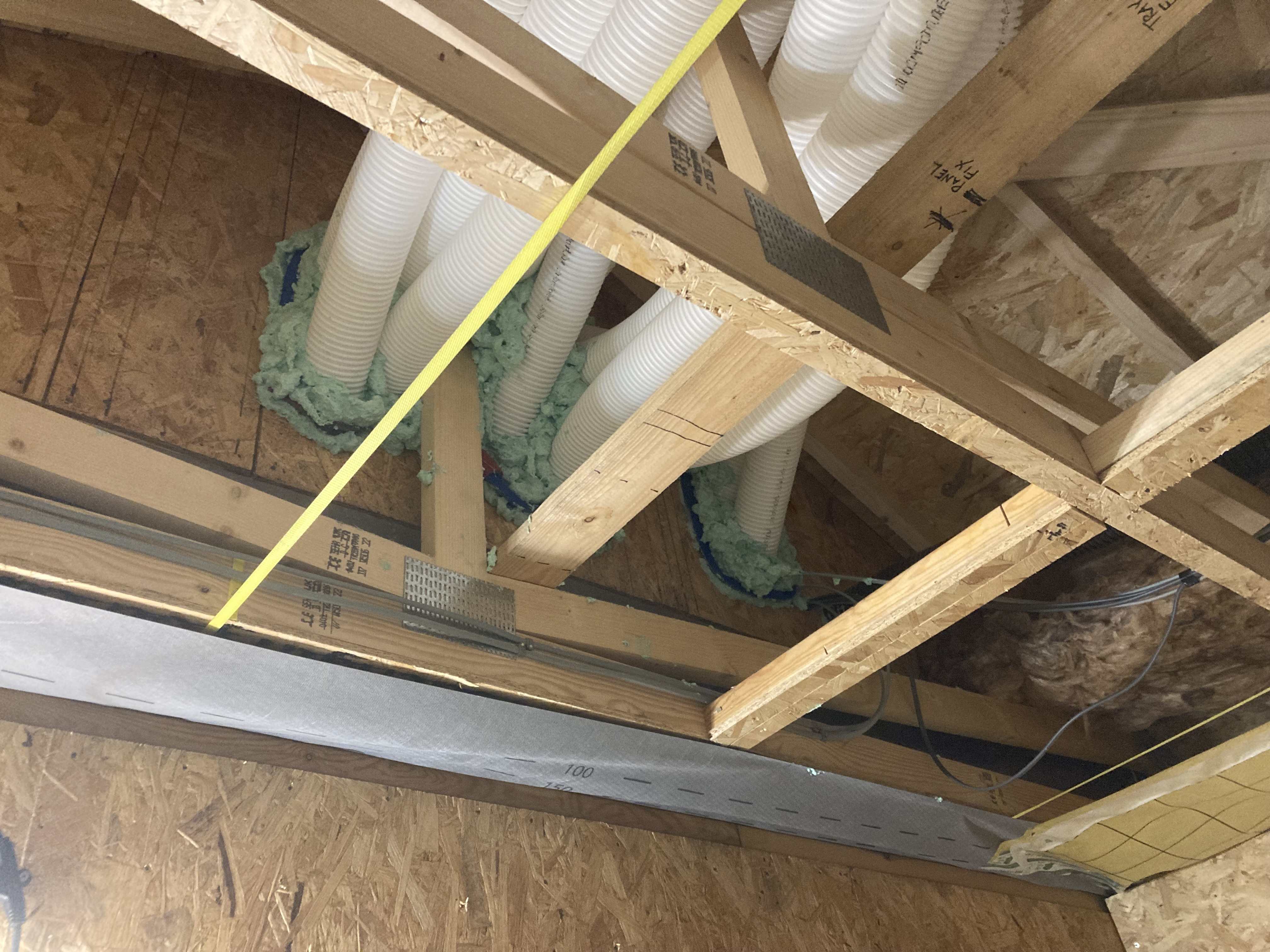

The bit that didn’t work was the downstairs ducts getting over the glulam.  It meant they started their journey into the house with a tight s bend.  The corrugated outer skin helped prevent the pipes pulling through the holes in the wall and floor that enabled them to dive down into the posi layer.
We also discovered a downside to our very heavily engineered joist plan above our main room.  We are very keen to have nice, stiff floors upstairs with little movement.  So we ended up with pairs of 147mm posis with only about 240mm gap between each pair.  Looking at it there was literally more joist than gap.  Felt good to walk on. Getting ducting through however…
On top of that we had a flue to avoid, and a barrier formed by two well insulated pipes that run from the UFH manifold to the cylinder via a diversion due to steelwork - another obvious bit that I failed to anticipate.  Thank goodness the bookends (the guys doing the solar pv/inverter/battery/UFH/heat pump/UVC/etc.) suggested getting the cylinder in when they did.  We call them bookends as either appear to be unable to work without the other.  Odd world, innit.

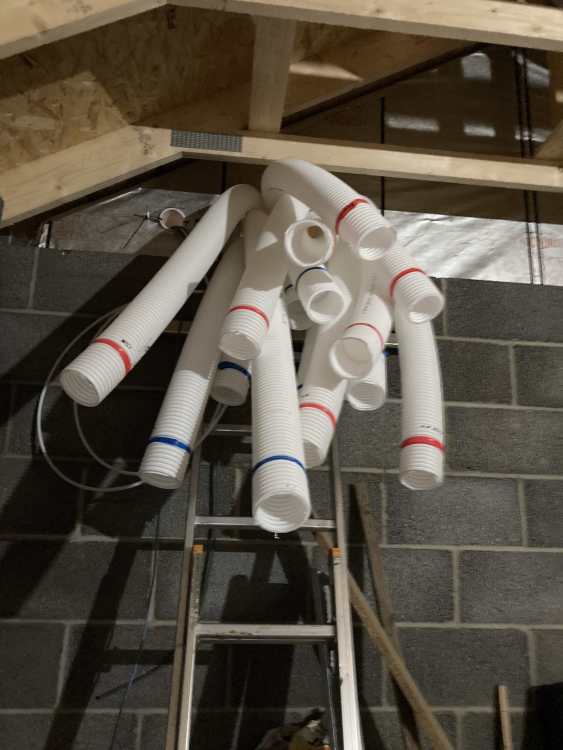

So, with those pipes too in place it’s v congested in various areas.  Much swearing and jumping up and down onto stepladders and skinned knuckles later and the vent pipes were done, with all 15 vent ducts poking out into the garage like some 1950s comedy alien being.
An alien that sits and waits, and when I walk past it it spits distilled water onto me.  Seriously.  Yet another ‘I’d never have imagined that’ moment.
I'm guessing that the warm, wet air from the house is being sucked through all the vent pipes by the passing breezes.  The garage is unheated.   When that air hits the bit of the ducts in the garage some of the water vapour condenses onto the inner walls of the ducts.   As I walk past I cause a disturbance which makes the condensation coalesce into droplets that then fall on me.  What a fabulous illustration of how much an MVHR unit needs a drain.

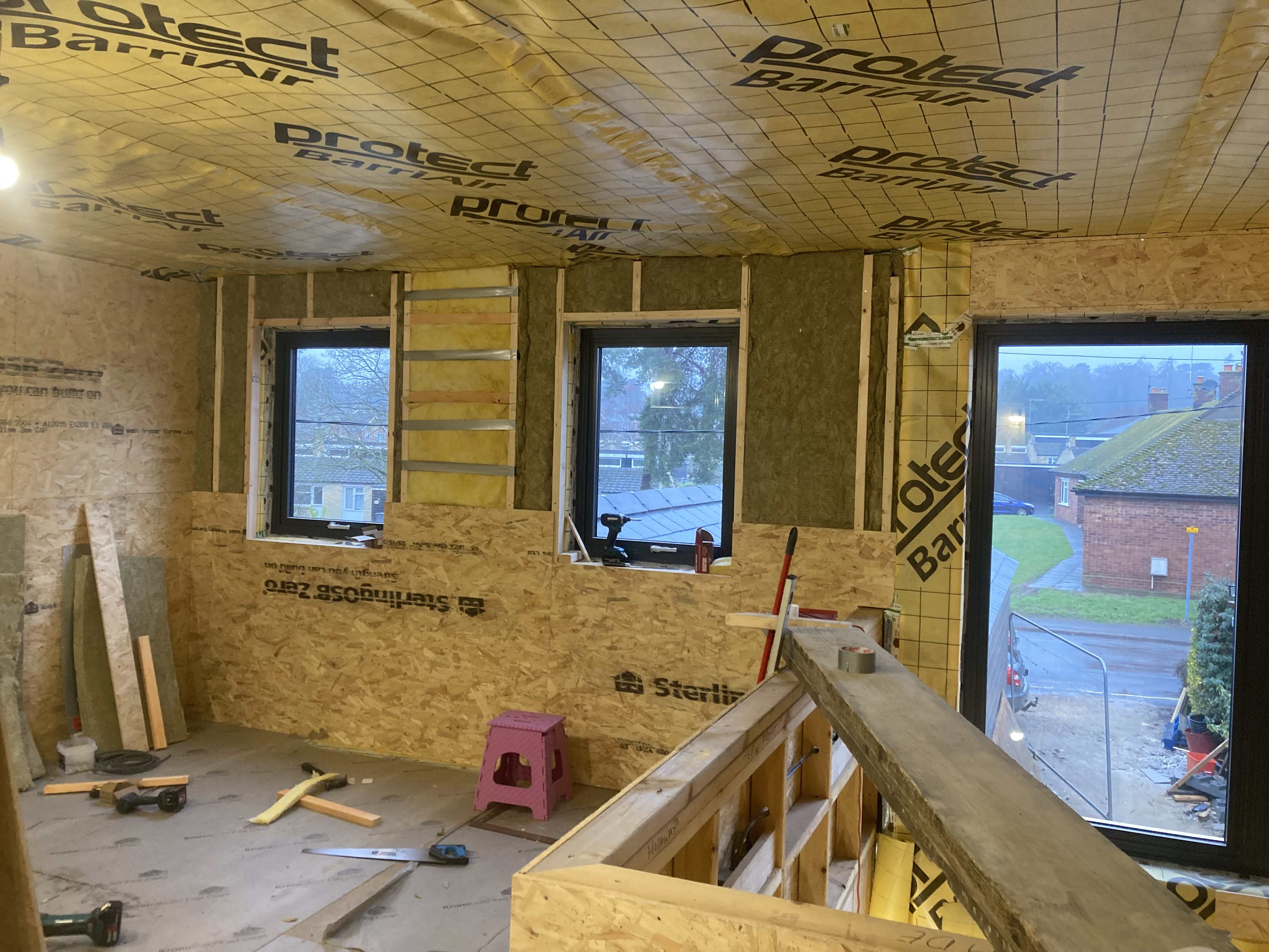

Originally we’d planned to put an OSB layer on all walls and the upstairs ceilings.  I'd gone for raised tie trusses to reclaim some of the ceiling heights lost early in the design process.  The idea was that the little sloped bit at the top of each wall would be hidden by the extra layer of studs and insulation.   It was designed to the millimetre.  Mistake.
The tackers assured me they would be careful of the ceiling VCL, and indeed they were.  The few times they caught the VCL or when it needed easing they called me in to bring my repair tape.  (Note to others - put spare VCL at corners, it’s so easy to make it too tight for the tackers).  So they convinced us to ditch the ceiling OSB idea.   Only if course, I’d factored in the thickness of the OSB into my calcs for the raised tie trusses.
So when the walls were boarded in a couple of places the roof bracing was just a tiny bit too low.  I should have allowed a contingency but hey ho, double boarding the walls sorted it where needed.  Fortunate to say the least.

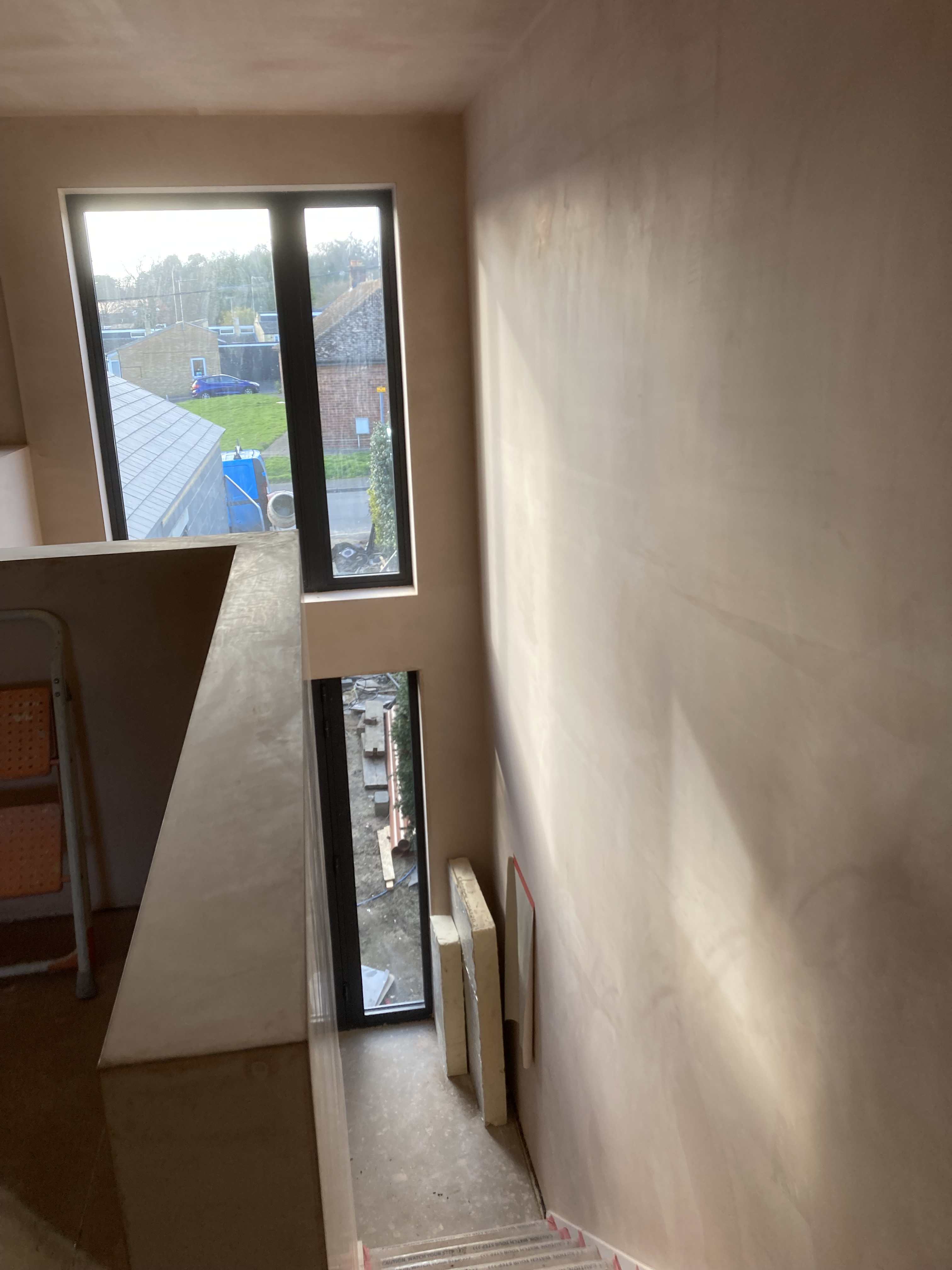

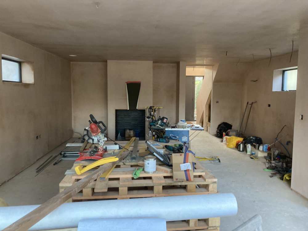

Plasterboard changes the place.   We’d spent weeks amongst soft, spongy walls, with insulation sitting behind and in front of the VCL.   Very quiet.  Lovely in fact.  But plasterboard puts all the echo back and then some.  Plus it finally shows the rooms for the shape and size they are.  Sounds daft given how long we've spent in those rooms but seeing them plasterboarded was a bit of a shock in places.
The best example of that is the hallway.  Drawing layouts and trying to imagine spaces only gets you so far.   We designed in a double height space just inside the front door, nice straight stairs on one side.   Bit of a sort of gallery on the other.  But it’s huge.  I knew all the dimensions by heart but I still didn’t know how big it was going to turn out.  We are going to have to get creative to get it feeling right.   Fortunately for me our principle aesthetics consultant (i.e. J) is brilliant, so I just know it’ll turn out well.

The plaster has reduced the echo a bit, and as it’s drying and its colour gets lighter it’s given an even better impression of the rooms.
