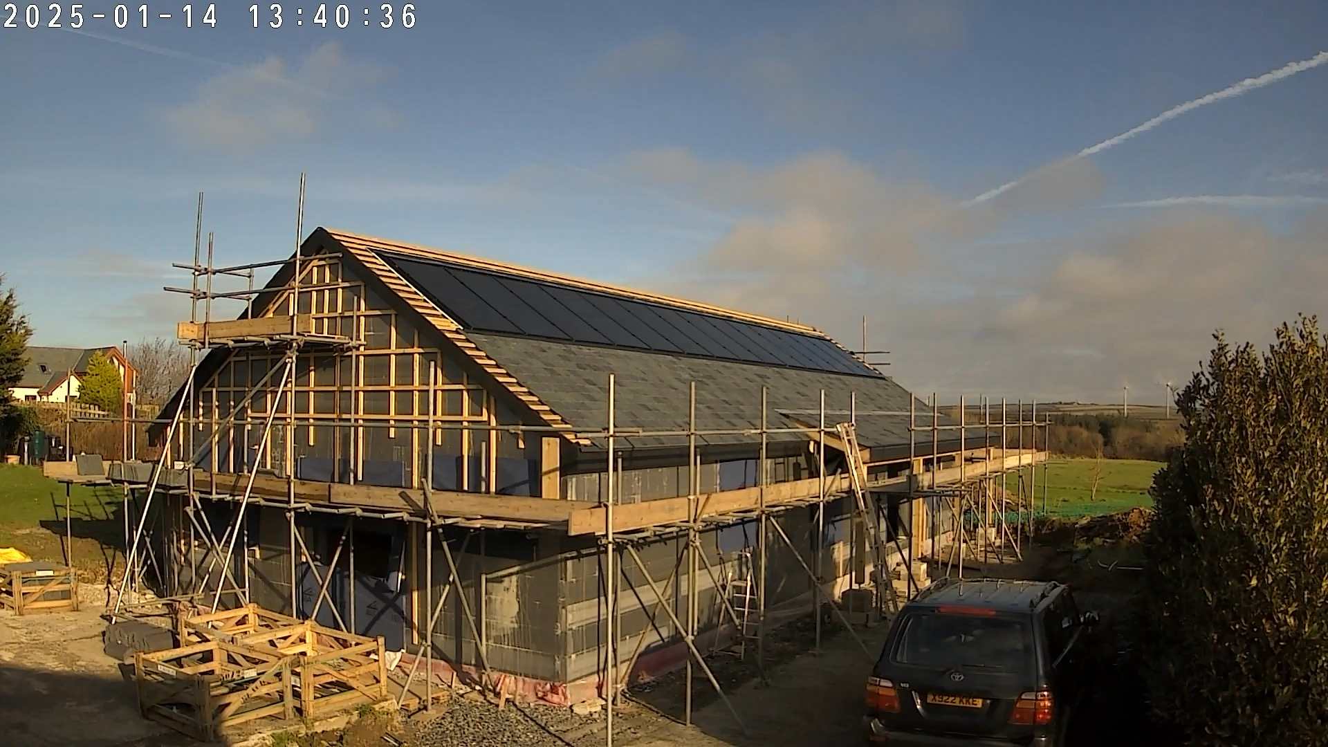

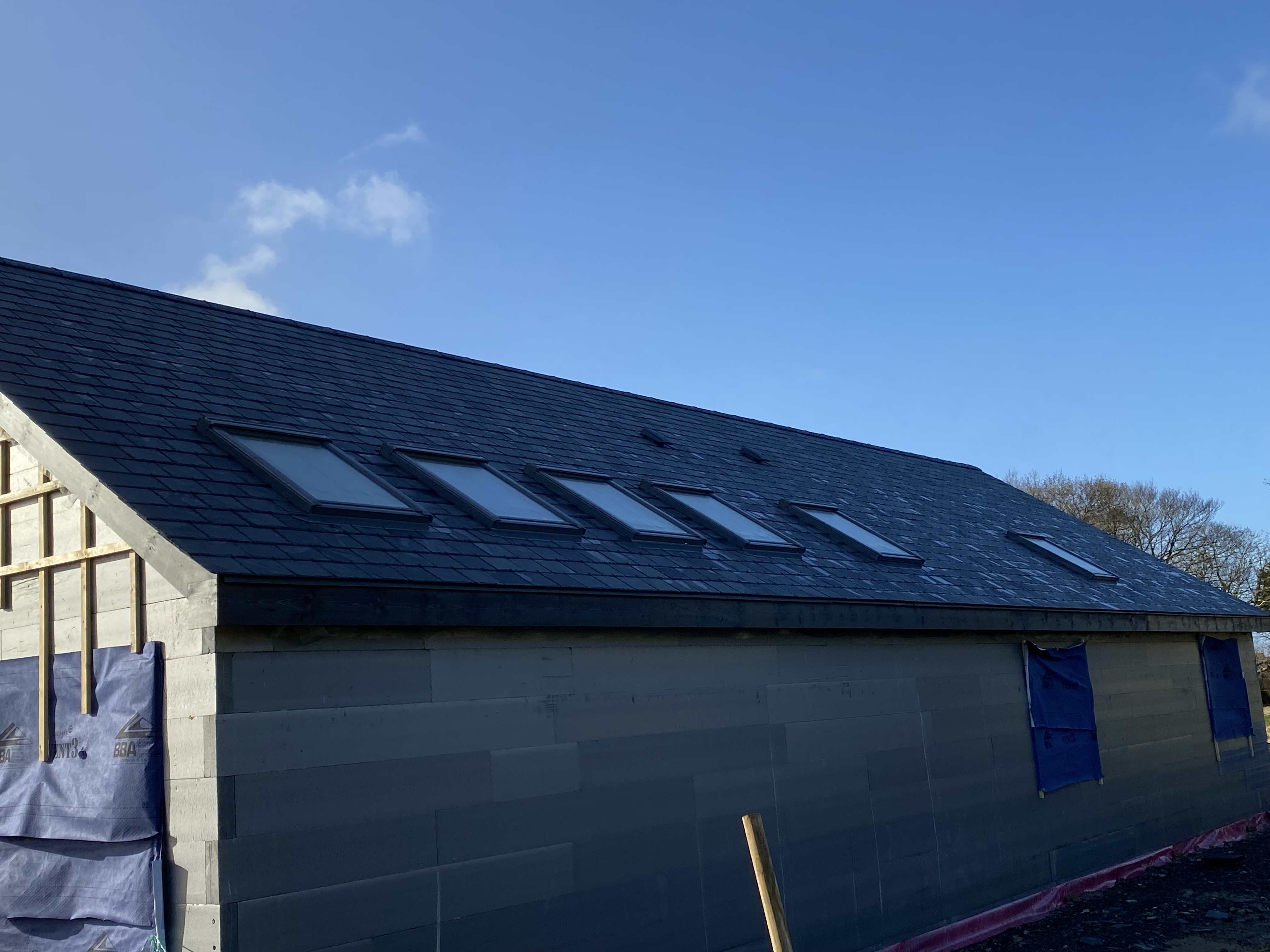

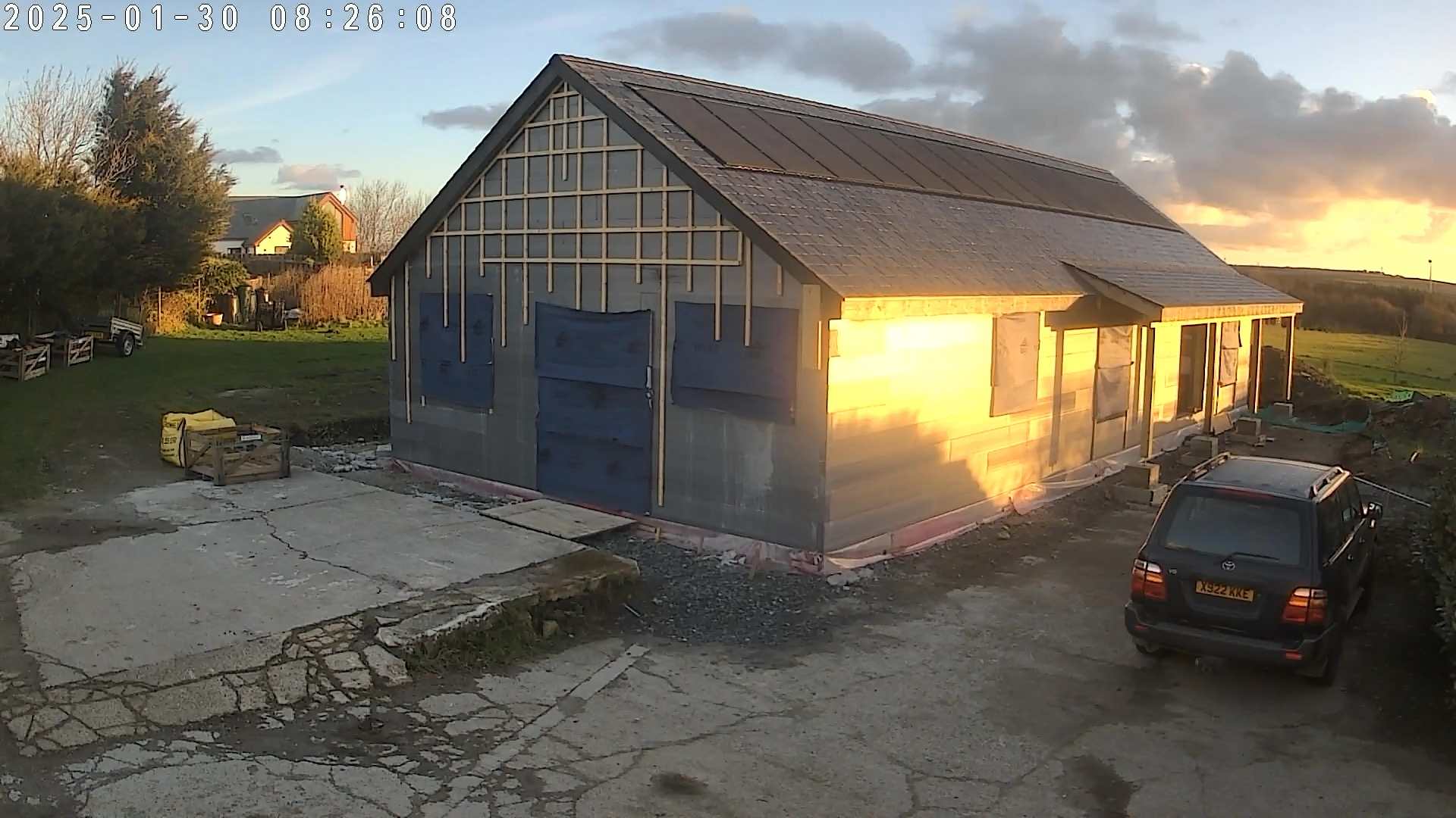

So it’s been a while since the last update, but a couple of weeks ago the scaffolding came down and we can finally see our lovey slated roof and the solar.  I am very happy with the roofers who worked so hard in the cold and the wind, as we are quite exposed.  Anybody in the South West looking for a roofer I would be happy to recommend them.

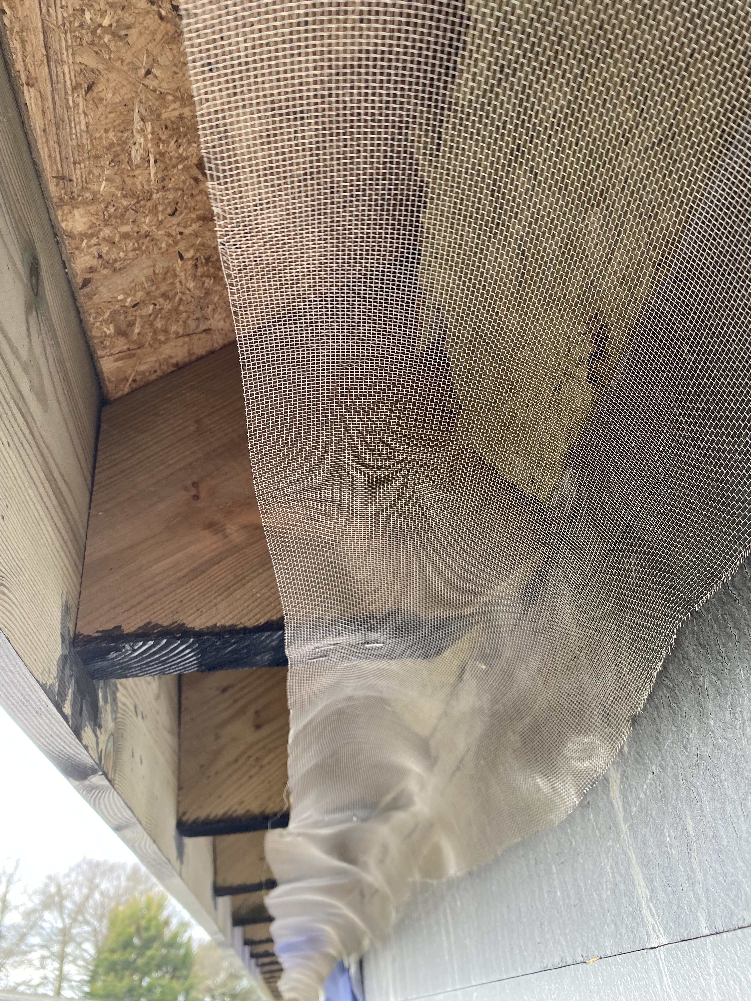

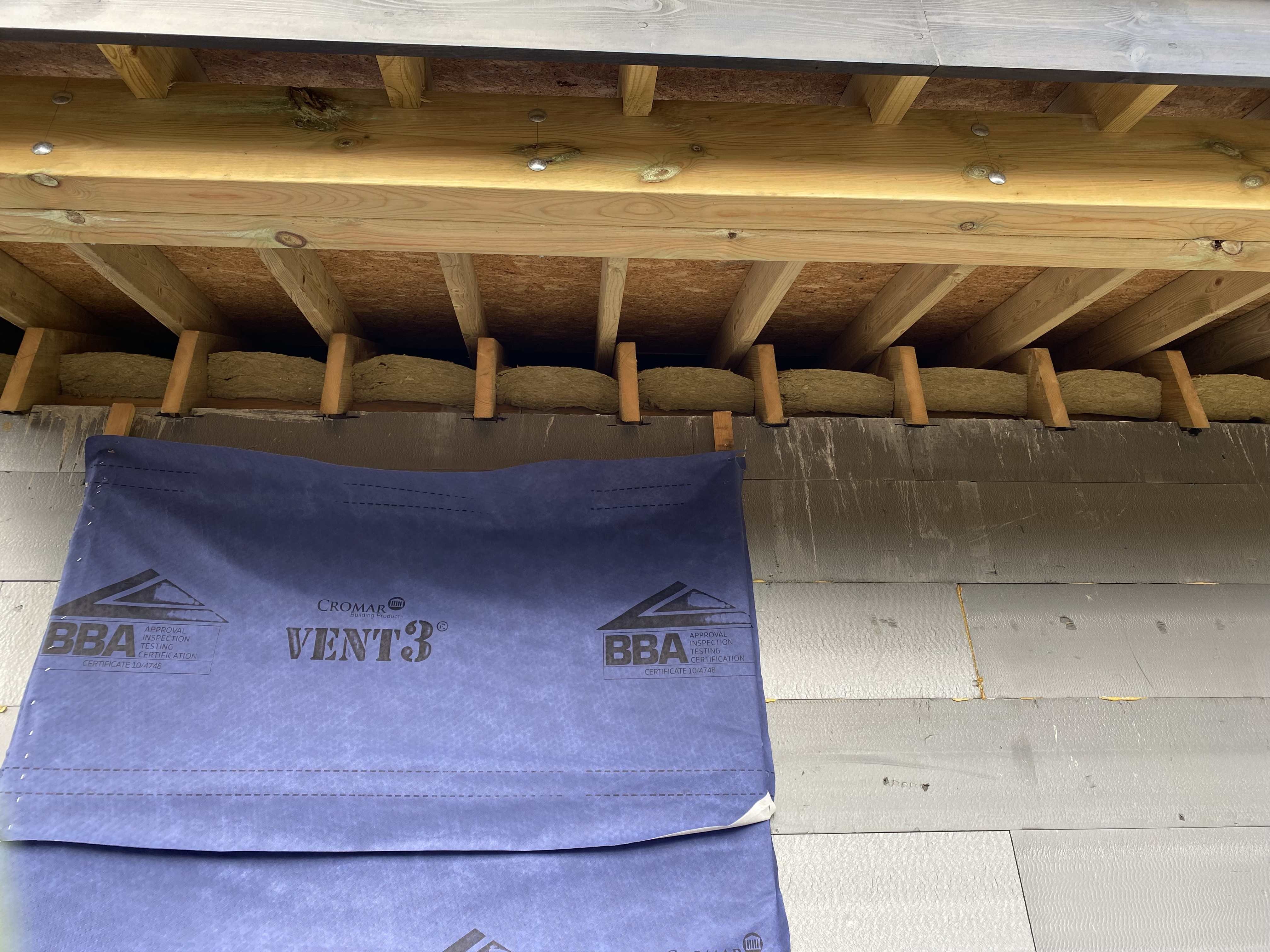

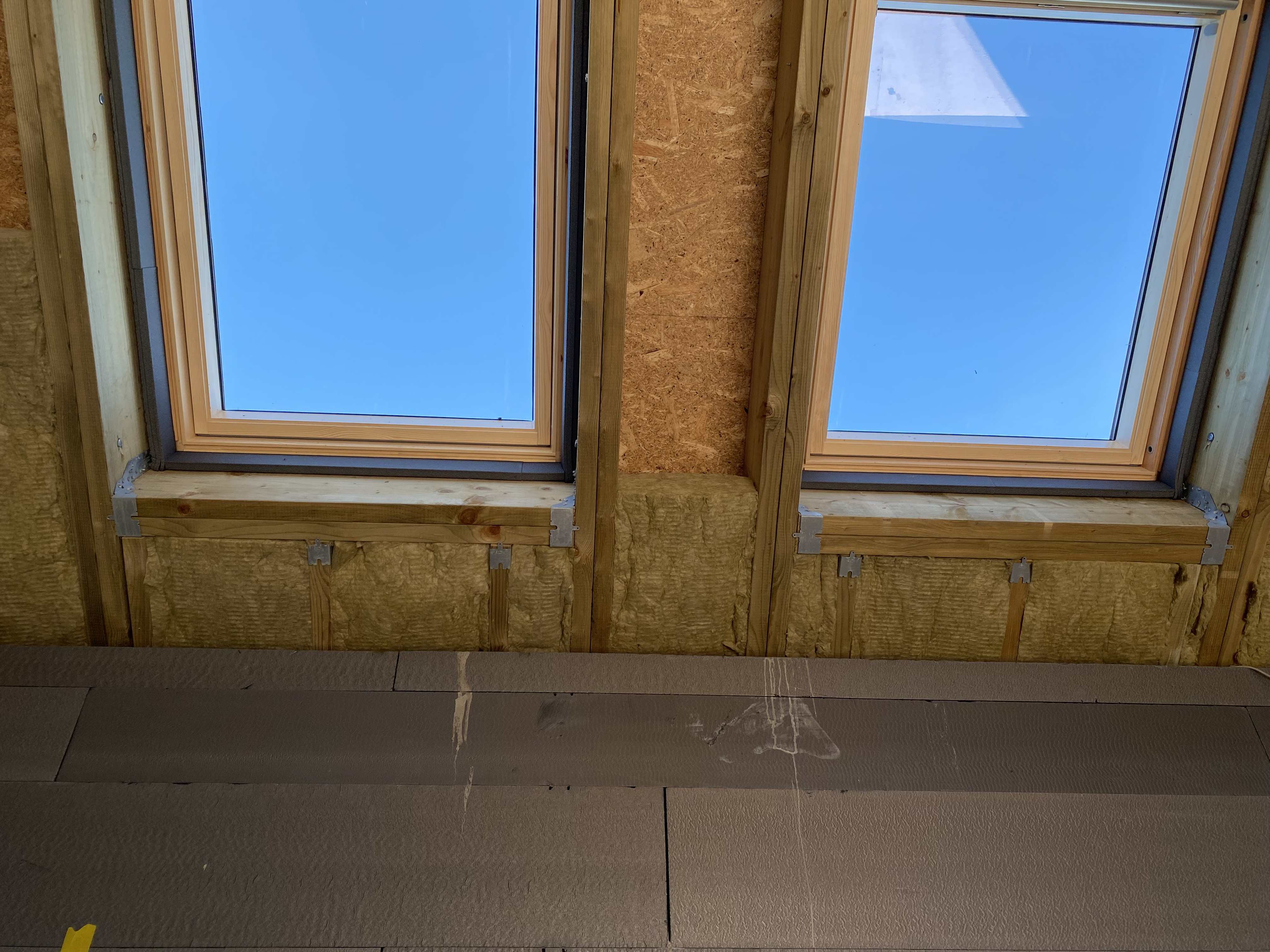

On the inside I have started with the insulation between the rafters.  I am using Rockwool flexi slabs 140mm thick with an air gap above.  On the outside I have put some insect mesh up already before the soffits are closed up, it’s attached to the ends of the rafters and will eventually be attached to the battens/cladding.
As per previous blog the costs of parting with the builder and finding our own roofer and solar has proved to be good.  Their respective quotes have been invoiced for the same amounts as the quotes, no extras or surprise costs.  A saving of at least £12,000 against staying with the builder as his quote would have also incurred extras no doubt as he didn’t include Soffits on his build quote or roof quote, and he acknowledged they had not been included in any quote.
Carried forward total £140,645
Scaffolding for roof £1440
Roofing.  Felt and batten. Slate with Brazillian Graphite natural slate 500 x 250mm. Hook fix system to costal zone spec as per plan. Dry ridge system Con6 with Marley modern smooth grey ridge tiles. Two vent slates.  Total supply and fix. £16786
Supply and fix softwood treated facia and bargeboards. Eave ventilation. Complete counter batten.  £2111
Solar 15  x500W solar panels and GSE in roof trays.  (Interior fit to be completed once windows are fitted) Supply and fit  £4357

1 Pallet of Rockwool 46m2 (Expect to order 2 more pallets to finish between rafters then PIR under rafters) £580
