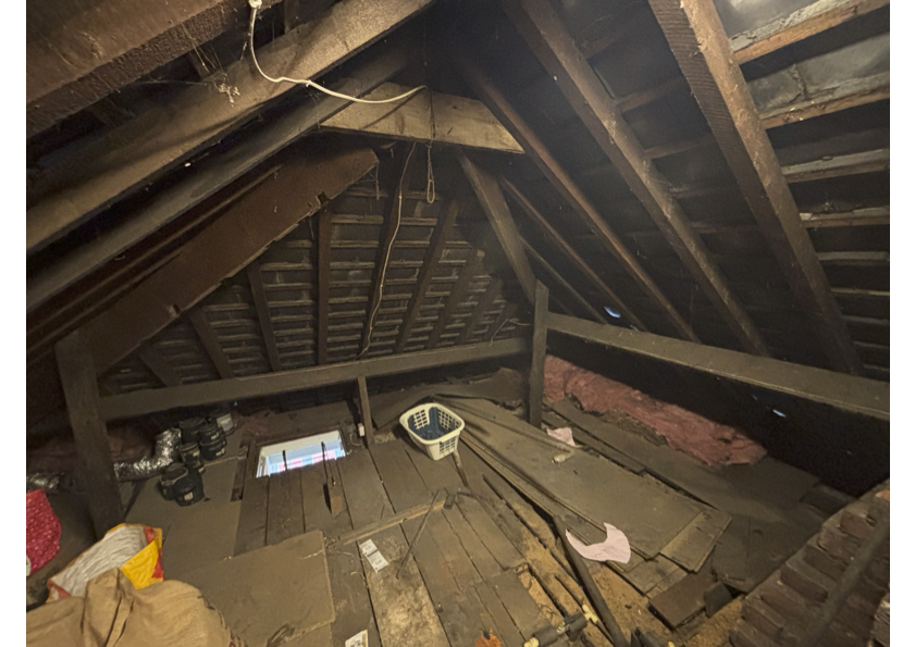

I'd like to make better use of the loft space in a semidetached 4 bedroom house, built 1906. Objectives are to:
1. Create a better insulated "warm loft" space
2. Improve access with larger loft hatch and e.g. foldable loft ladder
3. Velux windows
4. Remain within existing roofline with no plans for dormer extension
5. Include built in storage/cabinetry and overall result to resemble something like the screen shot below.
6. Would be used for storage and perhaps as a hobby/exercise space, to house an exercise bike and rowing machine etc.
We don't want to pursue a formal dormer loft conversion, as feel the expense will not add sufficient value to the house. We're also likely to move within next 5 years. I'm aware that this means the space will not be considered habitable and could not be considered an extra bedroom etc.
Initial advice conflicts and I'd be grateful for guidance. A reputable structural engineer advises that for a modest loft conversion such as this timber reinforcement of existing ceiling joists is sufficient. Subsequently, any builder I ask to quote advises that formal input from an architect & structural engineer is necessary.
Grateful for any advice!
Thanks,
Anthony

Well you're not in England so can't comment on your regs but here if you add a further storey then you have to upgrade fire precautions etc. the regs do not clarify what use that storey is to be put to.
In more general terms that's going to be a lot of work and expense to get from the upper picture to the lower, would it be worth it for less than 5 years..... and those slates look old.....
