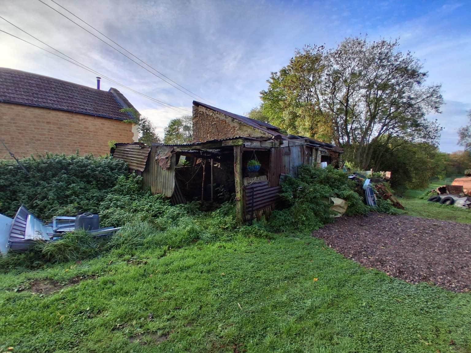

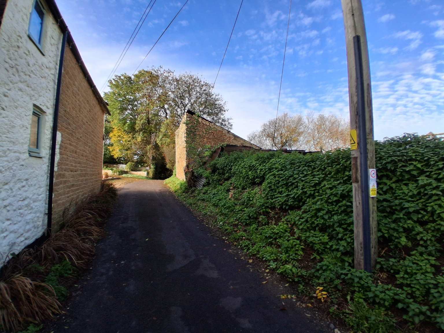

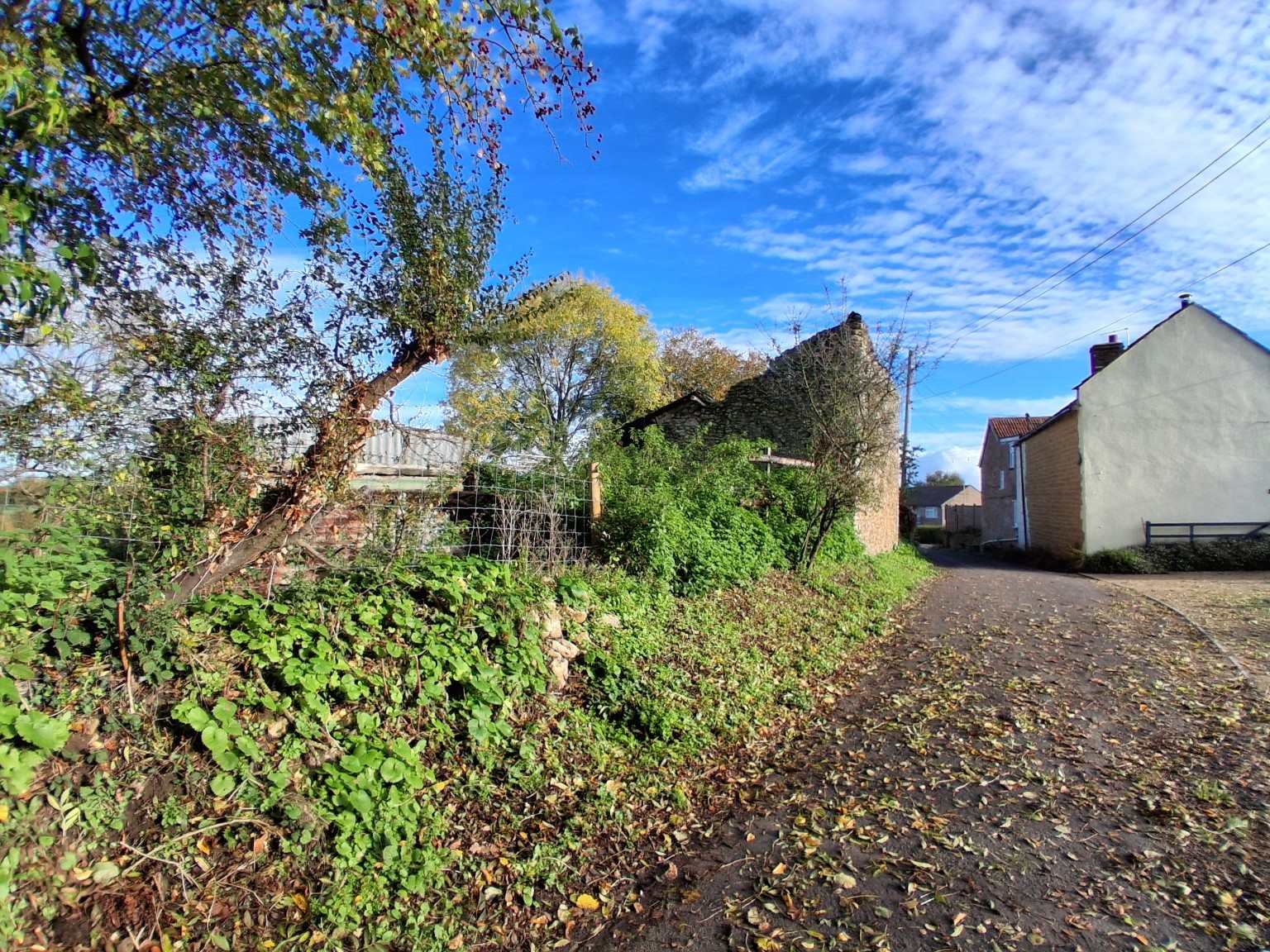

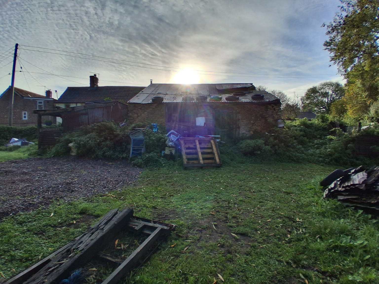

I’m working on a small rebuild project and would appreciate some technical input from anyone with experience in combining traditional masonry with modern natural materials.
The building sits within the old farmyard of a listed property, so I’m aiming to retain the original form and materials as much as possible while introducing a new structure that’s sustainable, breathable, and reversible.
Existing Structure
  • Rubble-stone barn with sections of collapsed walling and a corrugated tin roof in poor condition.
  • The goal is to keep or rebuild the stone walls to their original height and footprint, then construct a new glulam timber frame inside to carry all main loads.
  • The existing footprint is roughly 10.8 m × 7 m, with a 7 m × 3.5 m rear extension planned.

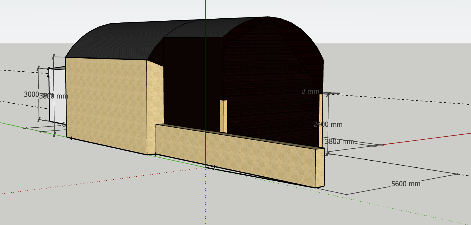

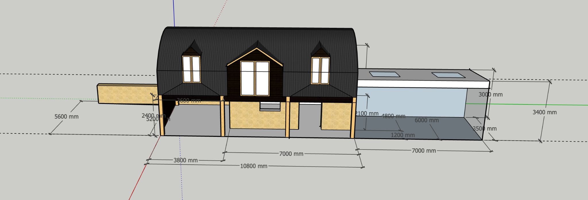

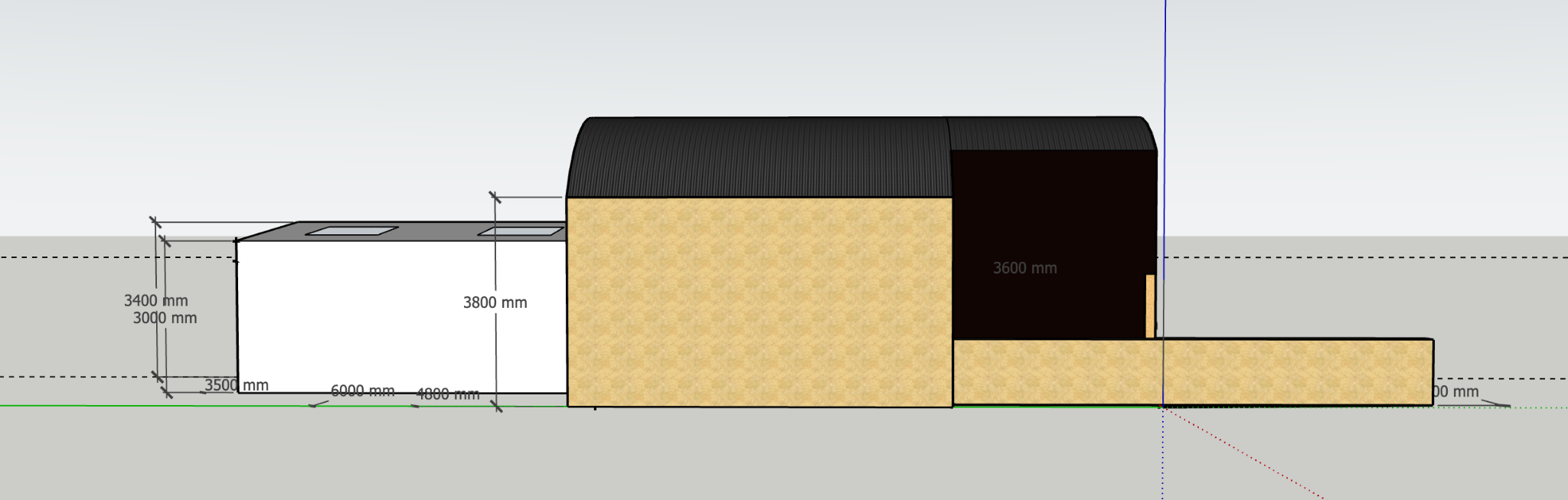

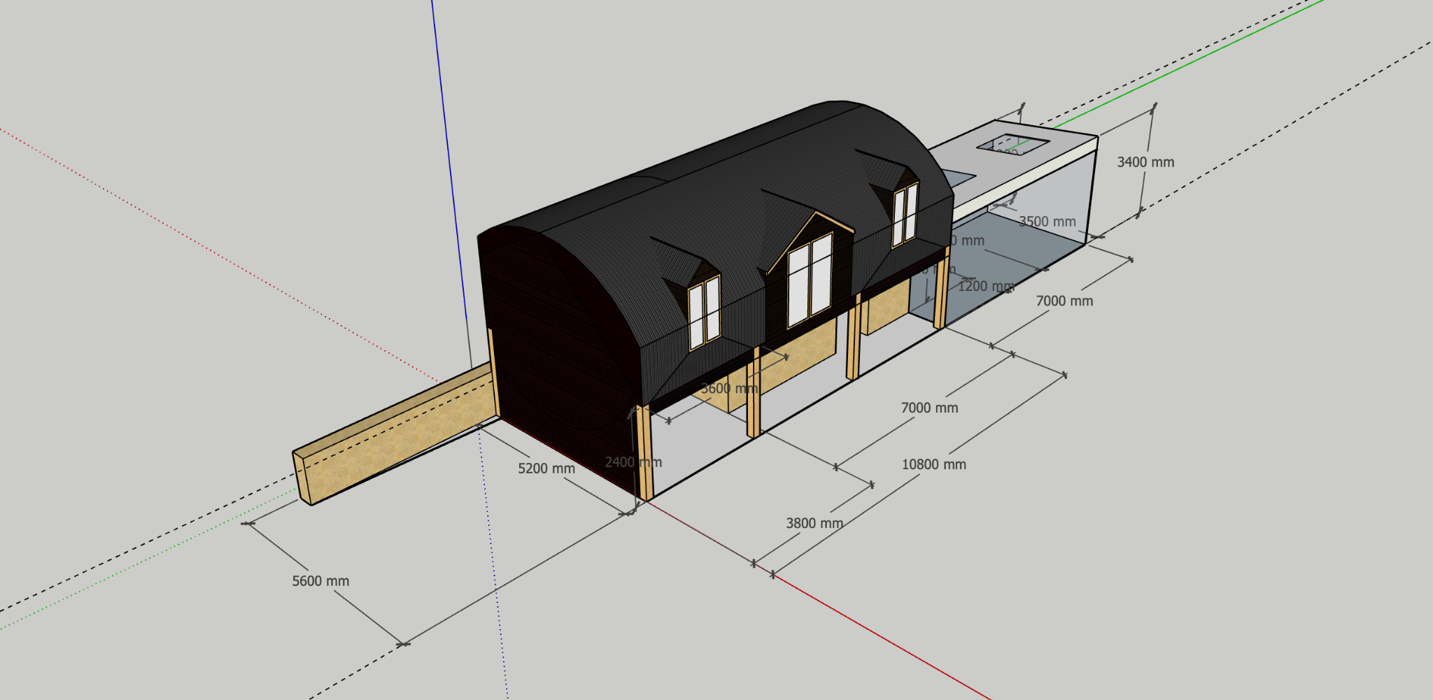

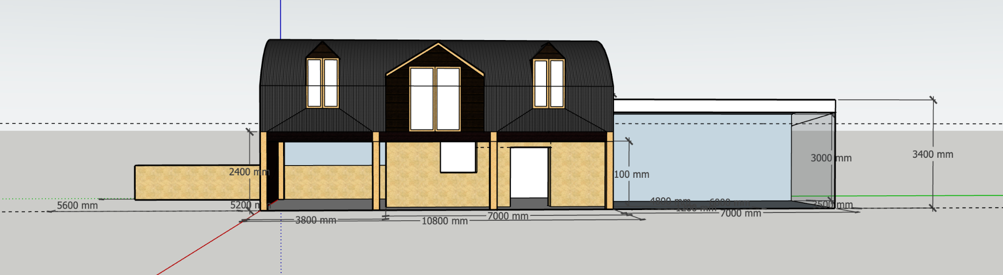

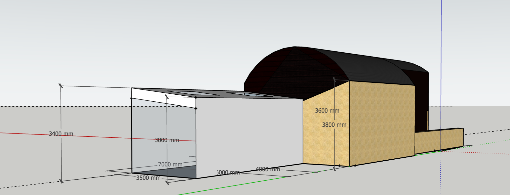

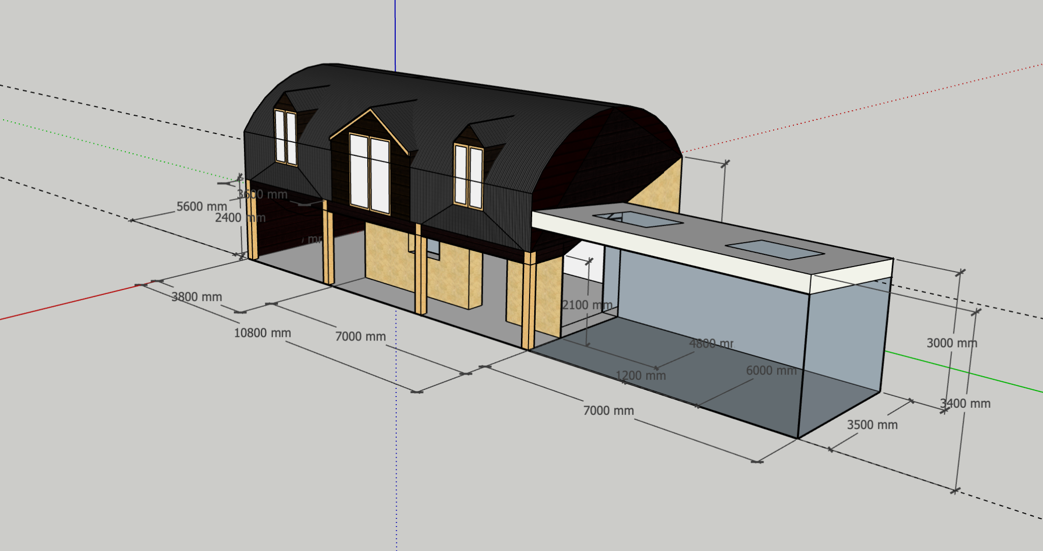

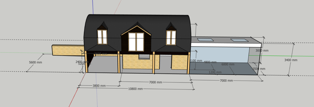

Proposed Construction
  • Structure: Independent C24 timber frame inside the stone envelope.
  • Walls: Hempcrete cast in situ between the frame members, tight against the existing stonework.
  • Roof: Curved glulam beams forming a Dutch-barn-style arch, finished with new corrugated galvanised sheeting to match the original character.
  • Floor: Limecrete slab over geocell insulation, fully vapour-open.
  • Finishes: Lime plaster internally; repaired stonework and timber cladding externally on rebuilt sections.
  • The design aims for a fully breathable building envelope with no cement or plastic membranes.
Points I’d Value Input On
  • Best practice for tying a limecrete slab into old stone footings without trapping moisture.
  • Managing condensation risk under corrugated metal roofs in breathable builds.
  • Experiences with hand-laminated or custom glulam beams for curved roofs.
  • Whether Class R (agricultural to flexible commercial) could apply here, or if full planning is the more realistic route.
  • How best to design for flexibility so the space could convert from light commercial/wellbeing use to small residential use later on.
Photos below show the current barn condition and context in the old farmyard, and the SketchUp visuals illustrate the intended rebuild form.
