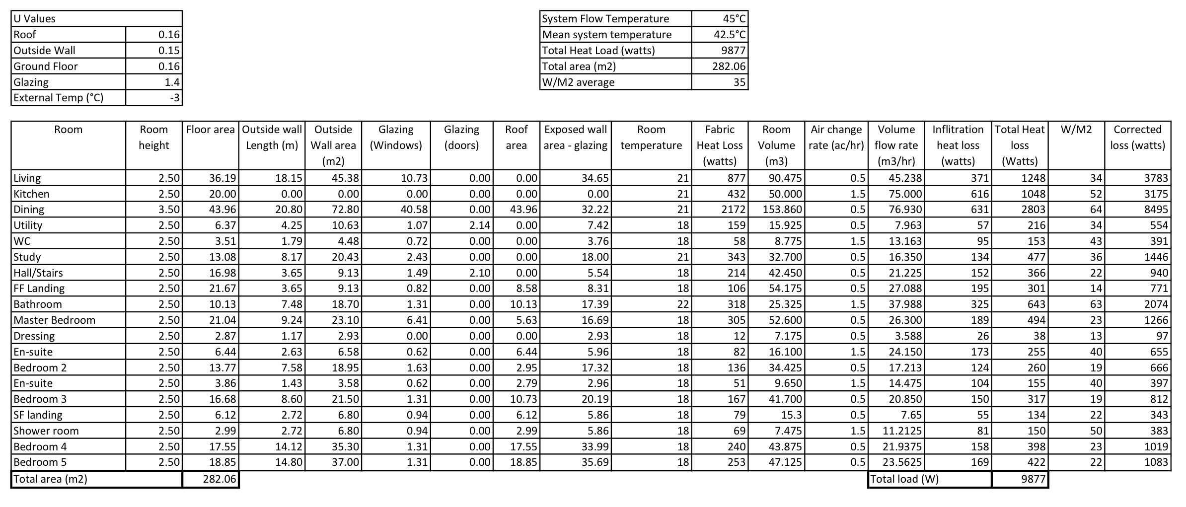

If the rad is producing 285 watts and the calculated total heat loss for the bathroom is 643 watts, does that mean the rad has been incorrectly spec’d? Or someone has not accounted for the corrected output.
Simply put, yes, the specified T60 rad output should, IMO, be 643/0.17212, 3736 watts.
Don't know what the corrected loss of 2074 watts means though.
